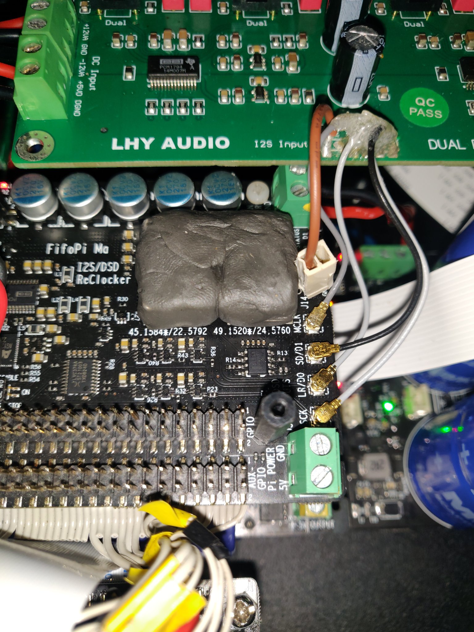

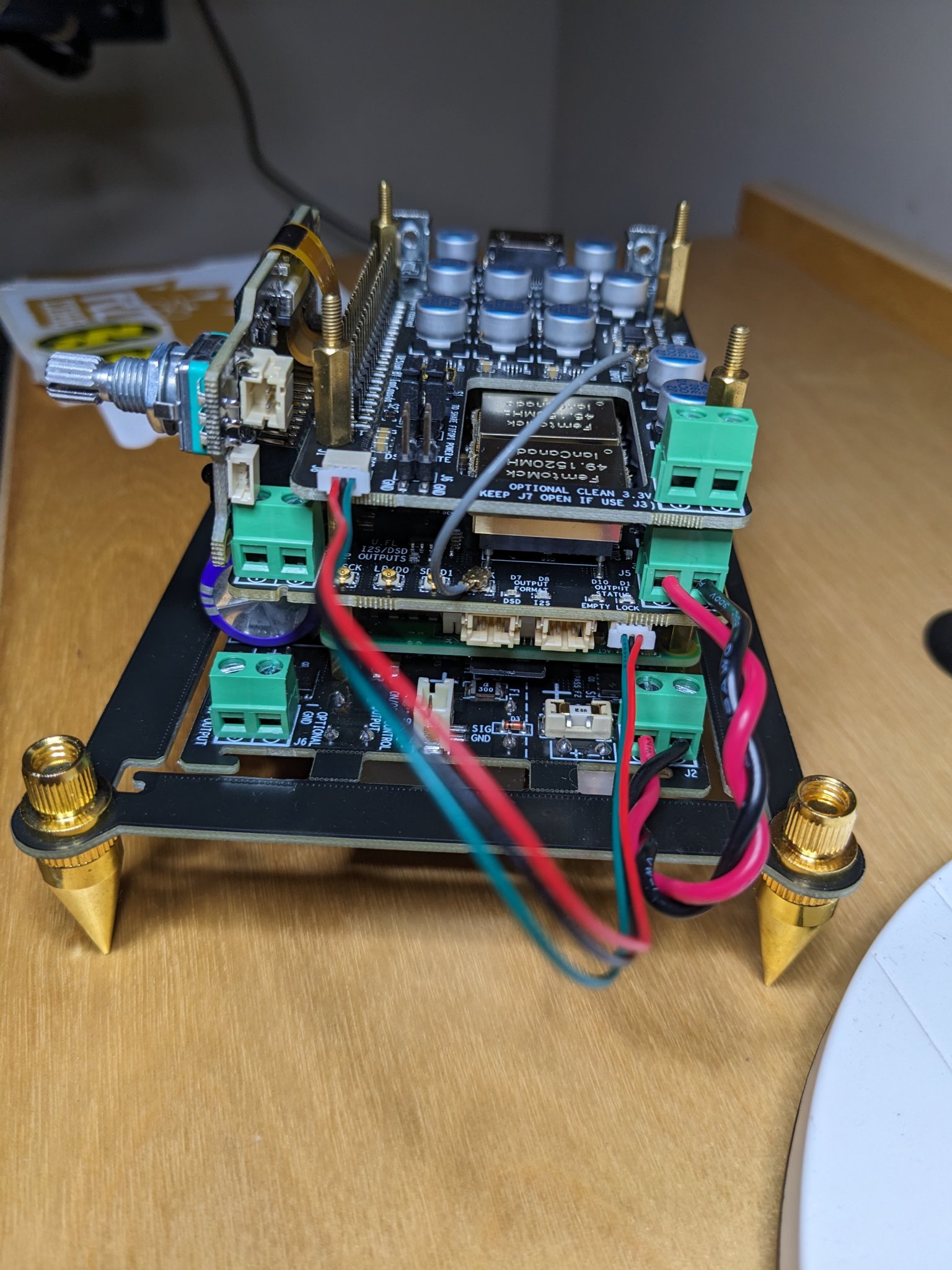

For the time being I resolved it as you can see in the attached pictures.
When I rebuild my current dac housing I probably solder them directly on the Q7
View attachment 1269386 View attachment 1269387 View attachment 1269388

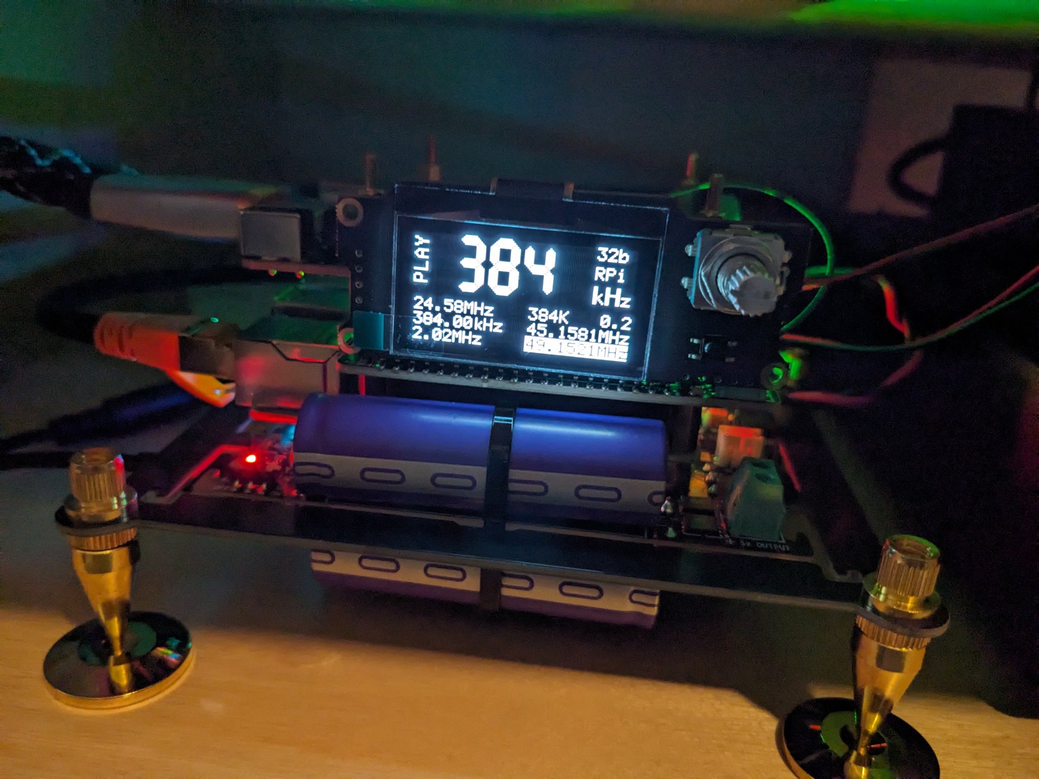

But I think I need some soft/mild plastic cable ties (the hard ones maybe damage the clocks). How is yours?
What is that white plastic between the clocks?

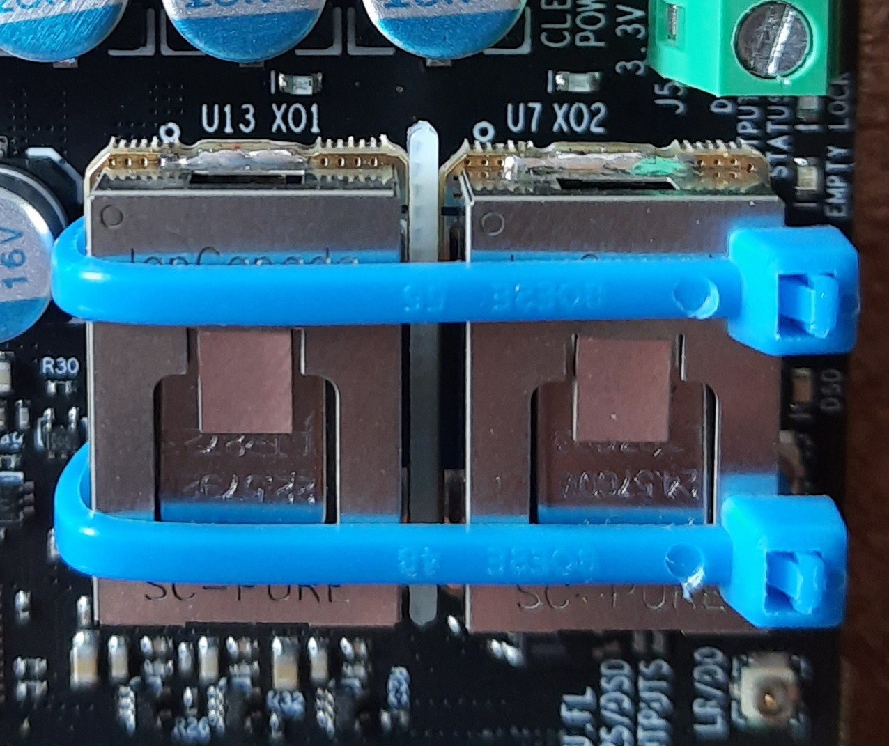

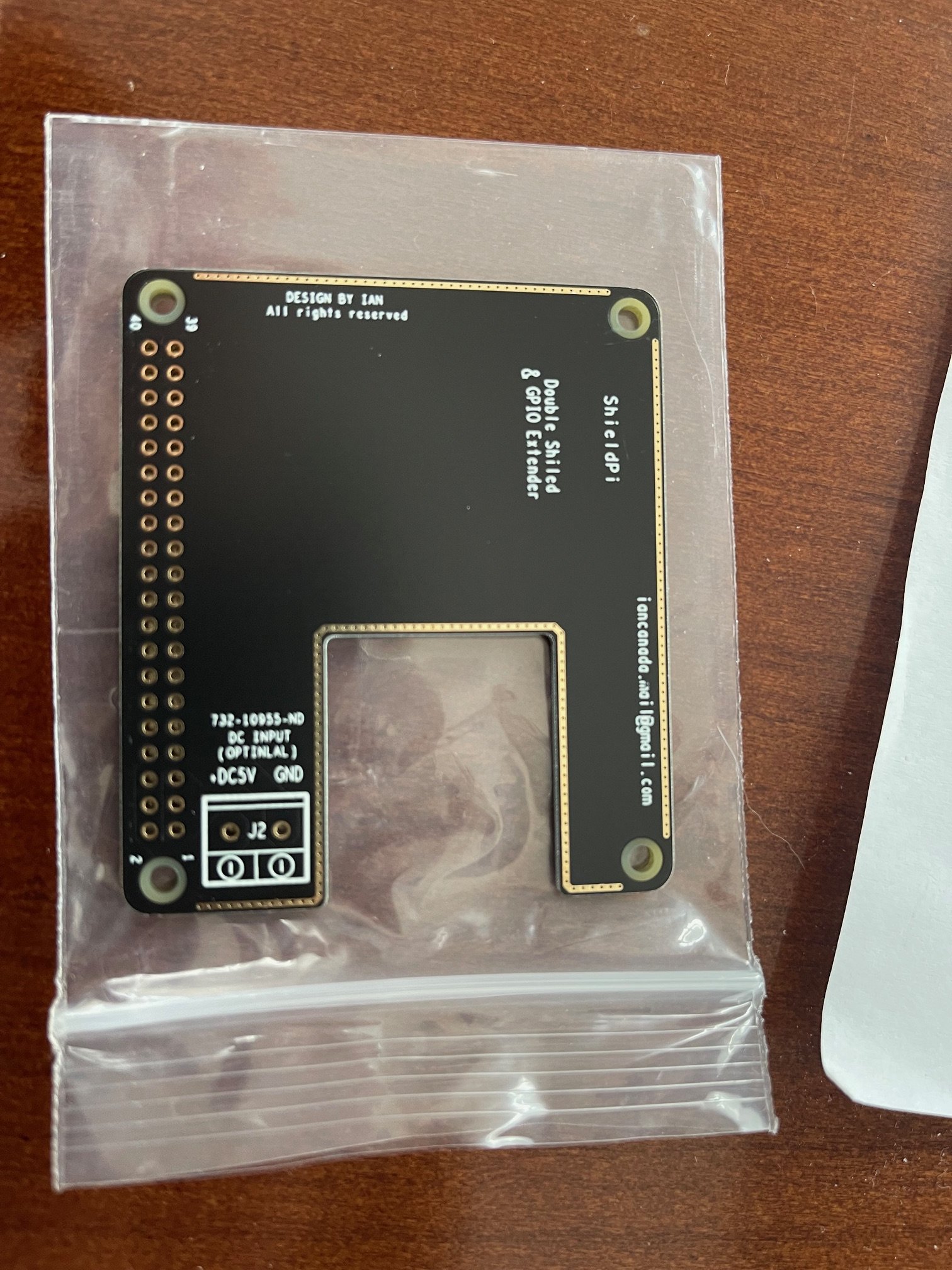

Maybe I could use this "ShieldPi" between HDMIPiPRO and TransportPiAES, but I think I need some GPIO extenders/spacers ???Any ideas how to use a anti-vibrating material on top of the clocks just to hold them a bit pressed on the Q7 sockets and to provide anti-vibration solution? As you see in the pictures, above the Q7 I have HDMIPiPRO and TransportPiAES.
The white plastic between the clocks is a piece of cable tie to keep the clocks straight when pulling the cable tie down.Thank you, maybe I will do the same.
If you think the cable tie is to hard you can soften them a bit in hot water or use a hairdryer, to be on the safe side, do this before you tie them down
I've had no problems to tie them down.

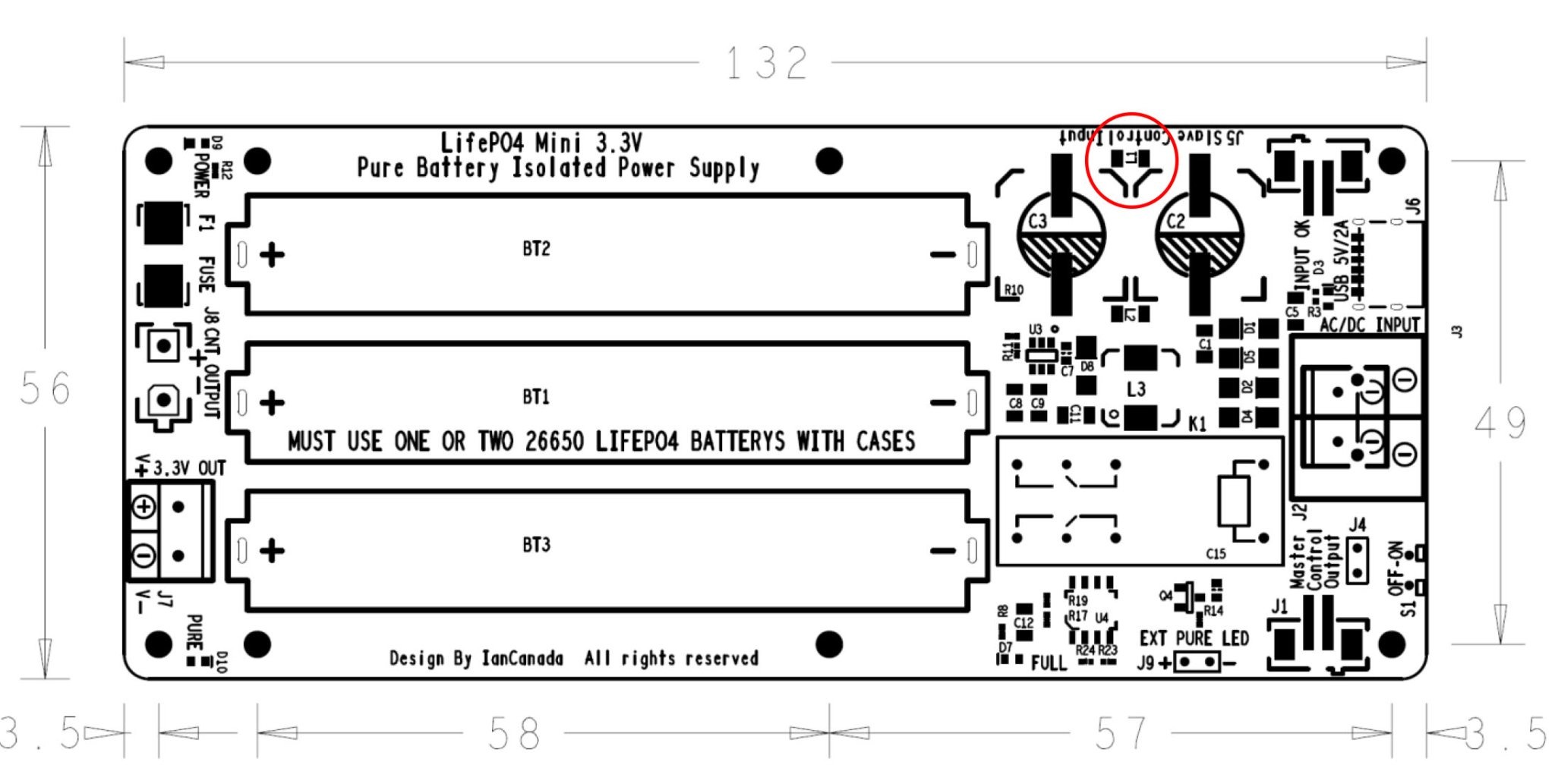

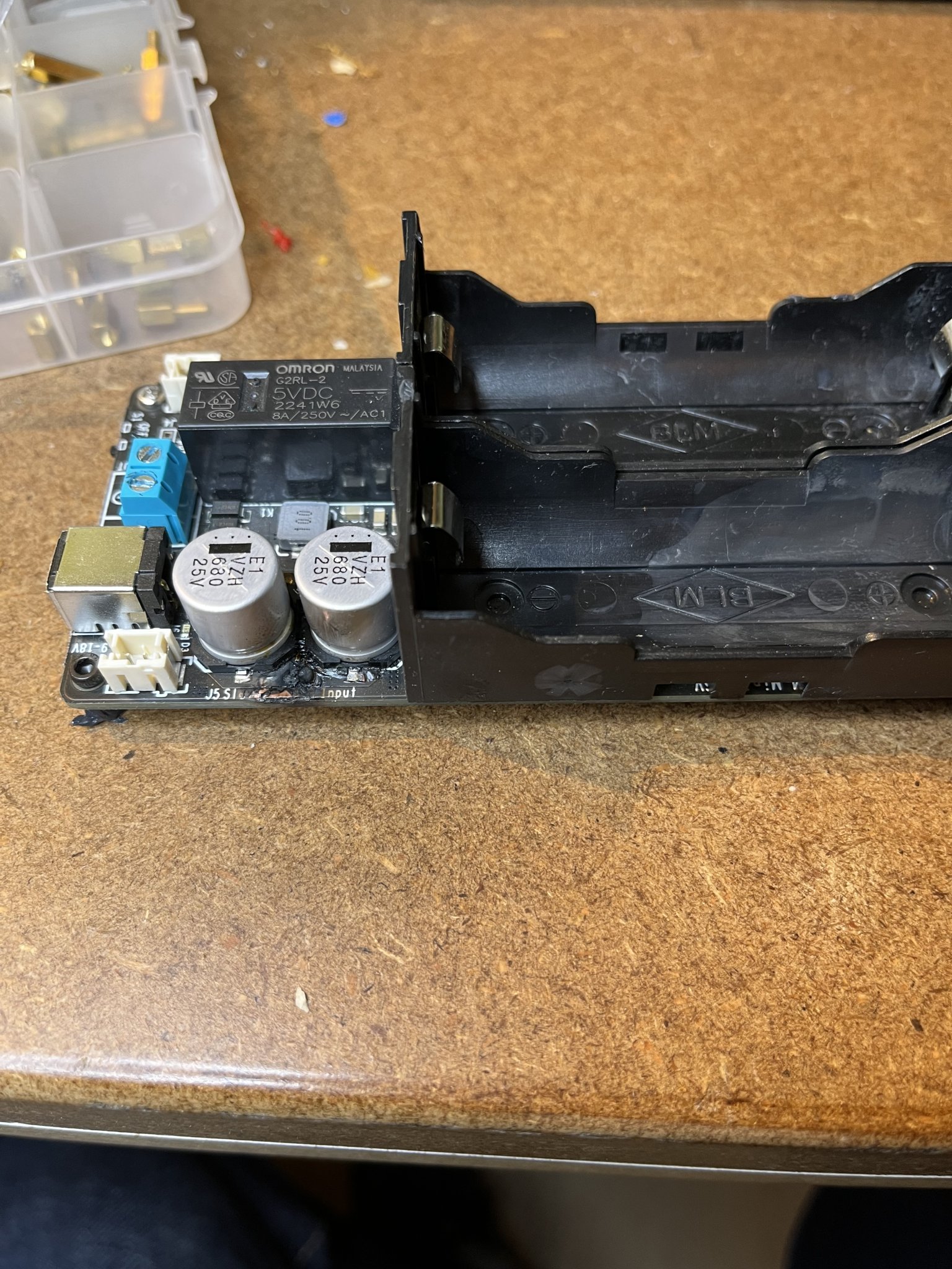

I just had a problem with a lifepo mini 6.6v.
I'm using 2x6.6v liepo mini + 1x3.3v Lifepo mini in series to power 2 andreas clocks.
the 3 lifepo mini are powered in ac 2x9v 1x5v.
Everything was working good for 2 days, but this morning: black smoke...
Looking inside, a small element L1 burned near j5 , please see pictures.
the board still shows input power led and output power led but no more pure led nor full charge.
Do you have an idea of what happened? and what can be the cause of this burning?
Thank you for your help.

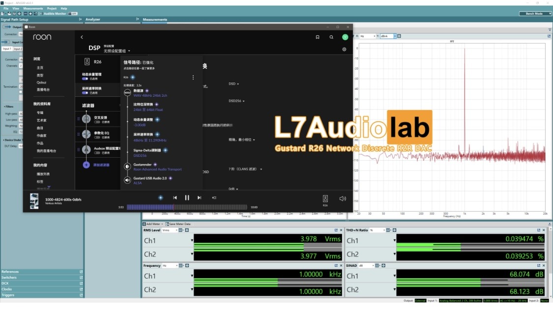

On Gustard R26 - NOS & DSD direct ON
LAN - DSD 2.82m
I2S - PCM 384k with or without small cable Roon and Volumino
USB- DSD 24.5m
On Gustard R26 - NOS & DSD direct OFF
LAN - DSD 2.82m
USB- DSD 24.5m
With your discussion with @camrector Is PCM 384k what should be displayed?
With the R26 configured with NOS & DSD direct ON does the FifoPiQ7 clocks take control of the timing?
Thanks - Dave

@dcallende did you change the setting in Roon to DSD over DoP?
R26 should display DSD if it is recieving dsd.
On the R26 with DSD direct off the signal is converted to PCM. Even if the screen says DSD
It is still PCM.
It is still PCM.

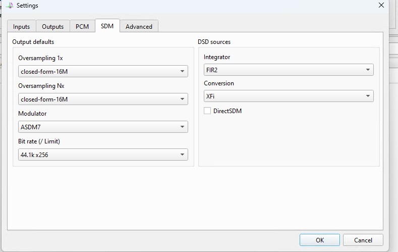

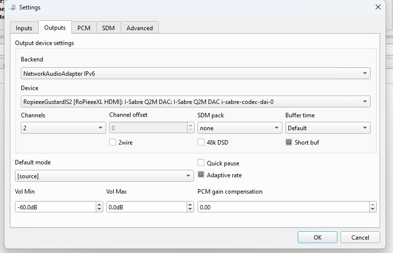

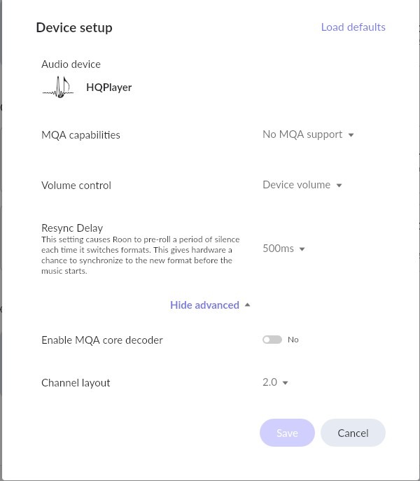

@camrector - No I did not. Switched. Now I see DSD64 on the 93B monitor and DSD 2.82m on the R26 display. This is with NOS/ DSD Direct ON. I am not aware of the DSD conventions what is DSD64 (Ripped SACD files) vs DSD 2.82?
Next step is using HQPlayer to work same way as Roon Direct. In the HQPlayer in Roon there is not the ability to set DSD over DoP in Device setup

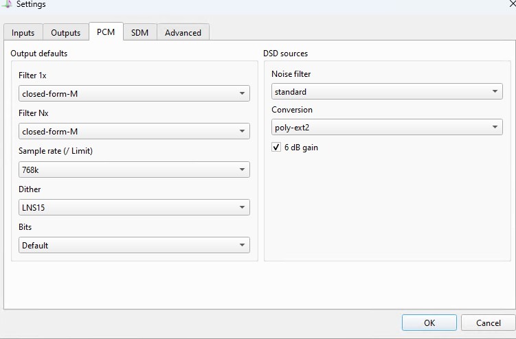

If you use HQPlayer do you know the settings i should change? Below are my settings in HQPlayer and Roon

You should be all good. Pick what filters and upsampling you want. Again I’m new to the Ian Canada / RPI stuff so I don’t know max sample rate etc etc.

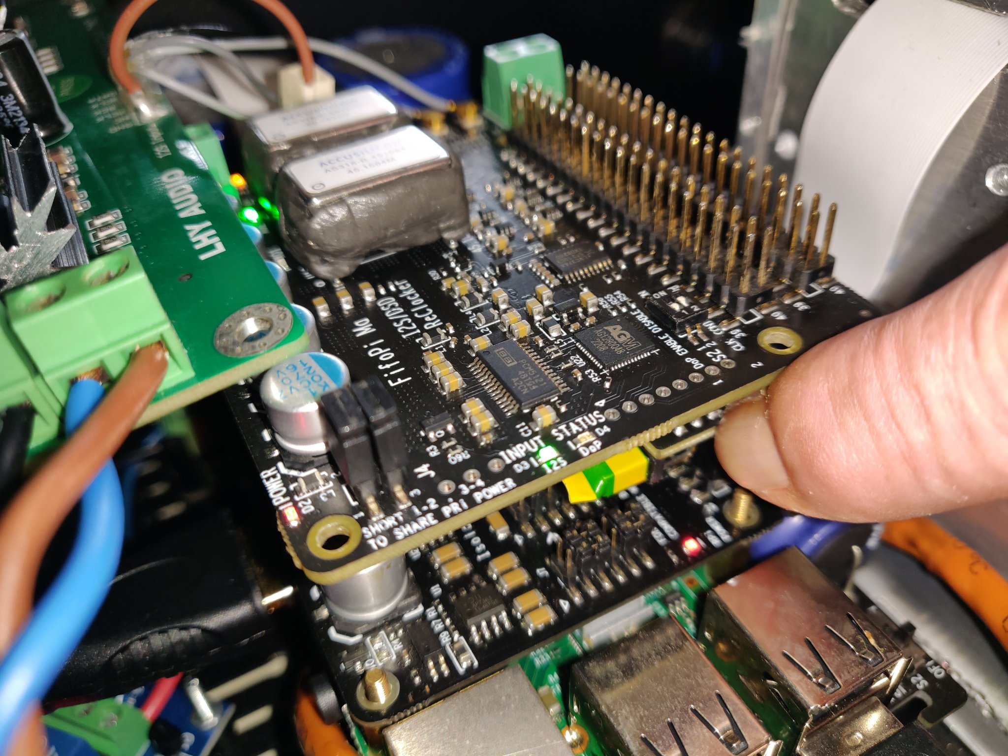

Thanks for the info. I hope I hooked up the cable properly (See attached photo). With some help of others got it working. Checked with both Roon and Volumino. It initially worked. Now it does not Rebooted with PoPieee not working. The monitor is displaying is rapidly going back and forth of the lower right two items (45 & 49). See the attached two displays. Have I destroyed the two clocks by not properly attaching the small cable?
Dave
Dave

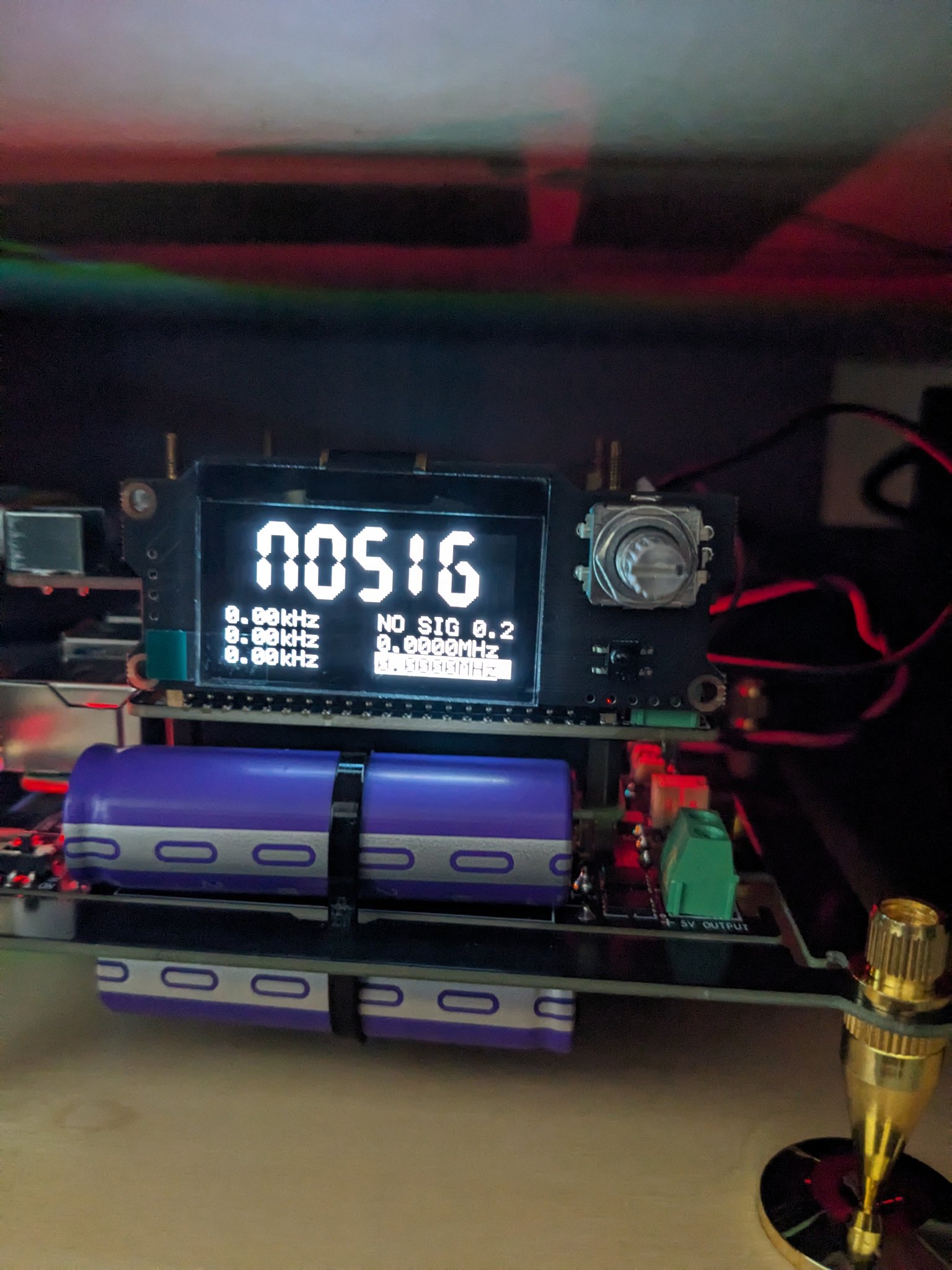

MonitorPi is a great tool to debug the system. It tells everything. The troubleshoot will be very easy if you make use of it.
Showing the XO frequencies zero means there are no clock signals. Mostly is the Q7 3.3V power supply issue unless you damaged the two XOs.
Please fix the issue if there is no 3.3V.
Ian
