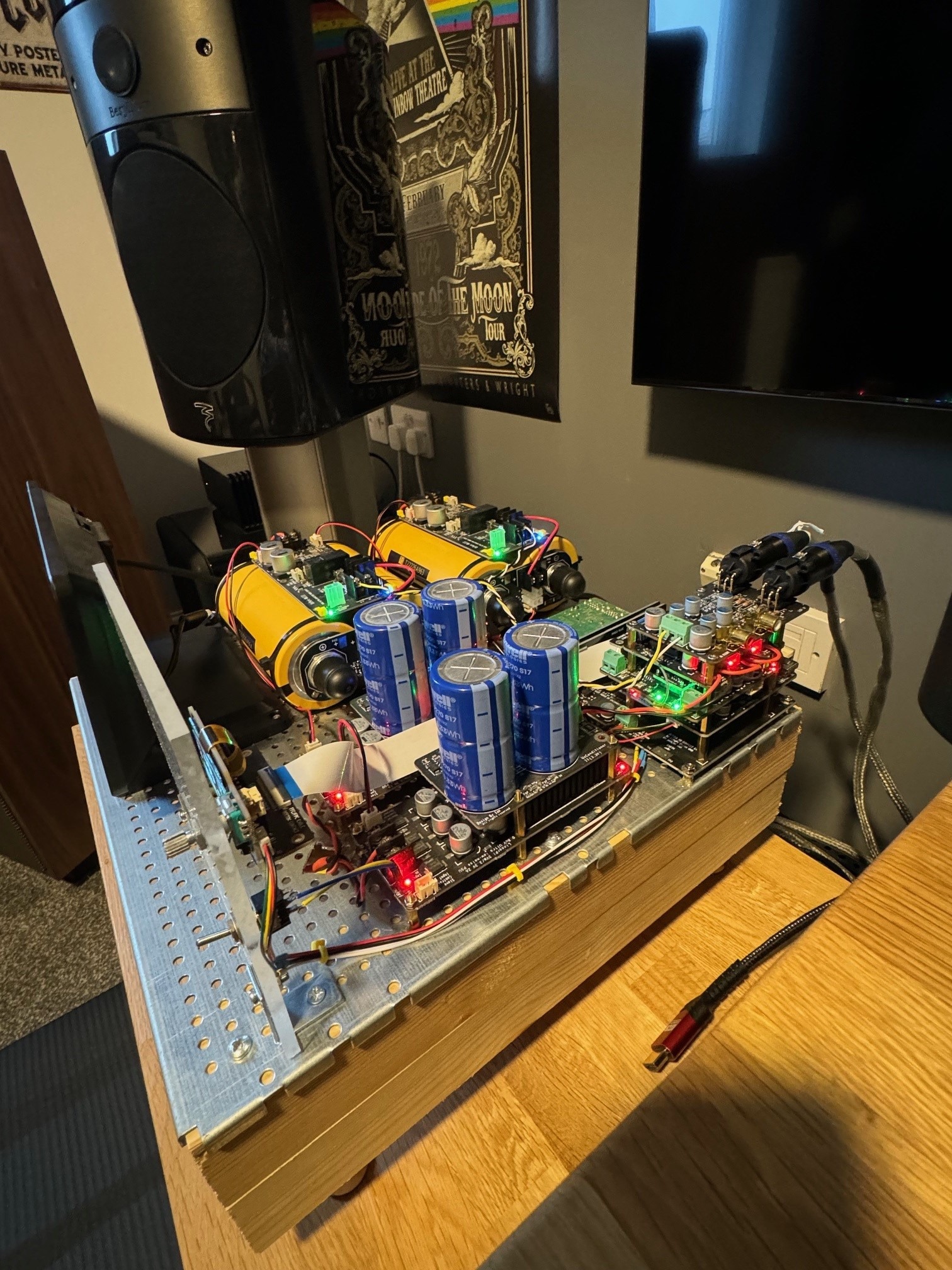

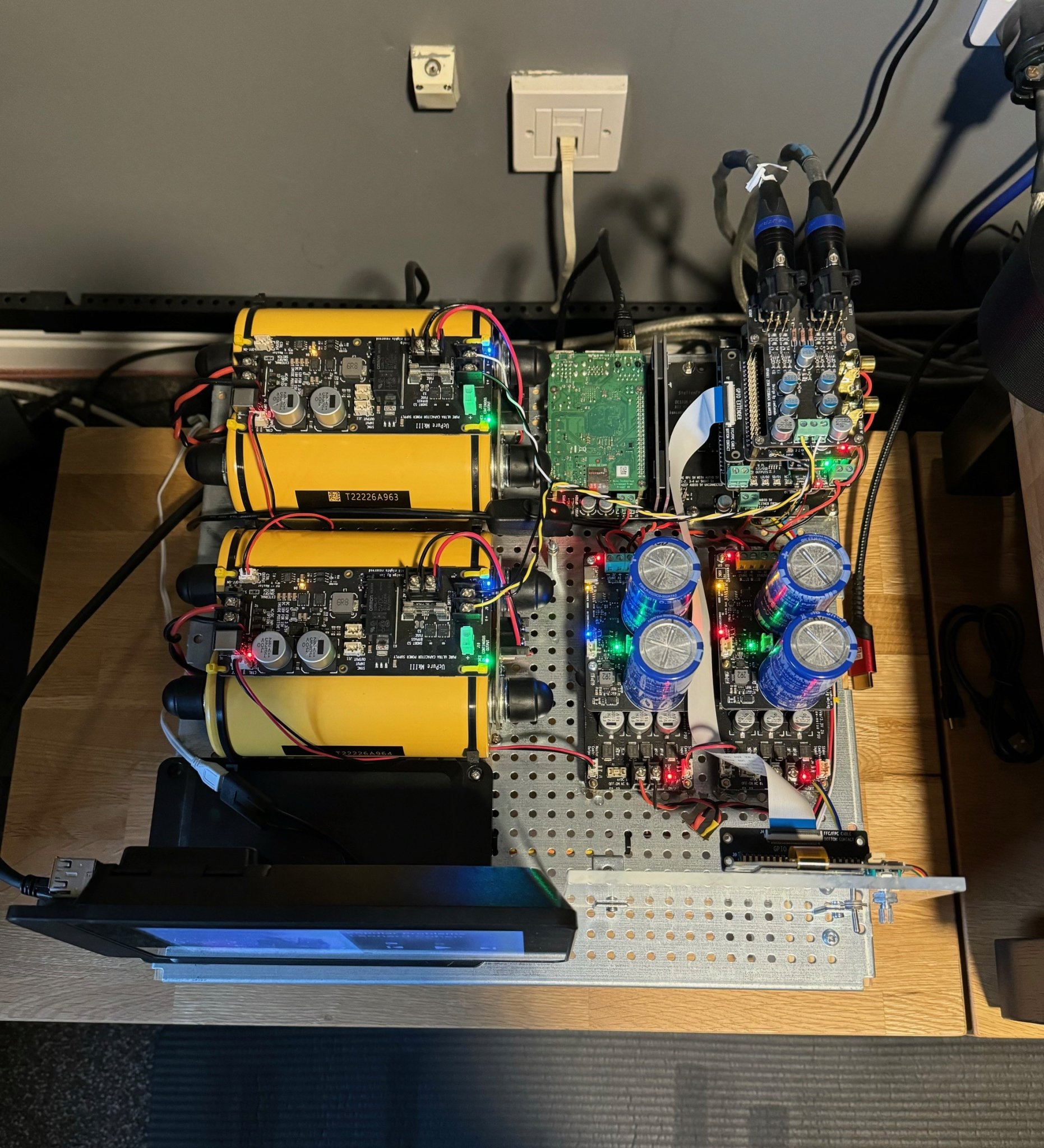

I started my Ian DAC build with the simple purepi/Q7/ ess/OPA861(powered with 2 ifi 5V switchers) and it sounds great and very little soldering.
That give a chance for soldering practice and sound step ups later once the right skills are in place.
I’ve added some LIFPO Mini 3.3v and Linearpi duo to the mix on my build. Also 2 x5V and 2x 3.3V
I’ll give an update on that later on the sound.

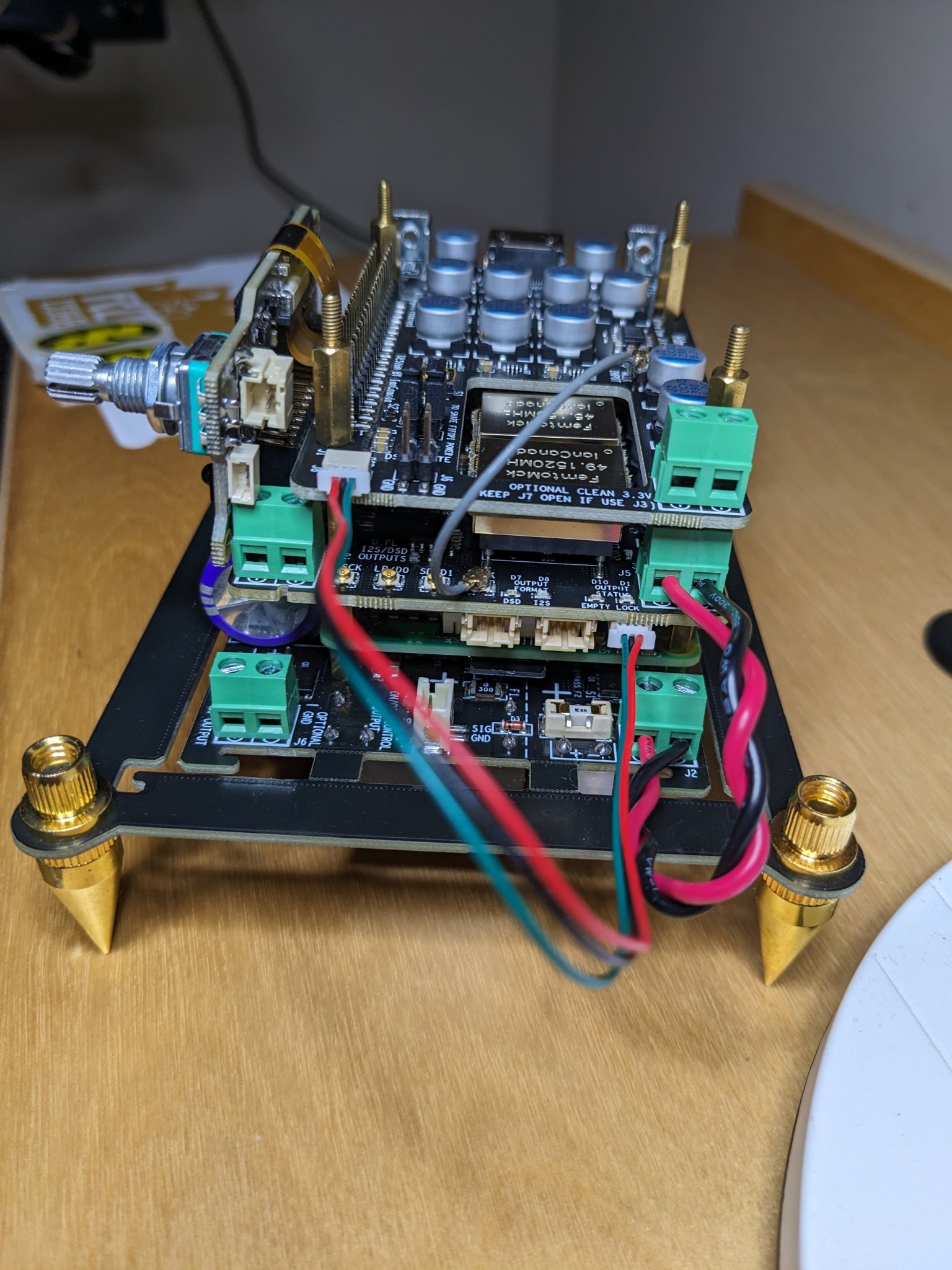

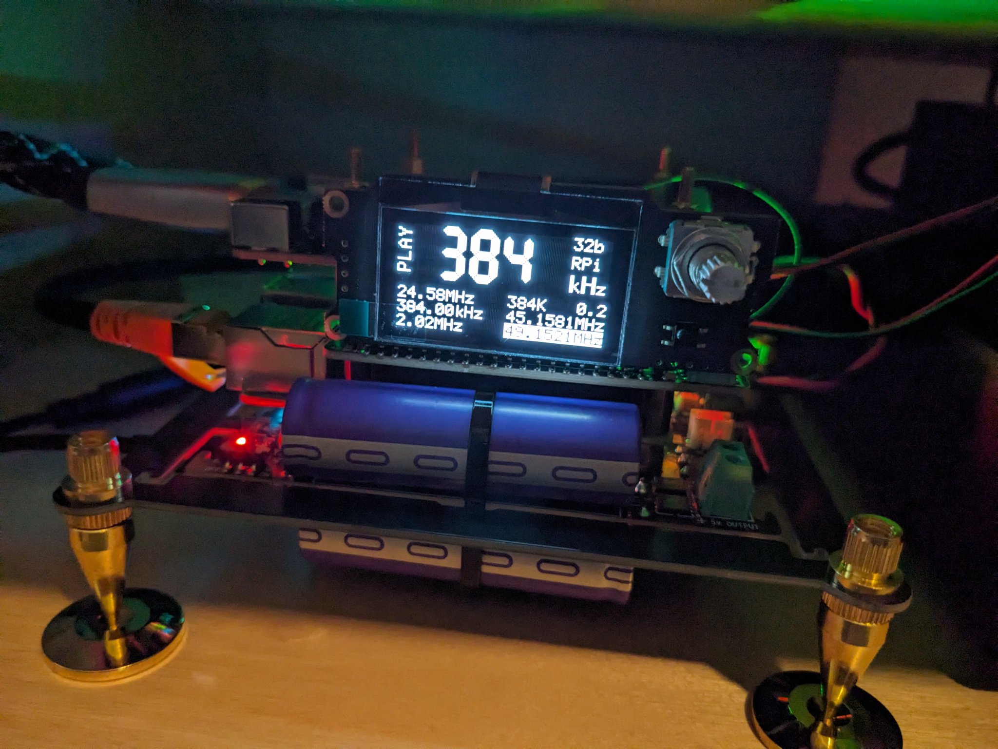

IanCanada DDC/Streamer integration with Gustard R26, Roon and HQPlayer
This is a quick synopsis of what I did to set up a IanCanada’s / Gabster DCC Streamer into a Roon / HQPlayer / Gustard R26 system ( I will call this “Complete Integration”). What I have written is cryptic, but I hope it is good enough to guide another novice like me to have success.
Motivation and how to assemble the IanCanada “Flagship Re-Clocker Streamer Kit (#93B):
https://iancanada.ca/products/flags...rk-music-streamer-kits?variant=47606889185580
Motivation was Gabster video:
@iancanada , @camrector , @crossride were extremely helpful to a successful conclusion of my “Complete Integration”. I am starting my journey with only the experience of running a Raspberry Pi with Ropieee as an endpoint in Roon and very basic knowledge of HQPlayer.
I have uploaded a bunch of images that are not well organized but could be helpful to understand the integration.
There are three main focuses to the Complete Integration”
Configuration adjustments between #93B and the R26
Hardware changes / settings

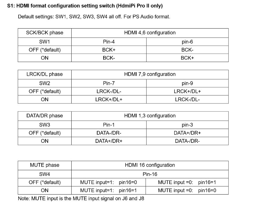

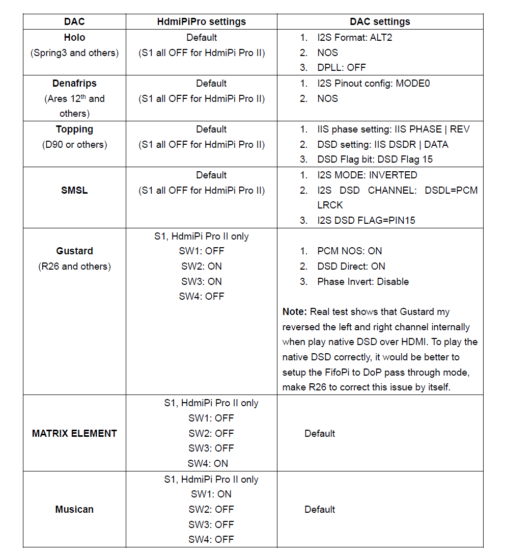

#93B
Switch change on HdmiPI Pro II - Remove thin film over switches
SW1: OFF
SW2: ON
SW3: ON
SW4: OFF

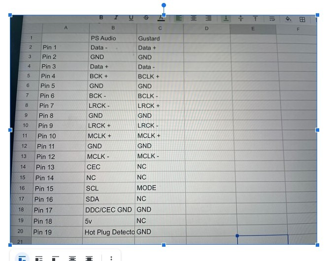

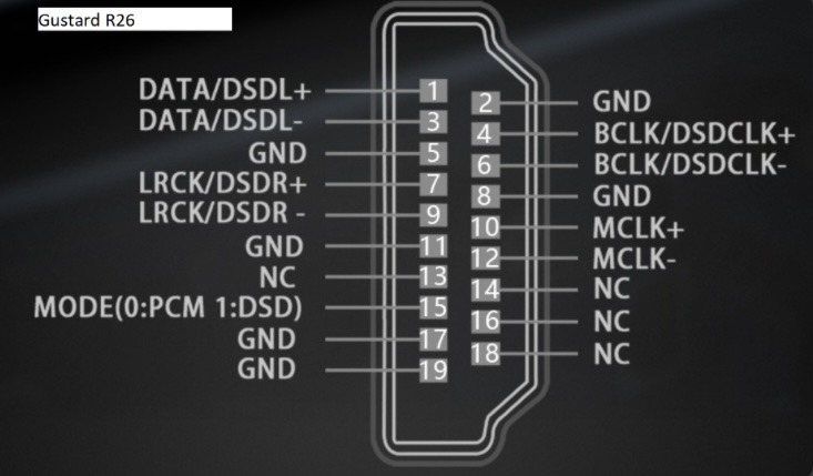

Configuration change on FifoPi Q7II
Using #49 MonitorPi Pro set FifoPi to Dop Pass through mode
Small cable connection between FifoPi Q7II (Q7) and HdmiPi Pro II. which can pass the DSDEN signal to Pin15.

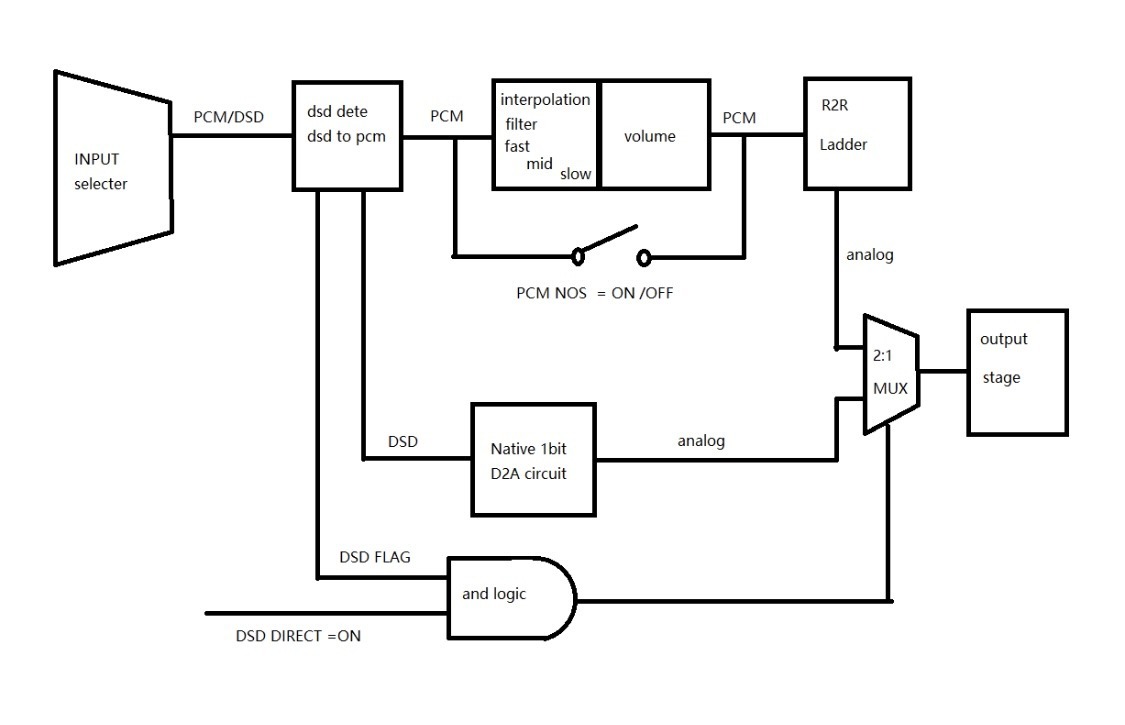

Gustard R26
Setting Changes
PCM NOS: ON
DSD Direct: ON
Phase Invert: Disabled

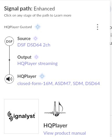

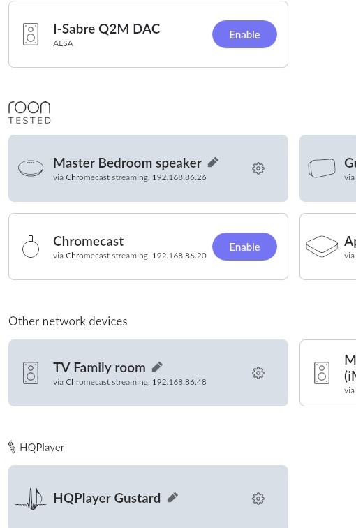

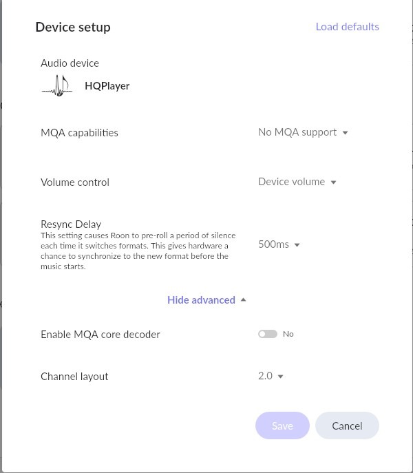

Roon and HQPlayer software settings
Roon setup Without integration of Roon
Roon
Go to Device setup of your Ropieee endpoint and configure DSD playback to DSD over PCM
Ropieee
Hat Configuration - Audiophonics I-Sabre ES90*8Q2M
Setup with HQPlayer integrated with Roon
Roon
Disable Roon endpoint that is being used for HQPlayer. This is to avoid conflicts with HQPlayer

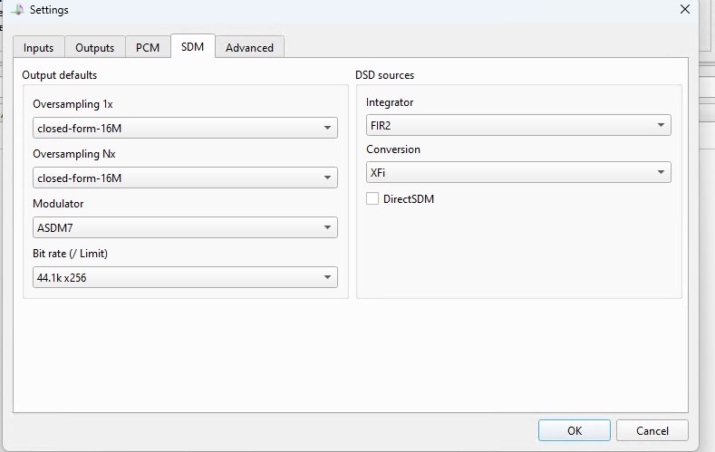

HQPlayer Settings
Output Page
Set device to your RoPieee endpoint
Set SDM pack to DoP
SDM Page
DSD sources / check DirectSDM
Things to be aware of and have.
If you have issues, document all the systematic changes you make. Going from streaming source to your preamp with this setup is a complex system. Until I started documenting changes progress was hit or miss.
For troubleshooting of the “Complete Integration” it is handy to have a 2nd Raspberry Pi and Volumino software available
No need to get a customized HDMI cable to work as your I2S cable
Understand what the LED lights are on the FifoPiQ7II
Order batteries from Ian Canada. Adding batteries to the order adds $8 to the shipping, but if you order anywhere else the shipping for the batteries will be over $20.
#93B
SW1: OFF
SW2: ON
SW3: ON
SW4: OFF
Gustard R26
Setting Changes
PCM NOS: ON
DSD Direct: ON
