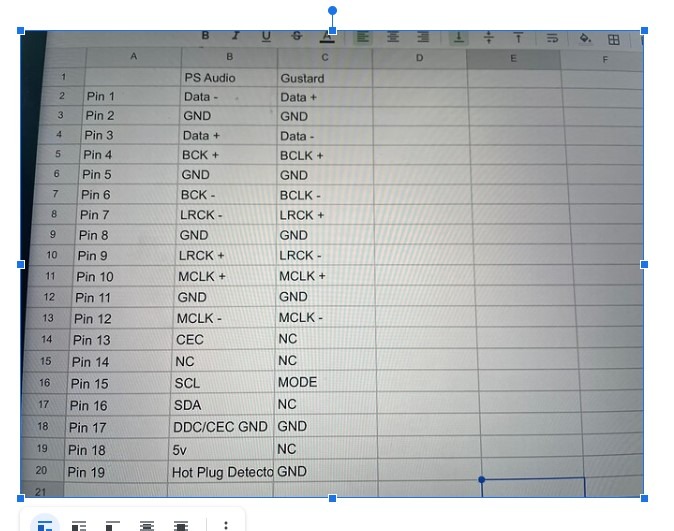

I was using this chart to configure the pins that can be changed with the Switches. I see that the 15 pin is SCL (PS Audio) vs Mode (Gustard) . I don't see the corresponding pin on the Gustard. As you went down this rabbit hole was the conclusion that all the pins needed to correspond? It looks like PS Audio has these pins that do not correspond to any pin on the Gustard:
Pin 13 CEC
Pin 15 SCL
Pin 16 SDA
Pin 17 DDC/CEC GND - Gustard has GND
Pin 18 5v.
Pin 19 Hot Plug Detected
What streamer were you trying to make work? Did you make a custom HDMI cable? Looking at the image are there pins on the Gustard that correspond to any of the pins I listed above?

For Ian's gear use Ian's i2s pinout from his manuals...

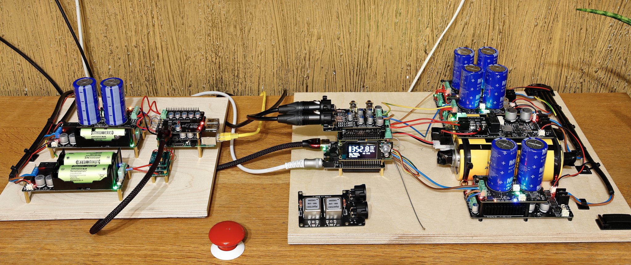

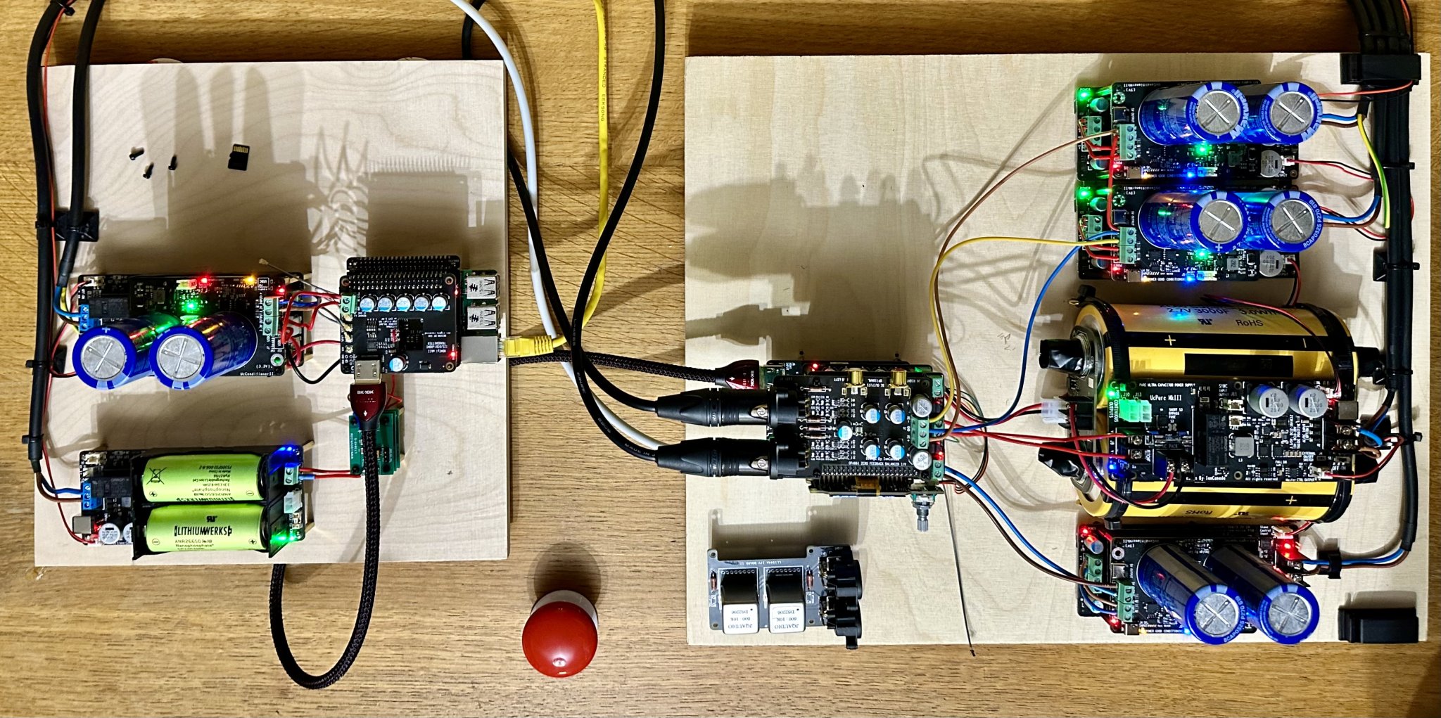

Hello, I am sharing my new setup, which consists of two separate stacks: a steamer and Dac with Fifo connected by I2S over HDMI.
Streamer
RaspberryPi3 - powered by LifePO4 6,6V regulated to 5V, 3,3V, and 1.8V through dedicated regulators from www.ldovr.com (original regulators on the RPi board have been desoldered)
IsolatorPi II + HDMIpi MKII - powered by LifePO4 3,3V + UcConditioner 3,3V
DAC
ReceiverPi DDC - powered by LinearPi 5V + UcConditioner 5V
FifoPi Q7 + MonitorPi Pro + SC-Pure clocks - powered by UcPure MKIII 3,3V (Continuous Output)
Dual Mono MKII DAC - shares UcPure with FifoPi Q7 (Switched Output)
OPA861 I/V Stage - powered by LinearPi MKII Dual + 2xUcConditioner 5V
Each power supply runs on a dedicated winding from a transformer. In total, three toroidal transformers with double windings, plus a little one regulated to 5V, which is for Master Control. Power supplies are constantly connected to AC power and switched ON via Master Control.
Over time, I have gone through various DACs: S.M.S.L SU-9 Pro, Topping D90SE, Denafrips Ares 12TH, and several older chips in DIY setups like TDA1543, AD1865, and AK4493. My last ready-made DAC was Gustard A26, which was quite decent. I felt that, overall, it was better than all I had used before. But later on, I got better sound with an old AK4493 run from LifePO4/LinearPi/UcConditioner supplied with I2S through an isolated connection from the JLSounds board with Crystek CCHD-957 clocks and run from LifePO4 power supply. So, I decided to try the DIY approach with Ian Canada parts.
How does this setup sound in my system? Initially, I was not impressed at all. It sounded just OK. I have spent some time double-checking everything and ensuring DAC settings follow Ian's recommendations (TrueSync, DPLL). No improvement. Now, it is 72h since the SC-Pure clocks have been powered up, and I have to admit that things are very different today. I can hear a significant improvement between yesterday and today. It is not subtle. I started to appreciate how it sounds. It is unlike anything I have used before. The sound is full of culture in its character. Nothing is exaggerated yet at the same time, there is plenty of details and good separation. I still feel there is a little lack of spaciousness of the scene and dynamics in low frequencies, but I try to remain patient waiting until things stabilise.
One thing that was very noticeable was when I changed the power supply for FifoPI Q7 from LifePO4+UcConditioner to UcPure. UcPure does provide an improvement which, to me was so significant that is worth the burden of having such a monster.
Marcin
