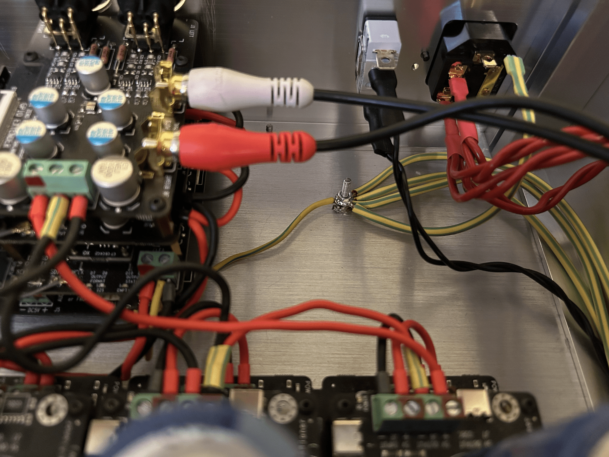

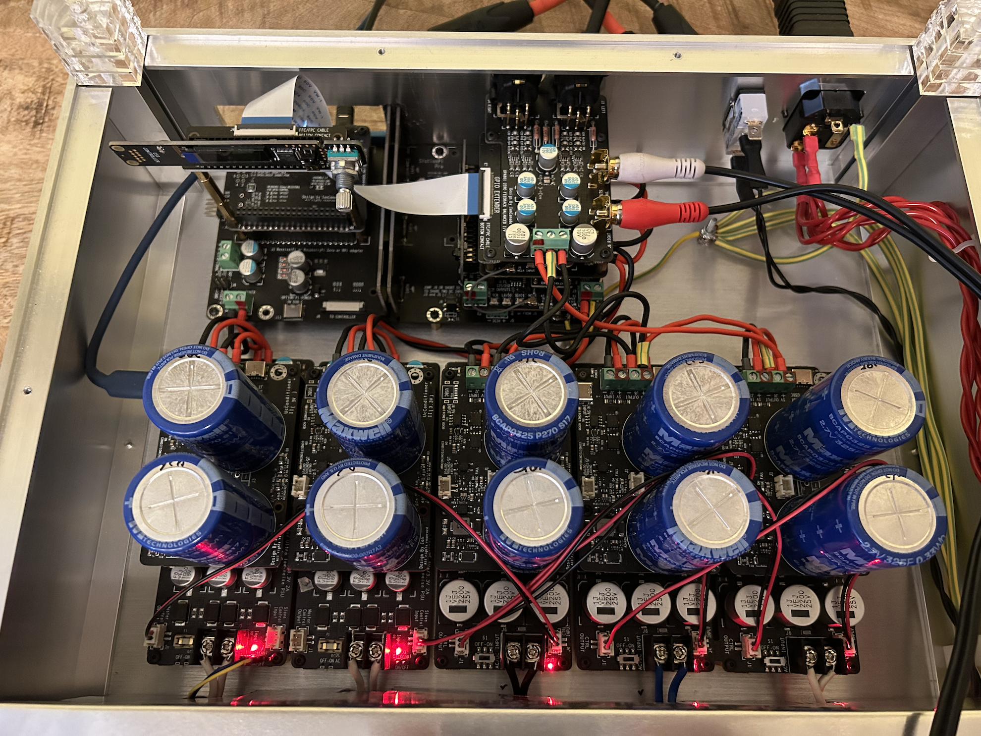

Hi all. I'm posting here to seek some help with two of my Ian Canada builds. I've built one stack for myself and one for a friend of mine. Currently experiencing 2 somewhat different issues.
I've attached 2 pics of the build, but I'm using 3 toroidal tansformers from toroidy (all with 2 secondaries, one sec for each linearpi) 9V 60VAC, linear pi with ucconditioner (2 of them in series to power the opa861), station pi, fifo pi q7.
- from fifopi is connected to station pi gnd and from there to the chassis on the star connection. All transformers gnd is connected to the same star point and IEC the same. I've attached a pic for visual.
1. My problem:
Whenever I plug in the stack to the wall outlet, the DC6 output leds are flashing on the linear supplies. On all 5. Not a biggie, but wanted to see if there's a way to avoid that or if it's normal. There's no power on switch other than the one controlling the on/off on the linear pi.
I have tried simulating an on/off switch by using an extension socket that has one. Same result. Maybe a slow start would help? Or something else?
2. My friend's problem, big problem:
First, an important note --> his ac wall outlet does not have an earth grounding. More precisely his entire apartment does not have grounding 🙁
With the stack powered off, but plugged in to the outlet (so only the input leds on the linear supplies are on), when he unplugs the XLR cables from one amplifier and then plugs them to a different amplifier (or maybe the same) the output DC6 leds on the linear supplies flash. Not always, not with all amplifiers or preamps (or so he says).
Bigger problem is that sometimes they flash and they all turn off. Even the input ones. And then the supplies don't want to turn on at all. Everything is turned off and doesn't want to turn back on again.
Last time after about 2hours they started working.
Before that he brought the build to my place, I plugged it in and it worked flawlessly. I do have earth grounding.
I have basic understanding of these things, not advanced, but enough to build a Ian stack.
Thank you in advance for any help!

LOL I'm so stupid. I've just realised that on my friend's build I had inverted neutral with ground on the iec plug :headbash:

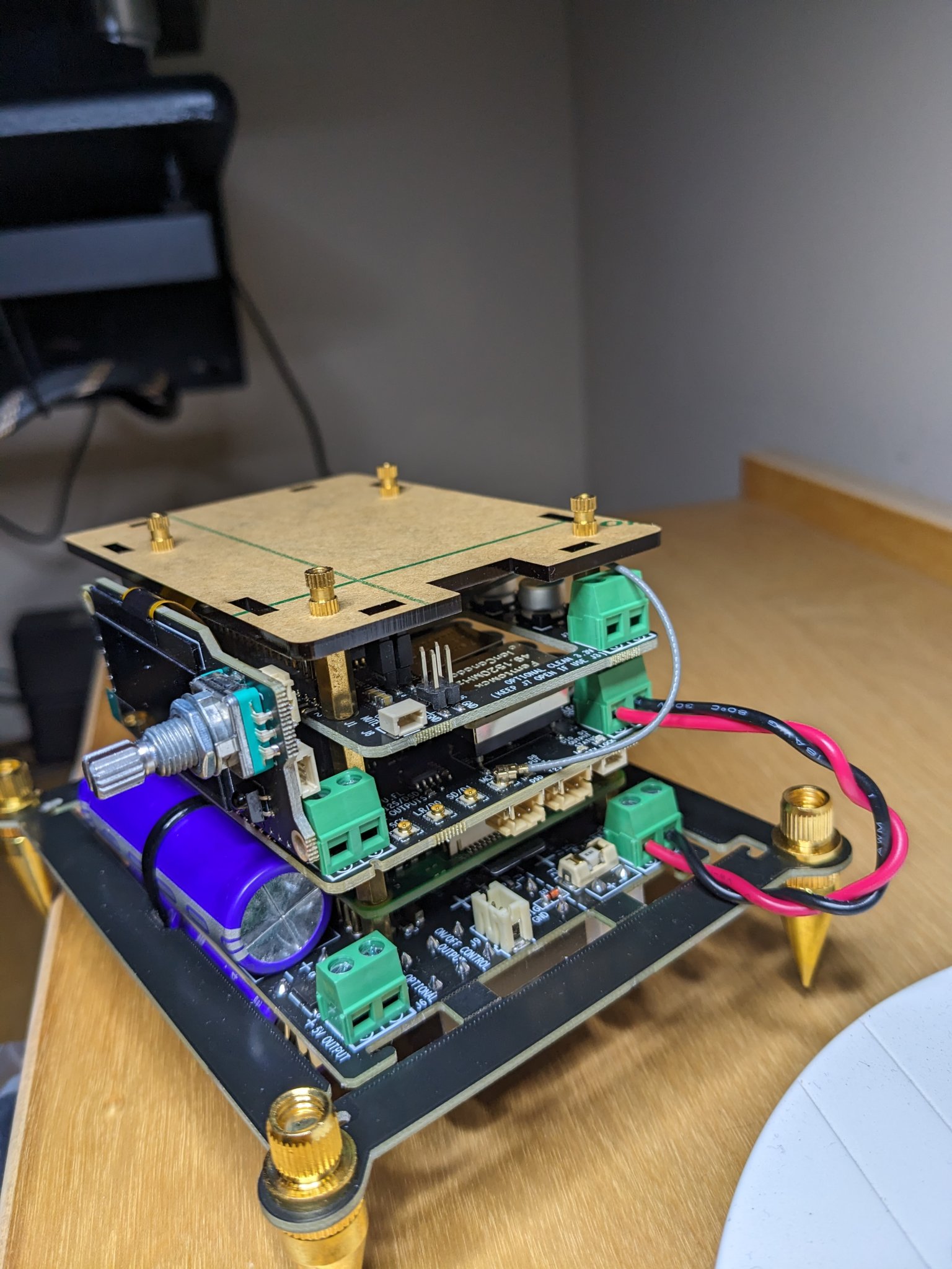

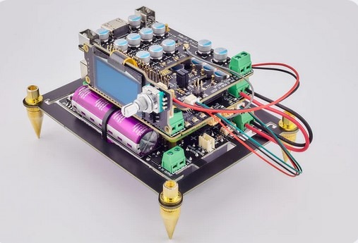

@crossride Thanks again for the time. Double checked and I think the MonitorPi Pro is seated properly.
I put together the iancanada #93B based on the video from Gabster. This morning I realized that he was using a different display (94A vs 94B ). Below are the pictures of the Flagship #93B that is on iancanada website, and the streamer that I assembled. I see multiple power wires in the iancanada. The 93B included a total of 2 power wires. Is this the issue, that I have not installed power to the MonitorPi Pro. If this is the case I have been looking at the documentation and it is not clear to me what location I attach the power wire between the MonitorPi Pro and the rest of the streamer.
Also I see in the image that there is another power wire. Do I need to install that one? If that is the case I don't know what are the two locations to attach the 2nd power wire.
Dave
Hi @dcallende
You monitorPi pro receives power from the GPIO pins and not the two cables attached on the back.
The two cables on back are for mute/SYNC control (send signal when music is paused to change any super capacitor) and the second cable (4 pin) is to control and switch the different inputs on a ReceiverPi Pro II.
On the picture from Ian website I only see one cable from the MonitorPi pro and that looks like the 2 pin mute signal.
There is also a 3 pin cable between the Q7II and the HDMI board.
