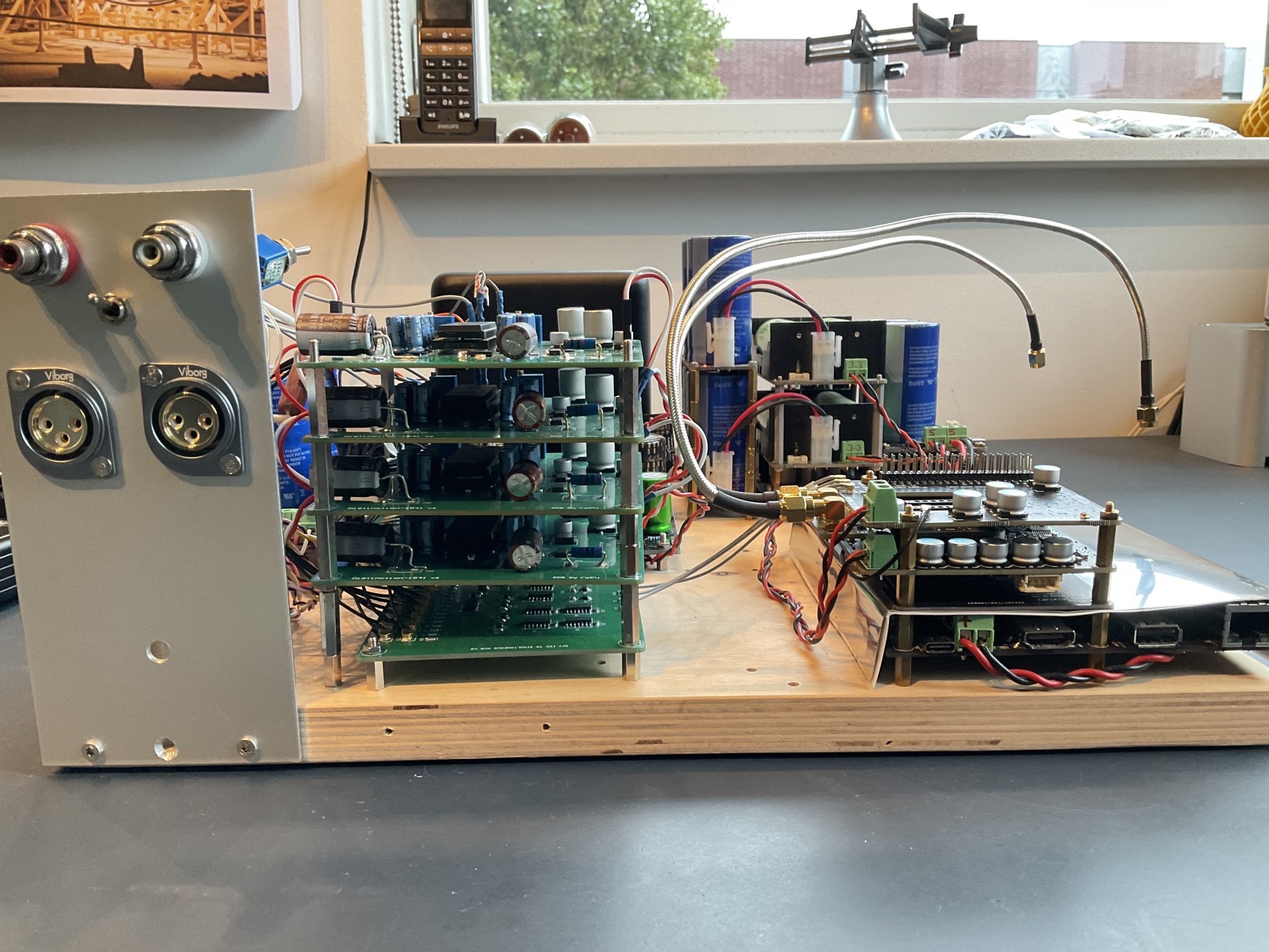

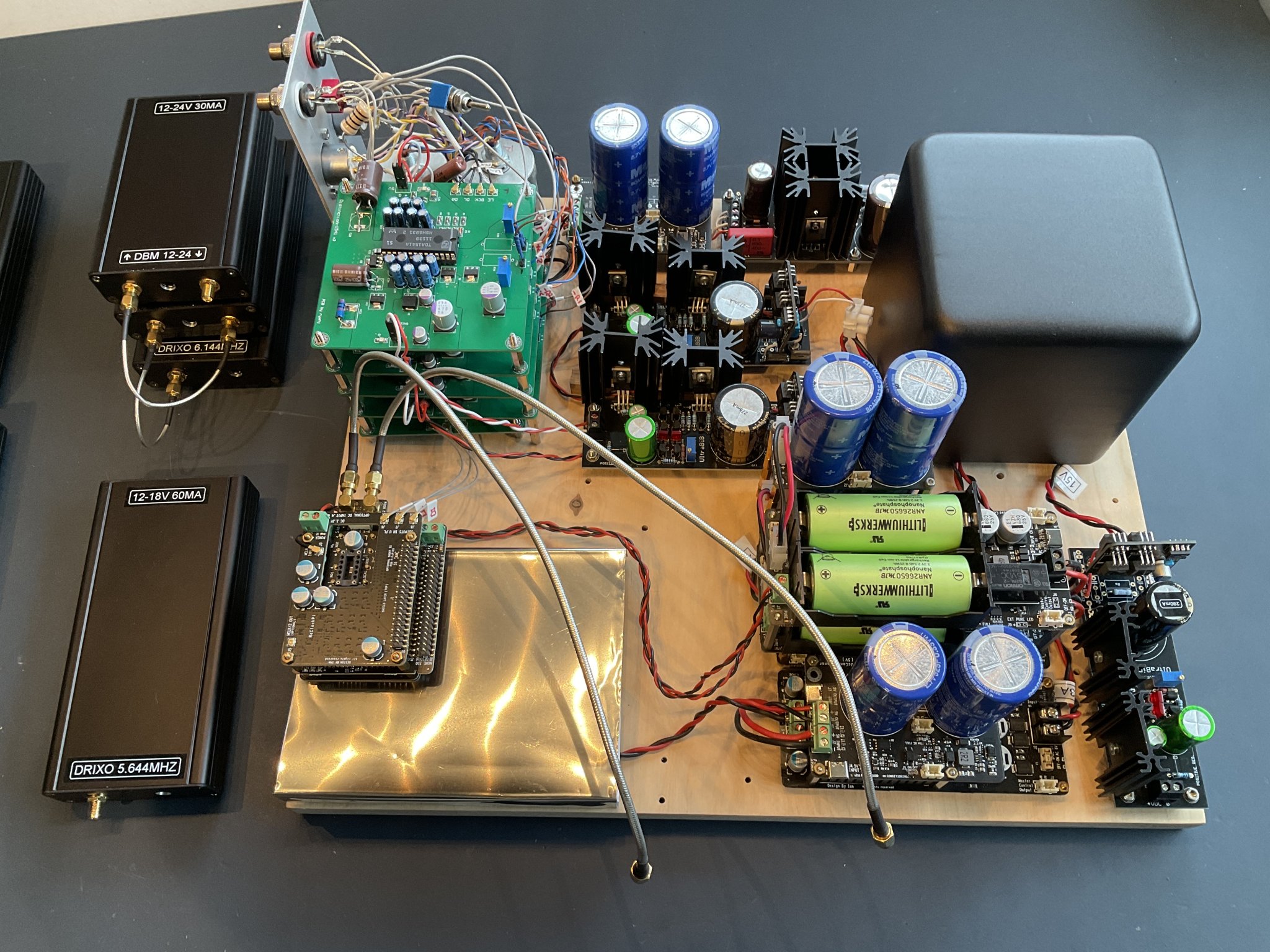

I m using a quad TDA1541A in fact. Based on the very nice design of @ryanj 3D pcb design.
And it is the best dac I have ever built and heard. I have had some quite expensive high-end dacs next to it, with the most expensive being a dCS Vivaldi with master clock unit. The performance of the dCS was quite shameful next to my old Philips dac chips. It was no comparison, the owner of the Vivaldi said within 20sec after start playing that the difference is ridiculously big and I agreed. The focus, naturalness and lifelike experience was much bigger with my diy dac.

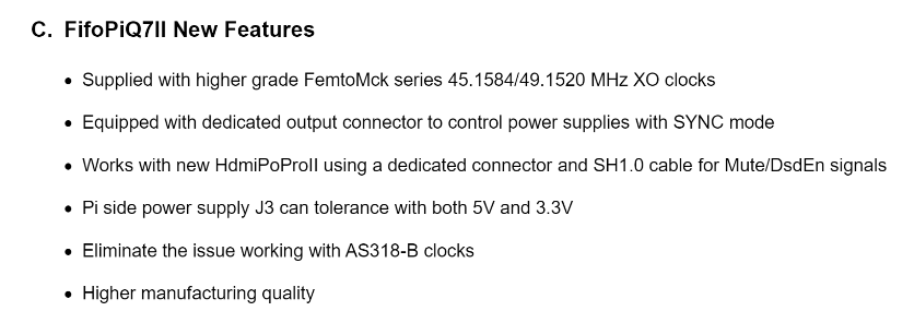

Hello,
I posted a printscreen from Audiophonics website showing there is again another update, the hdmi pi pro mk2.
I still have a new in the box Fifo pi Q7 and i read somewhere that the Q7 mk2 can do something new but only in combination with hdmi pi pro in the mk2.
We don't see any information by the designer here about these new boards. I guess if you still need to buy one of the two mentioned above better get the mk2. If you have an unused or 3 months old without the mk2 in its name you had some bad luck because no one will buy the one without the latest update.
When i am back home i hope to find a complete build here with the Raspberry at a considerable distance from my streamer/ dddac chassis. I have seen builds with Italian clocks at some distance but not the Raspberry. A few days ago i mentioned a potato which would be in a drop in replacement for the audiophile style raspberries 3bplus. Anyone, or everybody busy with coke can caps?
Greetings,Eduard

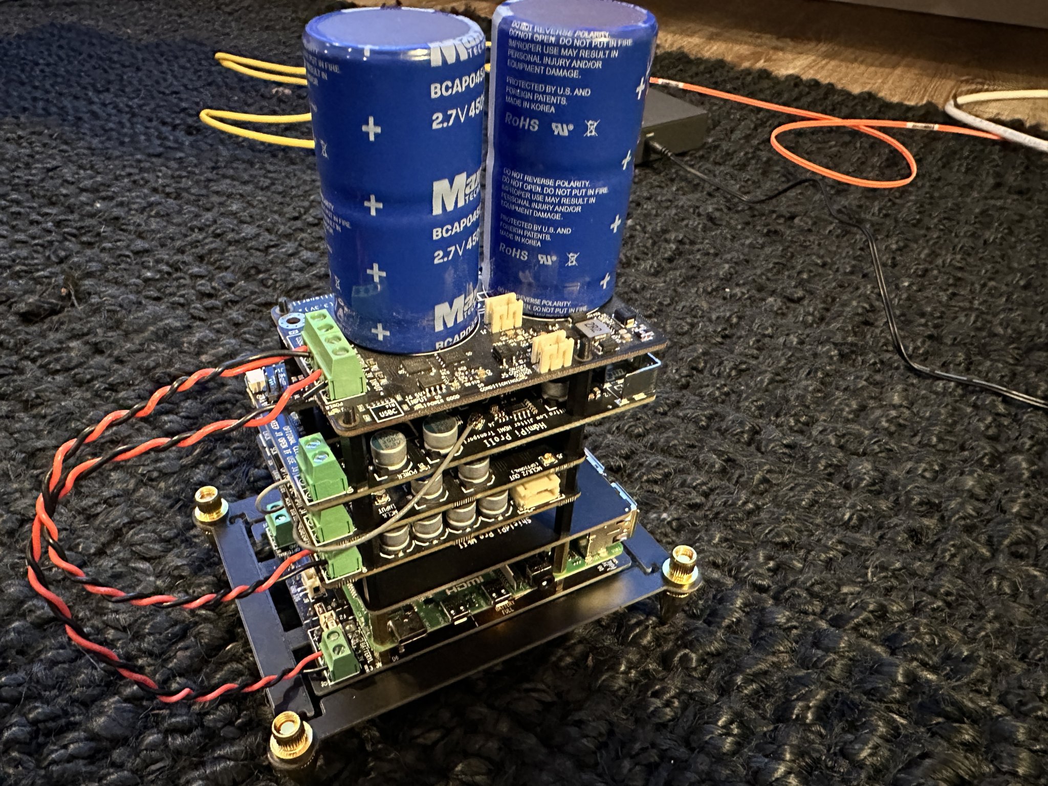

@iancanada I set up the attached streamer with purepi --> rpi4 --> shieldpi --> Q3 (NDK clocks) --> reclockpi --> HDMIpro. Will isolatorpi add any benefit to this streaming stack when feeding a receiverpiDDC --> q7 (SC pure clocks) --> 9038dac hat? If so, where should it be installed? Right below HDMPIpro or lower down, above shieldpi?
Thank you.
