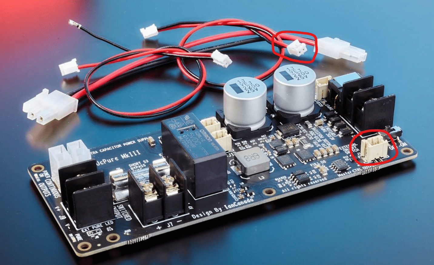

Not sure if this was asked before, but what are these connectors? Mouser/digikey part number anyone?

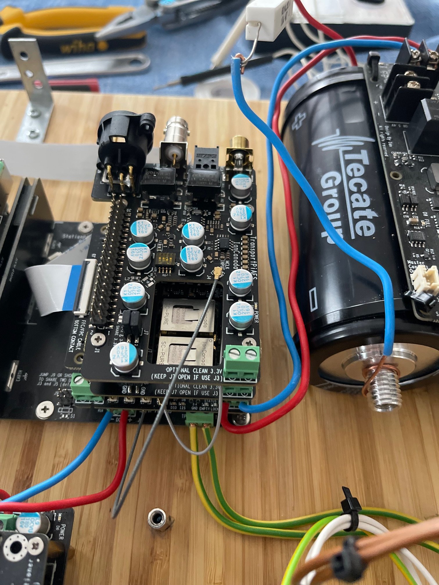

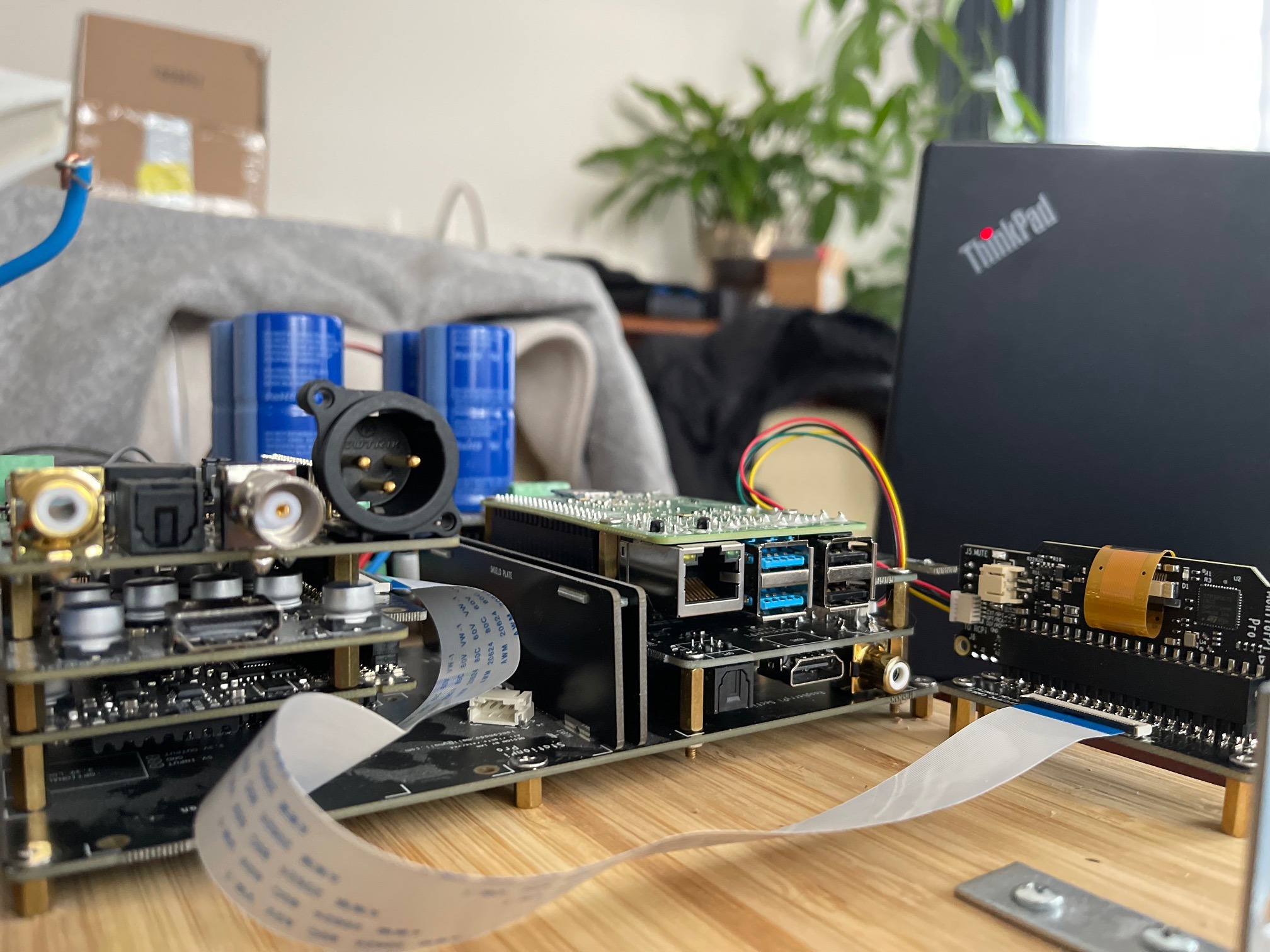

Hi all. I'm posting here to seek some help with two of my Ian Canada builds. I've built one stack for myself and one for a friend of mine. Currently experiencing 2 somewhat different issues.
I've attached 2 pics of the build, but I'm using 3 toroidal tansformers from toroidy (all with 2 secondaries, one sec for each linearpi) 9V 60VAC, linear pi with ucconditioner (2 of them in series to power the opa861), station pi, fifo pi q7.
- from fifopi is connected to station pi gnd and from there to the chassis on the star connection. All transformers gnd is connected to the same star point and IEC the same. I've attached a pic for visual.
1. My problem:
Whenever I plug in the stack to the wall outlet, the DC6 output leds are flashing on the linear supplies. On all 5. Not a biggie, but wanted to see if there's a way to avoid that or if it's normal. There's no power on switch other than the one controlling the on/off on the linear pi.
I have tried simulating an on/off switch by using an extension socket that has one. Same result. Maybe a slow start would help? Or something else?

The best way using the LinearPi is keeping the AC input always connected. and using the control chain cables to control the on/off of multiple LinearPis. You can make one LinearPi as master and others as salve.
Please don't use the AC power for the on/off. It's normal that D6 flashing one time when AC power is applied for initialization.

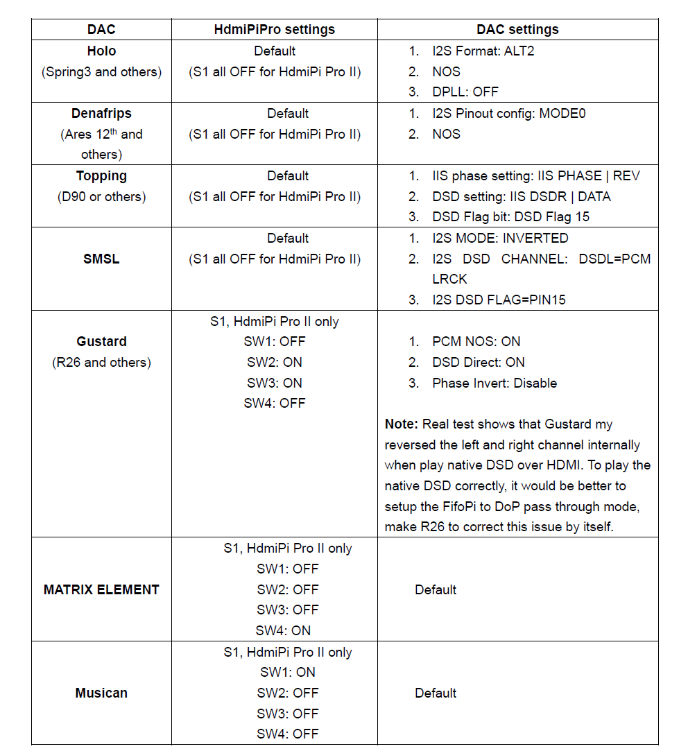

That’s still won’t work with the R26 for DSD.
HdmiPiProII and FifoPiQ7 works perfectly for Gustard R26 at Native DSD. You just need to connect the small cable from Q7 to the HdmiPiPro which can pass the DSDEN signal to Pin15.
Please find the picture for the connections. I just test it the day before yesterday.

@iancanada
In your notes you wrote “
To play the native DSD correctly, it would be better to setup the FifoPi to DoP pass through mode, make R26 to correct this issue by itself.
Is that then DOP? Not trying to start an argument about Native not being DoP, (I’m in the camp of if it’s DoP, it’s DoP, and that’s not native) just trying to understand your device features.
DSD with the R26 and that 1bit Dac is pretty atrocious anyway.
@camrector
With hardware DoP decoder, there will be no difference with native DSD. Why?
DoP is a protocol to transfer native DSD data within the 24bit PCM (I2S) protocol. By using DoP, DSD data can be sent using existing I2S or S/PDIF connections. DoP is a bit perfect protocol and converts back into native DSD with no losses. There are NO differences between the original native DSD stream and one re-generated back into DSD format from a DoP stream. Many of the common software packages used to playback music on RaspberryPi’s or PC are beginning to offer DoP output of DSD data as a means to output DSD via the I2S pins on the expansion header.
Unfortunately RPi doesn't play native DSD over GPIO, DoP only. If you really care about the native DSD format, the only way to take is making RPi output music through USB. In this case, a ReceiverPiDDC or StationPiPor will be required in the system.
HdmiPiProII and FifoPiQ7 combination plays both Native DSD and DoP into the R26 R-2R DAC.
Please let me know if you have any questions.

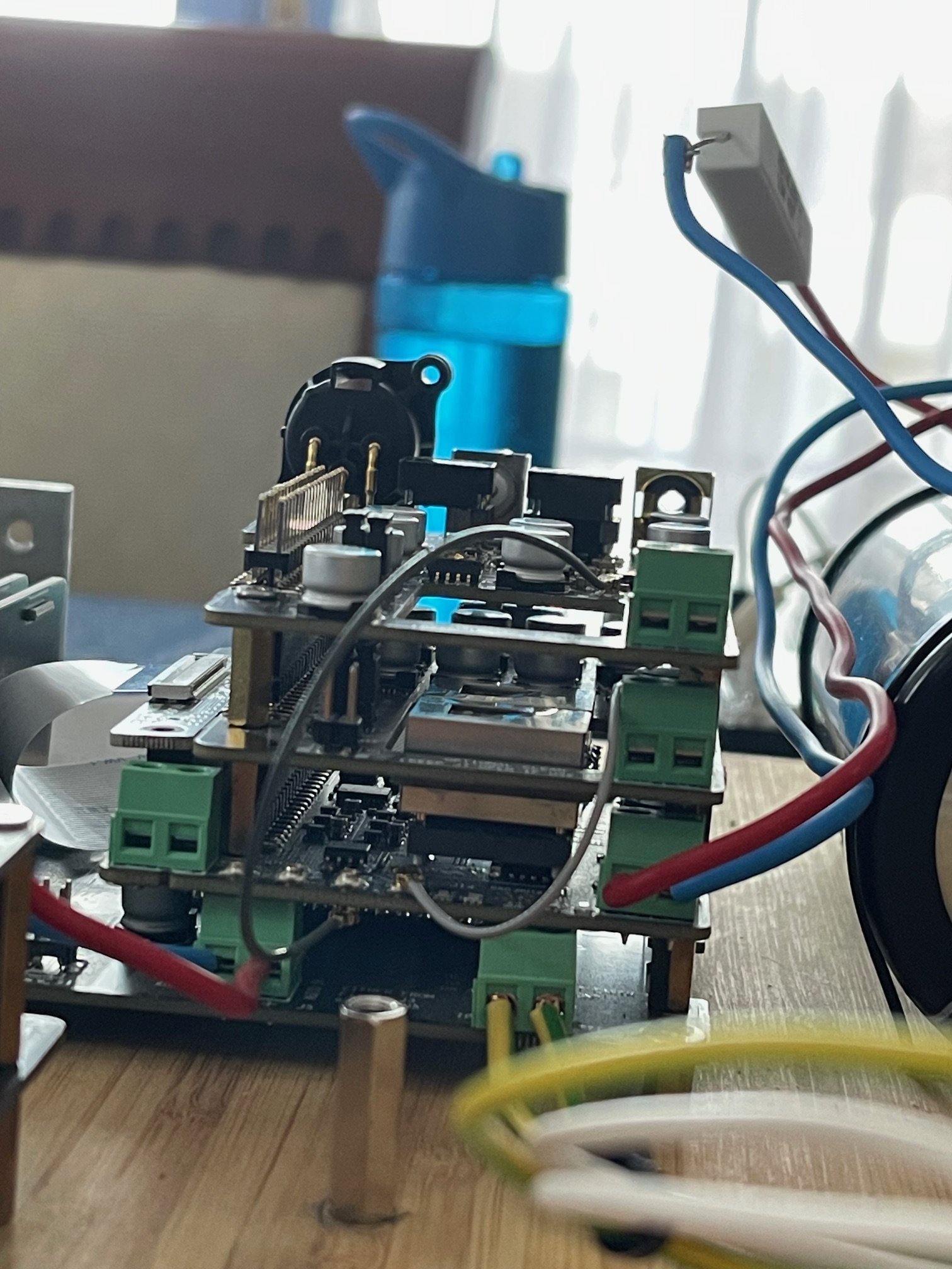

Just a warning for those who want to install ReceiverPi on StationPiPro: good to know that the two shield plates are not protecting anymore from RPi EMI because the RPi is upper (see photo)

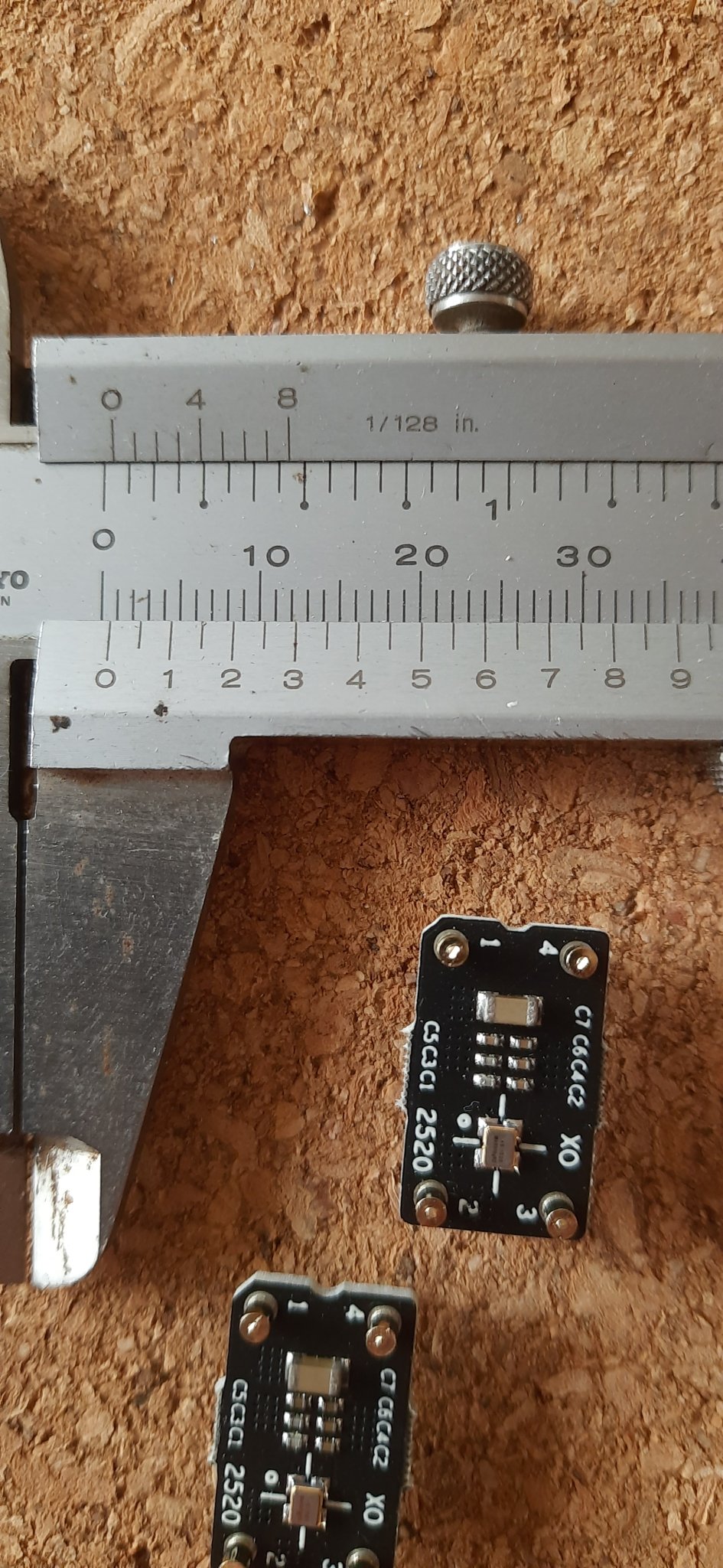

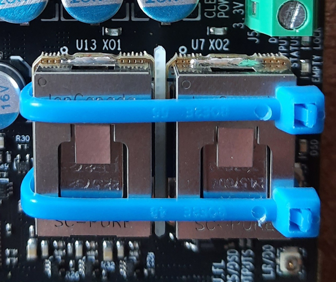

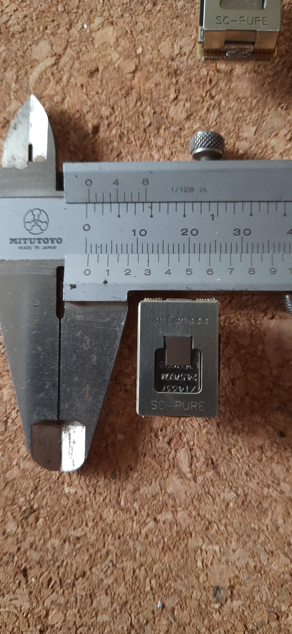

I just install SC-PURE clocks and seems like the Q7 clock-sockets do not hold them very good - this is kind of disappointing because I never remove the stock clocks and from what Ian said the sockets should hold the SC-PURE. 🙁 It is not a desired thing that I have to order the new sockets and then solder them on Q7 🙄
Any ideas how to use a anti-vibrating material on top of the clocks just to hold them a bit pressed on the Q7 sockets and to provide anti-vibration solution? As you see in the pictures, above the Q7 I have HDMIPiPRO and TransportPiAES.

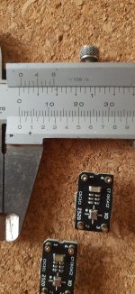

You're correct, there's a small but inconviniant difference in size.
For the time being I resolved it as you can see in the attached pictures.
When I rebuild my current dac housing I probably solder them directly on the Q7
