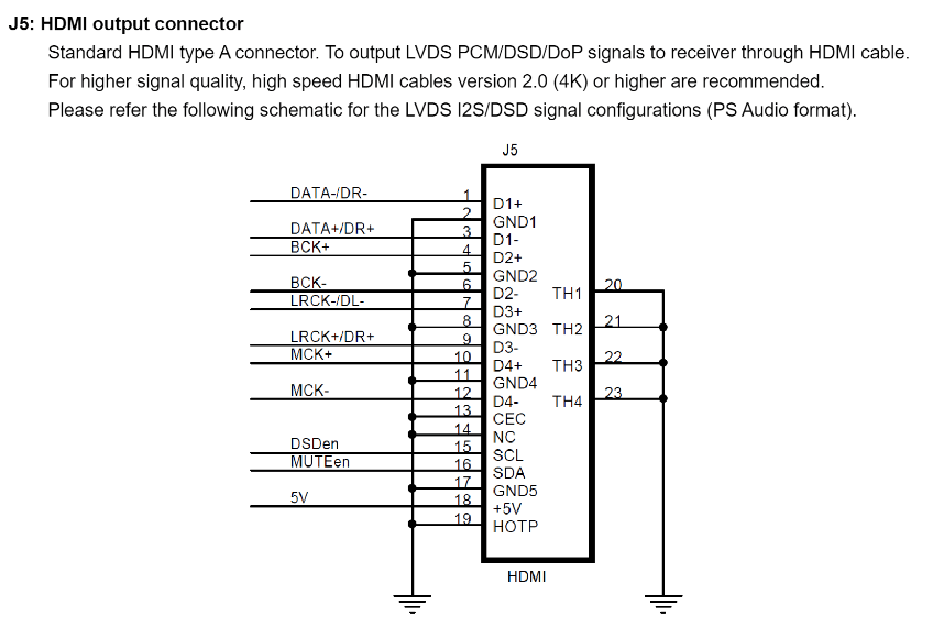

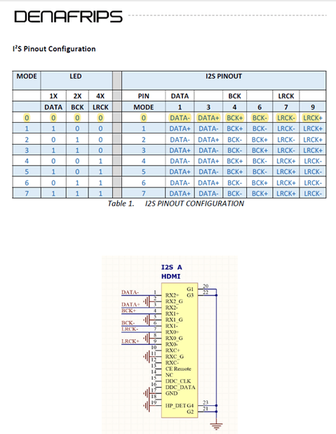

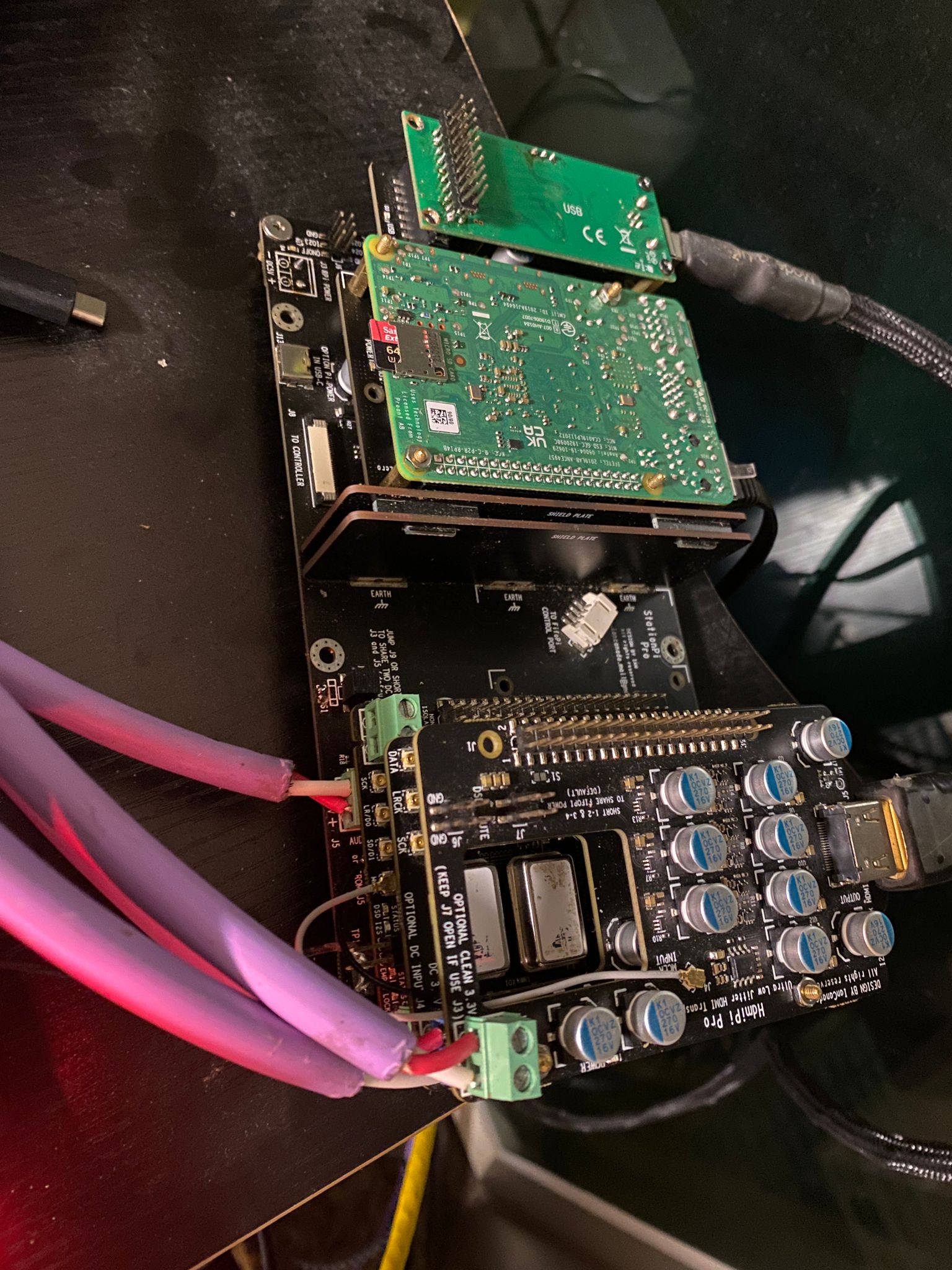

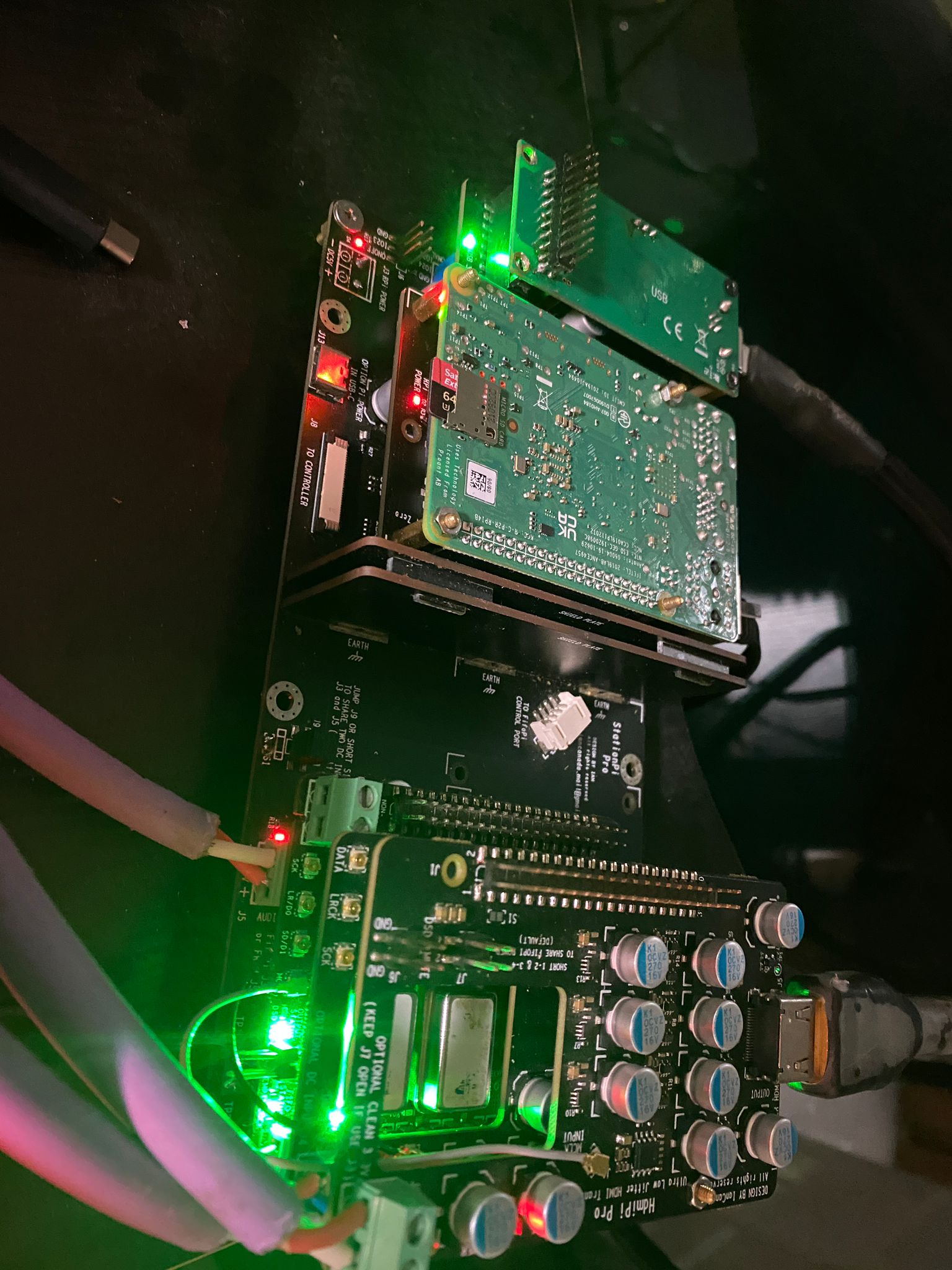

Have problem getting native DSD signal from my ian boards combination.:cry: I suspect that I still need extra borad to make native dsd I2S HDMI output works. Can anyone give me some ideas? When installing the borads mentioned underneath, I can get the 44.1k PCM to 192k PCM and DOP DSD64 works. But the Fifopi Q3 show DSD signal is empty (no light lit) when streaming native DSD to rp4.
Rp4b (Ropieee-Running NAA)
FiFoPi Q3
  • -MCLK signal to ReclockPi & HdmiPi Pro
  • -Accusilicon AS318 45MHz & 49MHz
  • -DOP decoding enable
  • -bit depth keep the same
ReClockPi
HdmiPi Pro or TransportPiMkII (I tried both)
Denafrips Pontus 2 DAC
  • -I2S port mode 0
<Picture of my RP4 setting>
I have tried connect DSD and mute signal cable, It make no difference.
i have tried every possible I2S setting on Denafrips Pontus dac, all I2S mode doesnt work.
Is MonitorPi pro or ReceiverPi necessary in my situation?
Not solved yet, but further troubleshooting will have to wait until I have a working MonitorPi Pro to check/change the FifoPi Pro settings.
Have you solved the issue yet? i think we have kind of similar issue. We both cannot make native DSD work, while my Denafrips dac can accept all kind of HDMI I2S setting. Sadly, it doesnt solve my problem, I have tried every I2S mode on DAC side setting. BTW, I also tried the StatinoPi pro with amanero USB as sources to combined with FIFOPI Q3 and HdmiPIi Pro, it turns out having the same issue.
(HDMI I2S option of my dac)............................................................................ (HDMI pins of HdmiPi Pro)
