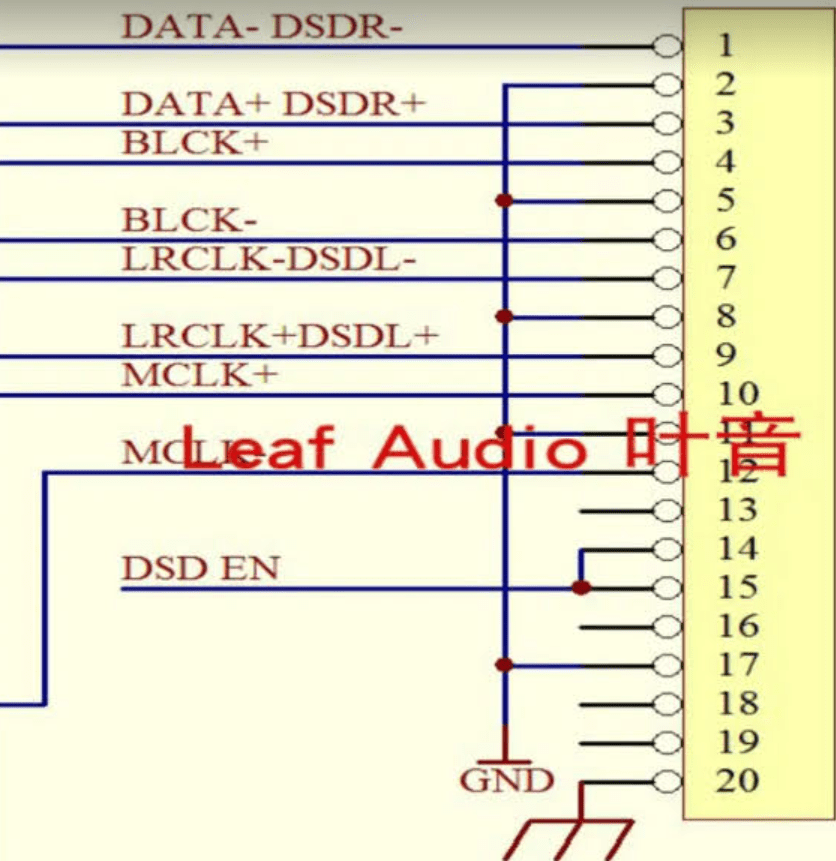

Thanks Ian, for looking into this!
My Leaf Audio CMD27 DAC also uses the PS Audio pin layout:
Surprisingly, even if the DSD flag on pin 15 is not sent by the streamer, the DAC plays PCM as well as DSD. Only with your stack there is noise on all files of 176 kHz or higher: a soft hiss before the music starts, and then loud static noise/distortion that is triggered by the music.
I just tried again with a direct ethernet connection (to rule out the EtherRegen) but it is still the same.
This behavior is the same whether I use the Amanero board or the internal I2S DAC.

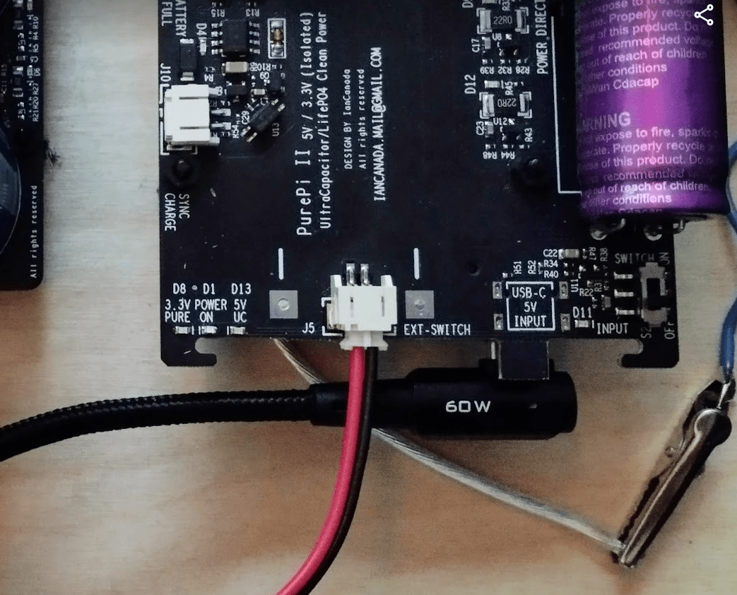

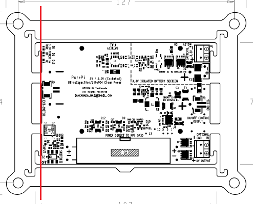

I have a design revision suggestion for the PurePi board:
When combining this with the RPi computer and want to install it in an enclosure the USB-C connector of the PurePi board will be blocked by the panel of the enclosure if I want to use a linear P/S which is also in the same enclosure.
Unless I decide to have the P/S output to the same panel (by a 5,5/2,1 mm barrel for example) and have a small cable outside the cabinet to feed the USB-C input.
Then of course the panel of the cabinet will need to have a cutout too for the USB-C plug of the PurePi.
An additional 2-pin header or connector / socket on the PurePi would be sufficient to have the option to feed the PurePi from within the same cabinet.
Another option is to find the 5 Vdc solder pads near the USB-C connector (see 4 pads at the underside of the board .. are these usable or are these for the connector housing = GND ?) and solder a cable here to feed via the cable.
Or are there better position where I can attach some additional P/S wiring ?
To make it fit anyway I will need to remove the outer PCB and also remove the ears al both corners.
I guess these have no functional PCB traces ?
Reason:
I have a Saligny rectifier and want to use this with an LT1085 + Noizator to have a super clean "raw" power feeding this into the PurePi.
Even a very good power stage as the PurePi will still benefit from a cleaner external supplied voltage.
Thanks Oystein for the suggestions, I'll think of it and take into consideration.
Good weekend.
Ian

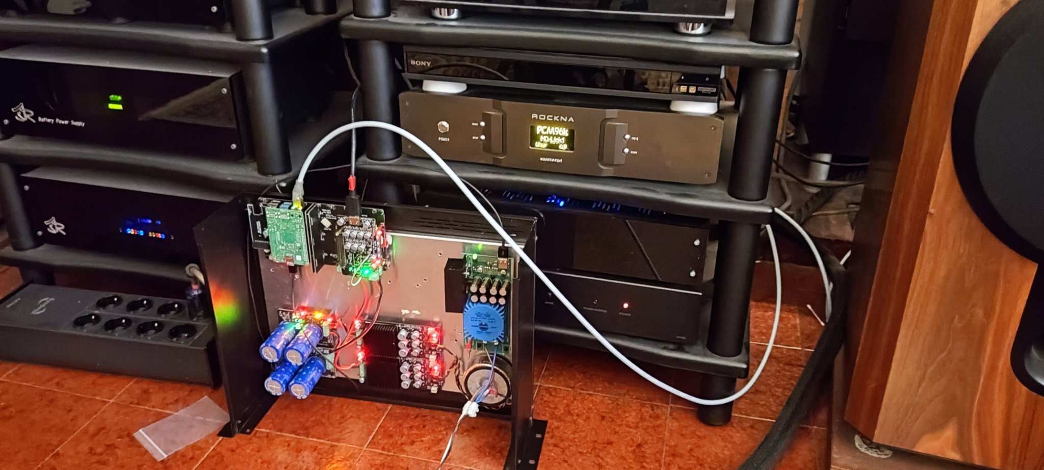

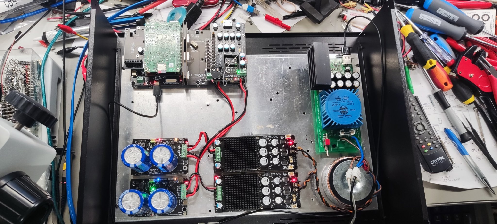

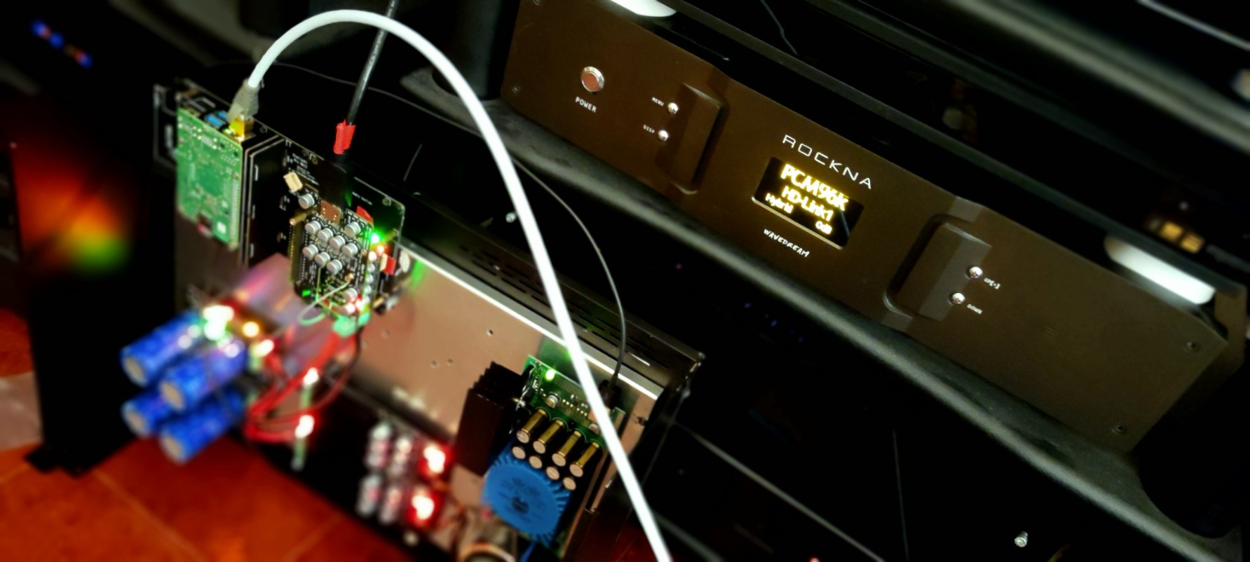

Hi all!!
This is my build
The results are superb, better imaging, better extension and detail, better control.
i2s on Rockna Wavedream
I had problem with the one UcConditioner, overvoltege light on, i rectified the problem with the help of Dimdim, we resoldered the capacitors and then proceeded to fully discharge them with a 100w 1ohm resistor making sure to measure the voltage as it dropped to be the same on both. It seems that only if the voltage of both capacitors are very close less than 0,2V or so is the UcConditioner able to charge both capacitors without overvoltage. This is just what we found in practice maybe Ian can chime in.
Also had problem with short circuit of the Q7 on the GPIO pins on the StationPiPro, had to bend the 6 pins "V" shape and put electric tape on to be sure.
Not a fan of the very small smd fuses got 10 of them as replacements.
Other than that all good, the setup delivers what it promises.
Still have to close the box
Cheers to all!!
