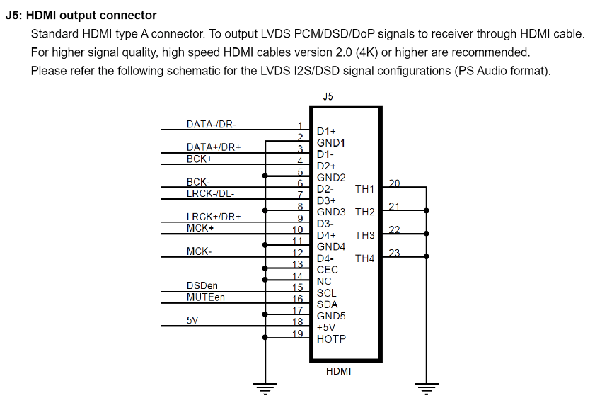

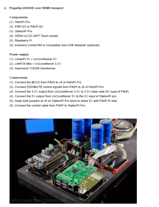

You can download the HdmiPi Pro user's manual for the Denafrips settings.Have problem getting native DSD signal from my ian boards combination.😢 I suspect that I still need extra borad to make native dsd I2S HDMI output works. Can anyone give me some ideas? When installing the borads mentioned underneath, I can get the 44.1k PCM to 192k PCM and DOP DSD64 works. But the Fifopi Q3 show DSD signal is empty (no light lit) when streaming native DSD to rp4.
Rp4b (Ropieee-Running NAA)
FiFoPi Q3
- -MCLK signal to ReclockPi & HdmiPi Pro
- -Accusilicon AS318 45MHz & 49MHz
- -DOP decoding enable
- -bit depth keep the same
ReClockPi
HdmiPi Pro or TransportPiMkII (I tried both)
Denafrips Pontus 2 DAC

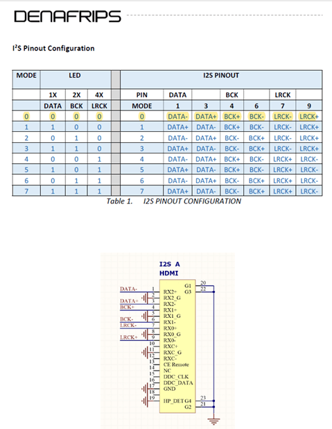

- -I2S port mode 0
<Picture of my RP4 setting>
I have tried connect DSD and mute signal cable, It make no difference.
i have tried every possible I2S setting on Denafrips Pontus dac, all I2S mode doesnt work.
Is MonitorPi pro or ReceiverPi necessary in my situation?
https://github.com/iancanada/DocumentDownload/blob/master/HDMIpi/HdmiPiPro/HdmiPiProManual.pdf
But Deanfrips internal clock can not be bypassed so the room of improvement could be limited.
Yes, a MonitorPi or pro will be a great help to debug you DSD issue but you have to setup you software and DAC correctly to get the correct DSD playback.
I was actully following the application example in your HdmiPiPro manual. My build is almost identical to your demonstration except not yet buying the touch screen.
I thought it acts as a digitial transport, which accpet usb input from Amanero and turns it into better quality I2S Hdmi output. 🤔 I guess this is not the correct understanding of above example? So what it actually does? 🤣
DSD would require a USB cable between the Pi and the Amanero. I2S (PCM) should work as shown.
"I thought it acts as a digitial transport, which accpet usb input from Amanero and turns it into better quality I2S Hdmi output"I was actully following the application example in your HdmiPiPro manual. My build is almost identical to your demonstration except not yet buying the touch screen.
That's what exactly it dose. What's the question?

Have you solved the issue yet? i think we have kind of similar issue. We both cannot make native DSD work, while my Denafrips dac can accept all kind of HDMI I2S setting. Sadly, it doesnt solve my problem, I have tried every I2S mode on DAC side setting. BTW, I also tried the StatinoPi pro with amanero USB as sources to combined with FIFOPI Q3 and HdmiPIi Pro, it turns out having the same issue.
View attachment 1240129View attachment 1240130
(HDMI I2S option of my dac)............................................................................ (HDMI pins of HdmiPi Pro)
Not solved yet as I am still waiting for a replacement MonitorPi Pro to check/change the FifoPi Pro settings.
The issue remains: distortion/static noise with all material above PCM96 including DSD, regardless whether I play with Amanero or the internal I2S 'DAC'. It occurs regardless of whether I use the Leaf Audio CMD27 DAC or the Audio-GD DI20HE DDC.
I am pretty sure that it has nothing to do with the I2S pin layout. The fact that it plays undistorted PCM96 and distorted DSD shows that the pin mapping is correct, and it should be as both sides adhere to the PS Audio standard. The same DAC with the same cables plays everything well up to DSD512 when I use another RPI4 based streamer using this standard.
Also looking at your issue, I am guessing it is something with either the FifoPi (Q3 resp. Q7) or HDMIPi Pro, or their configuration using the StationPi Pro board. I hope to find out when I get a new MonitorPi Pro. Ian is kindly helping me a bit via PM's.

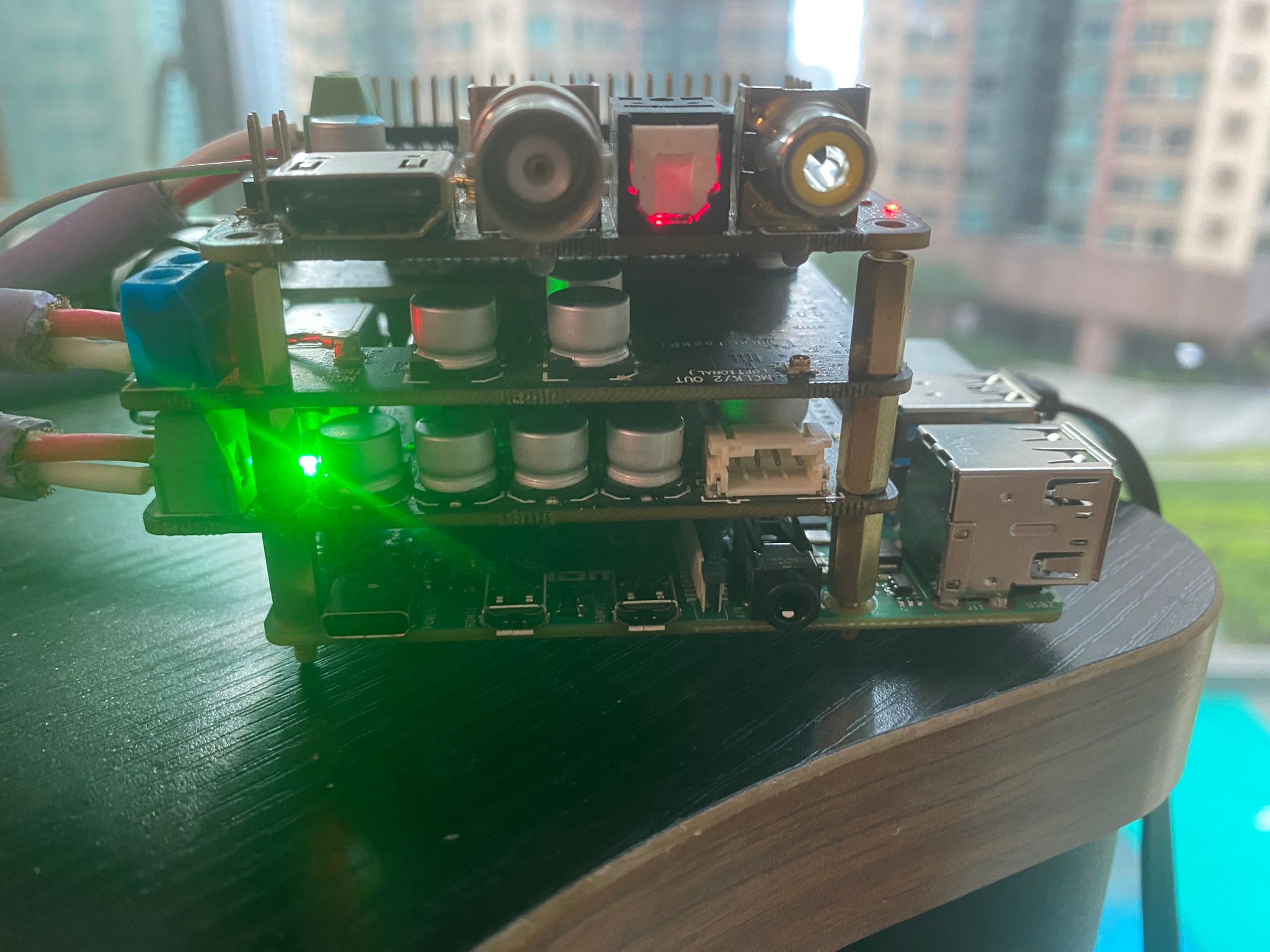

Also still having the distortion problem with all material above PCM96.
My configuration: stationpi pro, receiverpi pro II, FifiQ7, monitorpi pro.
Tried all monitorpi pro settings but the distortion is still there.
Ian suggested to remove the receiverpi pro II to check. As I don;t have time until now, I didn't tried that yet.
To be continued.
To be continued.
