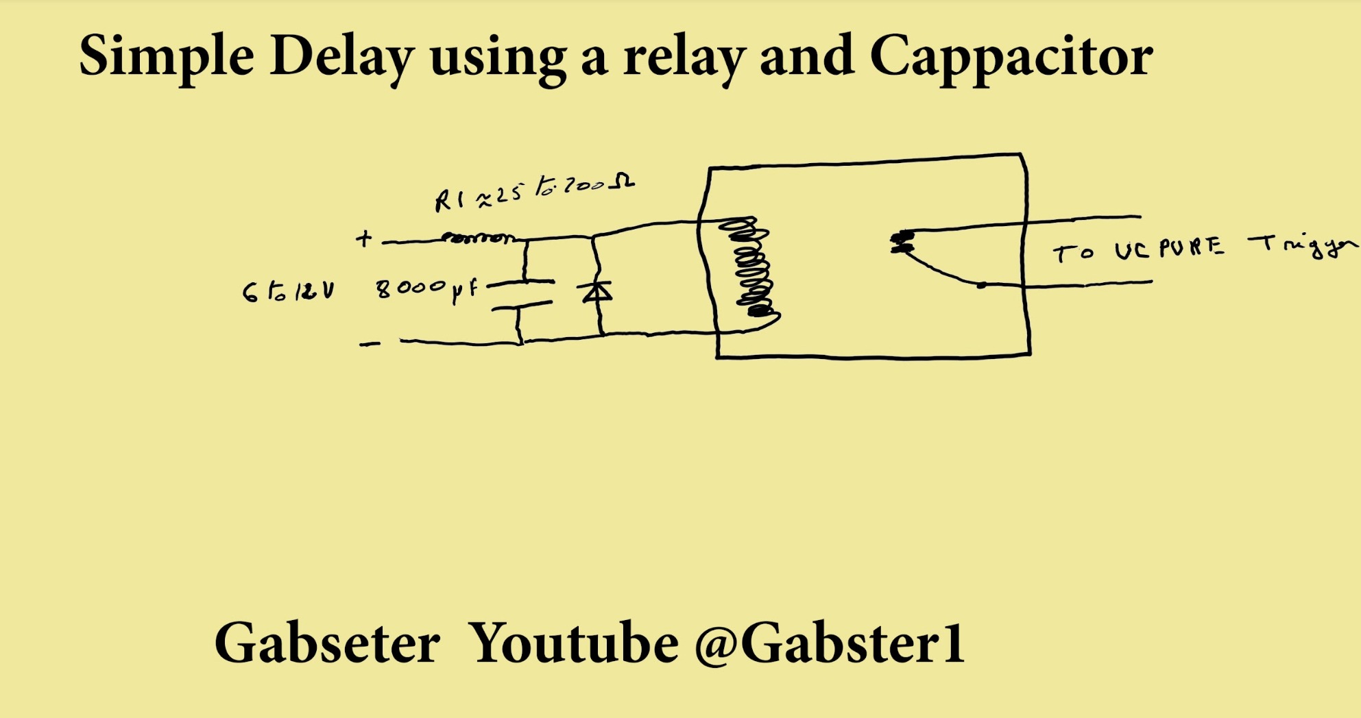

If you like to use a passive way reduce possible noise I used a simple Capacitor/relay, schematics below
The relay is a small 12v you can also use a 5 v relay for 3 to 5 v input
You can supply it from the unregulated RPI supply
Any simple diode will do Capacitor size is approximate use what you have close to that

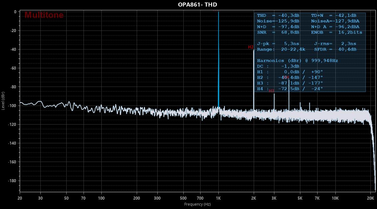

Is there anybody here that can help with this setup, Amanero USB, StationPI Pro, FIFOQ7 with SC-PURE, ES9038Q2M and OPA861, It measure and sound terrible, i have the right power supply and all lights is green/blue. I'm using a E1DA for measurement.
Kind regards Lars
