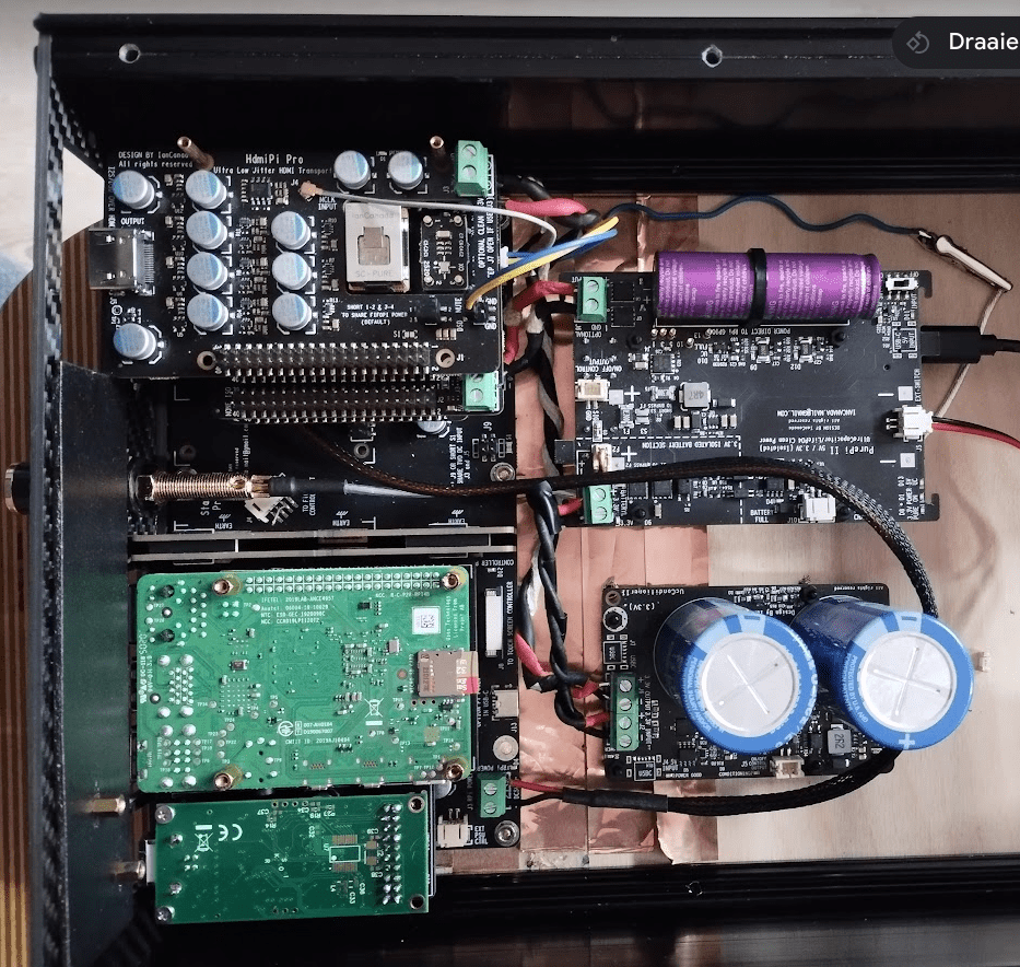

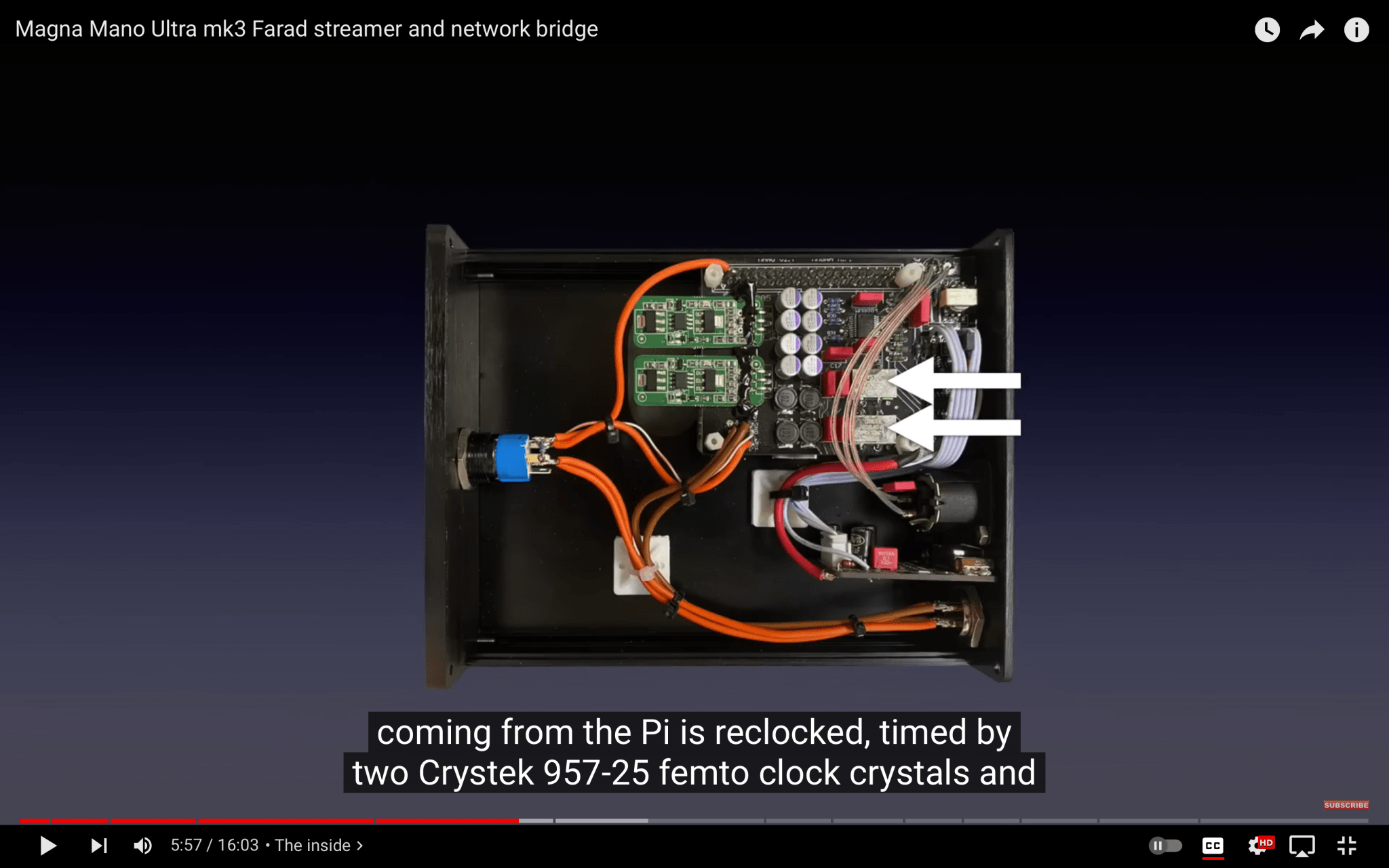

Hi guys. I have recently built a Streamer based on Ian`s cards. I have used Fifo Pi Q7 with SC Pure clocks, HDMI Pi Pro, Pure Pi 2, Ultra conditioner mkII, Raspberry 3B+.
As powersupply I am using av Ferrum Hypsos powersupply. I am also using a copper plate for shielding between Pi and Q7 card.
I compared my streamer to a Mano Ultra mkIII streamer, listened on a system based quality components like Respons Jussi loudspeakers, Mola Mola Tambaqui dac on the I2S input with Audioquest Vodka cable, Mola Mola Kaluga poweramplifiers, PPA stdudio Quad switch, Vibex Granada Platinum Dual DC powerdistributor etc.
My streamer was powered up for 15 hours before comparing the two.
Sadly I found that the Mano Ultra mkIII sounded clearly better. It had larger more threedimensional soundstage, instruments had more natural and fuller sound with more overtones, especially acoustical instruments and voices. Wifi and usb on the PI3 was turned off.
I tried to connecth the copper plate between the Pi and Q7 card, and this improved the sound of my streamer, but there was still a step up to the Mano streamer.
The price of the parts I have used and the Mano Ultra mkIII is almost similar.
As is I consider buing the Mano Ultra instead, but wonder if anyone have tested the difference of a streamer like mine with and without the Shield Pi mkII card?View attachment 1237612

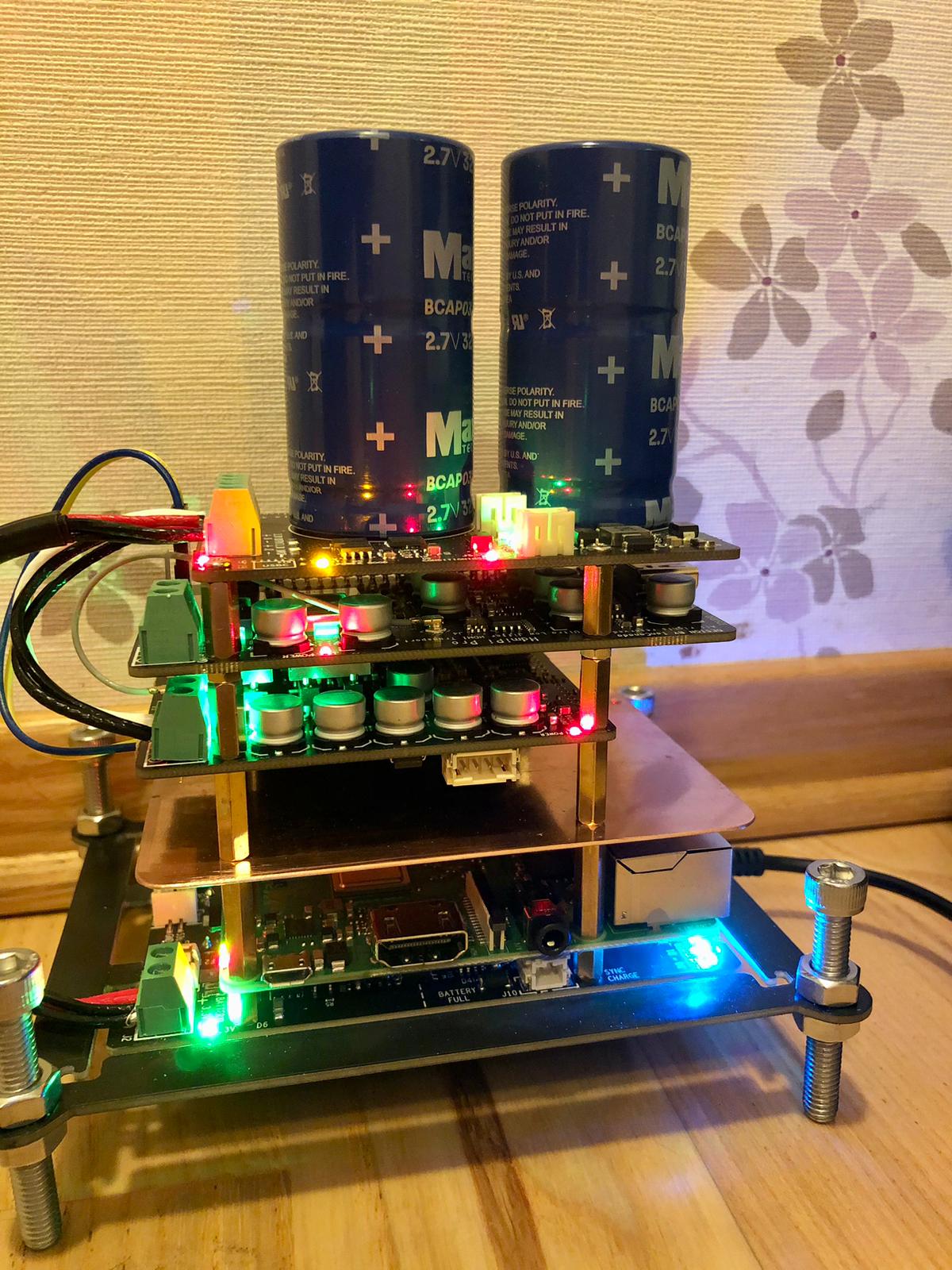

Domenico of Amanero kindly and promptly helped me by sending an updated ConfigTool.exe, and after reinstalling cpld_1082 / 2006be15r2 there was music!
However, the problem is that all files above PCM96 (including DSD64 etc.) are accompanied by a loud hiss/distortion, exactly the same as what happens with the I2S DAC, so I do not believe the Amanero board to be the problem.
This is disappointing as I built this stack especially to be able to play (at least) DSD256, and bought the 44-rate family SC-Pure clock for that.
Could it be that I have one stock clock and one SC-Pure?
Any pointers where to look for a solution will be appreciated!

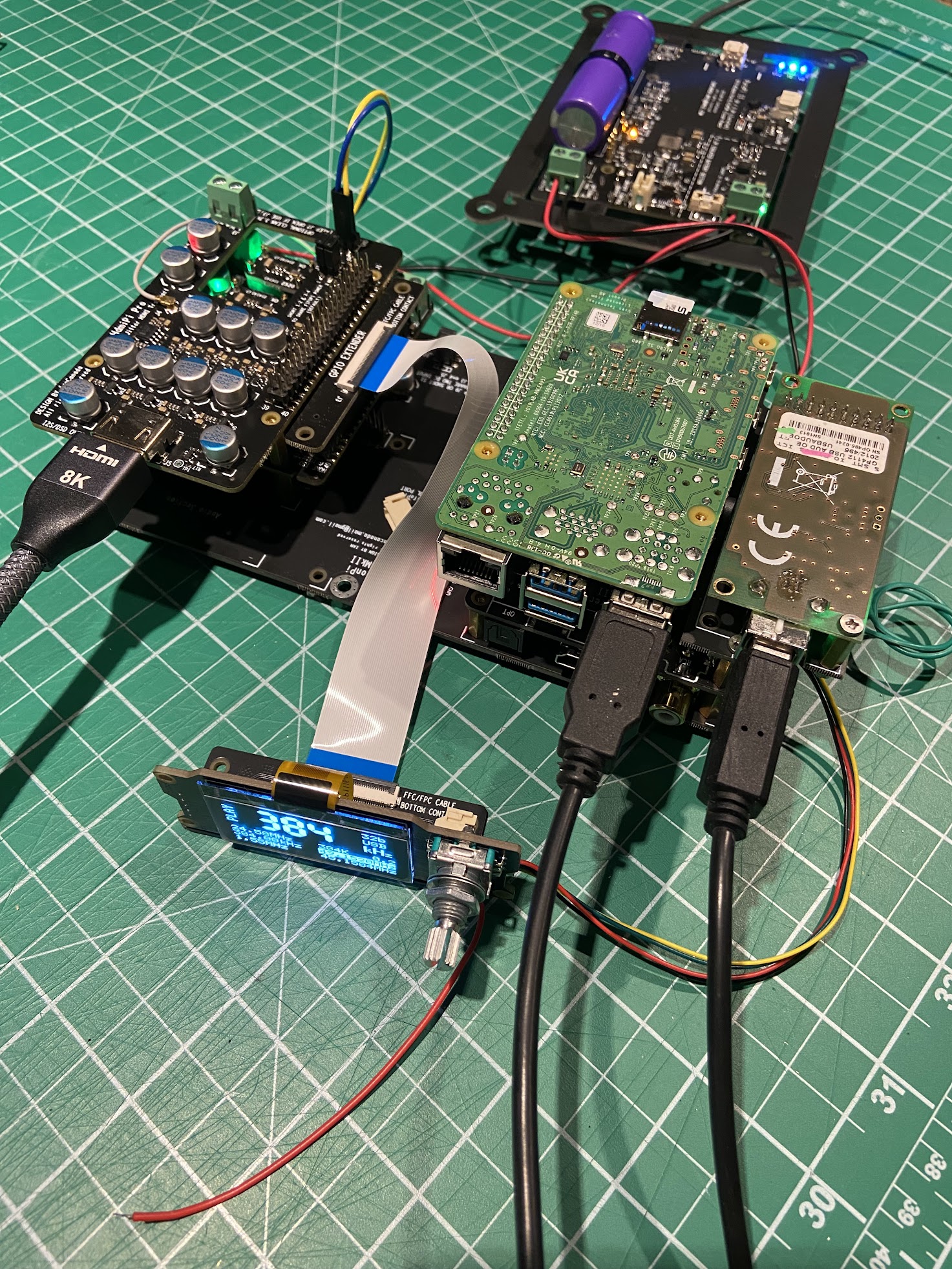

Q7 is capable of 768KHz/DSD1024, so normally it's a software issue or the DAC issue.
Can you post a picture showing the system and connections?

Thanks Ian. Below is a picture of the stack: RPi4, StationPi Pro, ShieldPi (mounted on the clean side under the FifoPi), FifioPi Q7, HDMIPi Pro. The stack is powered by PurePi II and UcConditioner.
I think I ruled out software and DAC, as both are able to play PCM384 and DSD512 with other streamers (including an RPi4 based one). Previously I considered
  • weak MCLK u.fl connector
  • ShieldPI (but ruled out as the problem also occurs when I remove it)
  • hybrid clocks (stock and SC-Pure, but don't think so)
  • FifoPi settings (I have not been able to change these as the MonitorPi arrived DOA and I am waiting for a replacement)
  • DSD/MUTE cable between FifoPi and HDMIPi (ruled out as removing it does not change anything)
  • Amanero board (ruled out as, with the help of Domenico, I verified that it can play the DSD without distortion)
  • RPi4 (ruled out as it plays up to DSD128 with my DAC's Amanero)
I do hope that I can get DSD to work... But to end on a positive note: in spite of this, I have no regrets as it was a fun build and even with lower resolution PCM the sound quality exceeds my previous streamers 🙂

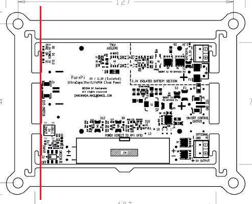

I have a design revision suggestion for the PurePi board:
When combining this with the RPi computer and want to install it in an enclosure the USB-C connector of the PurePi board will be blocked by the panel of the enclosure if I want to use a linear P/S which is also in the same enclosure.
Unless I decide to have the P/S output to the same panel (by a 5,5/2,1 mm barrel for example) and have a small cable outside the cabinet to feed the USB-C input.
Then of course the panel of the cabinet will need to have a cutout too for the USB-C plug of the PurePi.
An additional 2-pin header or connector / socket on the PurePi would be sufficient to have the option to feed the PurePi from within the same cabinet.
Another option is to find the 5 Vdc solder pads near the USB-C connector (see 4 pads at the underside of the board .. are these usable or are these for the connector housing = GND ?) and solder a cable here to feed via the cable.
Or are there better position where I can attach some additional P/S wiring ?
To make it fit anyway I will need to remove the outer PCB and also remove the ears al both corners.
I guess these have no functional PCB traces ?

@bodiebill
Today, I did a test using the same configuration as yours, just trying to help.
I played 192KHz, 384KHz, DSD64, DSD128 music files, the streamer works like a charm and sound great without any issue.
I tested on D90, Spring3, Ares 12th and R26 DACs, they are all good no problem.
The only thing is that, my HdmiPi Pro uses standard PSAudio I2S over HDMI format, but different DAC may use different format, so DAC has to be set up properly until play correctly.
My configuration:
HdmiPi Pro
FifoPiQ7
StationPi Pro
RPi4
Amanero USB
ReceiverPi Pro II
MonitorPiPro (as StationPi Pro controller to select sources)
I just simply use a PurePi as power supply.
It would be a great help if you can figure out what HDMI format that your DAC is using from the user's manual.
Please let me know.
Ian

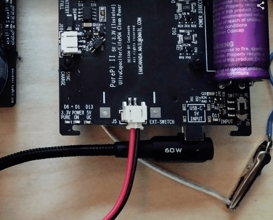

Hi Eduard,
Your picture is not very clear but I can see a black and red wire solderen to a PCB.
Is this a PurePi board ?
The PurePi board on the available pictures looks different so I dont’t recognise the connections / locarion on the board.
My main question was where to connect external P/S wires on the PurePi when not using the USB-C .. not how to connect them.
i don’t have the hardware yet .. I am listed in the latest GB but am working out ideas In advance.

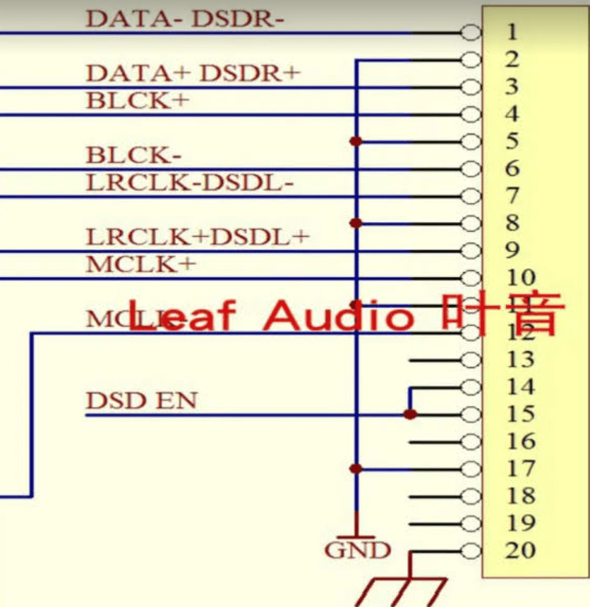

Thanks Ian, for looking into this!
My Leaf Audio CMD27 DAC also uses the PS Audio pin layout:
Surprisingly, even if the DSD flag on pin 15 is not sent by the streamer, the DAC plays PCM as well as DSD. Only with your stack there is noise on all files of 176 kHz or higher: a soft hiss before the music starts, and then loud static noise/distortion that is triggered by the music.
I just tried again with a direct ethernet connection (to rule out the EtherRegen) but it is still the same.
This behavior is the same whether I use the Amanero board or the internal I2S DAC.

Hi Eduard,
Hello,
This the UC Pi board that only has one five volt output BUT it only needs the same input voltage connected to a tiny USB connector.
Once you see it it will be easy.

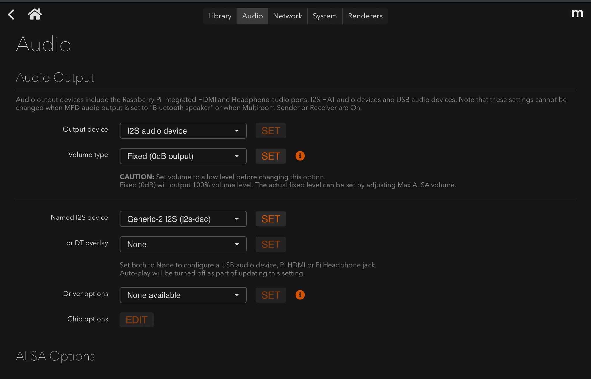

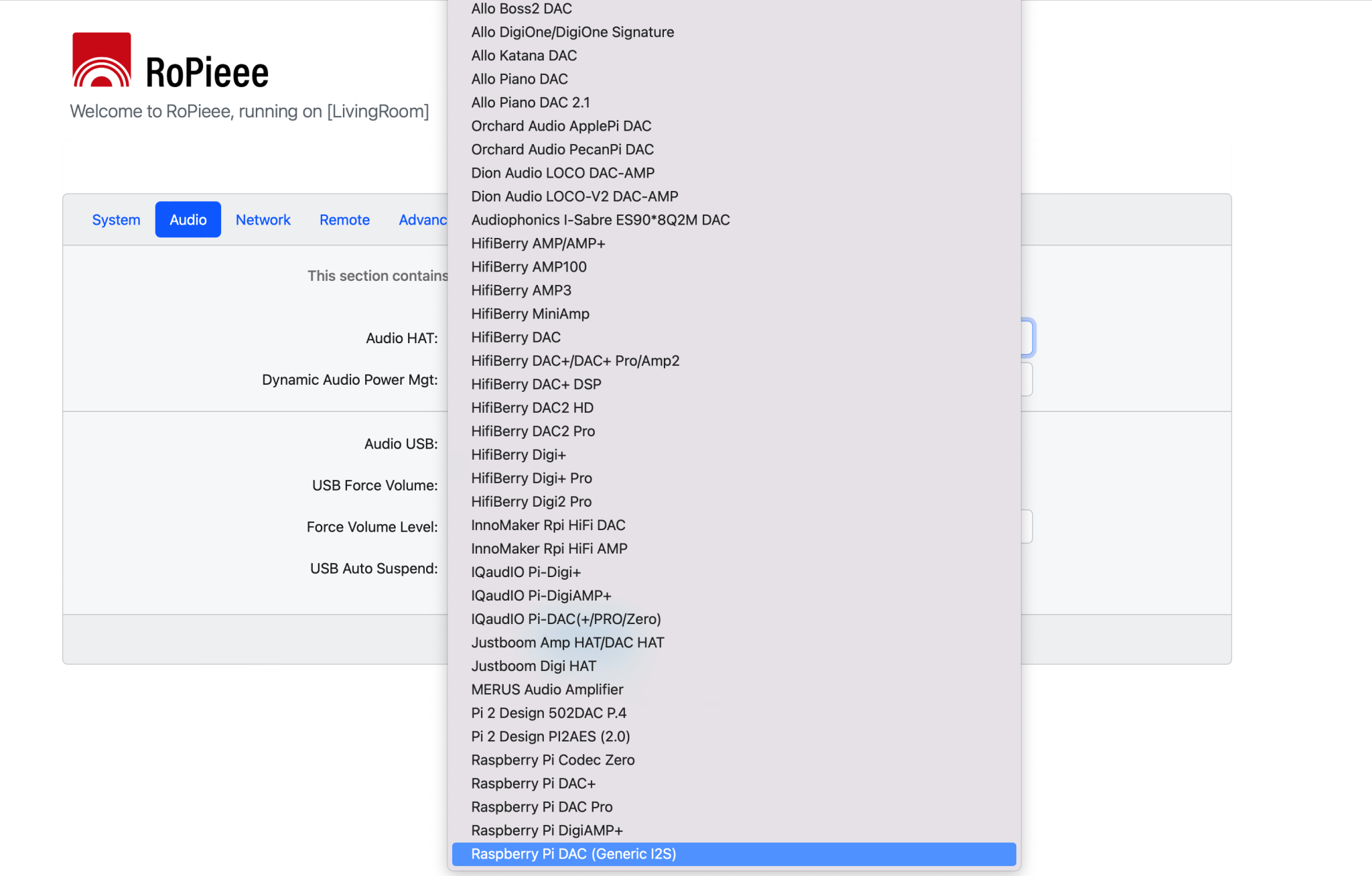

Does anyone know the fix for this please? I just built a streamer with the following.
PurePi II PSU
Pi 3b running Moode
FifoPi Q7
TransportPi AES
It all powers up fine, and Moode works from my iPad, but from within Moode configuration page I cannot see the Holo May DAC.
I’ve tried connecting the DAC with Toslink and Coax. Of interest is the Toslink cable, as when this is unplugged from the DAC I would expect to see the red led, but there’s no signal there at all.
Many thanks.
@iancanada
Reason:
I have a Saligny rectifier and want to use this with an LT1085 + Noizator to have a super clean "raw" power feeding this into the PurePi.
Even a very good power stage as the PurePi will still benefit from a cleaner external supplied voltage.
You could use an angled usb-C plug:
