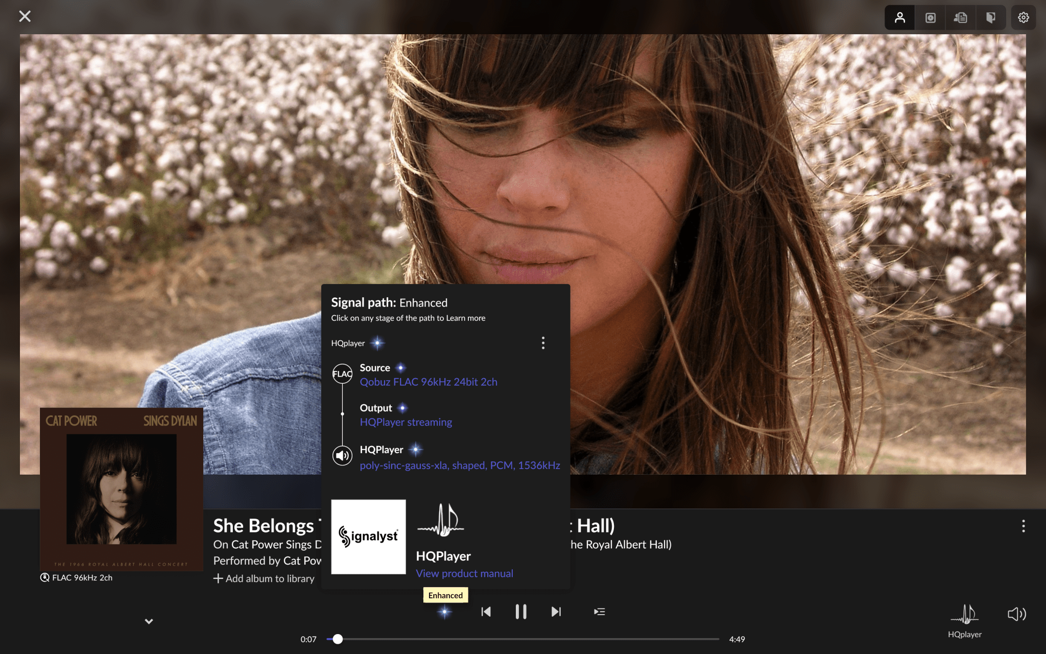

Hqplayer --Rpi4 RopieeeXL NAA --USB Denafrips DAC [usually the devices you connect to Rpi4 cause a bottleneck, I had this with DDC]

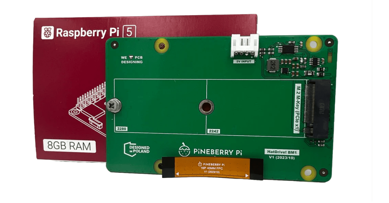

There's also a NVME HAT that attaches to the bottom of the RPI5, so it should be good to go with a StationPi but it's not a priority yet. I rather wait for more RPi5 HATs releasing January 2024. Yes, you can boot straight from NVME at blazing speeds. Crossing fingers RPi5 is shipped out end of November.

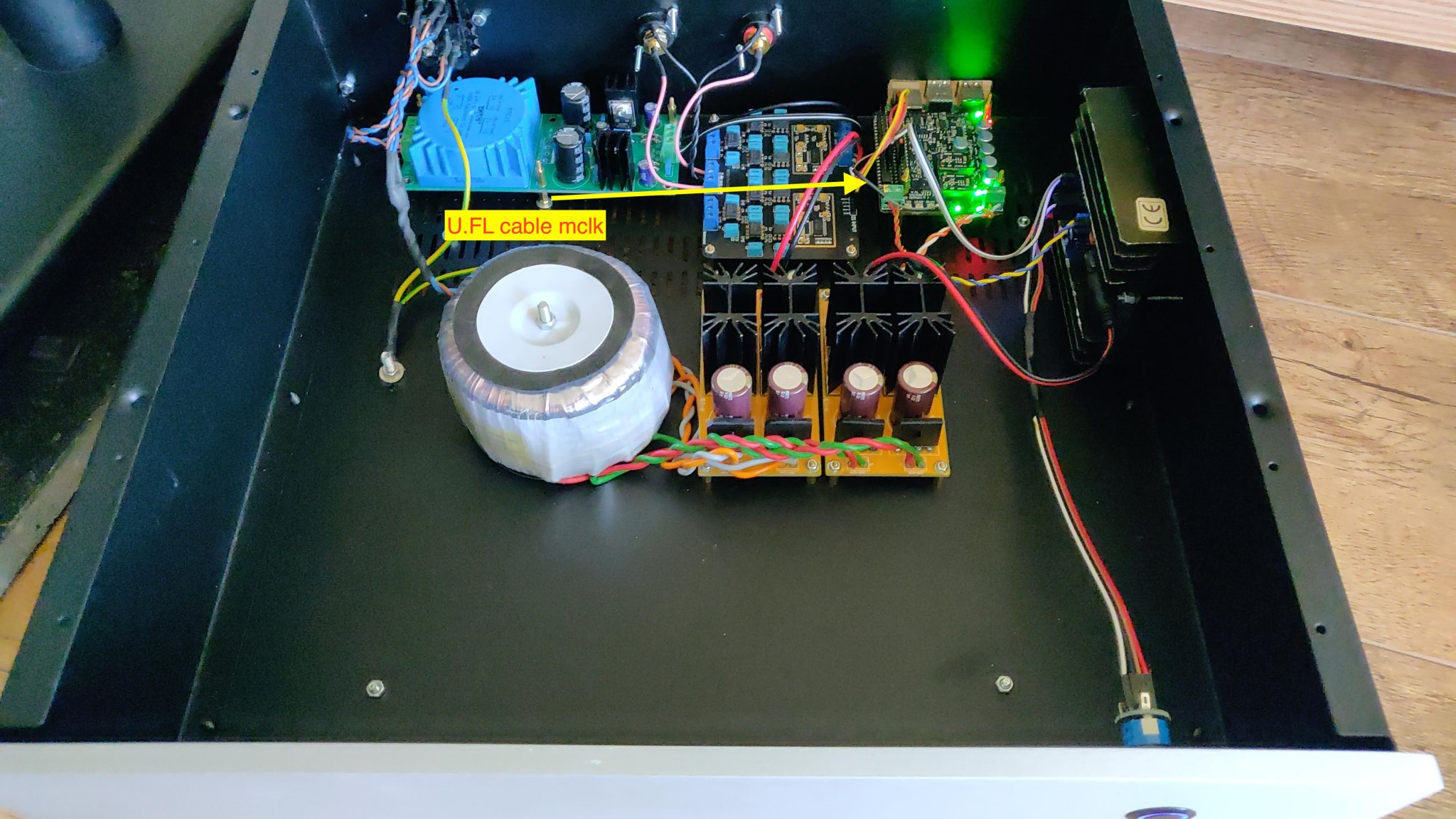

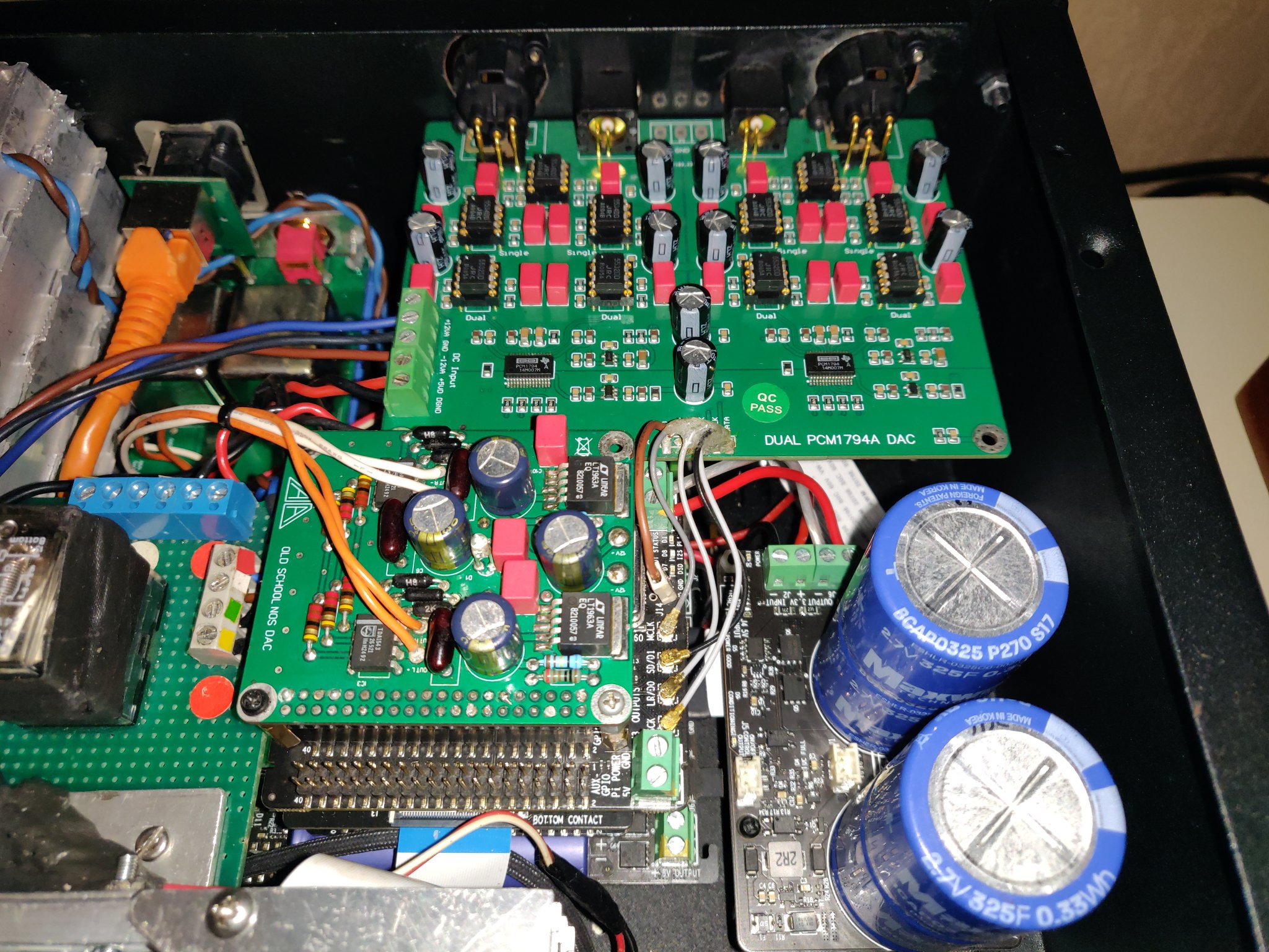

@PcChip
I connected the same PCM 1794A dac board for a friend.
You can use all i2s signals from the gpio pins fifoQ7 and the mclk via a U.FL cable, you will need this mclk for this pcm board anyway.
also note that you have to upsample otherwise you won't get any sound.
in my own streamer I use a pcm 1794A but then the fifoMA 1.5 but all i2s connected via U.FL cable.
Solder the U.FL cable to a piece of jumper cable.
I get no sound here via gpio or U.FL directly from the fifoQ7 or fifoMa 1.5 (volumio) both pcm dac, I need to upsample.
You do get sound, but very low, I have to turn the volume knob all the way up.
I haven't tried moodeaudio or picoreplayer.
it should indeed be able to play......but unfortunately not.

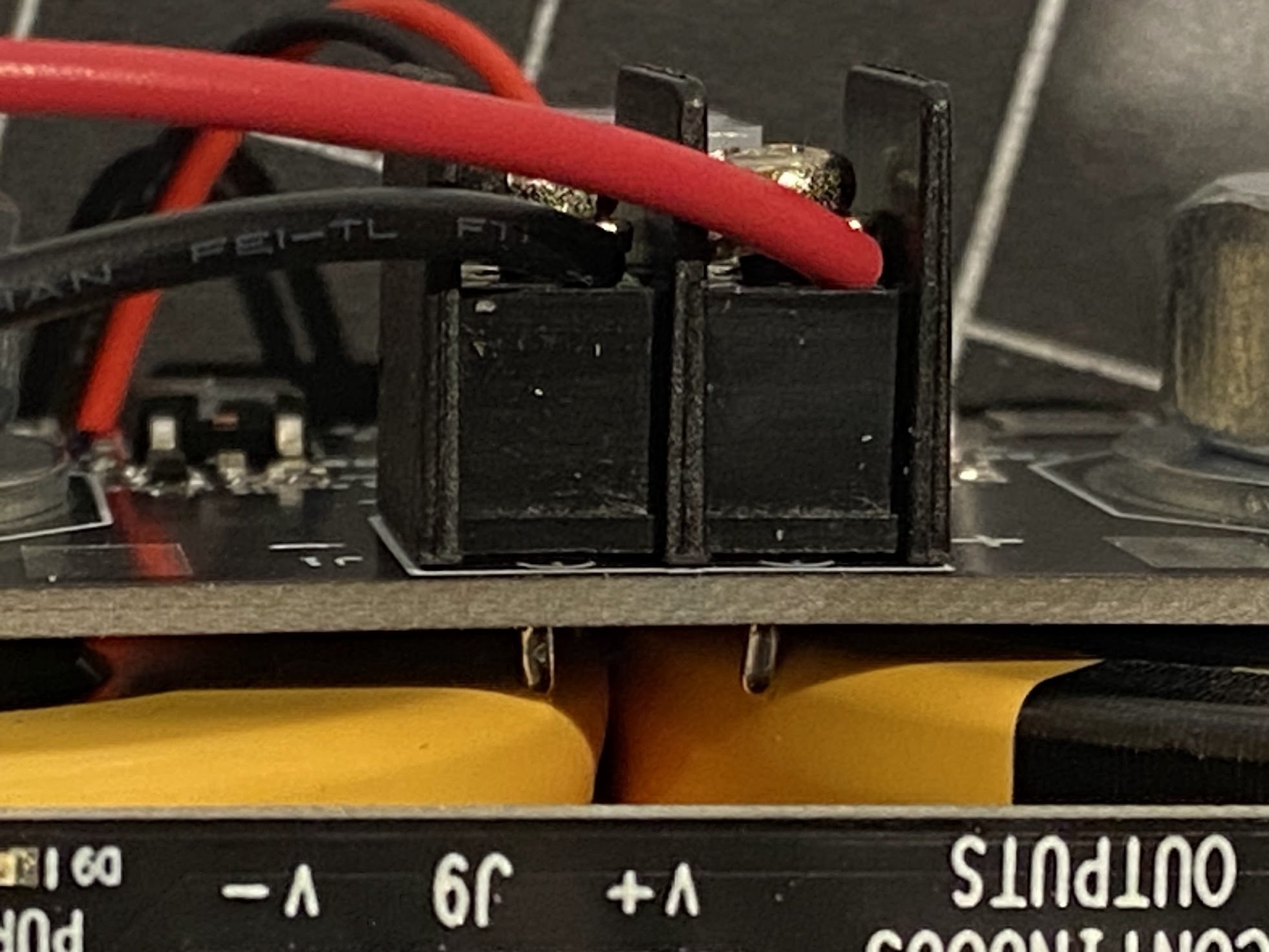

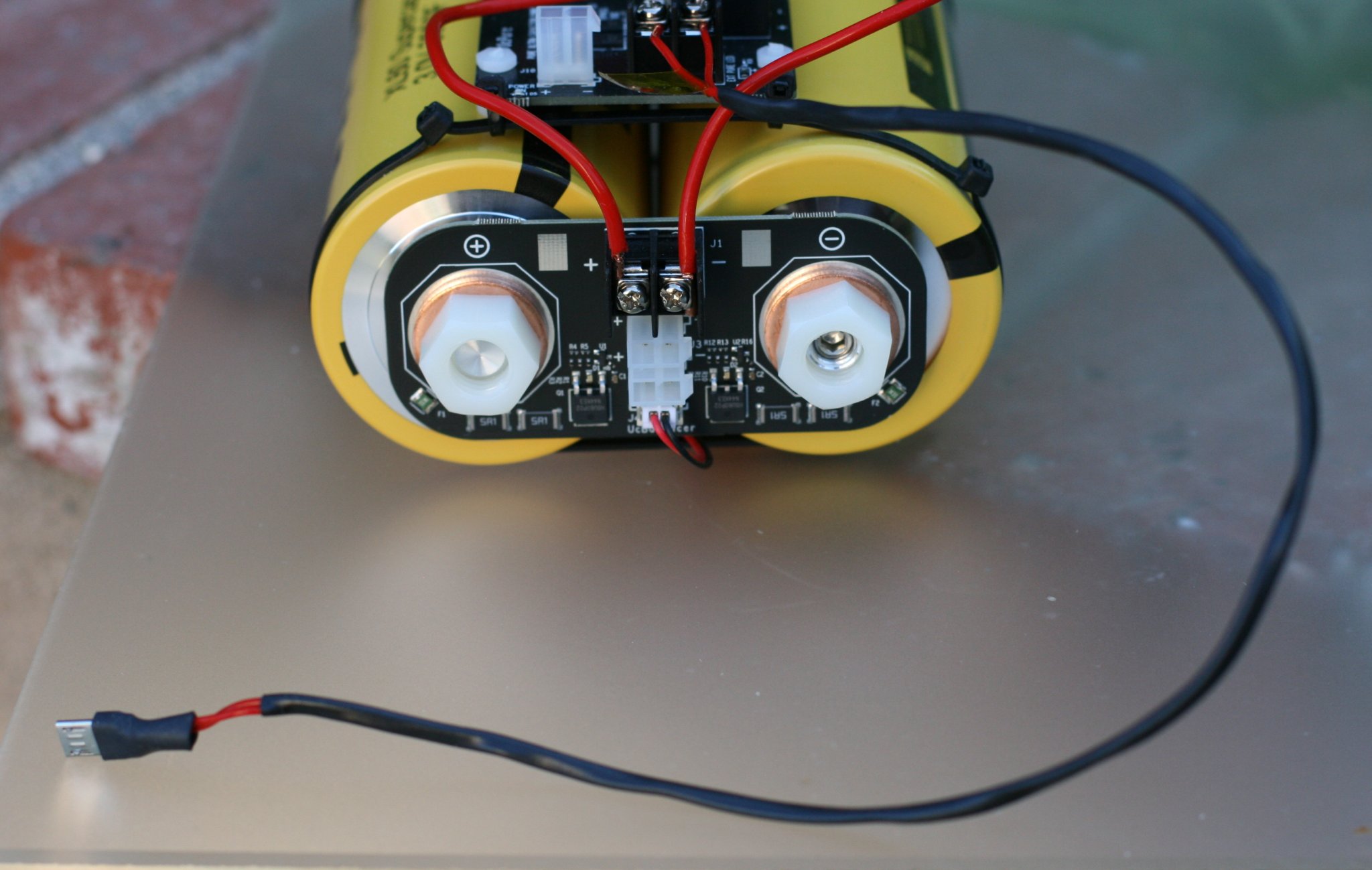

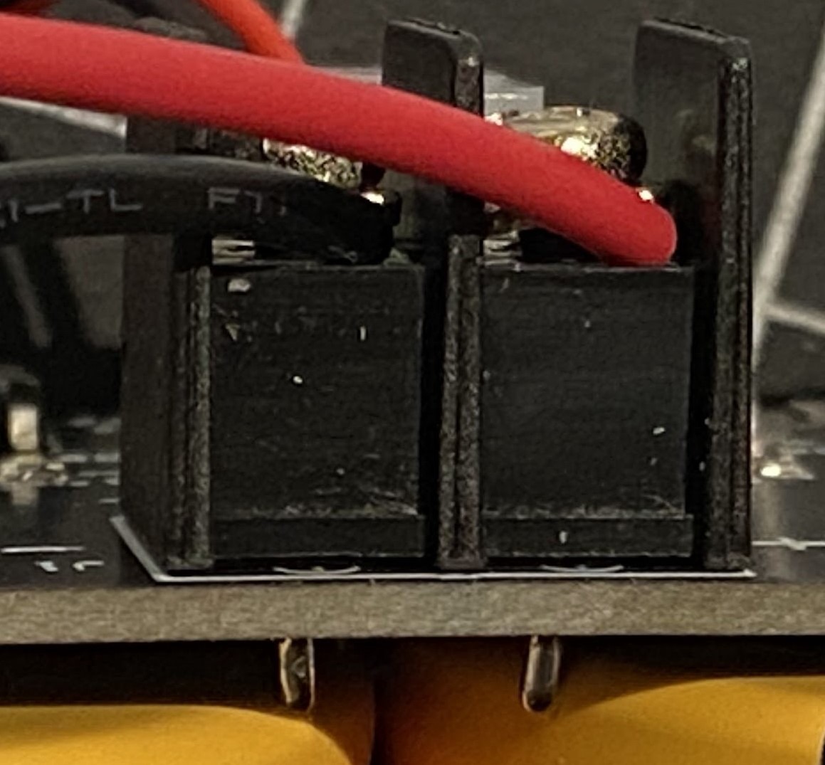

UcPure/UcBalancer troubleshoot case
issue: UcPure in 5V configuration, one of the ultracapacitor can not be charged and always keeps 0V.
Finally the reason was found.
The pins at the back of the UcBalancer PCB touch and break the yellow film of the big capacitor and make a short circuit. Please see the pictures for the case.
Fix:
Discharged all the ultra capacitors to 0V, cut the UcBalancer connector pins it they are too long, or installed more washers. After that it works fine without any problems.

Disabled Account
Joined 2002
Hello,
Screwing the wires onto the terminal already creates the possibility of damaging the plastic cover of the cap.
Sometimes it could take a few weeks for the metal to penetrate the plastic so better have all builds checked.
Of course adding an extra washer will create an extra contact resistance so better fix things properly.
Uc pure board also needs special attention during mounting it seems.
Greetings, Eduard
