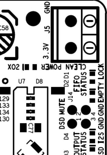

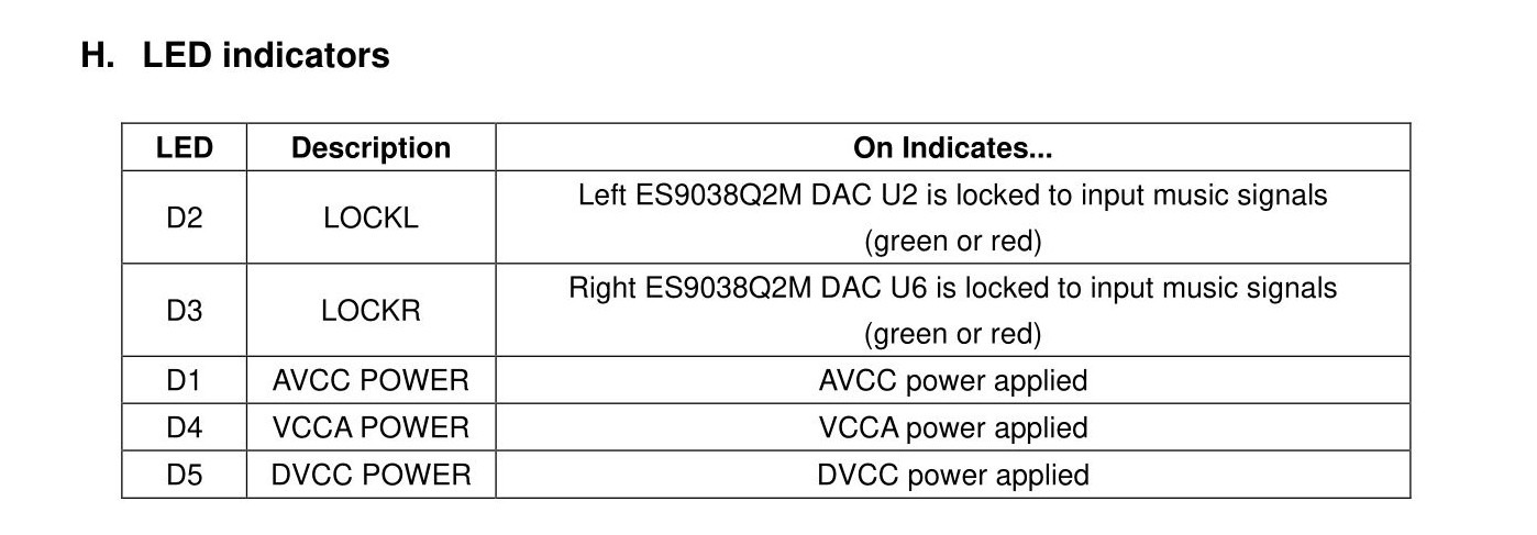

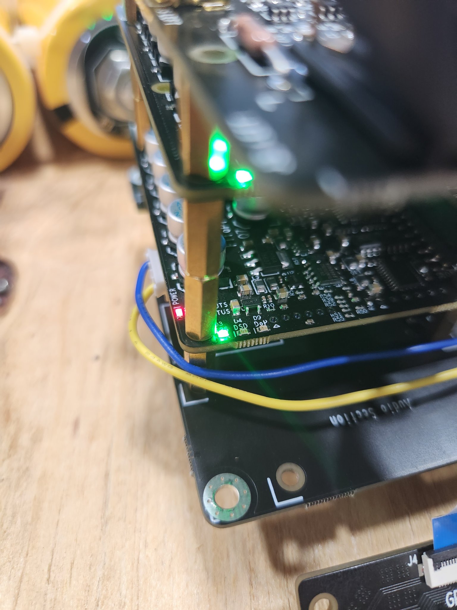

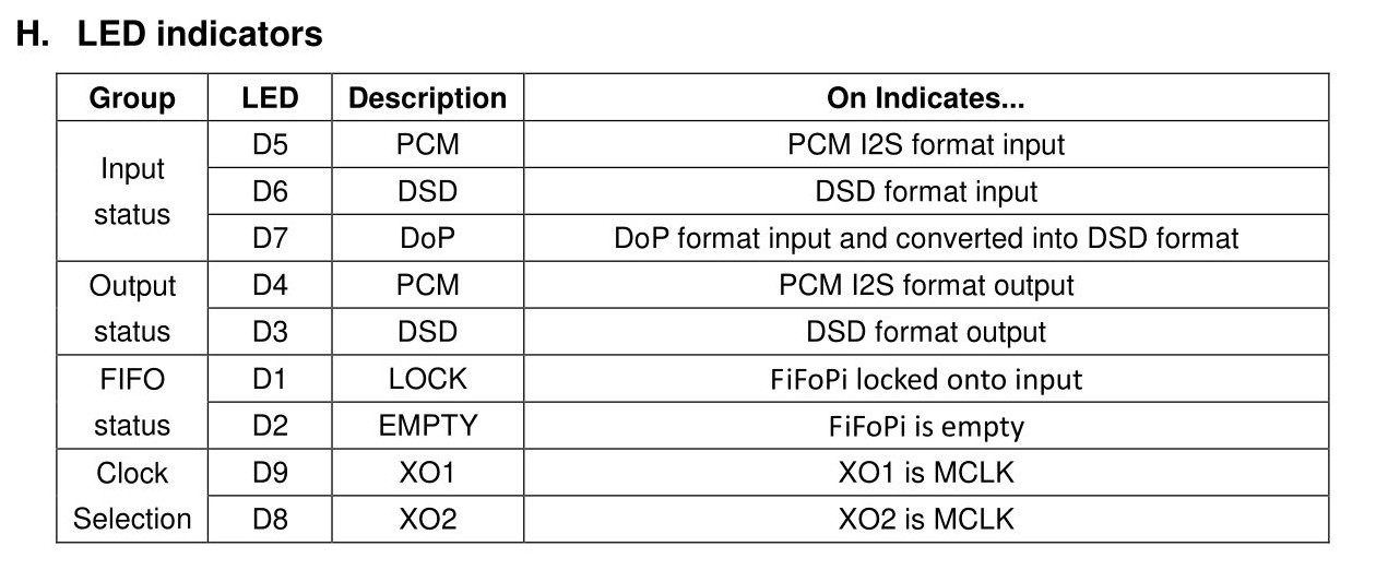

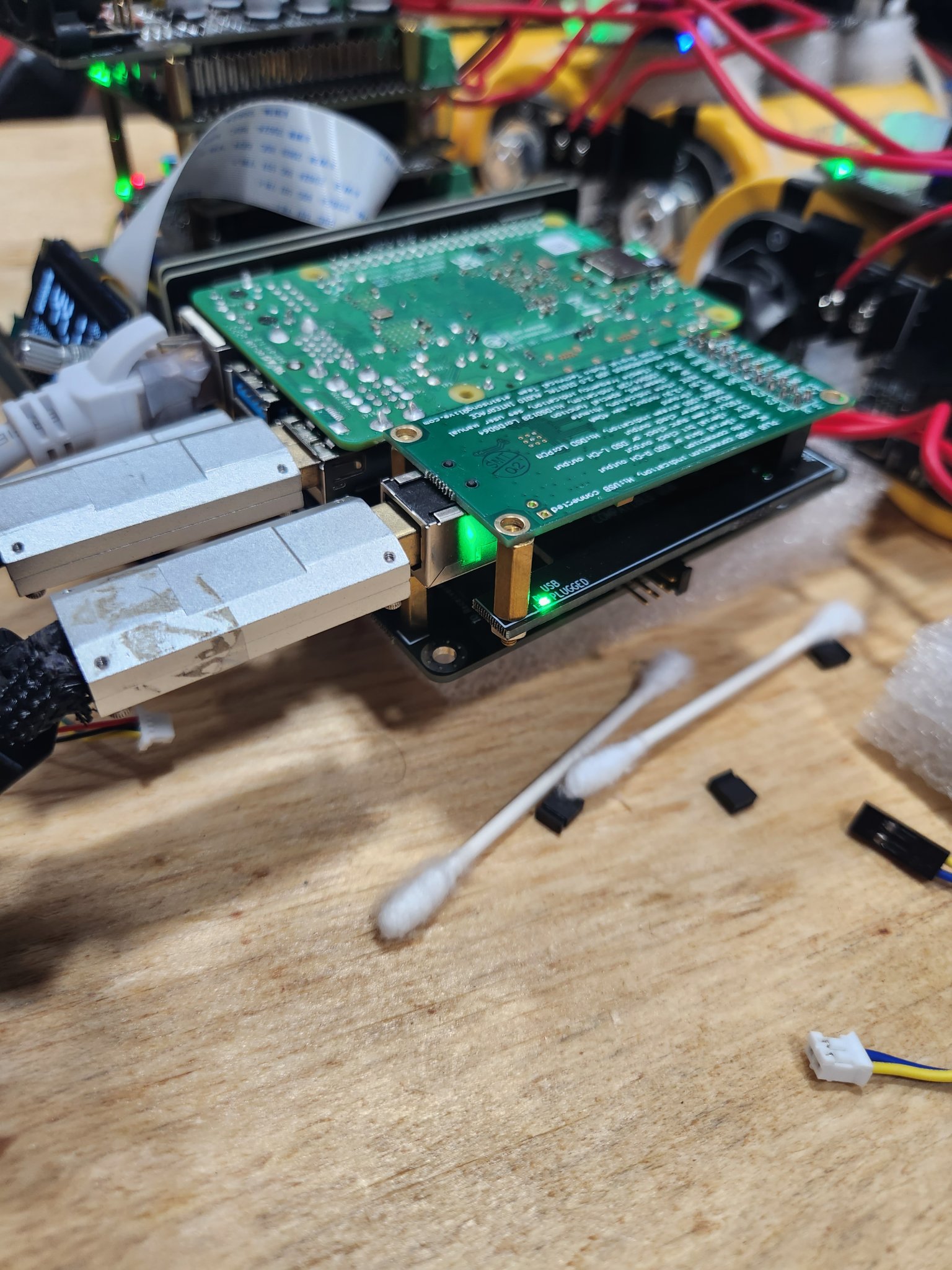

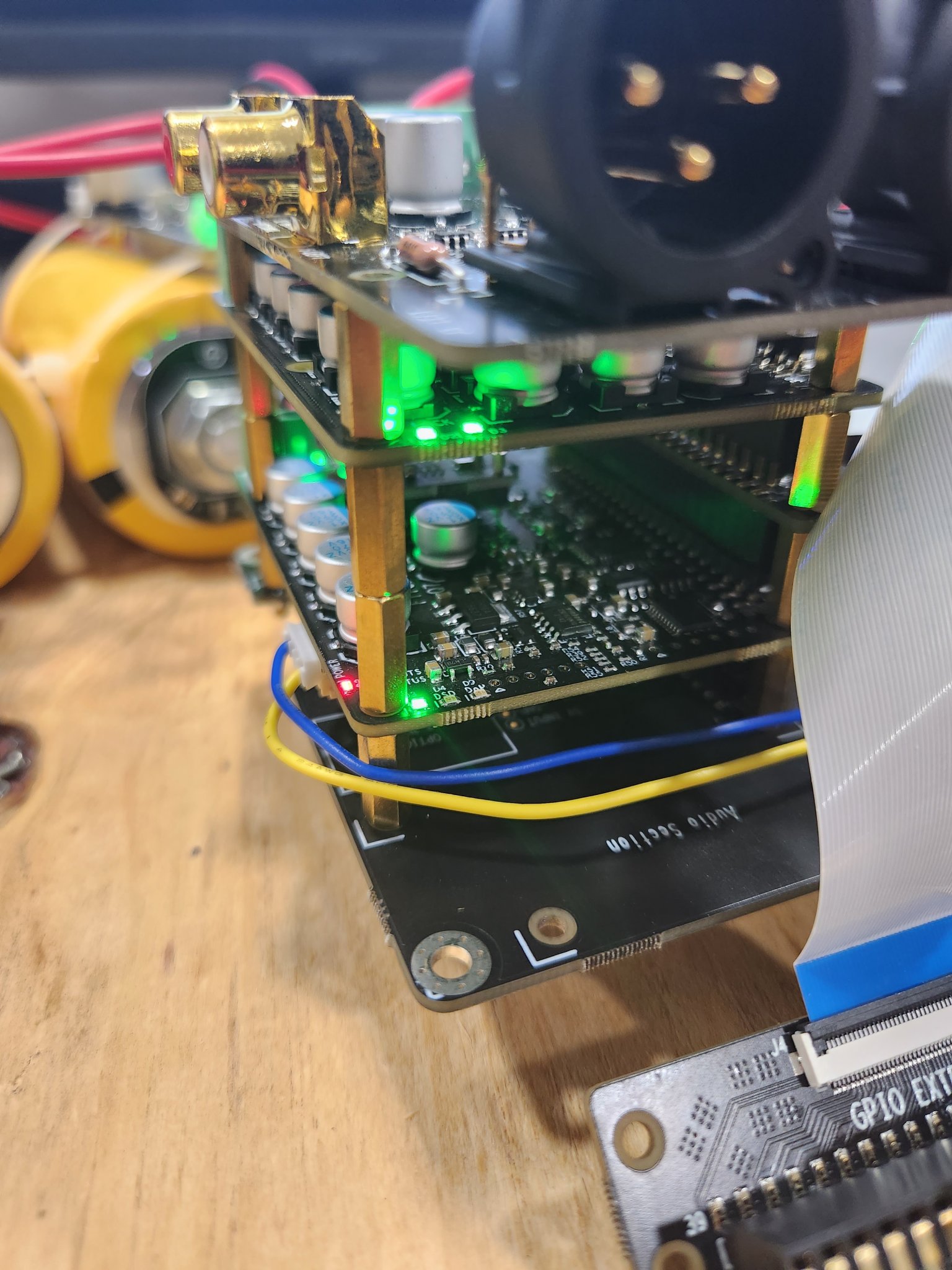

Yes I get correct lock led on dac board, power jumpers are correct. All fiopiq7 led appear correct. Led change to dsd when I send dsd as well.I would start with Volumio and known driver first.
Do you get a “lock” led light on you dual 9038 DAC?

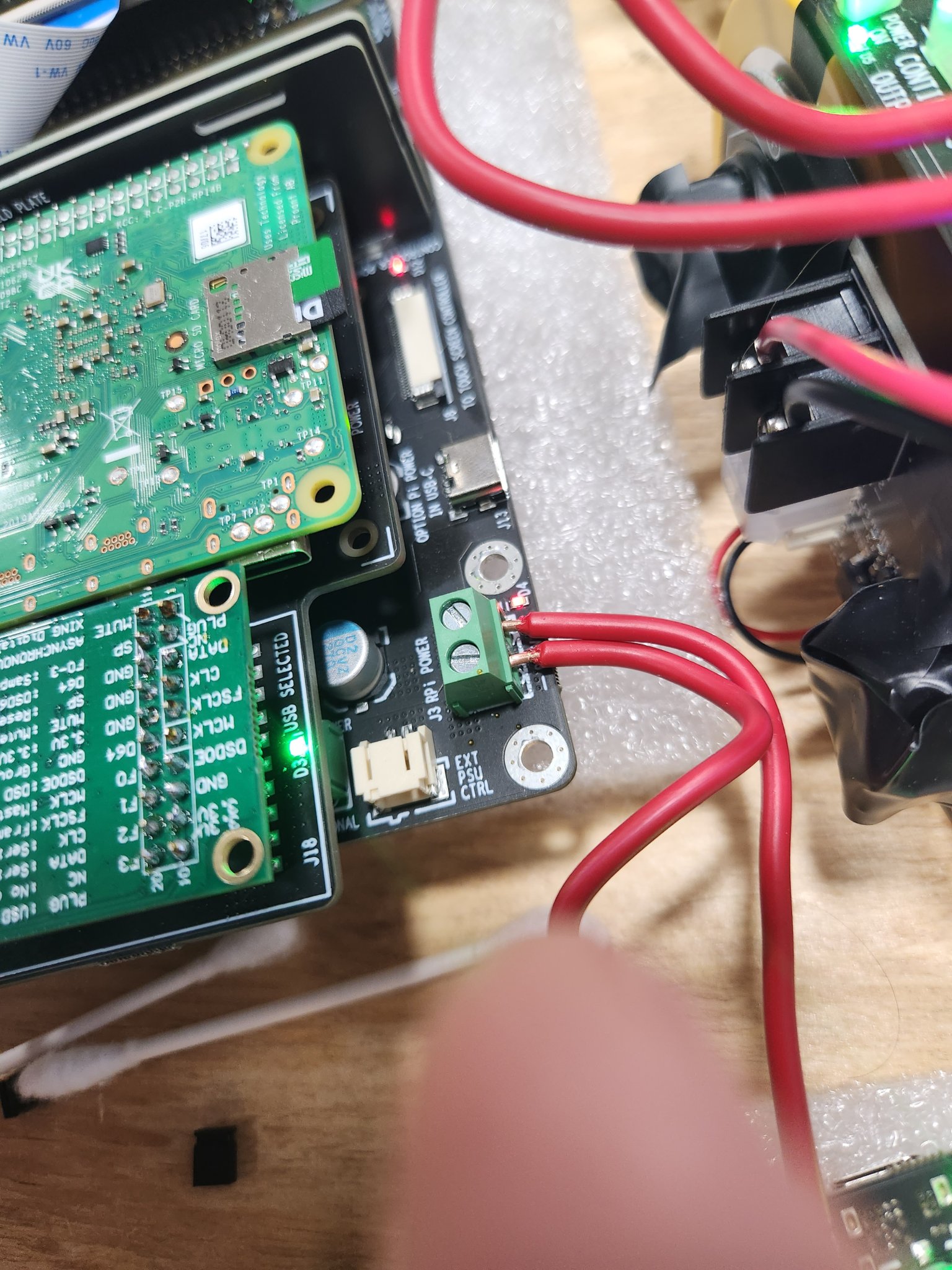

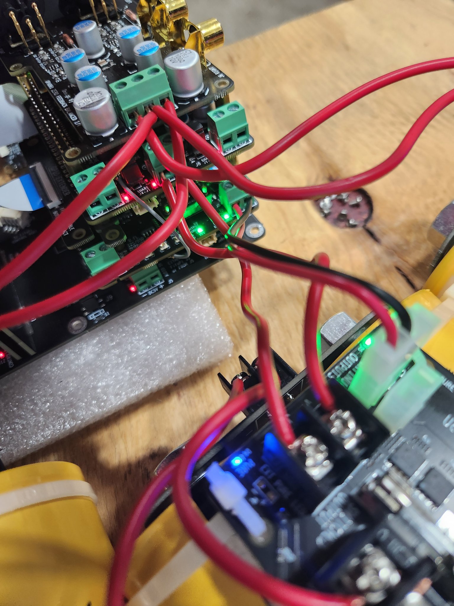

I assume you are using the linearPi to power the Rpi and dirty side of FiFoPi Q7. Have you set the jumpers correctly on the stationPi pro so that single power supply can be used?
This is test build setup, but wire is all red because it's 99.99% sold core 14 gauge copper in Teflon. Will replace with my occ kimber latter. I have checked voltage and wiring very close and everything has power and correct voltage to the i/v board when measured.
Dirty side has a ucconditoner but not in pic as not needed for testing atm.
Rpi4 with gentooplayer and same exact setup works no problem with usb output to another ammenero based dac...although here it's just Rpi4 usb to standalone dac using the ammenero board.
Can someone please help me? I've been trying to fix this four eight hours straight now and I'm about at my end.

I recommend installing Squeezelite so you can squeezelite -l from the command line to list all your available audio devices. Make sure to start the squeezelite service before running squeezelite -l.

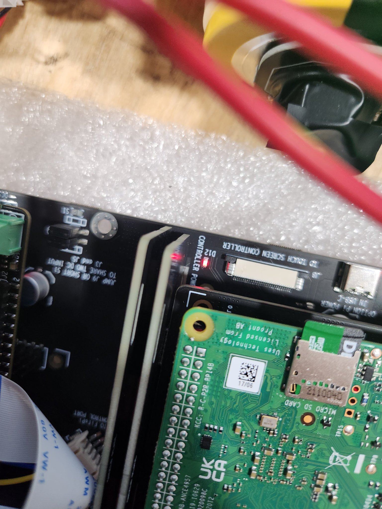

My guess is something to do with a damn mute channel or something... I can't figure it out for the life of me.
A mute issues... Mute cable? Trying now without receiver pi II, using monitor pi pro with ddc off... Can't get this mute on the display to go away no matter what I do, 44.1, higher, dsd, dop natta. Dsd and dop don't show mute, but they just have no sound but lights change correctly...
Does it matter station pi pro shows controller led?

Here's my config.txt snapshop January 2022 or 2023:
As you know, AudioLinux constantly updates so config is dynamic so it may vary present day.
The key here is dtoverlay=rpi-dac and maybe dtparam-i2c_arm,i2s and dtparam=audio=off
I can't remember but if you sqeezelite -l, you should see hw:CARD=sndrpirpidac or something similar
squeezelite is nice to troubleshoot. if your squeezelite.conf is correct with the sndrpipridac driver, your FiFoPi should light up if clocks are installed correctly once you start squeezelite service. If you shutdown squeezelite service, the FiFoPi light should turn off.

Keep an eye out on the results of squeezelite -l for Audio devices. Without the proper driver, I don't think it goes further.
Also, I'm asumming there is a FiFoPi in the chain. If it's just a DAC, I'm hoping it behaves similar to FiFoPi. I'm just hoping a light activates when you start squeezelite with the proper driver.
If the driver shows up in squeezelite -l, once I start a squeezelite service I believe I get a FiFo Lock. Never visually confirmed but there's nothing else that makes sense but a FiFo Status lock. The "D1" LED will activate.
Looks like the DAC is similar to the FiFo:
Sometime, aplay displays your Audio devices too:
- Find driver by locating using squeezelite -l
- Insert that driver into squeezelite.conf
- Start squeezelite service. That should activate D2 and/or D3.

Another possible is power the same or another RPi with the official Raspberry Pi Power Supply, then add just the HAT DAC via GPIO.
If just the base RPi and HAT DAC play nice with one another, you should be able to replicate that on the StationPi.
But be careful as you are in the "Pull Out Your Hair" mode, so patiently disassemble and start fresh.
The StationPi has so much variance because your dealing with 40 pin + 40 pin, if even one pin is off, nada, zilch.
Wish you luck fellow audiolinux, solid core user.
Best approach is just to start from scratch with a traditional stack, but don't add any HATs that are configured for direct 3.3V use. Extremely important as if you shorted any HATs to run only via 3.3V direct, you possibly cannot put those HATs on a traditonal stack.
If the traditional stack works, it's the StationPi GPIO pins.

I had a problem were every thing was connected to the station PI and all the lights were glowing correctly on the FIFOQ7 , butno sound but there was no sound
Have you checked the gpio pins on the station PI are correctly soldered ?Can someone please help me? I've been trying to fix this four eight hours straight now and I'm about at my end.

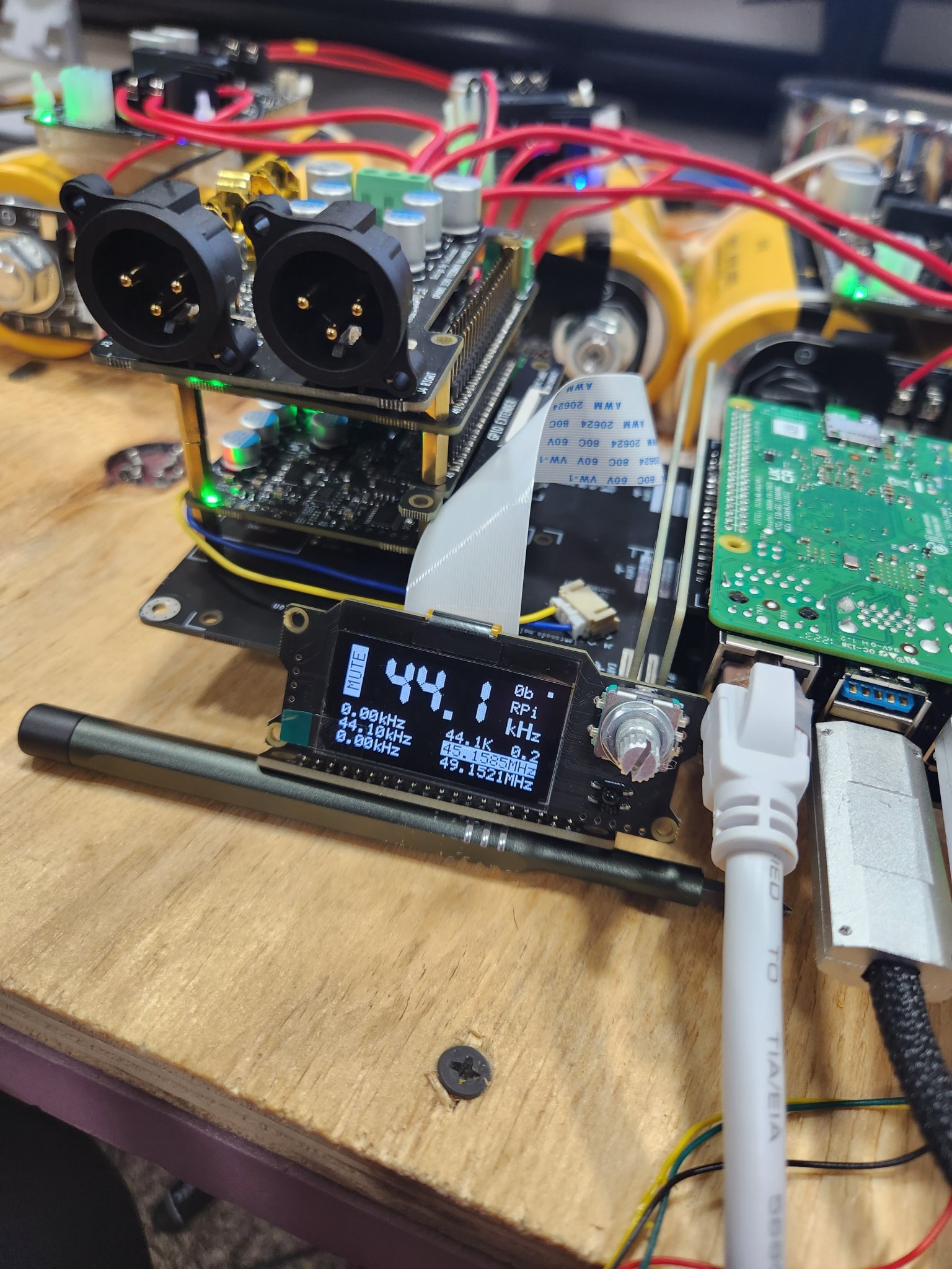

I can't get anything to play thru the opa861 i/v board. Using station pi pro everything is powered correctly.
I've used with and workout a reciever pi 2 using different combos of jumpers at j14 and different ess and monitor pi pro settings. No matter what pcm or dsd with or without dop nothing.
Using only usb input from rpi, fiopiq7 and no dac chip is in the 9038qm mk2 board. Sync cables hooked up correctly. Used with and without j4 control port on station pi pro to fiopiq7.
I've tried a ton of gentoplayer drivers... Including all the rec ones i2s general ect ect.
Please help. Thank you.
