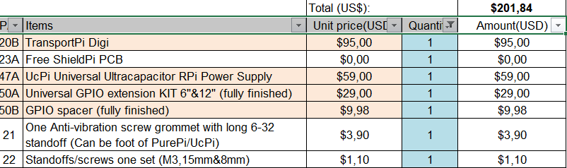

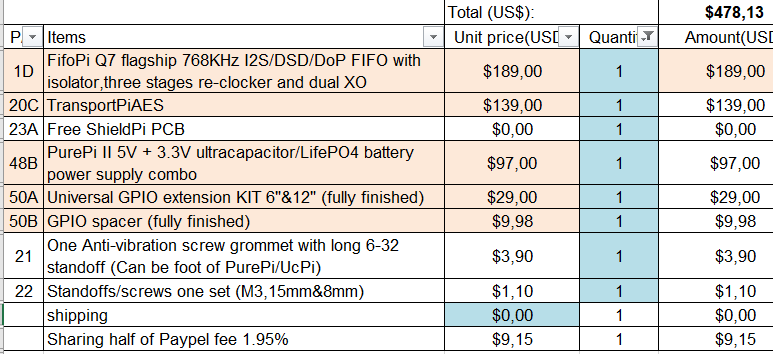

Hi all,
I decided to generally go with extension kit and I picked two setups one cheaper and one a little bit more expensive.
cheaper below
I am still thinking which one to buy. Other question on my mind is should I use GPIO extension kit, would that be significantly better for sound quality?
Extension kit will separate Allo US Bridge SIG from rest of audio boards from Ian.
What do you think ?
Pawel

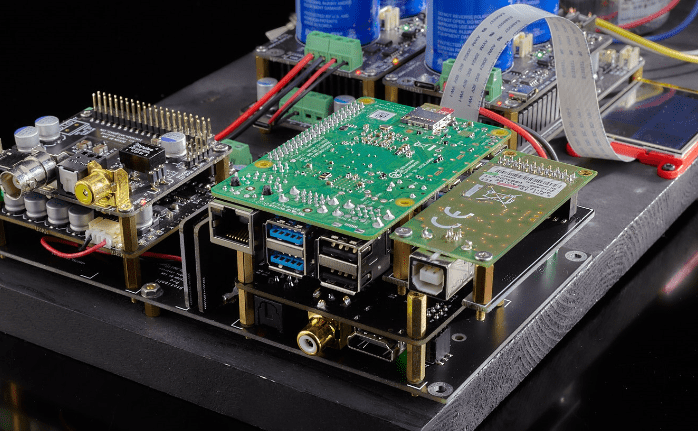

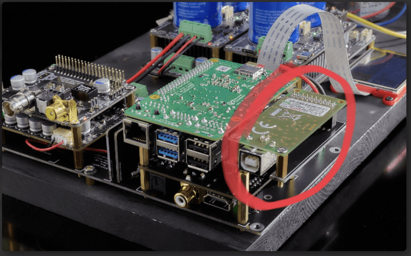

Another question: what is the proper orientation for mounting the Amanero board on the StationPi Pro? USB connector down or up? I see pics on the web of both versions. This one is 'up:
and this one (@iancanada 's own pic) is 'down':
Or maybe the one that Ian is using is not Amanero? It looks different.
I will not start soldering until I am sure 🙂

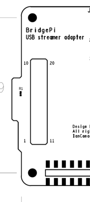

I found the pin numbering (1,11,10,20) on the BridgePi (that I do not plan to use):
However, the StationPi Pro does not show any pin numbering, and it could well be a different orientation as the RPi is mounted upside down on the StationPi Pro.
So I will not risk soldering yet...

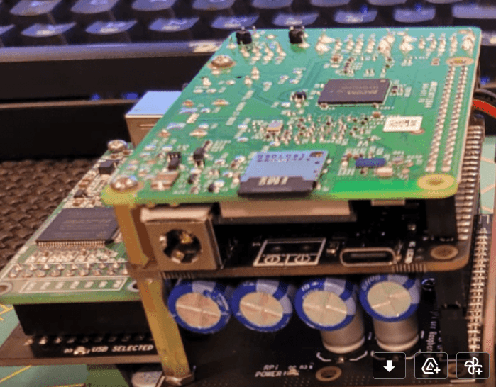

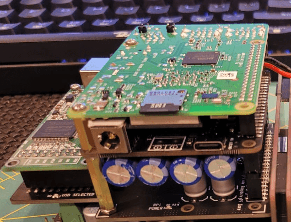

I have an Amanero on my DDC (RPIless) and it is mounted this way On the PiStationPro

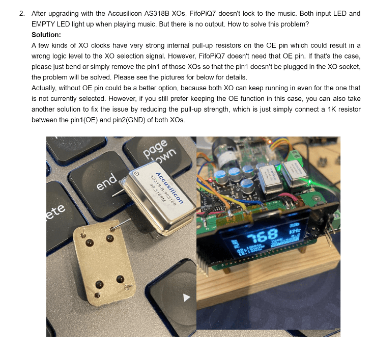

Hello,
I'm using this set up: PurePi, RPi 3b, FifoPiQ7, TranportPi MKII. I wanted to upgrade xo clocks to Accusilicon as318-b 45 and 49 mhz. I've installed them and there was no output. I found a tip in Ian's documentation to bend the OE leg because it can confuse the system, I tried that way too, but still didn't work. Lastly, I tried to install the clocks that came with FifoPi originally and there is no output.
I would be thankful if someone could give some advice.
Thanks,
Dénes
