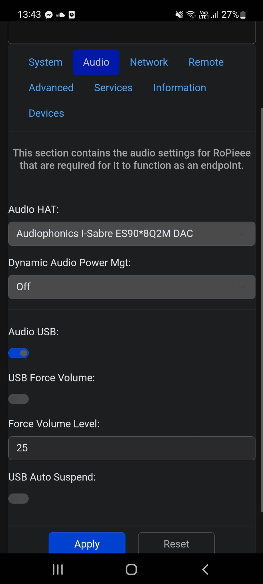

This is no secret. You need an i2s driver to utilize Ian Canada gear. As your external DAC most probably does not have a driver for Linux (i2s) you could use this one (does PCM 384 and DSD DoP 128)
Yes, i selected this one already. However, there is no output from transportpi. Empty led on fifopi is red and it's not showing up as an endpoint in roon.

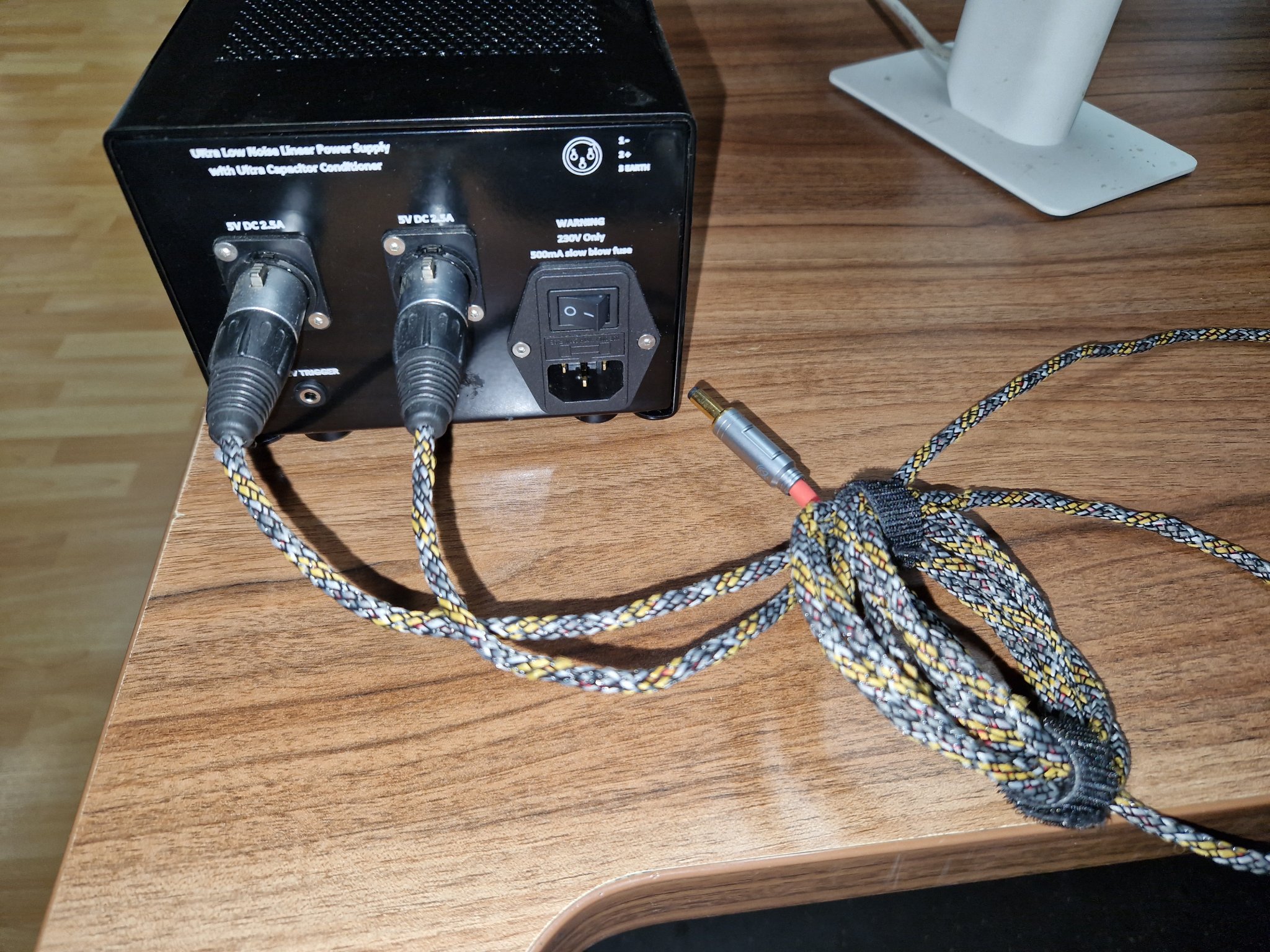

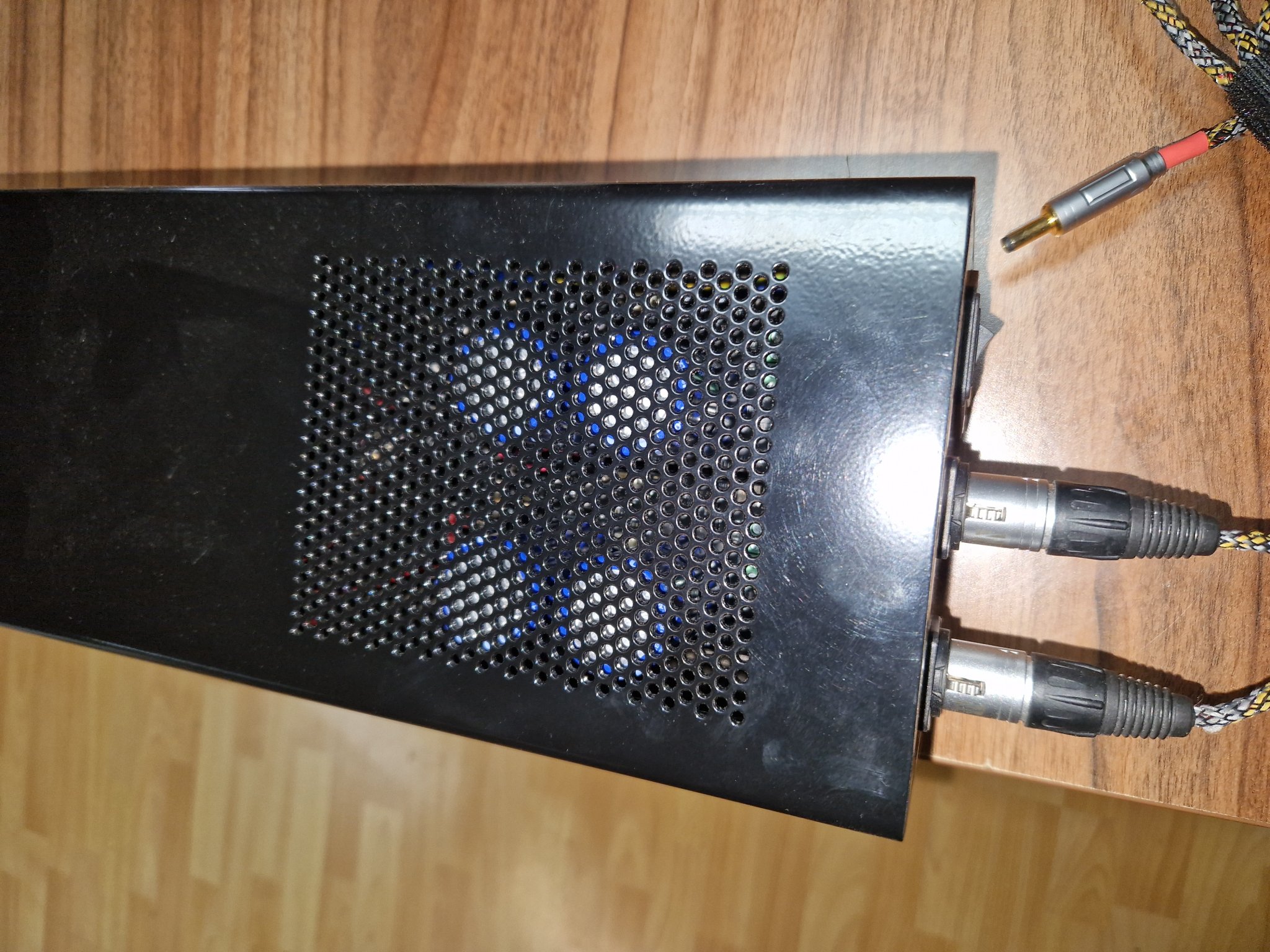

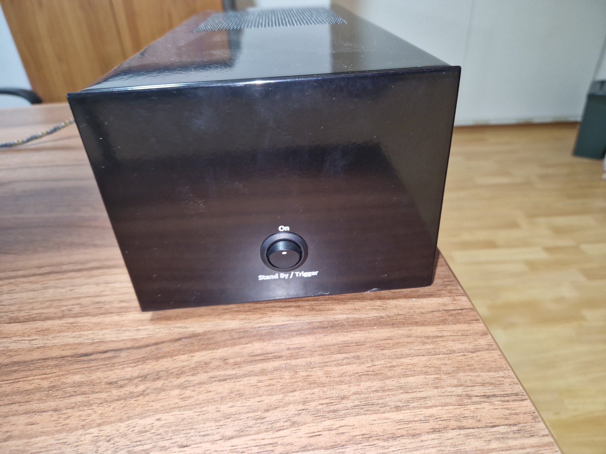

Hello, Hola, Ciao, 你好, नमस्ते , Jambo , Hei, Здравствуйте , مرحباً I have a LinearPi and UCConditioner, and I'm wondering about the maximum distance between them. I'm considering relocating the power supply to a separate enclosure, but I've read that having too much distance between the two components might not be advisable. Can anyone provide guidance on how far apart the LinearPi and UCConditioner can be while maintaining their functionality and performance?
@Ras Dan
I made it, a separate box with a transformer, a LinearPi Duo with two Ucconditioners 5V and 1m cables, and I don't have any problems.
I didn't even connect the kelvin sense and everything works great and stable.

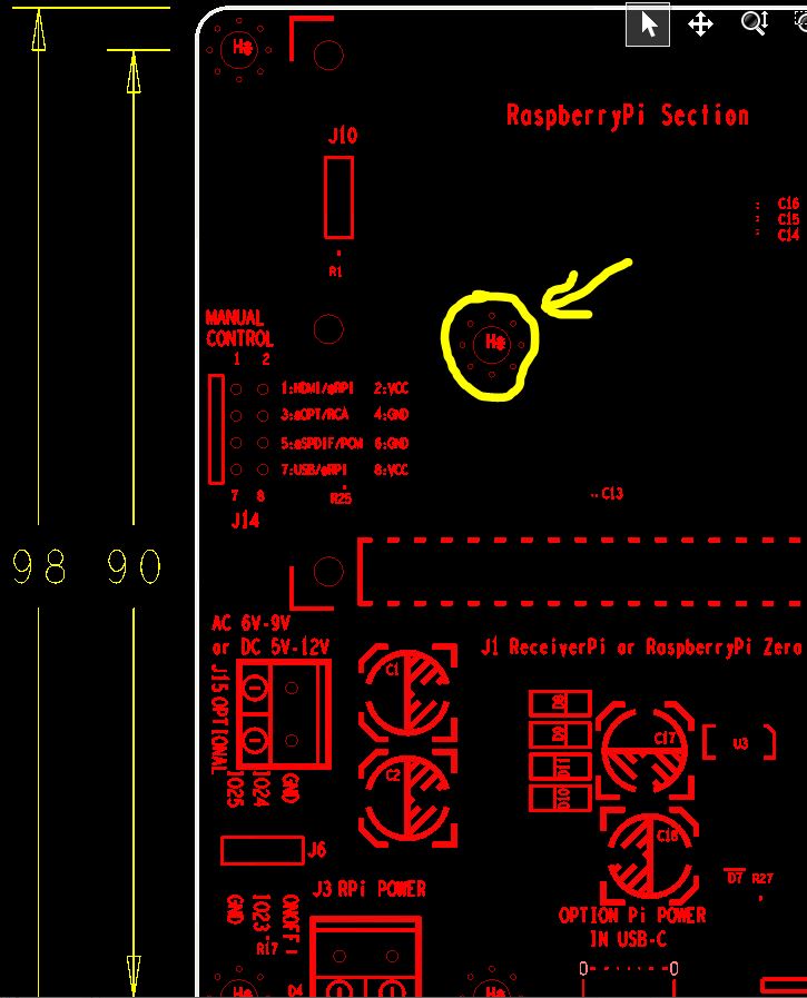

I 'am redesigning my DAC-box. Since it is build in an existing box I 'am not able to measure the mounting holes from the StatoinPi-Pro.
Luckily the manual has a layout published. However it is not complete. One number from a hole is missing.
Please see my attachment and the yellow mark on it. One number is 24 MM (horizontal); do you have the second number (vertical)?
Thank you, Jan
