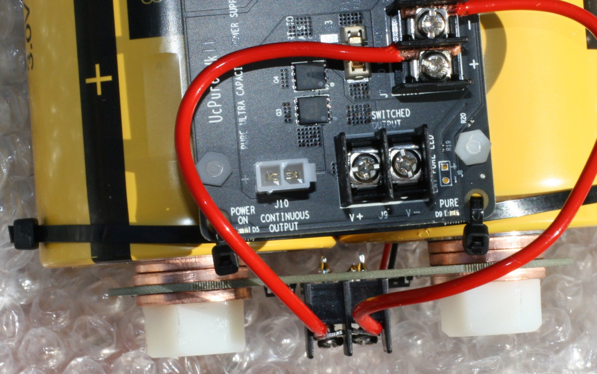

I am worried about the metal standoffs digging in the thin cap sleeve, the Cap Body is Positive The standoff where the nut is located is only separated by Varnish from the - ground of the UCPure.
With a bit of time or bad luck you could have a huge short. I suggest using Plastic Standoffs and strapping the caps independently from the UcPure or different design. Other the that that is a great way to do 15.5V I learned the hard way years ago with a regular cap. Hope I did not hurt any feelings I thought I say something.
Yes, thank you for your concern and advice. Actually, this is Crom's photo not mine:
https://www.diyaudio.com/community/...epo4-battery-power-supply.327105/post-6886105
Yes, I only exclusively use Plastic Standoffs and Plastic Nuts for all my Ian gear since the beginning. I also only exclusively use trusted Brand Name Balancing Boards like Eaton or UcBalancer. That's why I waited years to implement the UcPure since I had the Eaton Balancing Boards on backorder.
I even double washer just to make sure nothing touches the Cap Body:

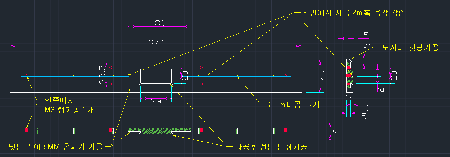

Did you anodize all panels after manufacturing?
Thanks in advance 🙂
Aluminum 8T plate machined, hairline, and silver anodized.

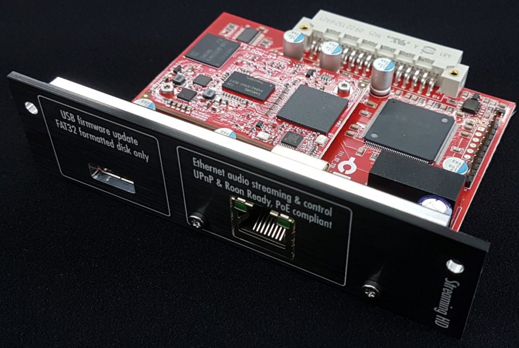

Can you elaborate on the eRED-mod Roon bridge capabilities? Any web based management for configuration? Which are the max capabilities detected by Roon and which are the actual usable with FIFOPI-Q7 (PCM/DSD native/DoP)?
I would expect it to be far better than a RPI for audio purposes and this looks to match your observation so far.
I have noticed this board in the past, however there was not much information available for it and therefore refrained from ordering one.
https://www.engineered.ch/products/ered-mod/
You can get information from the manufacturer's webpage.

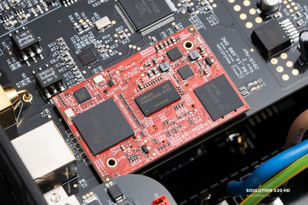

I only connected the I2S output of the ERED MOD to FIFOPI Q7.(12,35,40+gnd)
The same board is used in the ch-precision C1, soulution 330.
digital Media Renderer for stereo audio

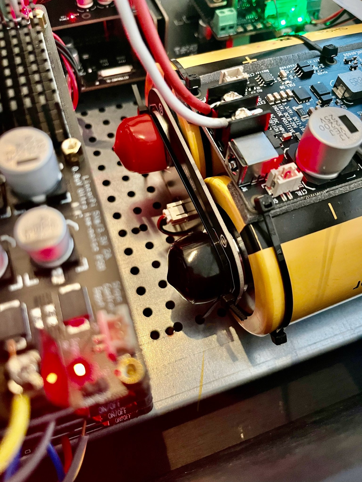

Please Drive, Can you tell me or you buy the Plastic Nuts and the copper washer,thanks.
I documented my UcPure build in the Power Thread as this thread is too fast-moving and a General Thread.
https://www.diyaudio.com/community/...epo4-battery-power-supply.327105/post-7494588
Hopefully, in time, I can document a 15.5V UcPure/UcBalancer Rig as that is sorely needed. Along with adding resistors to build a 12V UcPure/UcBalancer Rig.
I still need to track down the Nylon I used to buffer the Cap Body from the UcPure for documentation completeness later in the week and I'll try to remember to include the Medical Grade Mean Well AC/DC as it's top quality :
