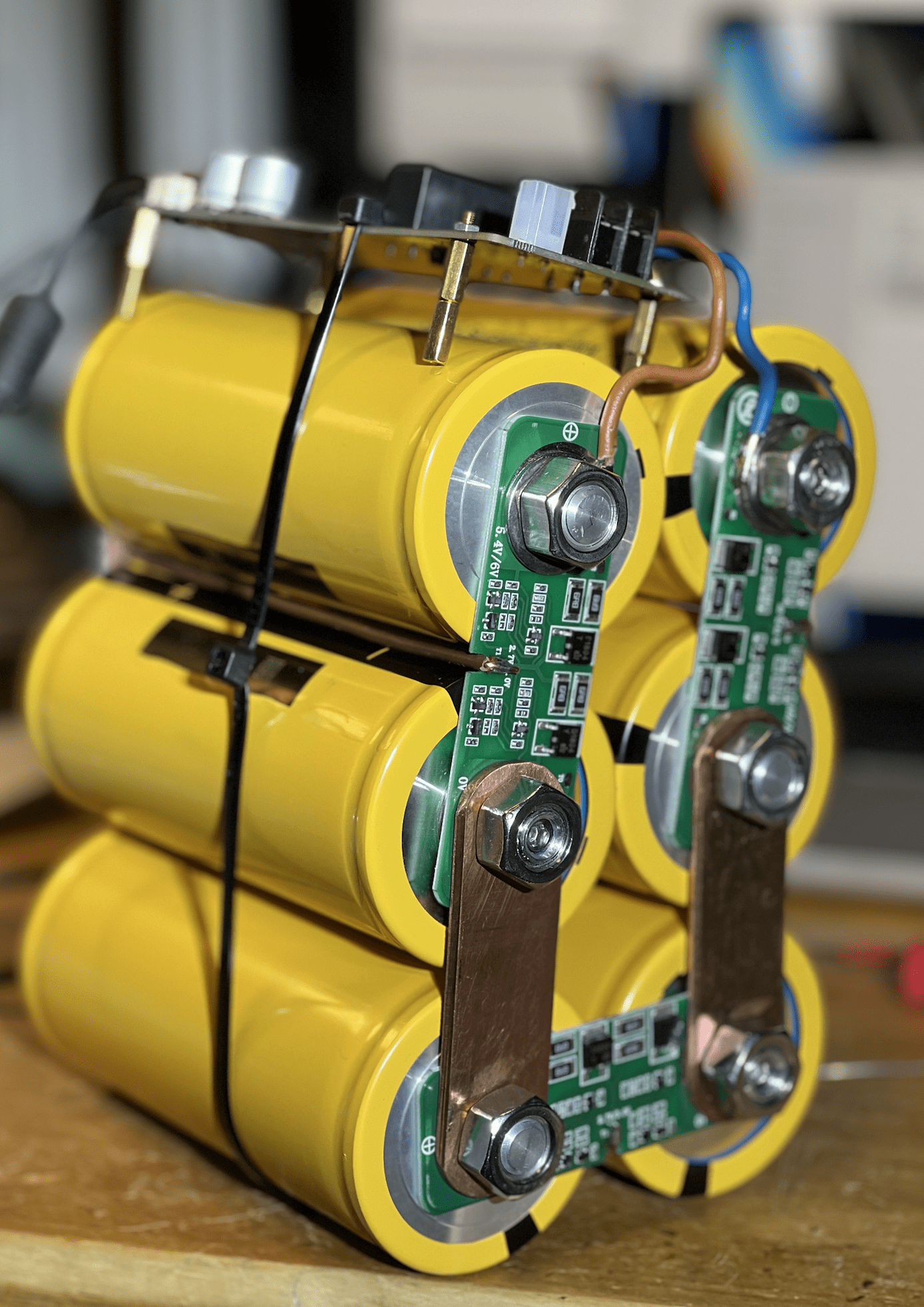

Hi Ian, Hi guys,

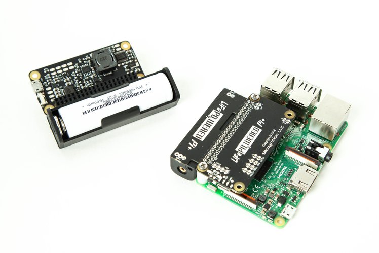

I would like to power a TWTMC-DRIXO and doublers with some spare lifepo mini I have in stock.
2x6.6v and 1x3.3v and I have few questions if you may help me.
1/ is it ok to bridge the 3 lifepo mini to get 16.5v?
2/ do you think this Ac transformer values will be optimal?
Total Power : 103.00VA
Frequency : 50Hz
Primaires:
1 x 0 - 230 V
Secondaires:
2 x 0 - 9 V / 4.5 A (40.50 VA)
1 x 0 - 5 V / 4.5 A (22.50 VA)
Support SF01
3/ subsidiary question
Is it possible to lower the lifepo mini output to 5v?
Will it be better to set 3xlifepo mini lowered to 5v and 3 ucconditionner 5v to power the clock?
Will it increase SQ enough to be worth the price and the work?
Thank you for your help.

Hi Ian,According to the real phase noise test to DRIXO, the best phase noise performance was measured when power it by a UcPure 15V configuration.
Yes I know UcPure are the best(I will use them in my next project).
But for now I have spare Lifepo Mini and my case is not big enough to put UcPure inside.
I read that there is sometime problems with AC powering lifepo if voltage is too high.
Are 9v 4.5A and 5v 4.5A ok for powering lifepo mini 6.6v and 3.3v or is it a better voltage setting.
Thank you

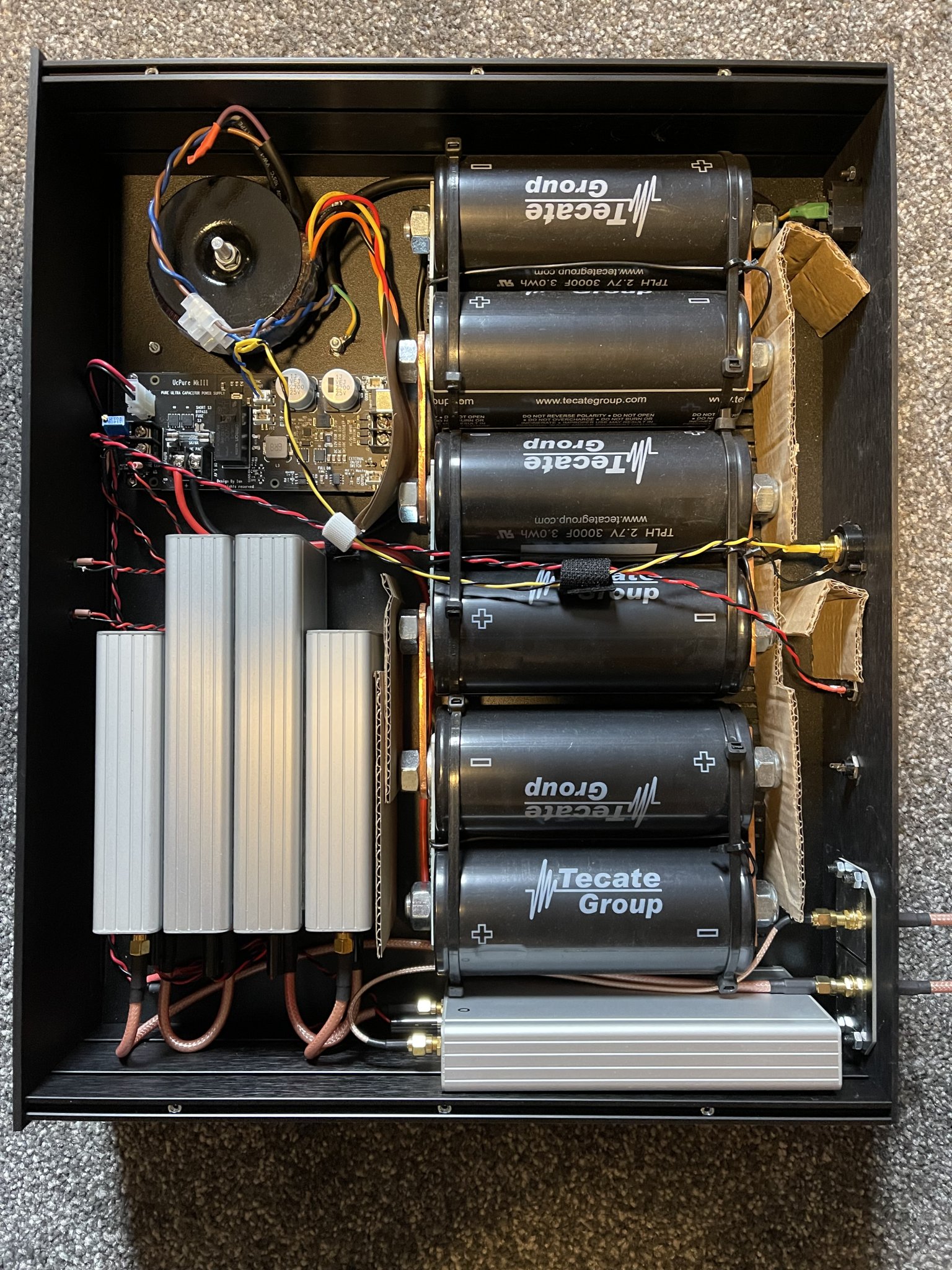

Welcome Back Ian. I really admire how you designed and launched so many products in 2023. It's actually quite amazing. Of course, I will always cherish the most underrated product in the lineup which is the UcBalancer. Having waited for a few years for Eaton Balancing Boards was brutal, so it makes me really appreciate the UcBalancer.
Yes, this is great advice. But I've been distracted from my Primary Rig which uses direct battery and ultracapacitor power and considering a travel / office rig. There will have to be some compromises. There are some that still use legacy Ian products and finding ways to re-purpose. Not all of us are implementing the latest and greatest Ian gear as the legacy Ian gear is still durable and of excellent quality.
As the Group Buy is nearing an end, I tend to get distracted.
So for this distraction, I'm considering a off-the-shelf Battery Pack -> PurePi MKII -> RPi4 -> Q3 -> SC-PURE -> RCP -> TransportPi MKI.
I like your Reservoir analogy of an ultracapacitor so if I feed the PurePi MKII, any noise from a off-the-shelf 5V Battery Pack should be filtered in this reservoir before it hits the Q3 stack.
Please ignore the UPS, that is an archived project. It's now used in a RC Car. Because of the difficulties with Air Travel with Batteries and Ultracapacitors, battery packs work out because of it's commonality. So if I want a traveling Ian rig, off-the-shelf Battery Pack is the most optimal for I. So direct battery or ultracapacitor via an Ian product is not an option for Air Travel use cases.
Maybe I'll go back on focusing on my Primary. I hate getting distracted but I had the itch to Travel lately since 2024 is approaching.

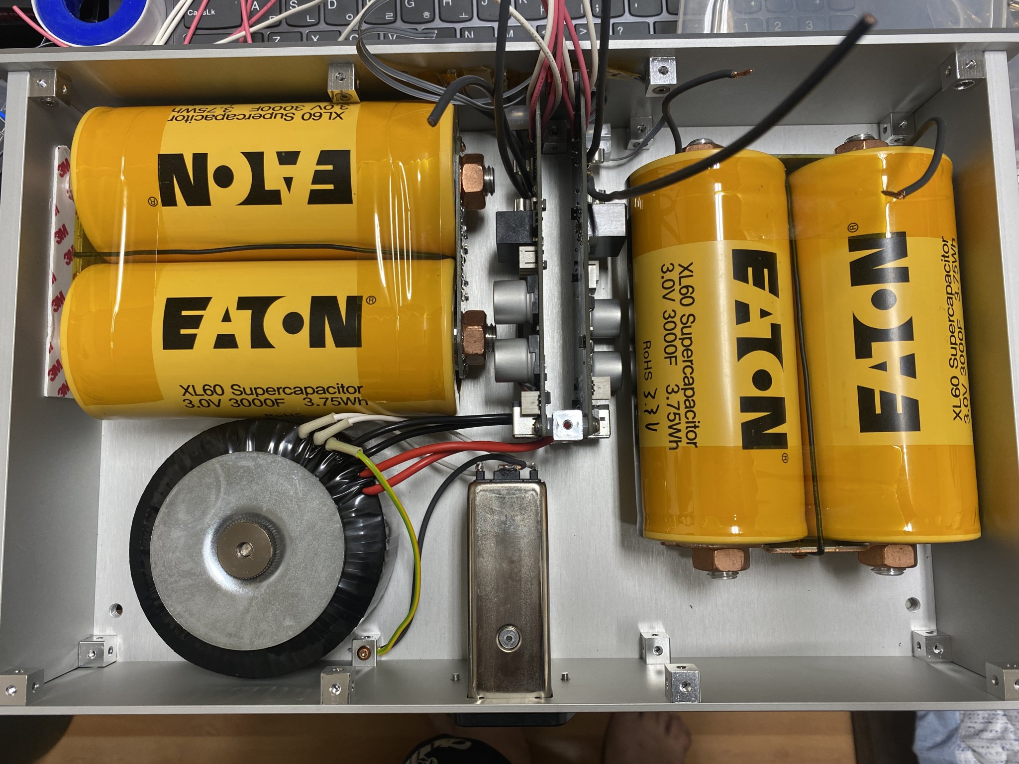

There's no documentation on a UcPure/UcBalancer 15.5V build yet? I'm considering UcBalancers for the Group Buy. I already have a UcPure MKI for this purpose.
If you are using UcBalancers, quantity 3 UcBalancers sound about right? I don't expect those with UcPure in production to have upgraded to UcBalancers this Summer. Thxs.
DC input doesn't directly affect the pure 3.3V battery output of a PurePi. However it may affect the 5V ultracapacitor output quality. And if you use a SMPS, small amount of EMI noise may across the isolation barrier through air. So, in any case, Linear DC input is always preferred as long as it is possible.

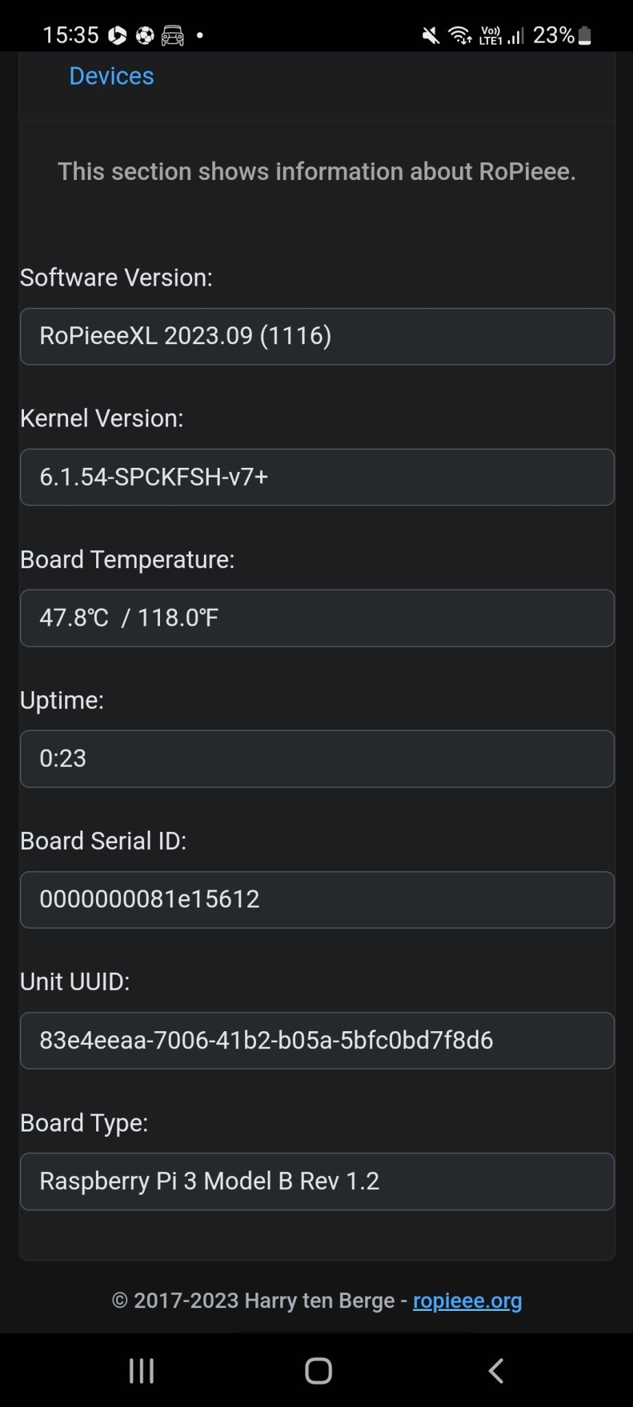

Hello,
I'm building purepi, rpi, fifopi q7, transportpi mkII setup.I would like to use it as a roon bridge with ropieee xl.
I've been using it without HATs and bridge would only show up in roon if the usb dac was connected. Now, I installed the HATs, connected clock and power cables, changed ropieee settings to audiophonics HAT as described in Ian's documentation. I connected a digital coax cable to transport pi, however it isn't showing up in roon as an endpoint and there is no output. The "empty" led is red on fifopi, only the power led is lighting on transportpi.
I would like to ask for some help, thank you in advance.
Thanks,
Dénes
Thanks,
Dénes

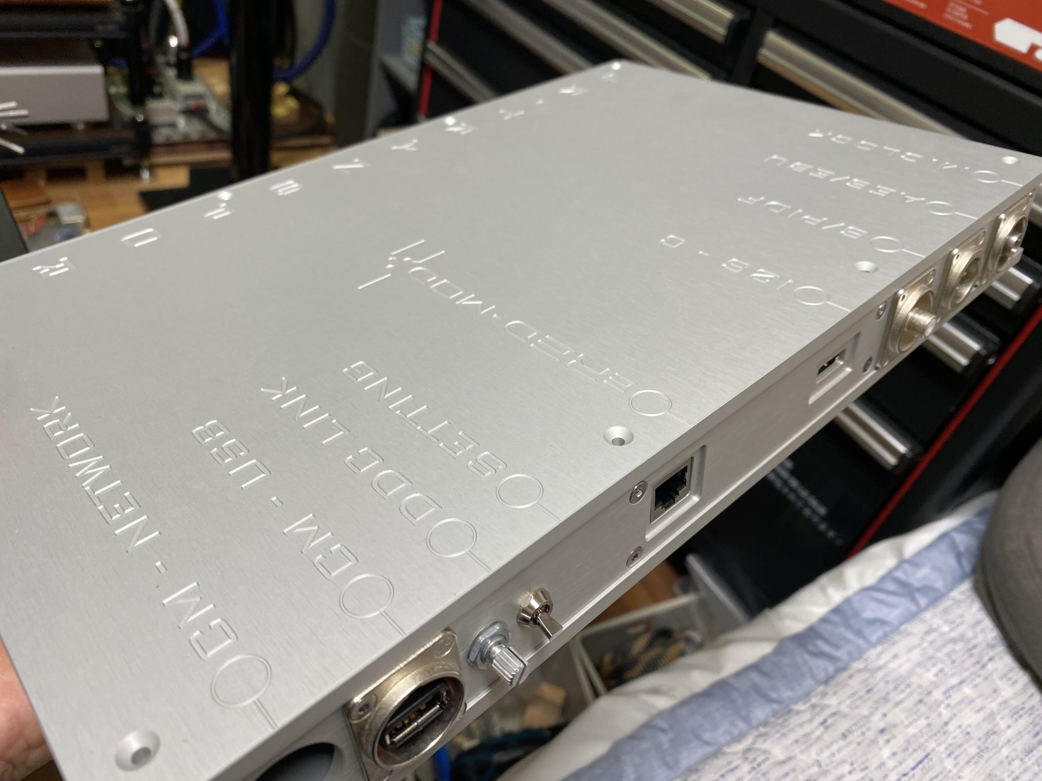

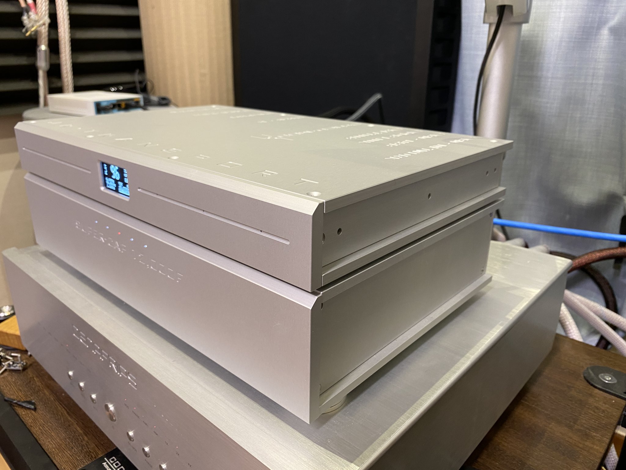

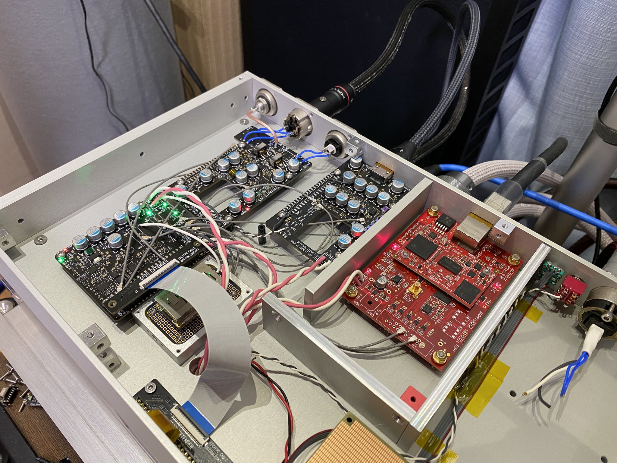

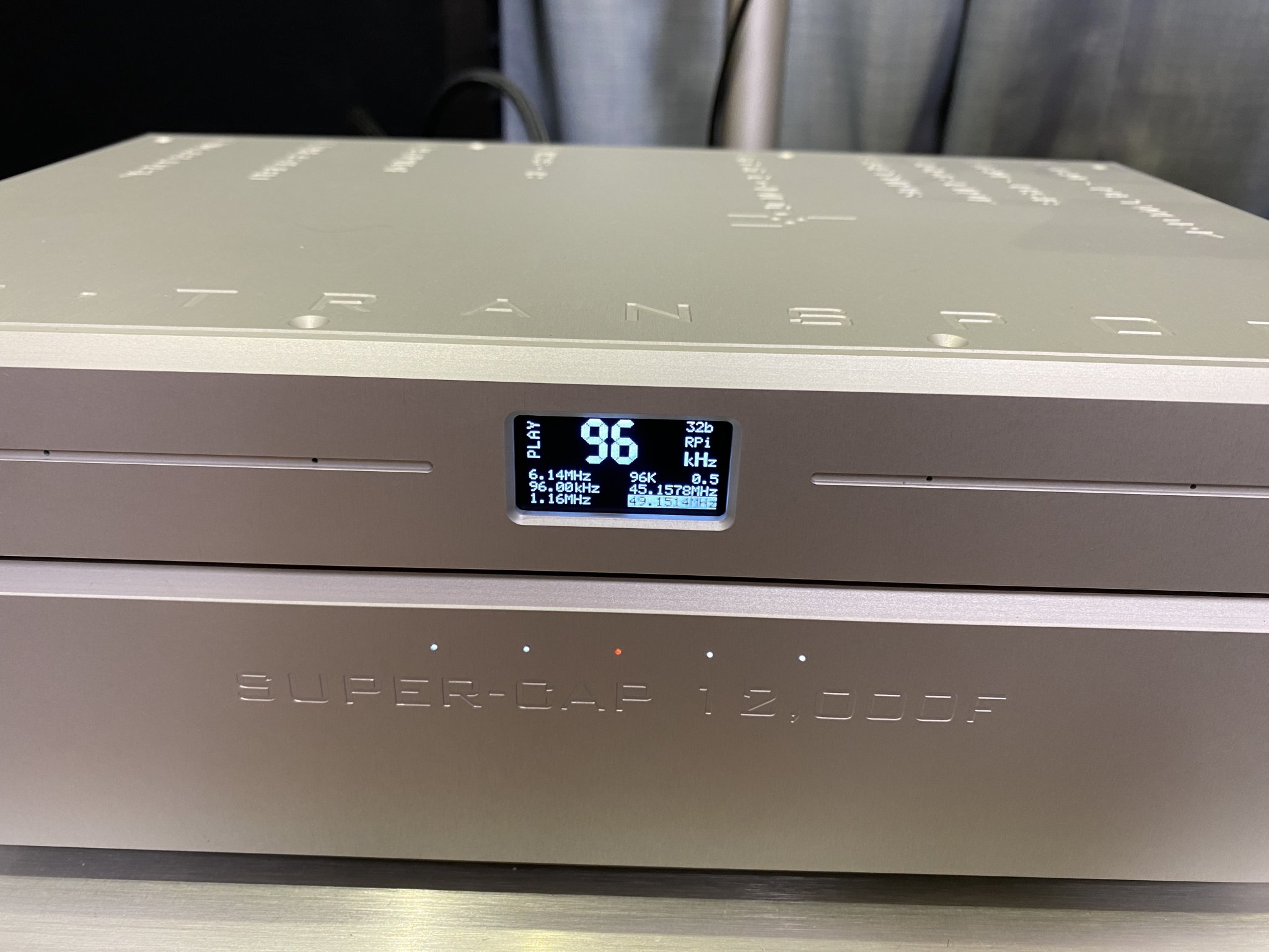

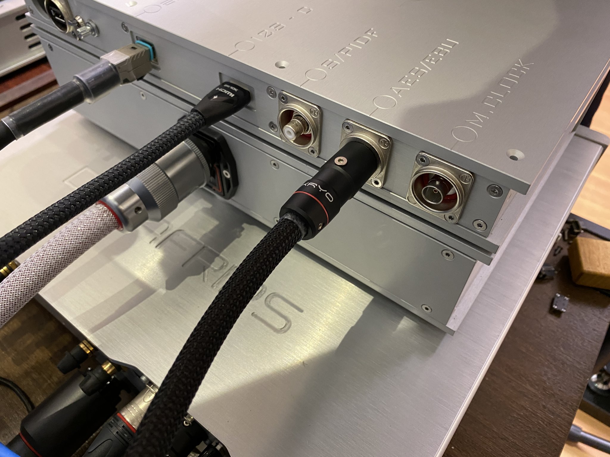

hello
i have completed the streamer case.
I made one more case for the uc-pureIII for power.
I have connected all the wires needed to make it work.
I haven't mounted the raspberry pi module yet.
For now, it only works with eRED-mod.
It works perfectly with roon, tidal, and qobuz.
I put in power and wait for the SC-PURE clock to warm up.
Music is more realistic and fine details come to life.
Comparison of the CCHD957, NDK2520SDA, and sc-pure.
sc-pure is the best for fine detail.
The control buttons on the MonitorFi Pro have been moved to the back.
There's still a little more work to be done, but I'm happy with the sound quality.
FifoPiQ7
TransportPiAES (sc947-02lf)
HdmiPiPro
ScPure 45,49
UcPure III
MonitorPiPro

You need to configure an audio HAT. You can use Audiophonics 9038 driver.Hello,
Thanks,
Dénes
Can you elaborate on the eRED-mod Roon bridge capabilities? Any web based management for configuration? Which are the max capabilities detected by Roon and which are the actual usable with FIFOPI-Q7 (PCM/DSD native/DoP)?hello
With a bit of time or bad luck you could have a huge short. I suggest using Plastic Standoffs and strapping the caps independently from the UcPure or different design. Other the that that is a great way to do 15.5V I learned the hard way years ago with a regular cap. Hope I did not hurt any feelings I thought I say something.

Here is my setup…..There's no documentation on a UcPure/UcBalancer 15.5V build yet? I'm considering UcBalancers for the Group Buy. I already have a UcPure MKI for this purpose.
