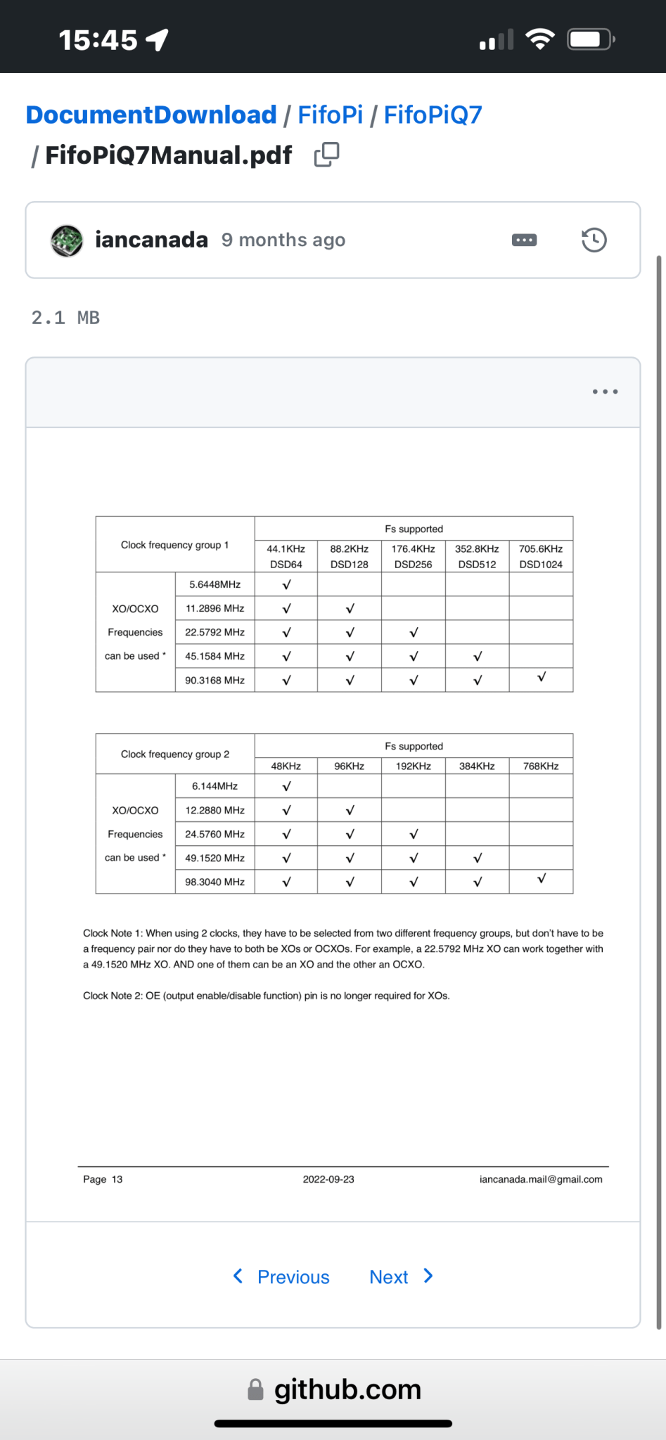

On another topic: is there a table somewhere that shows the correlation of possible/maximum resolutions (PCM 44-384 and DSD 64-512) and clock frequencies (22.5792, 24.5760, 45.1584, 49.1520)? I searched for it but just found some conflicting information.
Reactions: Yveskoala
FiFoPiQ7 manual
