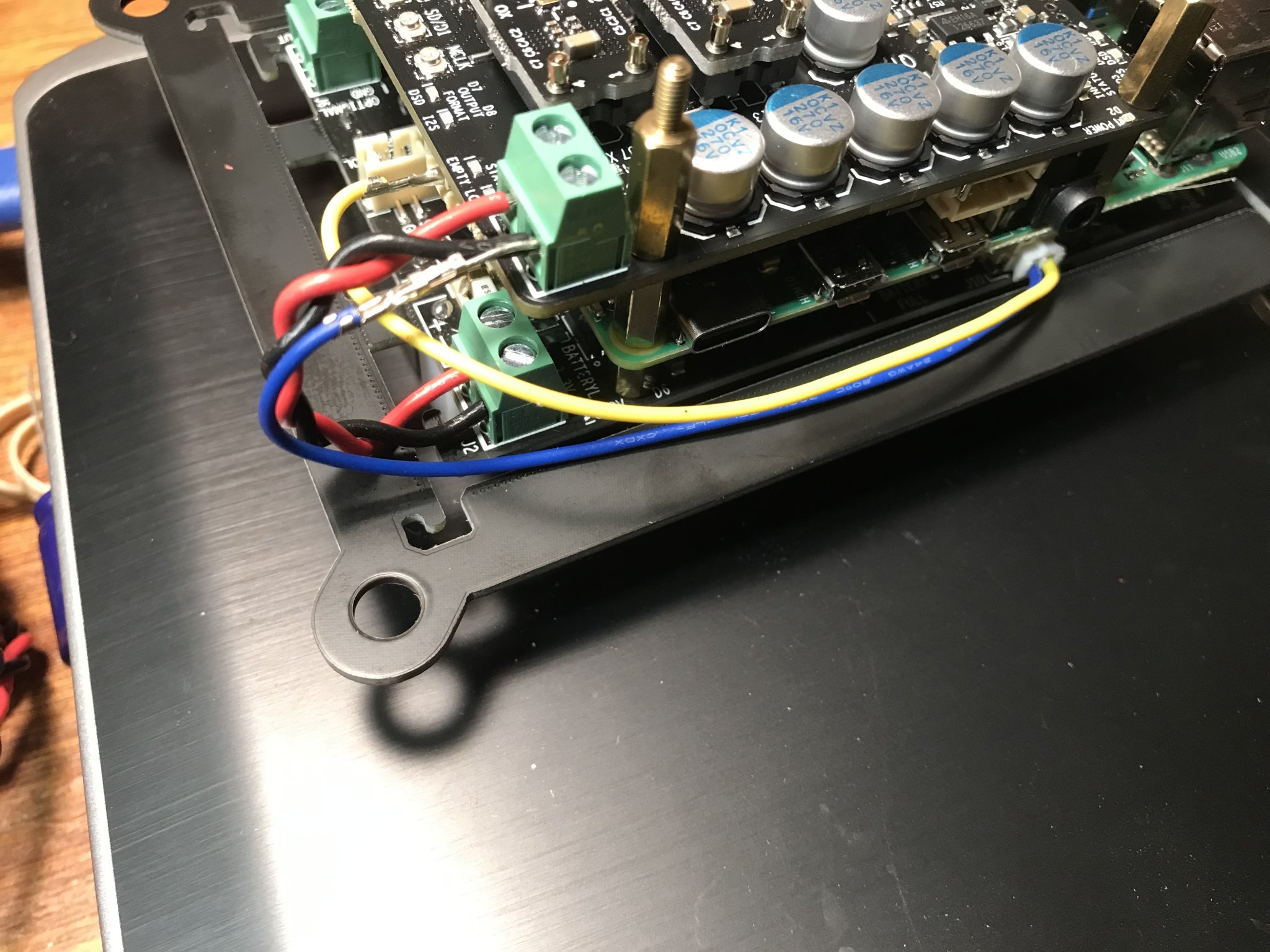

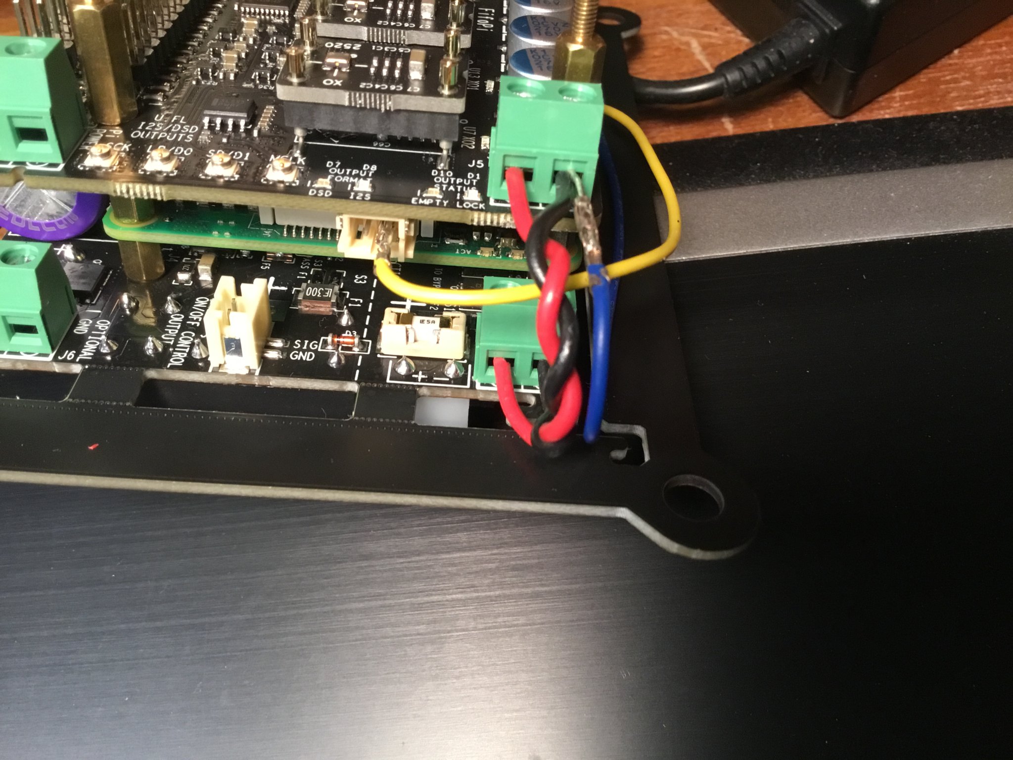

Can anyone tell me if this combo works or not without external DC 5V power supply?
Amanero works without external power because USB feeds it with 5V, but there is only 3.3V pin on the Amanero pin which is connected to the BridgePi.
BridgePi then feeds the 3.3V power to the TransportPiMKII, but TransportPiMKII needs 5V not 3.3V as I know.

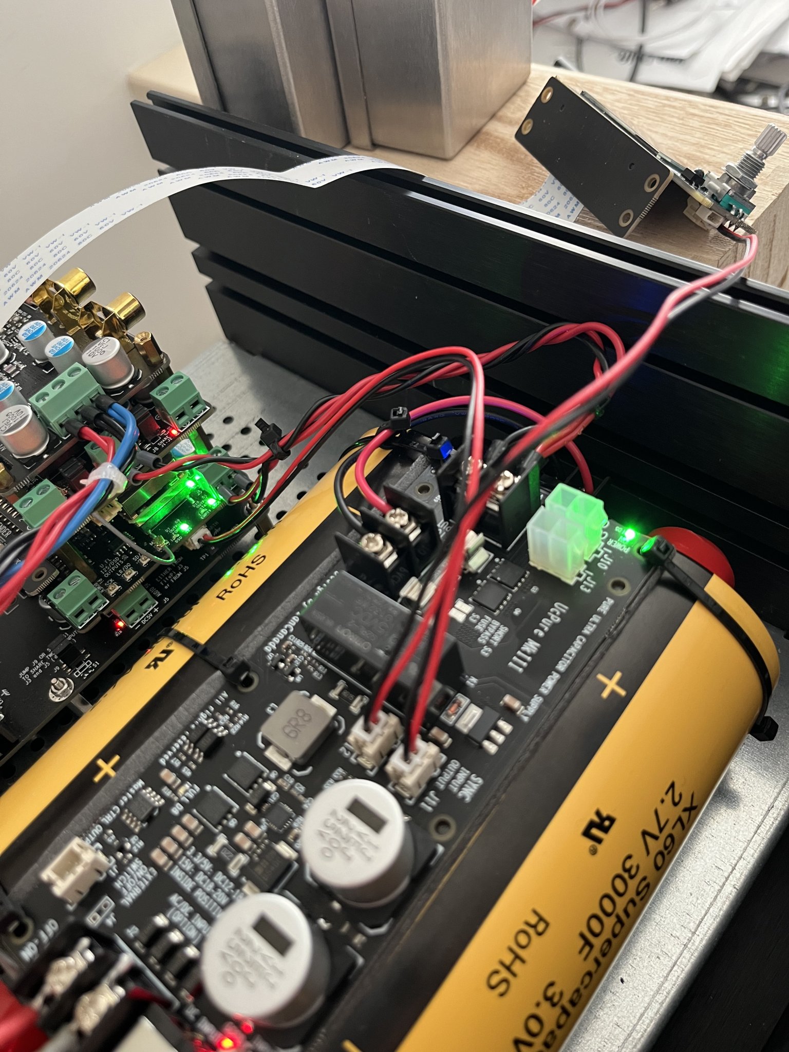

See my attachment. I have the UcPure connected to Fifopi and MonitorPi Pro. You can connect the corresponding connectors.I’m wondering how you connect the SYNC control from the PurePI to the Fifo PI Q7 Without the Monitor PI?
like this?
thanks
Works excellent.

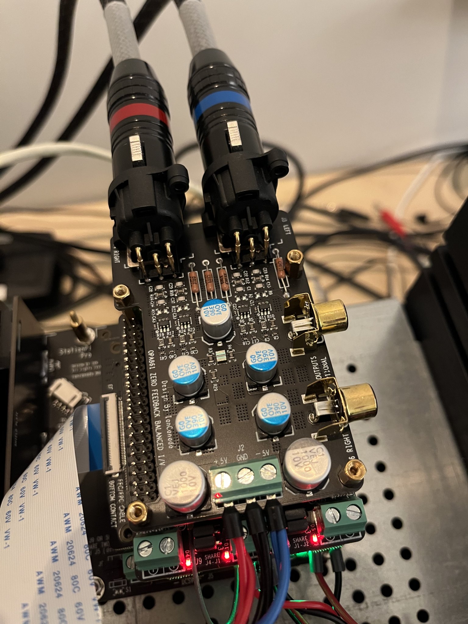

Can you add xlr /rca out to this with out RPi?ReceiverPi DDC based Flagship full-input RPi free DDC streamer

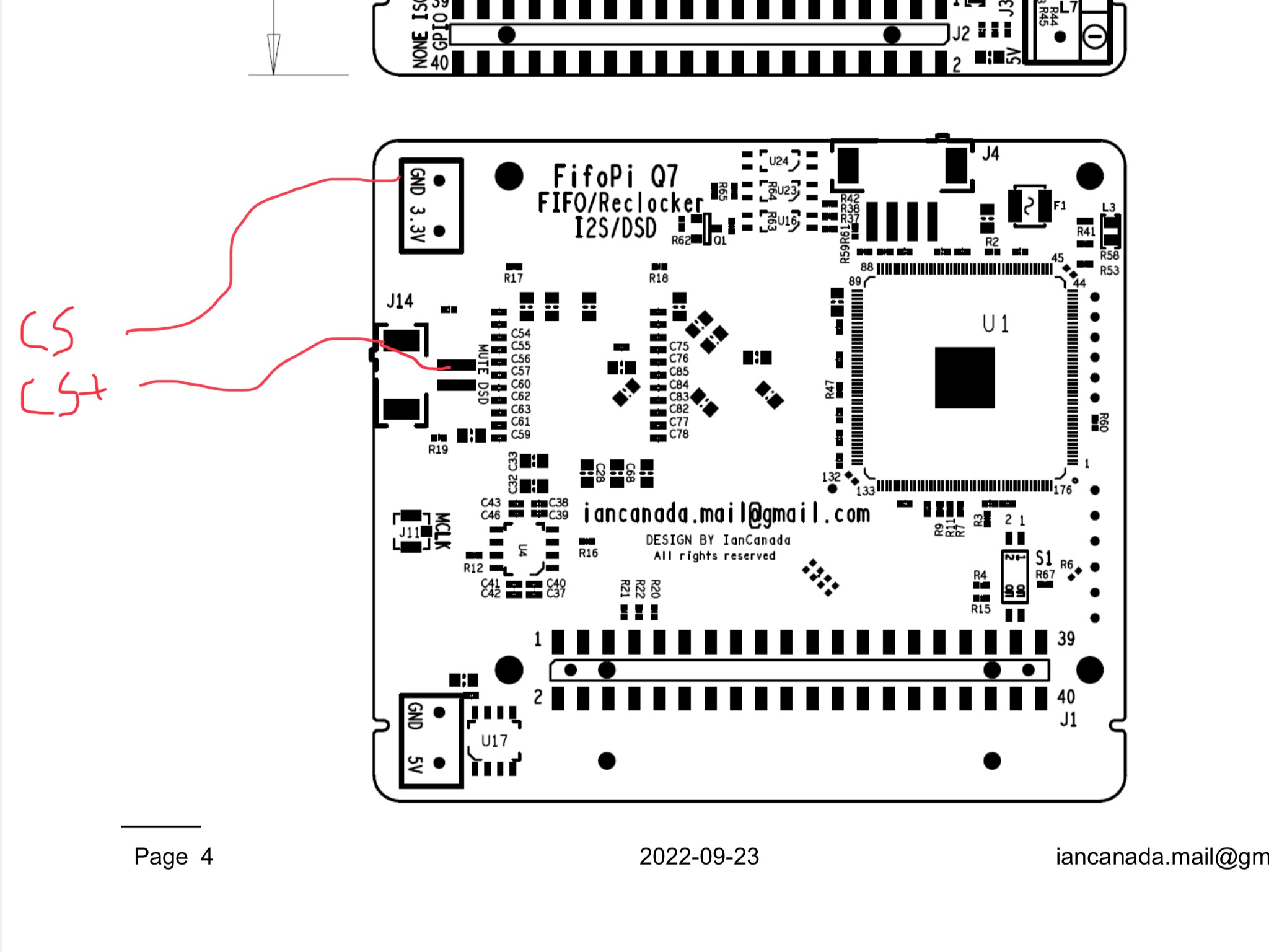

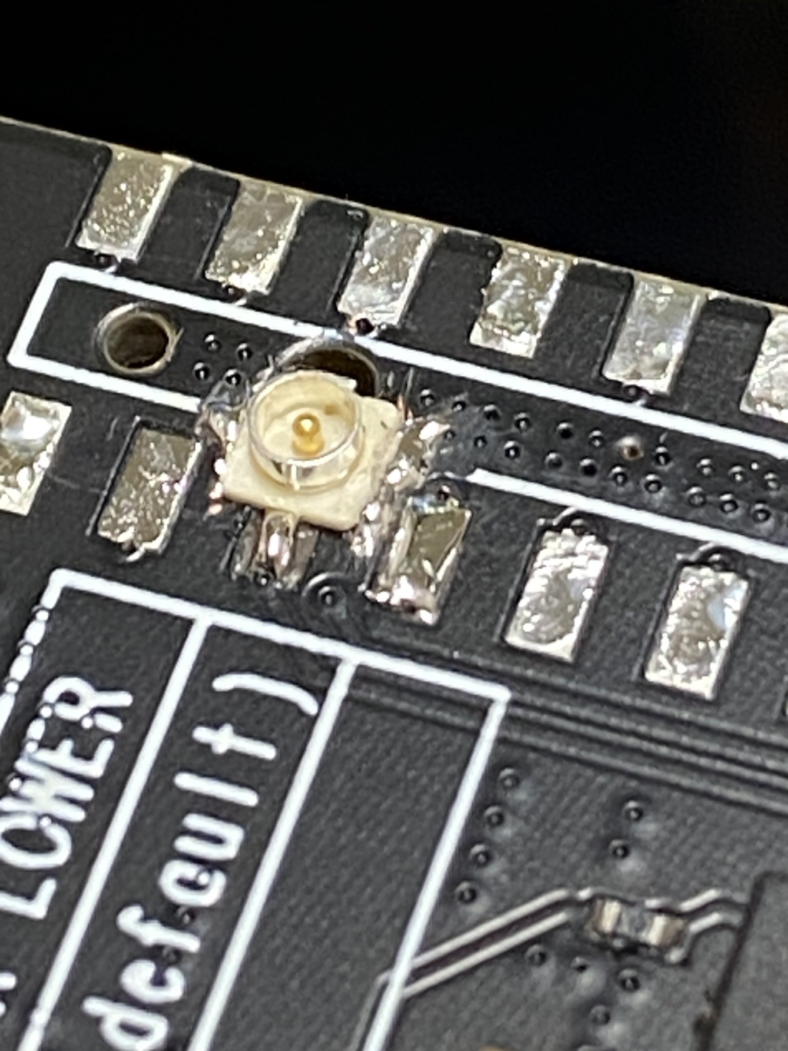

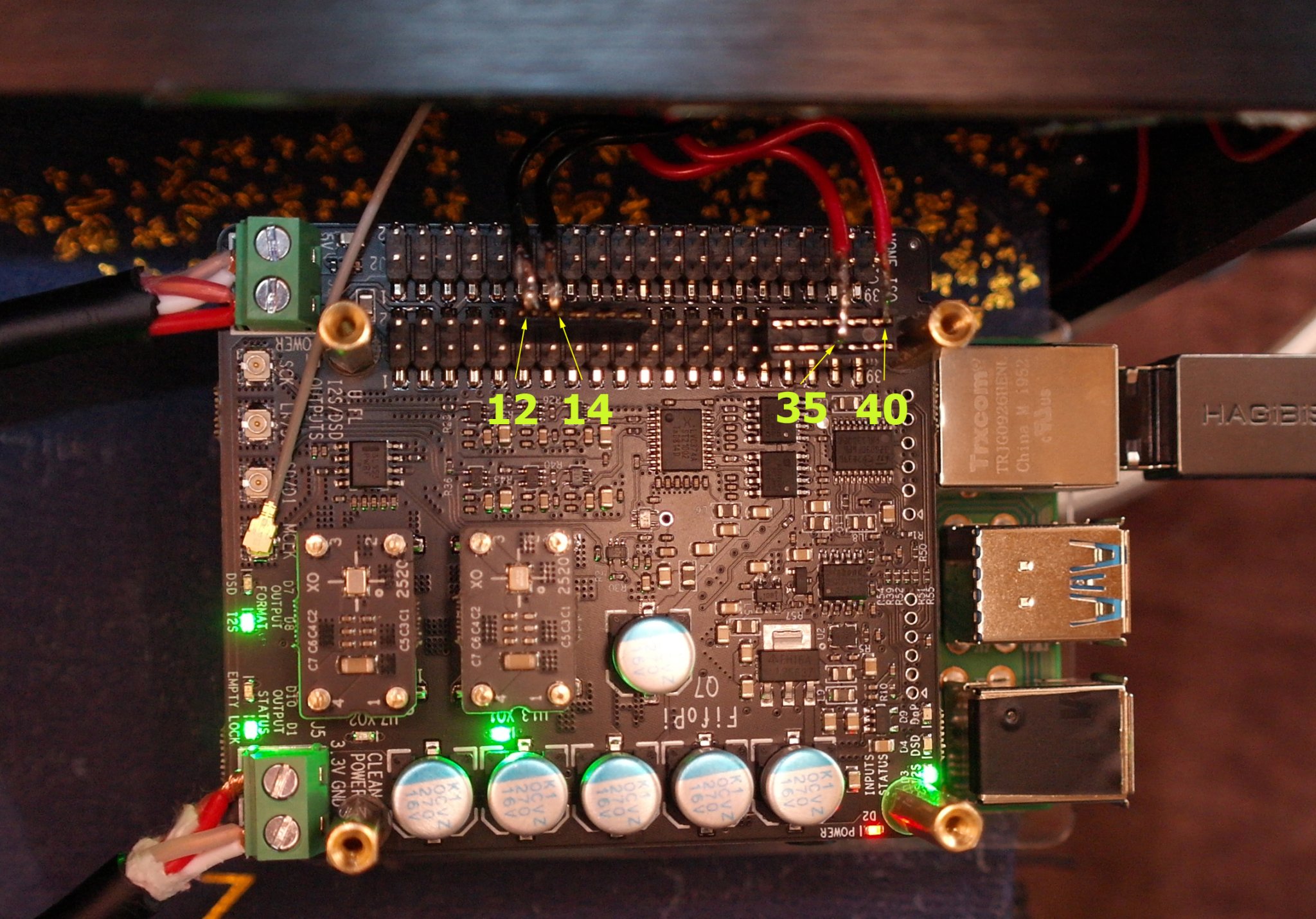

Was anyone able to connect the FIFO Q7 to a DAC directly via i2s from the Q7 pins?
I tried to connect this way to my Audio-gd Master7 without success – there is no sound.
At the same time, I have no problems at all connecting the Pi2AES in the same way - from five pins of the reclocker's I2S-output to the DAC’s internal connector.
Why it doesn’t work with FIFO Q7?

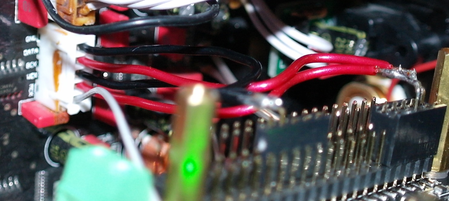

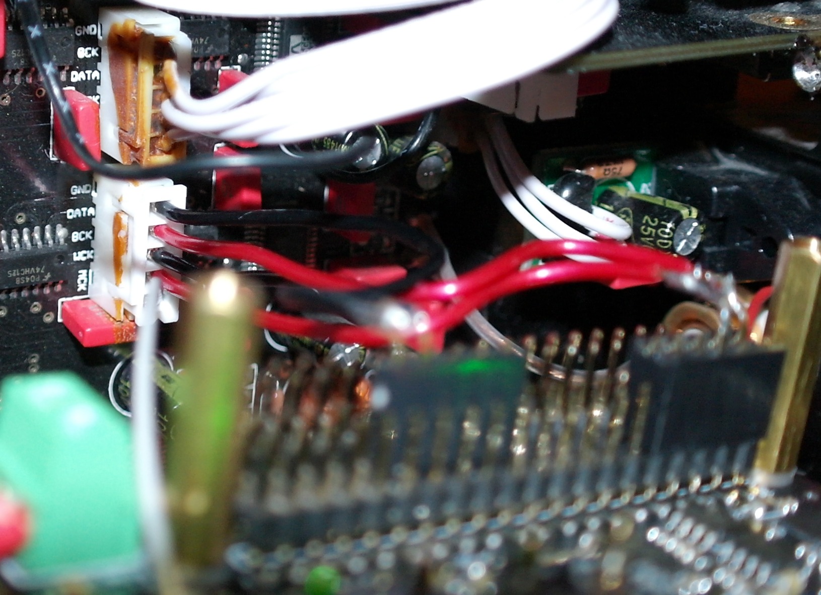

Wire's length is about 7-8 cm. I don't use rj45 or HDMI cables. The DAC has internal connectors, to which USB and HDMI cards are normally connected.
So I'm trying to connect I2S directly from FIFO Q7 pins to internal DAC socket - MCLK to MCLK, LRCK to LRCK, SDATA to SDATA and so on. And these connectors work flawlessly with Pi2AES, but being connected the same way from FIFO Q7 pins, Audio-gd Master7 is silent.

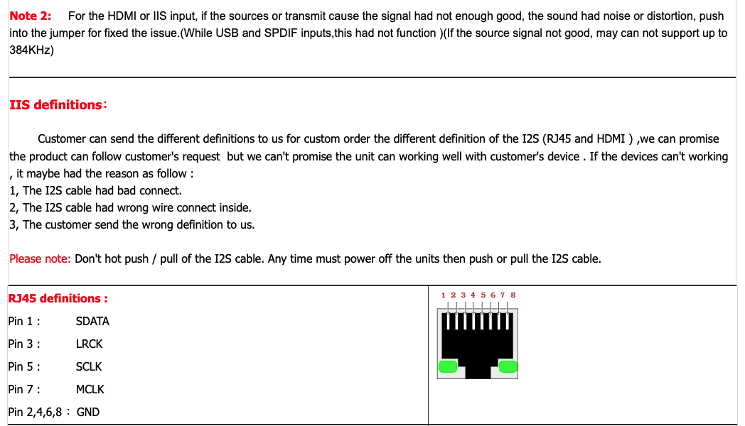

Hi, I have audio-Gd R7 He Mk2. For sound input Dac,I had to change Fifopi to 32 bit lossless with my Monitorpi.Wire's length is about 7-8 cm. I don't use rj45 or HDMI cables. The DAC has internal connectors, to which USB and HDMI cards are normally connected.
I am using a HdmiPiPro on top of the Q7 to connect to my DAC with i2s.Was anyone able to connect the FIFO Q7 to a DAC directly via i2s from the Q7 pins?

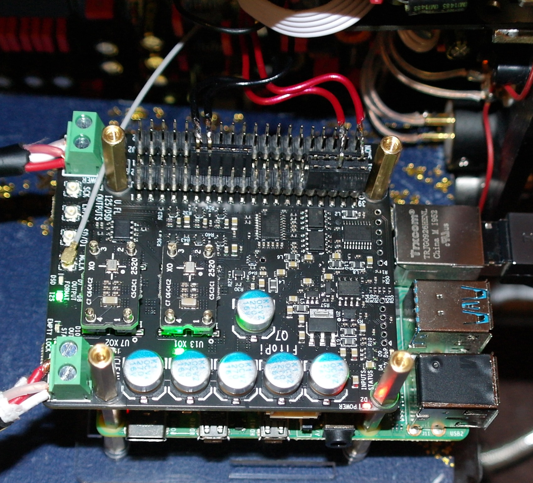

Which Q7 pins are you talking about? Can you send a picture?Wire's length is about 7-8 cm. I don't use rj45 or HDMI cables. The DAC has internal connectors, to which USB and HDMI cards are normally connected.
The Q7 is connected to the DAC like this:
GPIO pin 12 (SCK) to DAC’s (BCK)
GPIO pin 14 (GND) to DAC’s (GND)
GPIO pin 35 (LRCK/D1) to DAC’s (WCK)
GPIO pin 40 (SD/D2) to DAC’s (DATA)
U.FL MCLK central wire to DAC’s (MCK)
It’s connected with 20 AWG neotech copper mono strand wires (about 7 cm length) except MCLK. The Q7 lights are on, but there is no sound. Maybe I'm doing it wrong.
It’s hard to focus on both sides of the connection simultaneously, so I took pictures from each side separately.

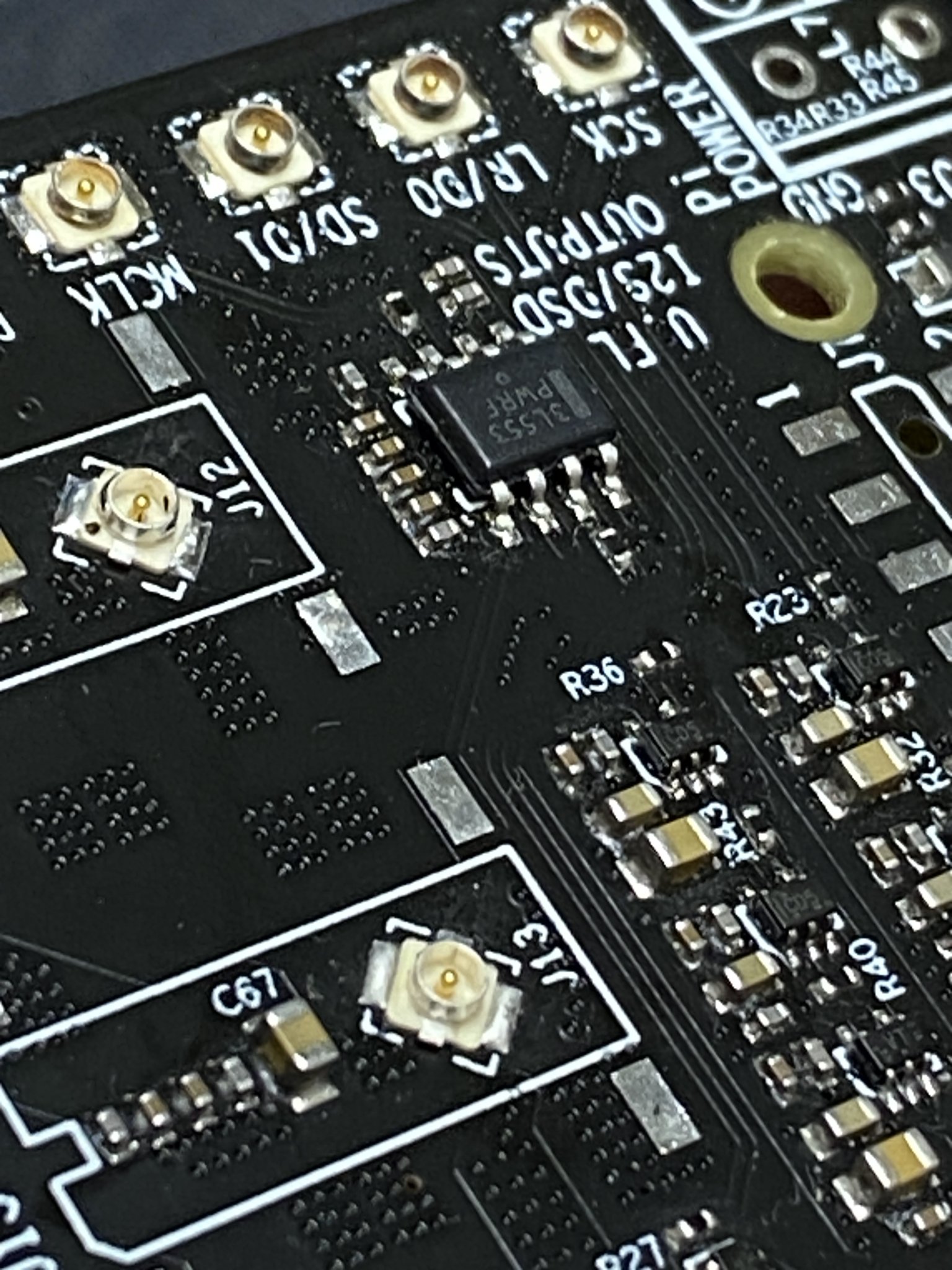

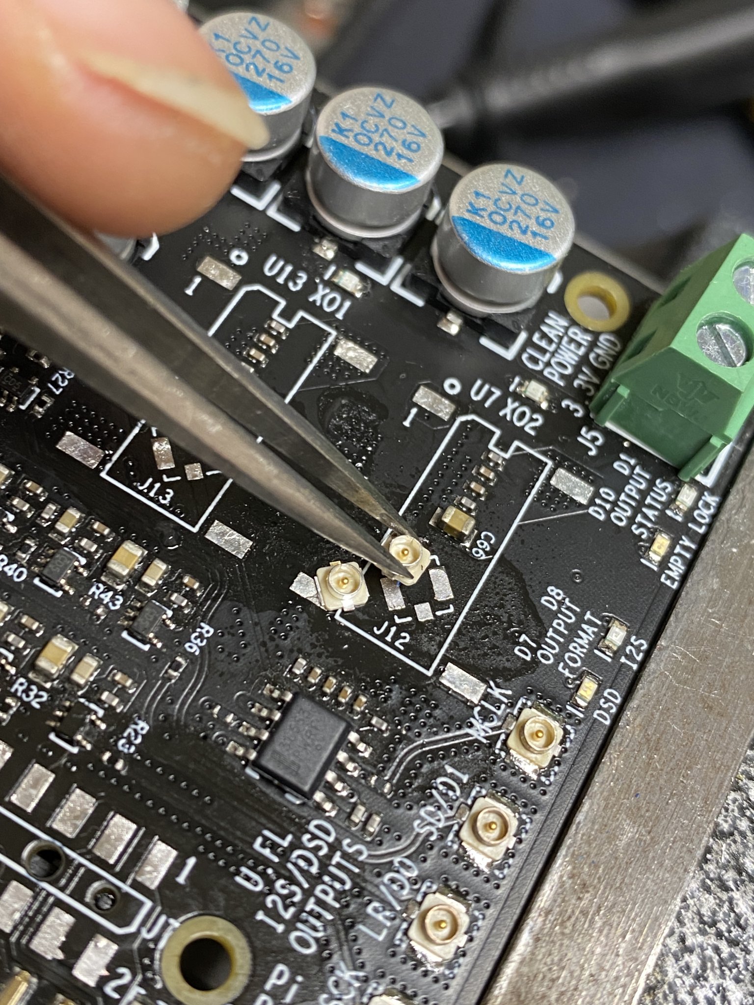

have you tried to connect J11 MCLK, J8 SCK, J9 LRCK and J10 SD via U.FL coaxial cable from FiFoPi to DAC and turn off Continuous clock output mode in FiFoPi?

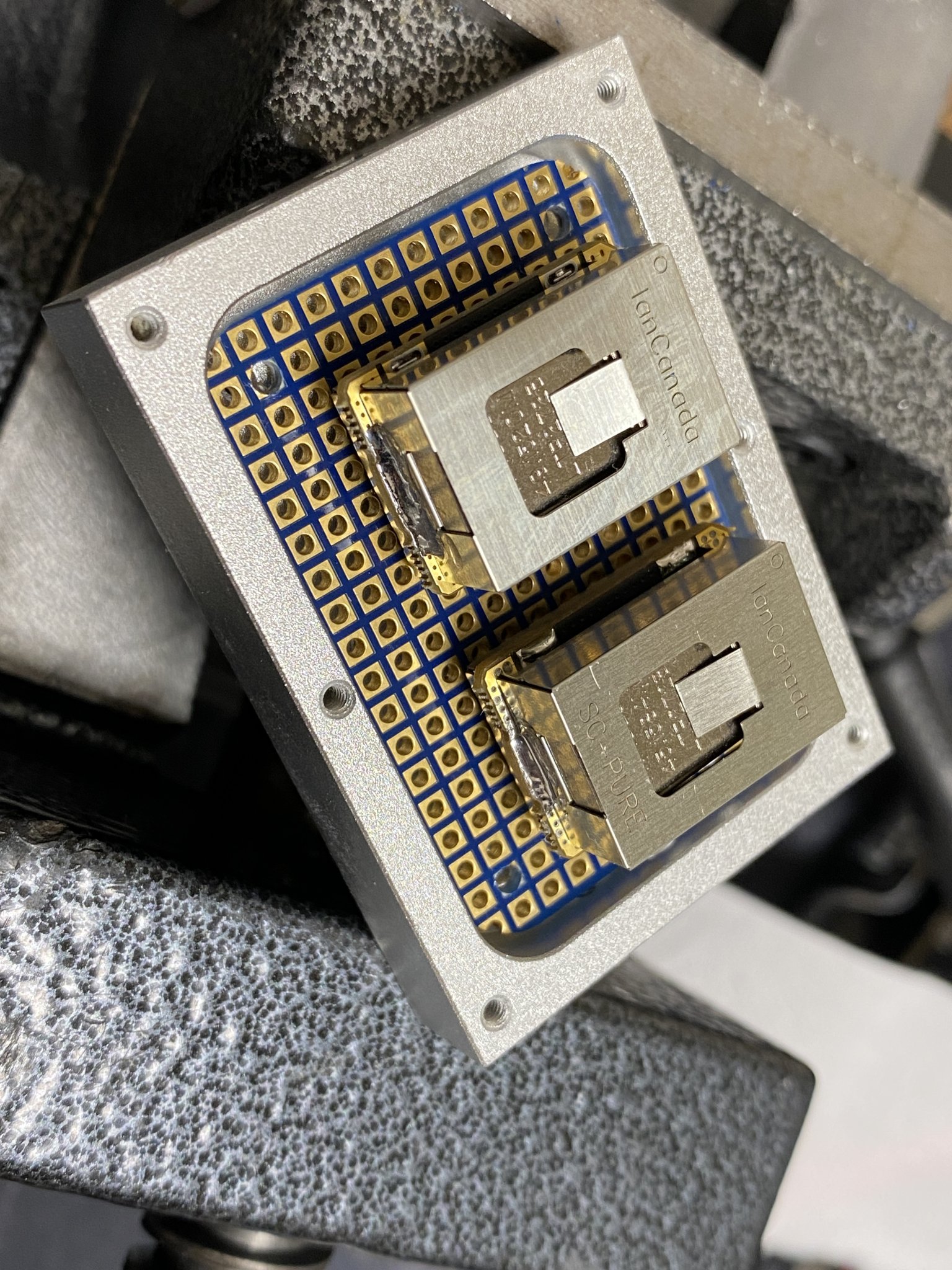

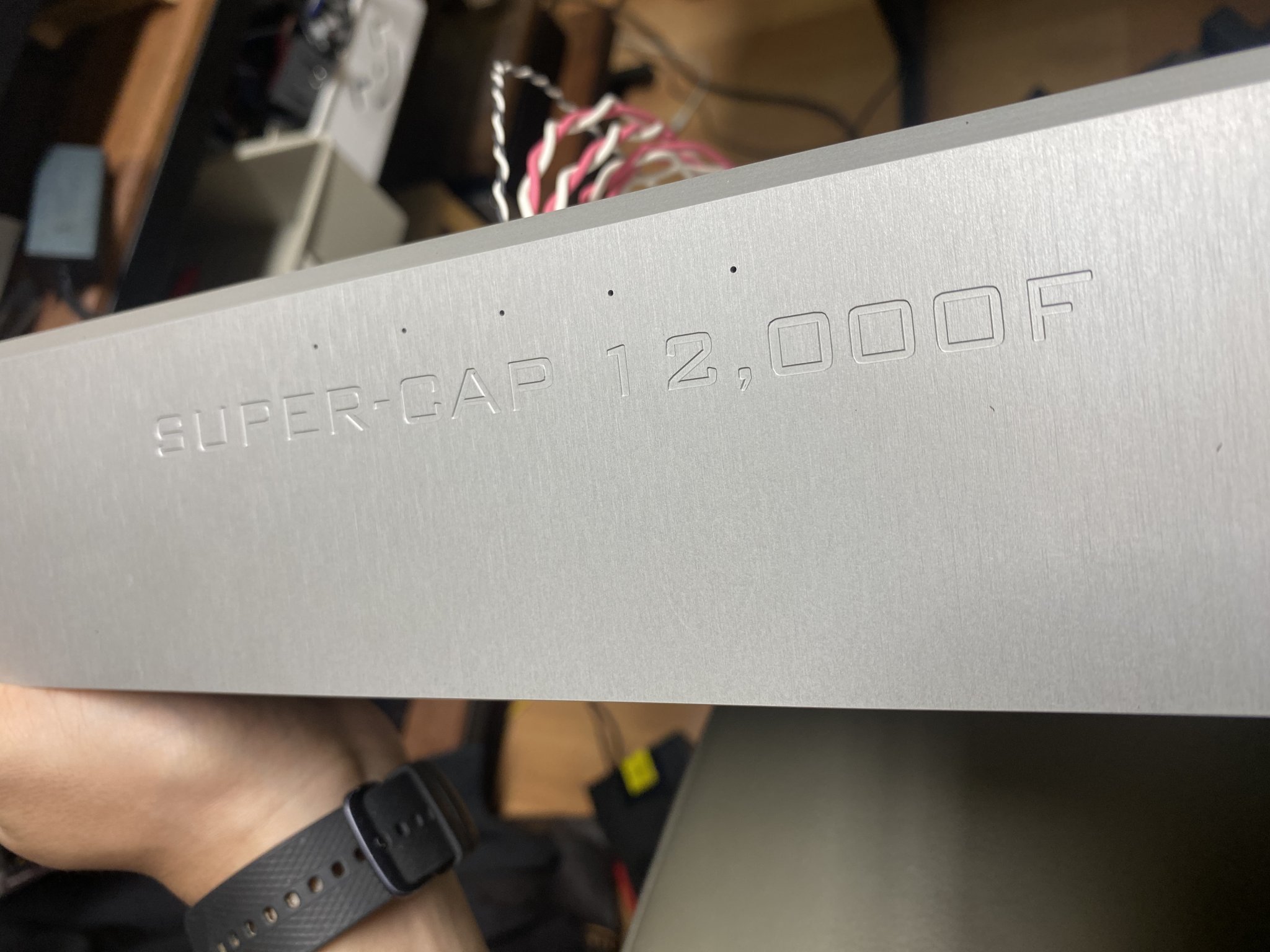

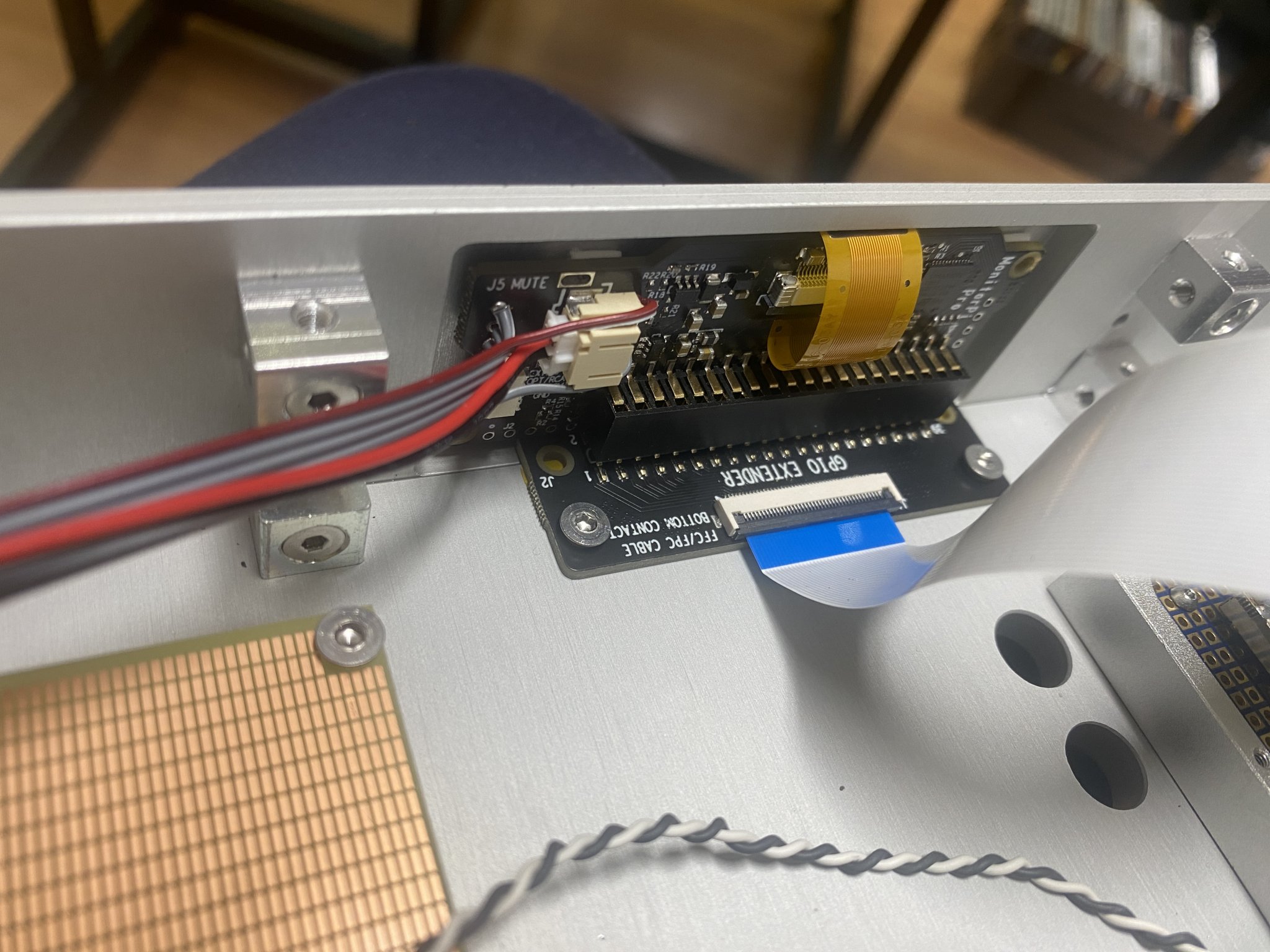

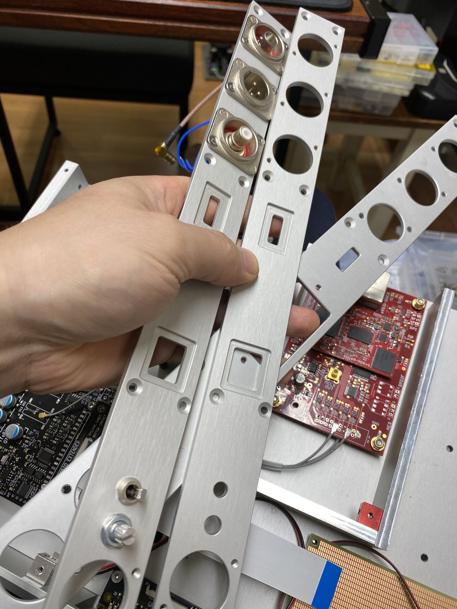

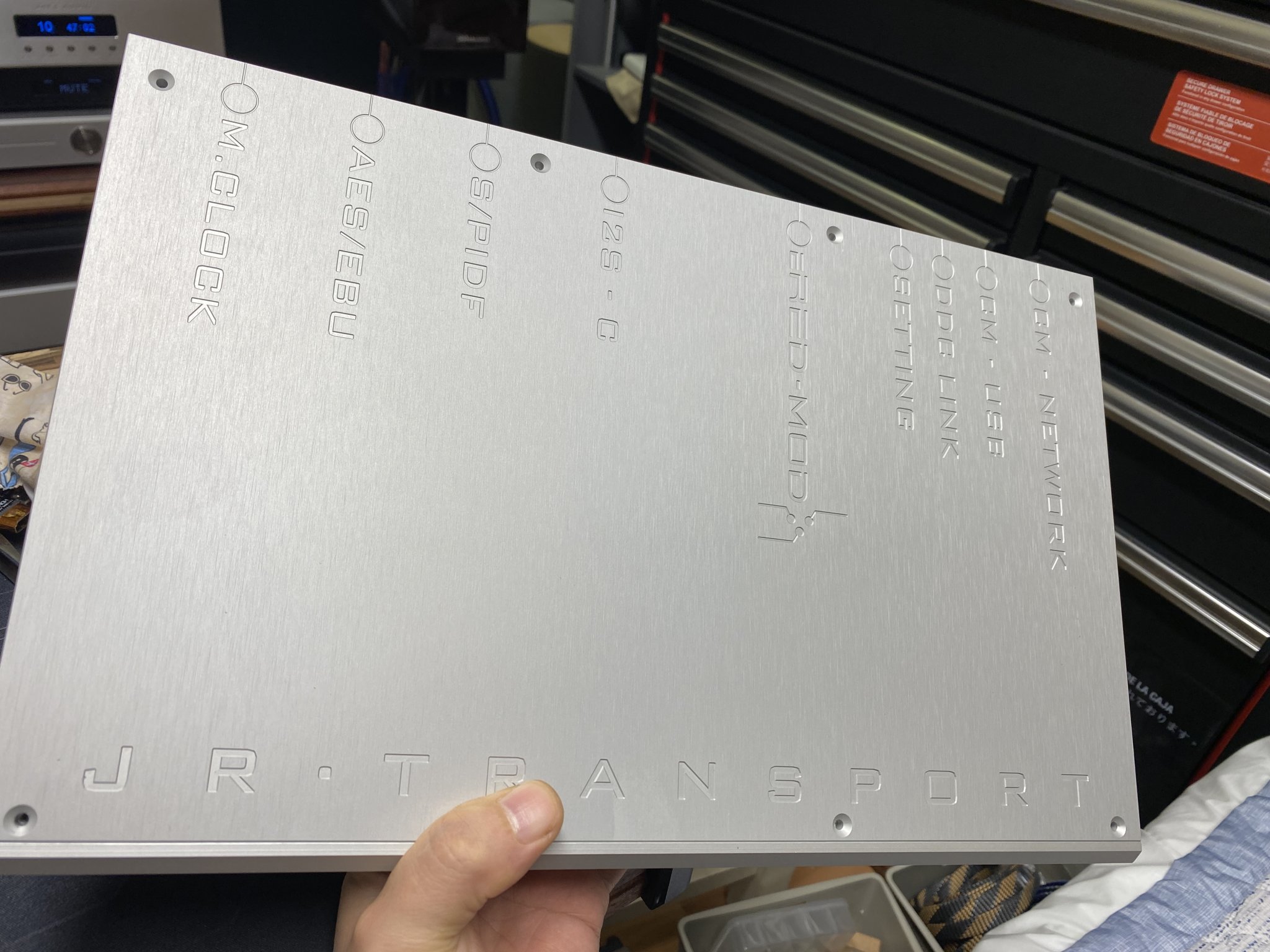

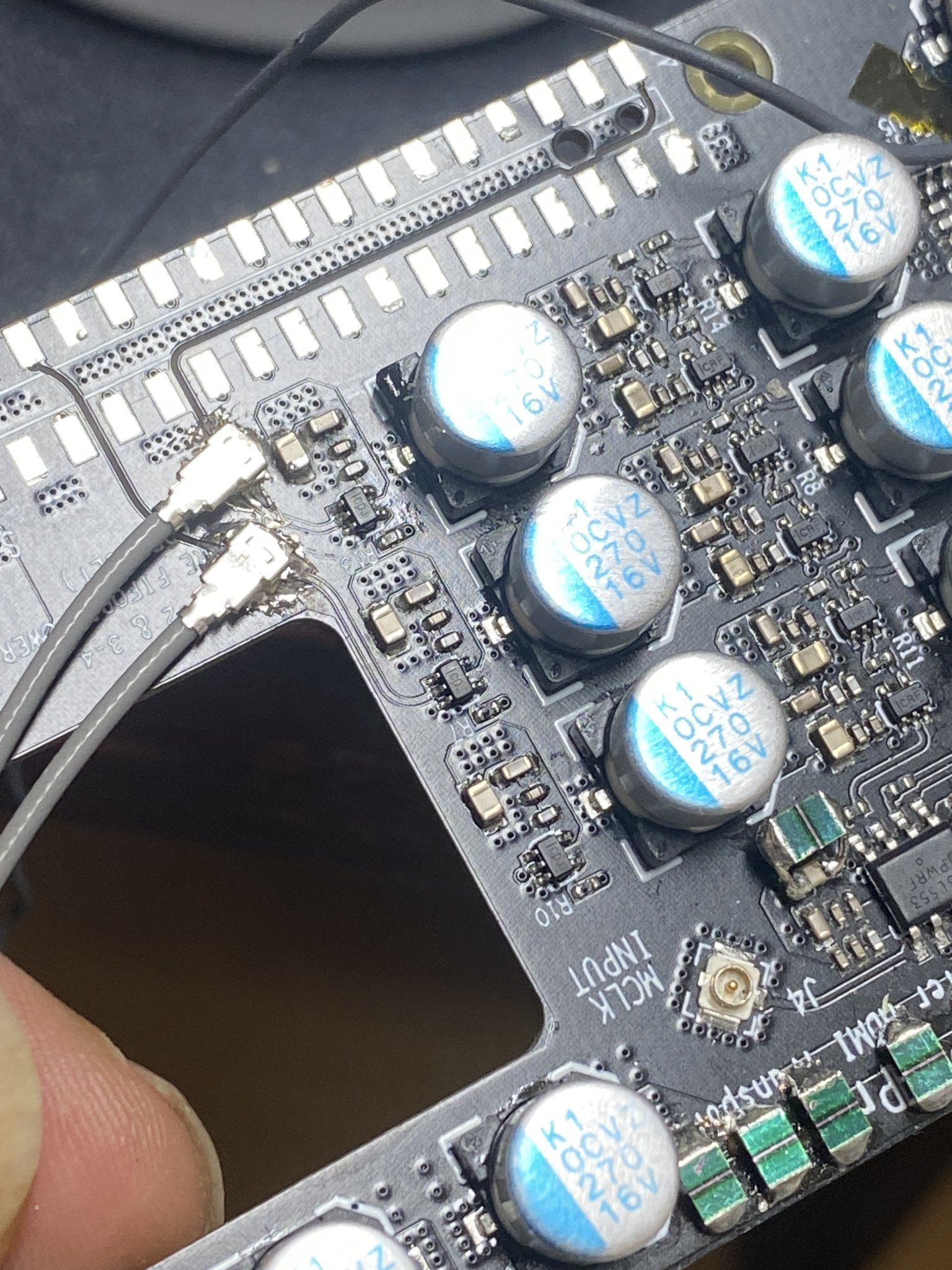

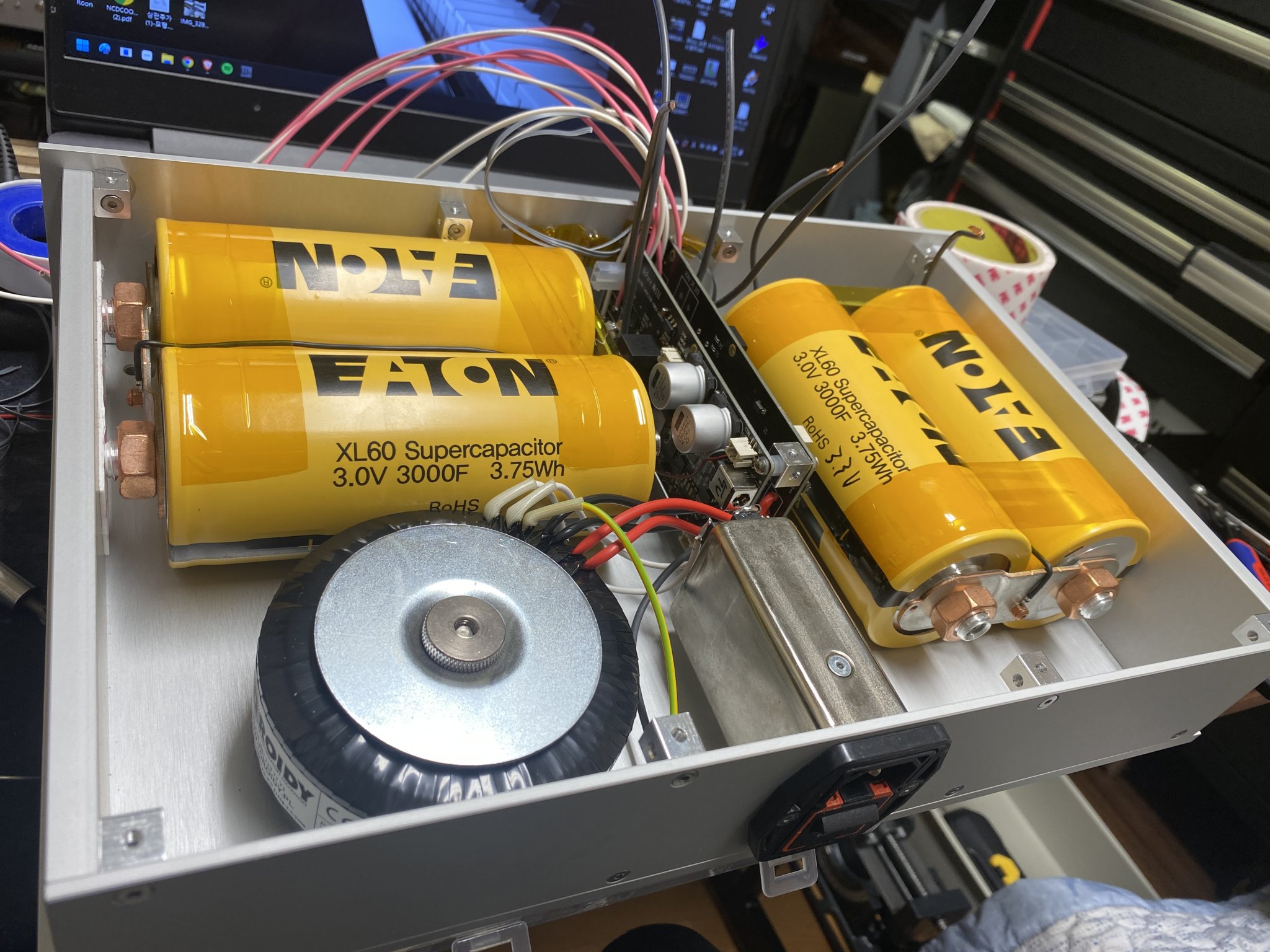

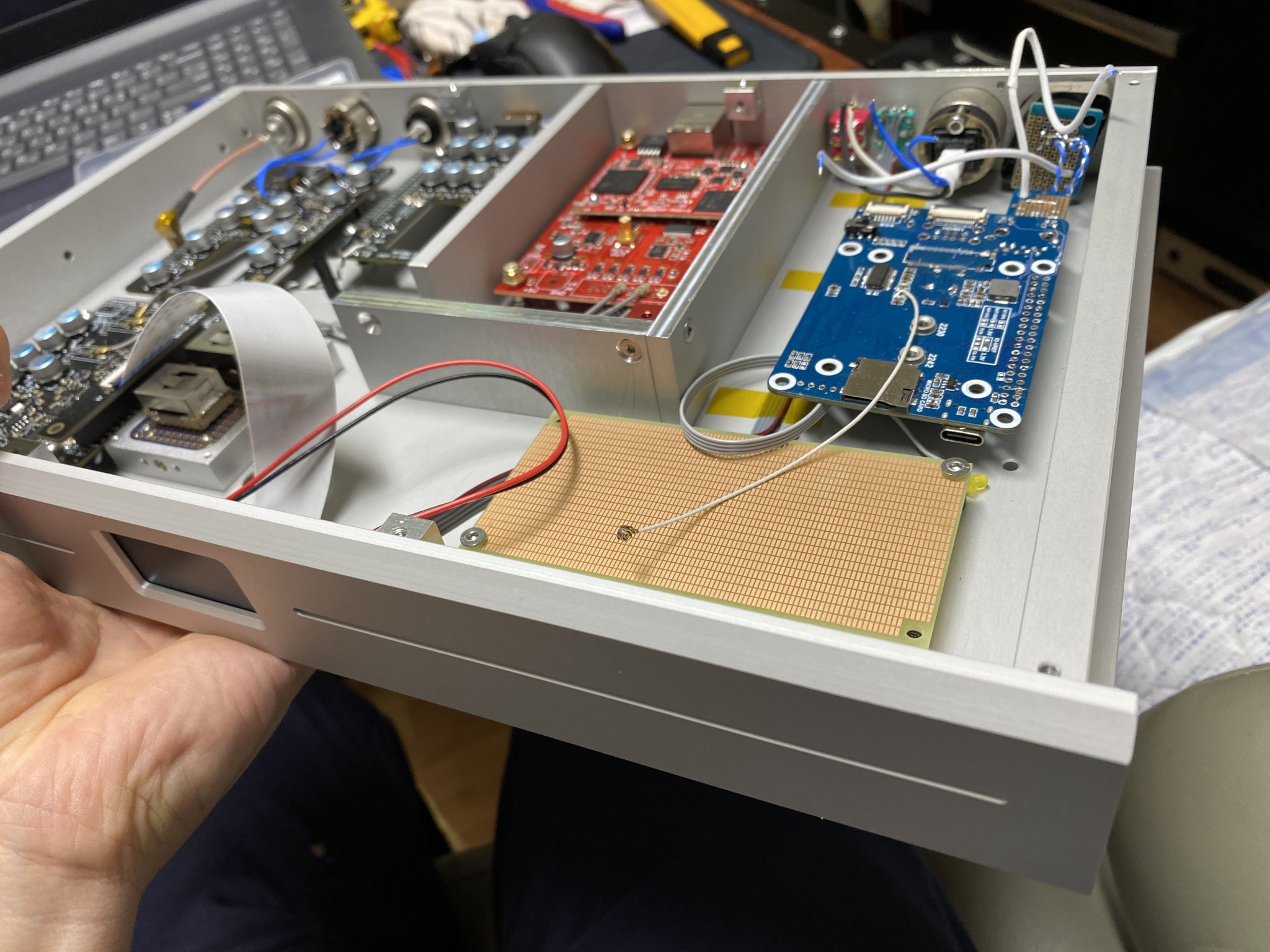

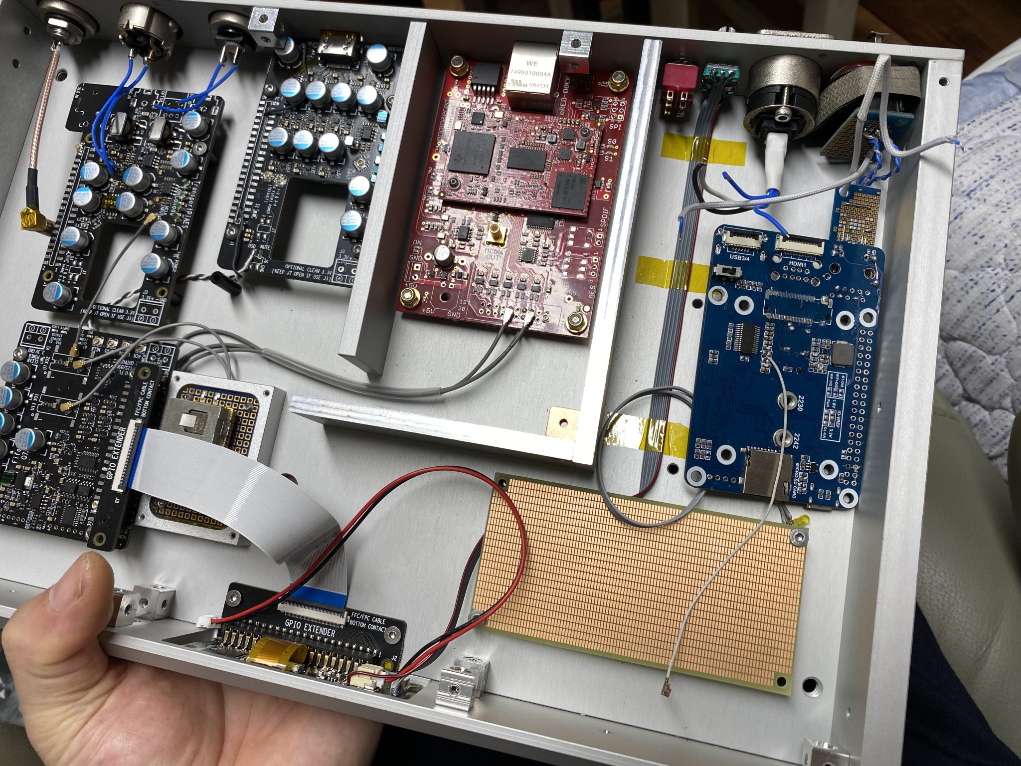

Hello
I'm building a streaming renderer.
I'm doing a quick working test and then putting it into a case.
The sc-pure is installed separately because of the loose socket.
I have two operating systems: raspberry pi cm4 and engineered-sa ERED-MOD.
I switch between them depending on my mood.
Both are attractive sounds.
The sound of the ERED-MOD is more musical and emotional.
Is this a difference between commercial and audio board design?
Both work perfectly with ROON.

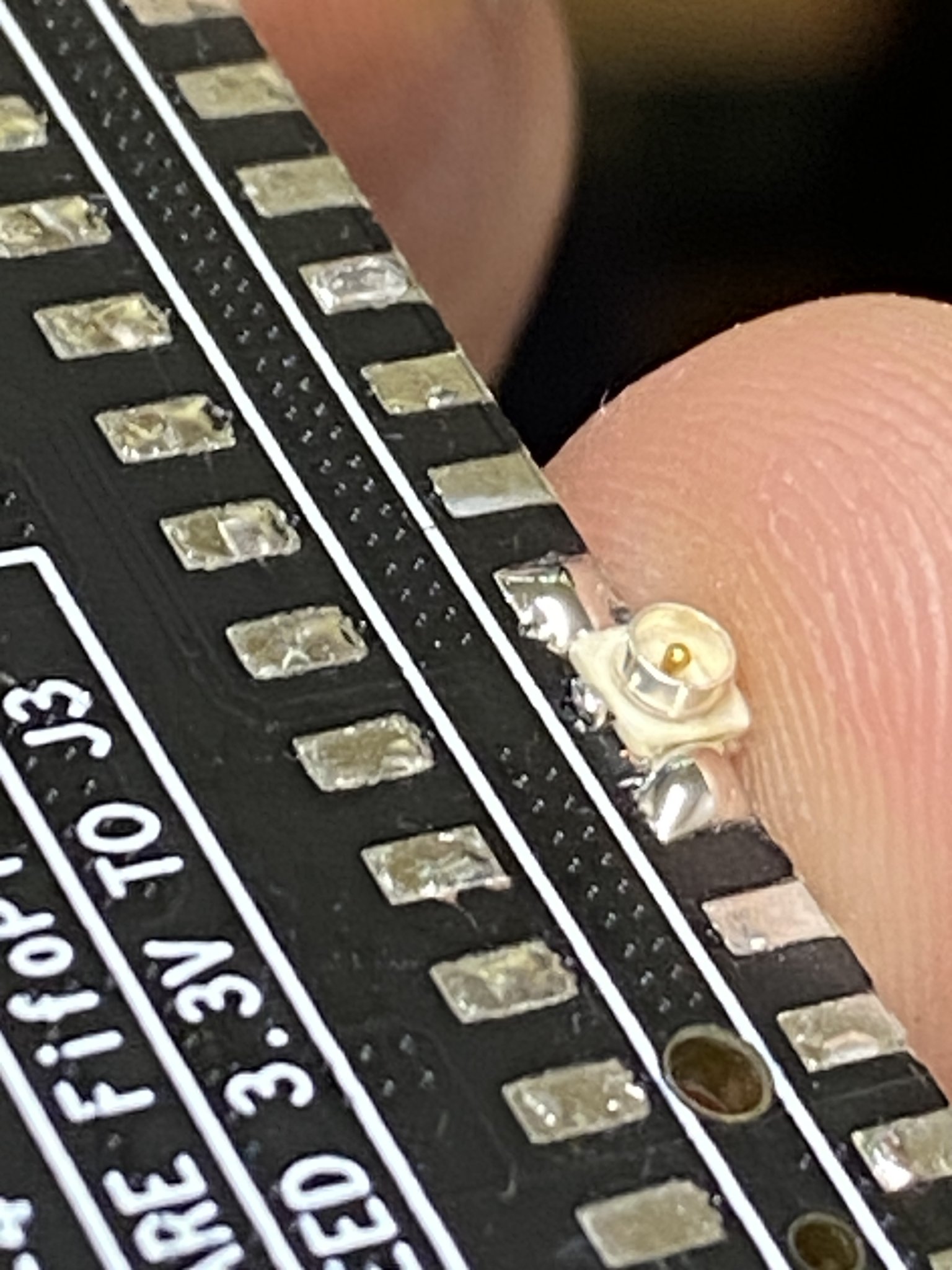

The wires connected sound better with industrial coaxial wires than with high end audio wires.
The clock signal and I2S signal are connected with coaxial shielded wire.
UFL connector
I will be replacing my raspberry pi cm4 with a raspberry pi 5 in the future.
I have some ideas that I haven't installed yet.

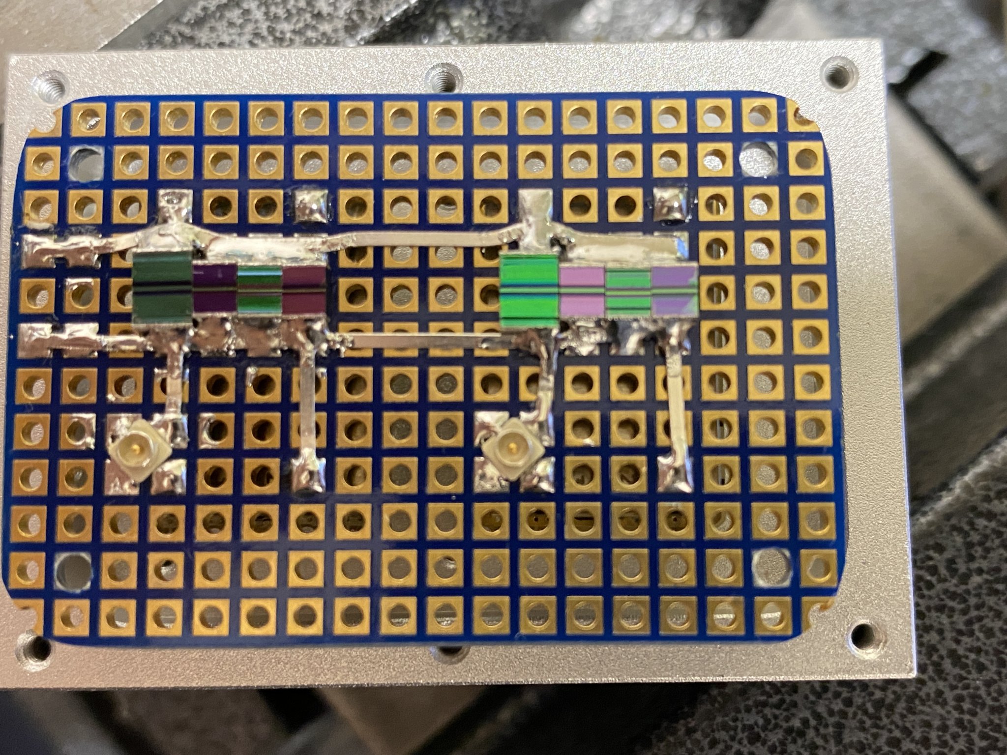

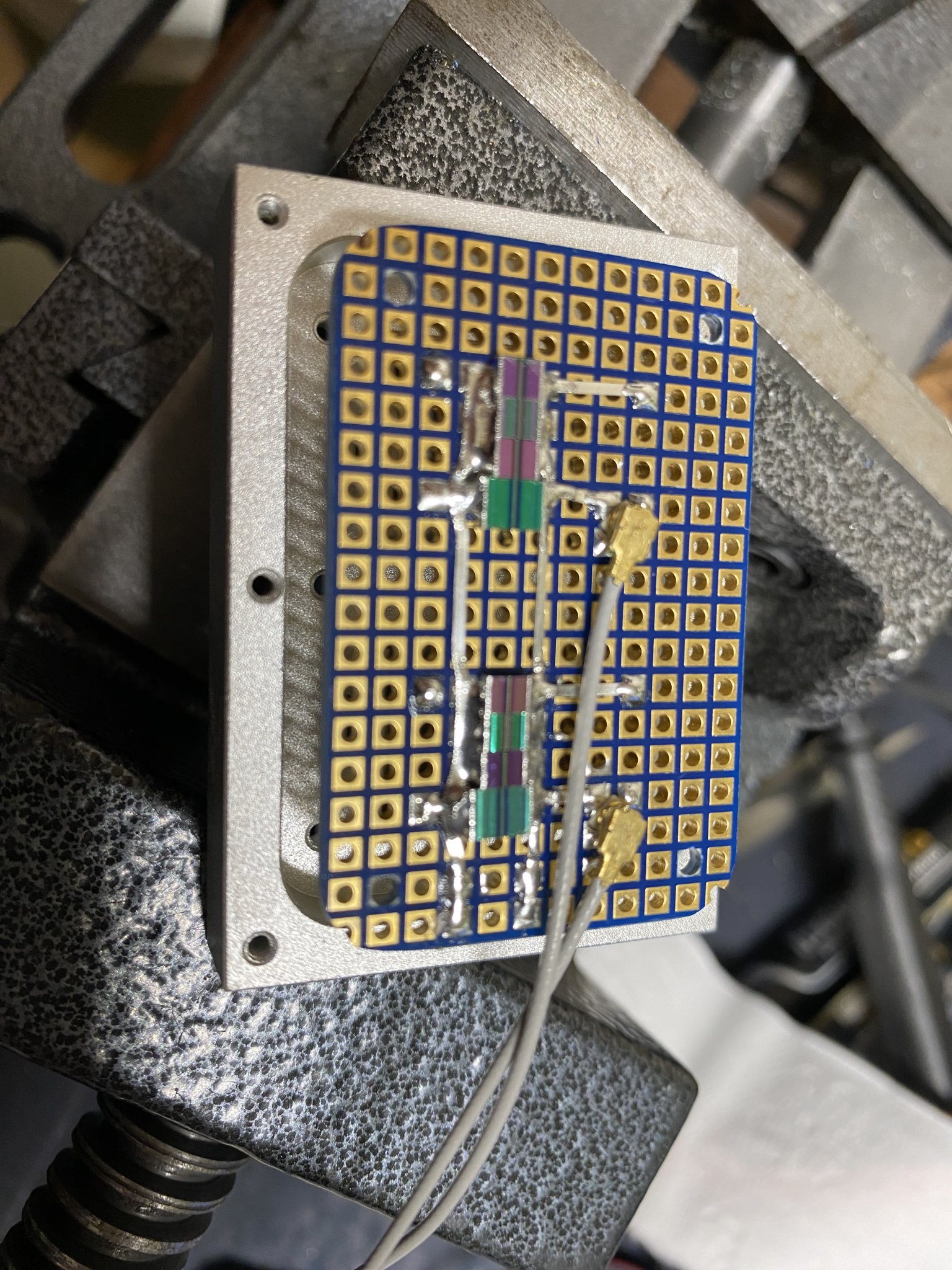

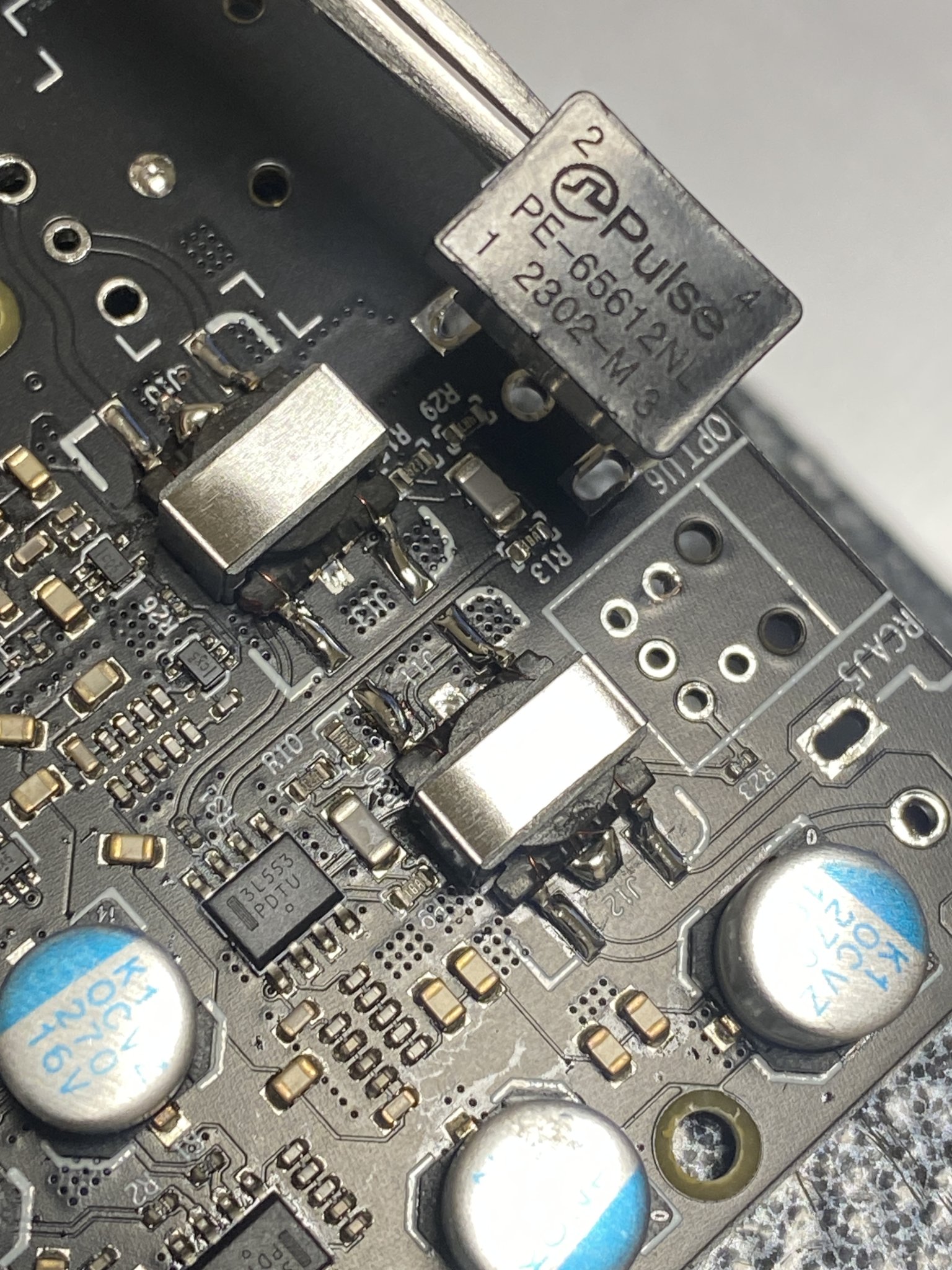

I replaced the coaxial output with a SC947-02LF transformer.
It sounds more dynamic.
Not finished yet, parts are coming.
I'll post again when it's finished.
It's not quite finished yet, but thanks to Ian for making it fun to make and fun to listen to.

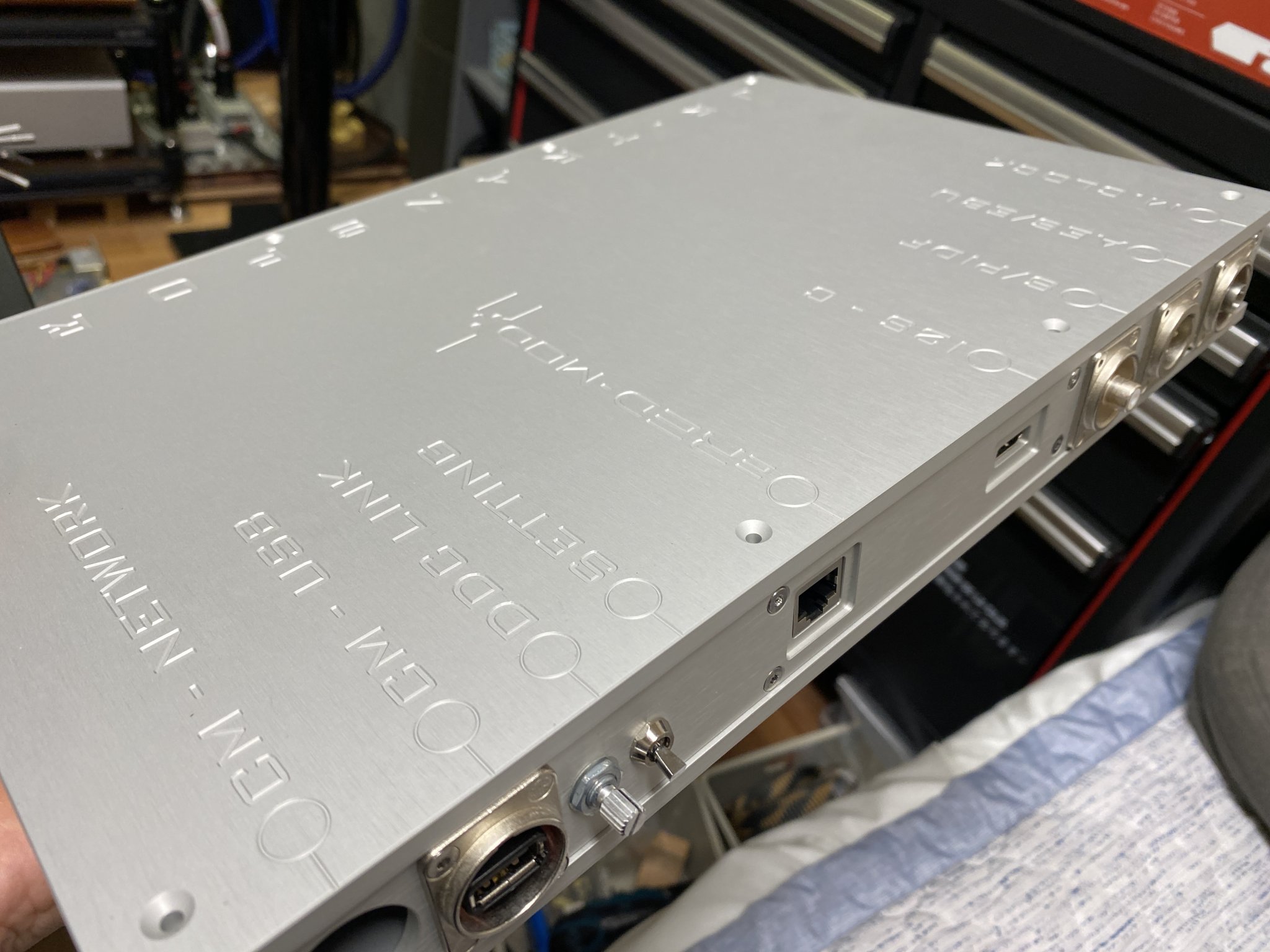

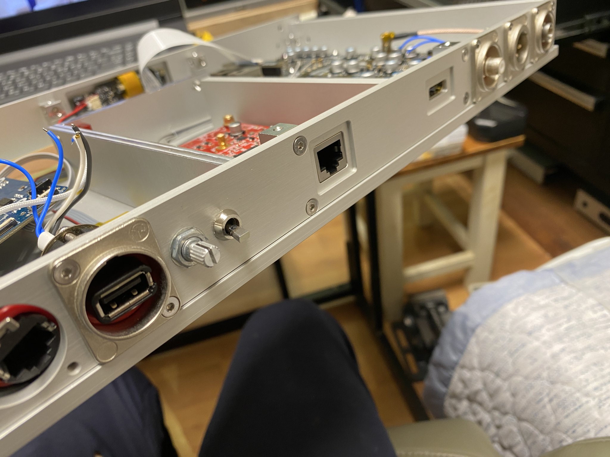

I submitted a CAD drawing file to a machining shop and made aWhere did you make the case?
and asked them to make it.
