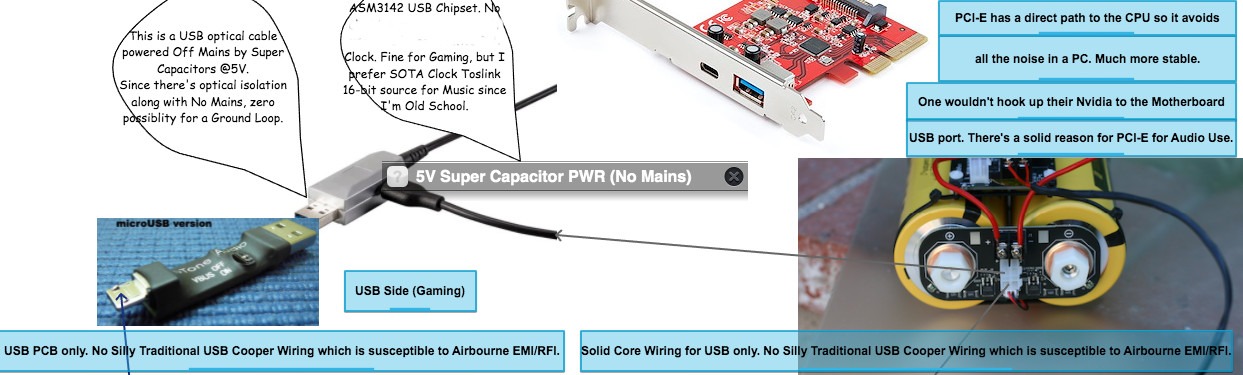

Hi @iancanada,
I hope to catch you at a good time, I just had a quick question.
I'm planning obsolence since I have a spare Q3, RCP, 18650 Lithiumwerks, TransportPi sitting around. My initial plan was to just build a duplicate, redudant of my primary system since it's Mission Critical. But that would require a duplicate UcPure infrastructure in the future and it's glued to a desktop setup.
I've been thinking about Travel in 2024 lately and how I can bring my legacy Ian Stack into my Carry-On.
Since the PurePi MKII is an natural option:
The LifePO4Mini would be too bulky for travel not to mention TSA complications, but the problem is I'm allergic to Mains.
So my question is can I run the PurePi MKII off a 5V/3A Battery Pack via USB-C?
I will consider the battery pack a higher grade DC power supply, not to mention it can be considered isolation mode:
My other option is to use my legacy BMS or a combo of legacy BMS/PurePi MKII:
Oh, one more question if you have time, does the PurePi MKII scale? If I feed a 5V/5A battery pack, will it output 5V/5A?

PurePi is functionally equivalent to a ConditionerPi 5V plus a LifePO4Mini 3.3V.
Only one standard 5V 2.5A or higher current power supply in USB-C is needed as power input.
6. Make sure S2 is at OFF position. Connect a standard 5V USB-C power adapter with 2.5A or higher rated
current to DC input J8 of the PurePi.

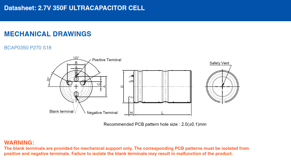

However, the 5V ultracapacitor output may still have something to do with the DC input because it’s not in
isolation mode. A higher grade DC power supply can still have lower EMI noise to the environment. So, there
will be still some improvements if upgrade the 5V DC input with a lower noise linear power supply.

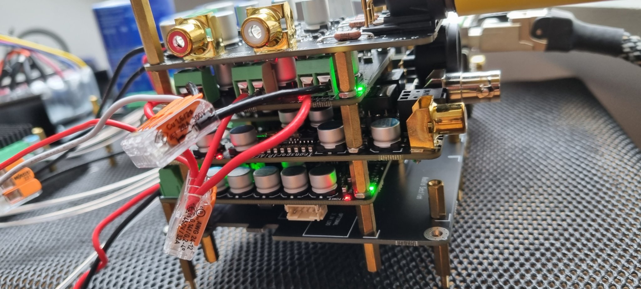

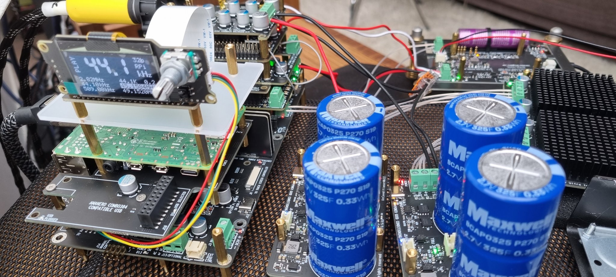

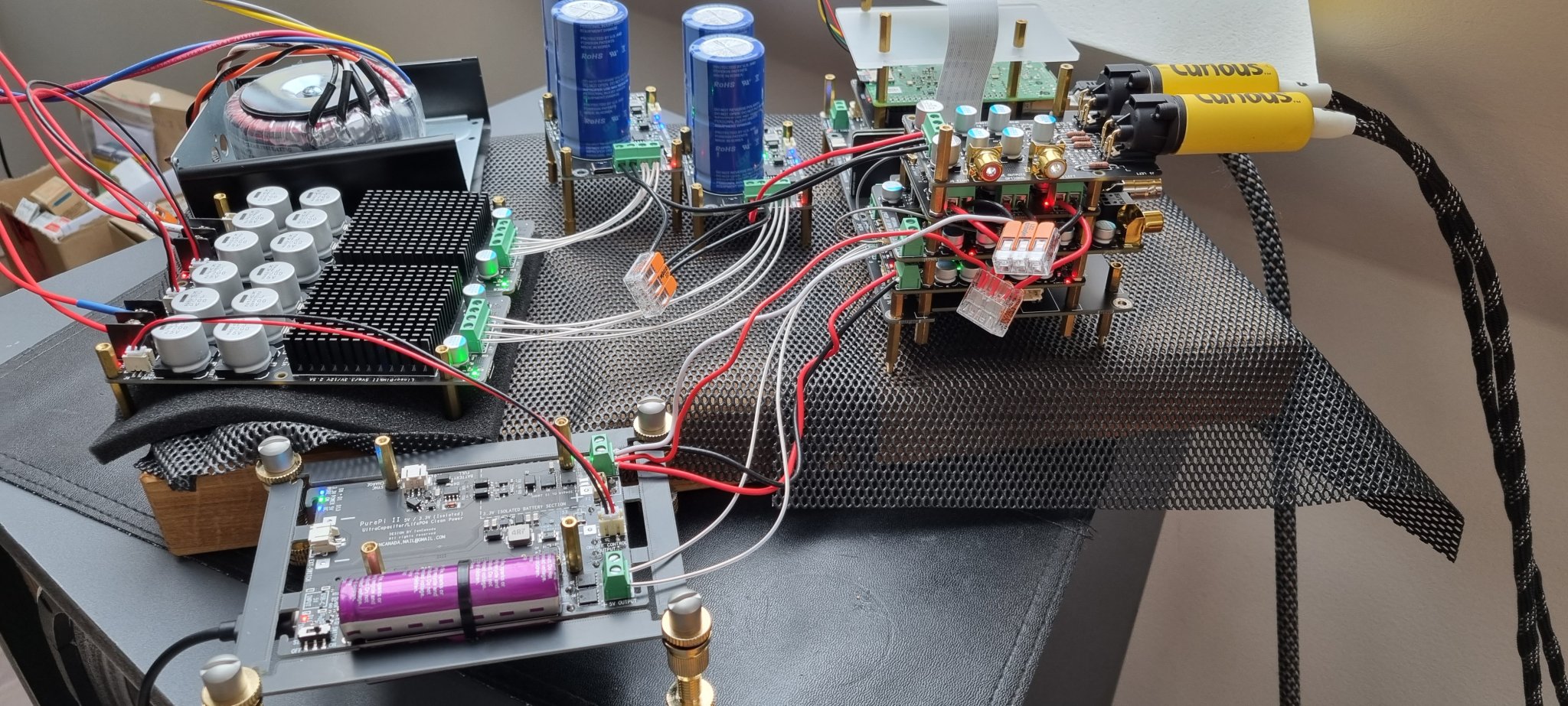

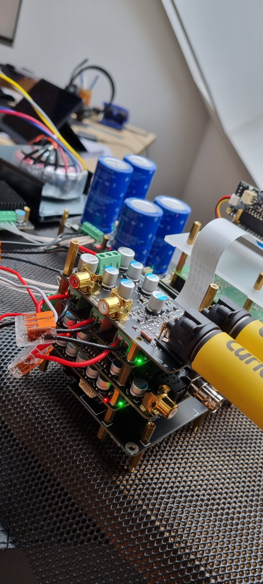

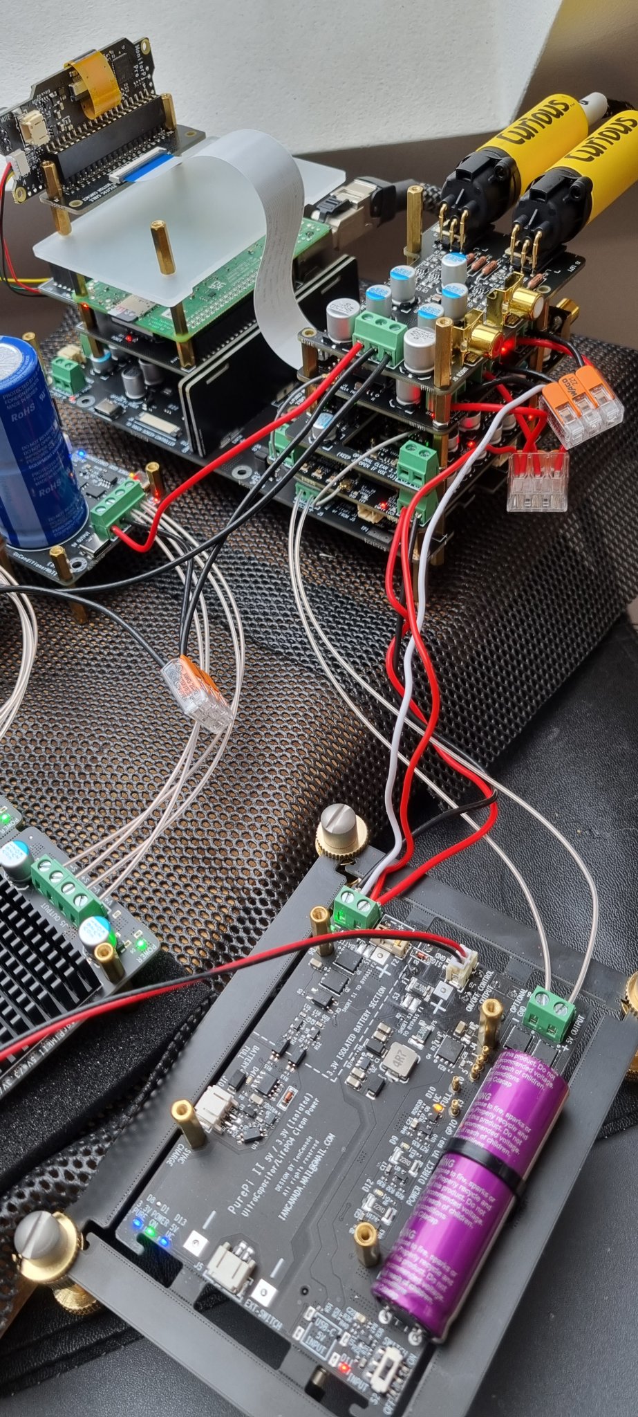

Dear all,
after many hours and with tremendous help from @zabloc (YES, YOU ARE THE MAN !! So many hours you supported me, thx soo much!).
I'm finally finished the build and started with some basic sound check, based on Volumio (before going down the road with gentooplayer).
I've a weird issue, because OPA XLR only the right channel is working properly, but not the left one (only having some flickering noise, no sound at all).
I see some flickering green led on the ES9038Q2M DualMono Dac HAT, as soon I start playing a song.
DAC is sharing 3.3V with the FiFo Q7.
BTW.: also realized I'd to go down to -0 dB on MonitorPRO that it here anything and controling volume via my PreAmp.
Please, ignore current cabling it was only for test purposes ;-)
Any ideas?
Pictures attached..
Thanks a lot !

You have probably already checked this, but do you have 3,3v on all 3 rails of the DAC, connected with the wago connectors?
Is the battery fully charged and the voltage doesn’t drop below 3,3v on the fifo and DAC, when you start to play music?
Using correct driver and signal is displayed on MonitorPi?

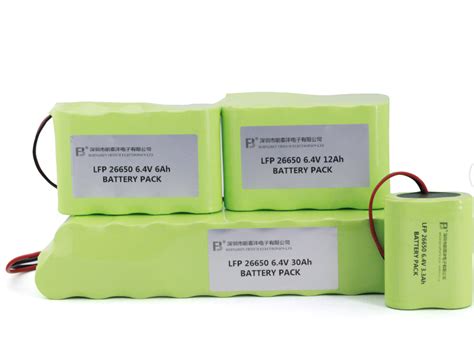

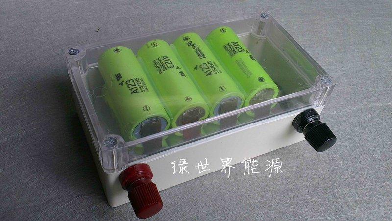

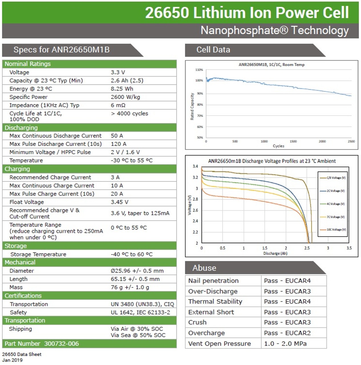

For example, each 26650 is 8.25 watt hours:
For my BMS, I need to build a battery pack:
Even if I explain 8.25 watt hours * 8 26650 is less than 100 watt hours, there's no guranteed I can bring these on the plane. With a consumer battery pack, it's almost guranteed so that makes the PurePi MKII the better choice. But the PurePi MKII also has super capacitors which can be tricky to explain away.
I don't have to worry about TSA agents either using logic.

The wiring looks correct.
Hi, yes verified that.
So I still have some OPA challenges and also need to be more confident to measure.
In general, as a newbie DAC/Streamer builder, who thought buying this "kit" and wired it together and you have a perfect DAC/Streamer..
I'm now back to reality...it is far away from an "average hifi electronic kit"!
So I will completly go back to step 1 and just build a simplified IAN Streamer and than move on. Currently even using my external Weiss 501 DAC and the SPIDIF from the Transport AES+ is disappointing bad streaming quality (lot of noise) - already disconnected my OPA and just using PurePiII.
thanks everyone for support!
