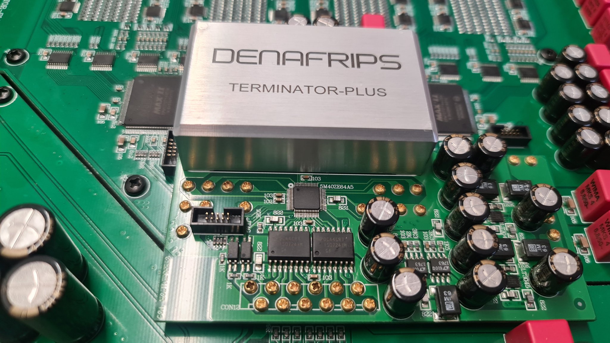

Why not try a slight bend in the legs to increase pressure on the socket? In my experience a good connection is key to good sound. Long before they fail to work due to a poor clock signal connection you see sound degradation as if you are using higher phase noise clocks. I use a cable between the clock and FIFO. SMA sounds better than ufl. Even applying proper torque to the SMA connection can be heard.All so true. I just have the stock clocks and the new SCPure. There is an improvement over the stock especially after burn in and with the UCPureMkIII. I’m sticking with the SCPure and will await Ian’s answers and how to best make sure they are seated.
Certainly soldering direct to the board might be best, but then you lose the flexibility FIFO offers to try different clocks.
If you bend a leg, secure the leg close to the clock with needle nose plyers and bend the leg, not the attachment point. Same with capacitors when bending the leads.

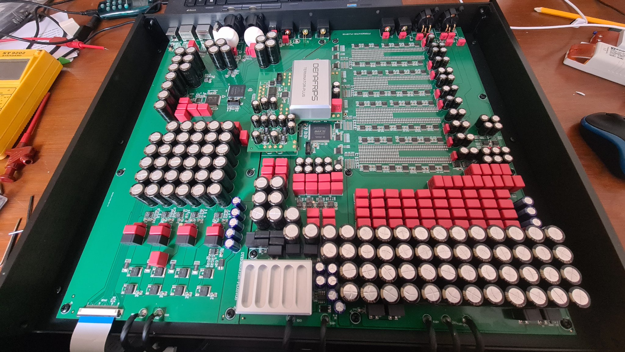

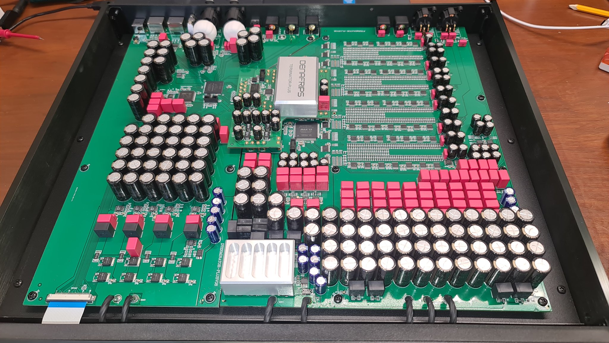

Ok. Update. I just took apart my DAC stack to do this (top two boards) and what I found was - the clocks are tightly seated like the default clocks were.
My assumption is that after a good 300 hours of running at 85C - or whatever their temp is - they ‘self seated’ due to expansion of metal. After all it is maybe 0.5 thousandths of an inch play on the radius.
But to be scientific - can anyone else report the same after 2 solid weeks of burnin 24x7 power to the clocks?
