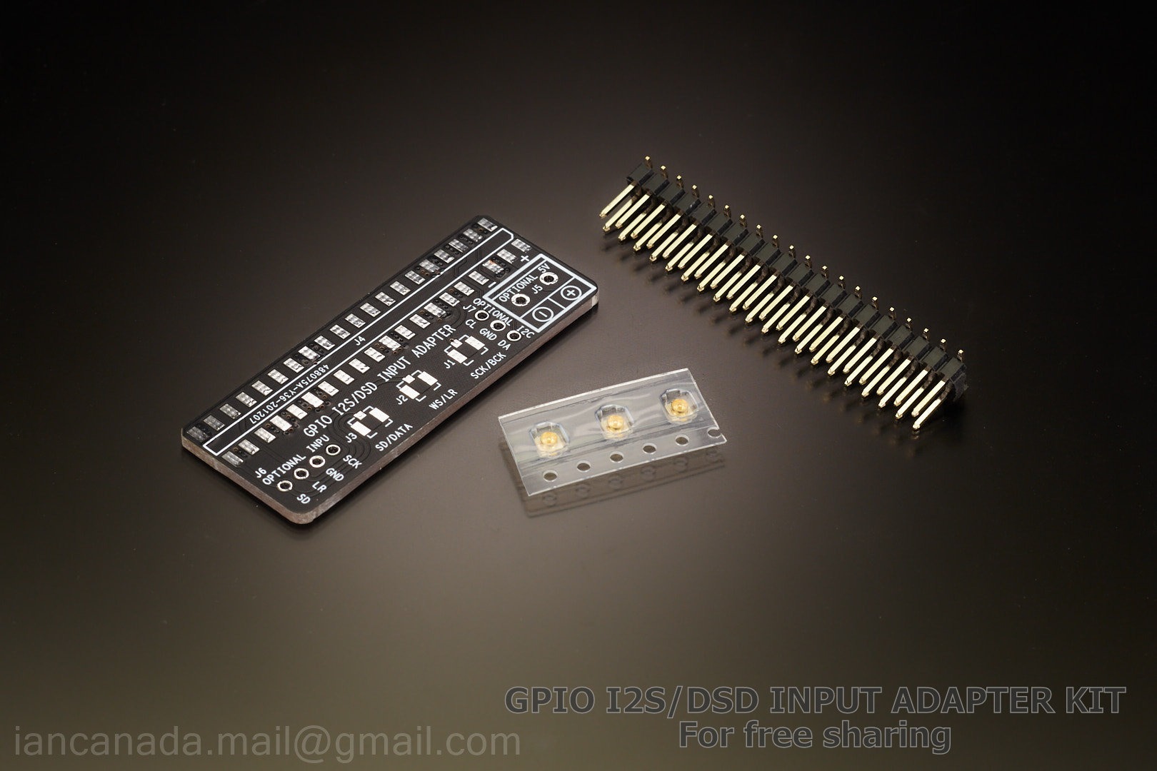

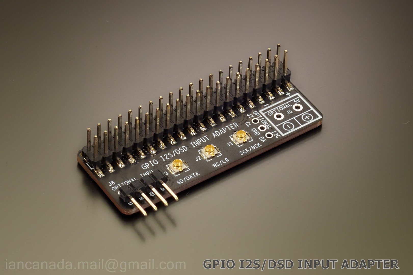

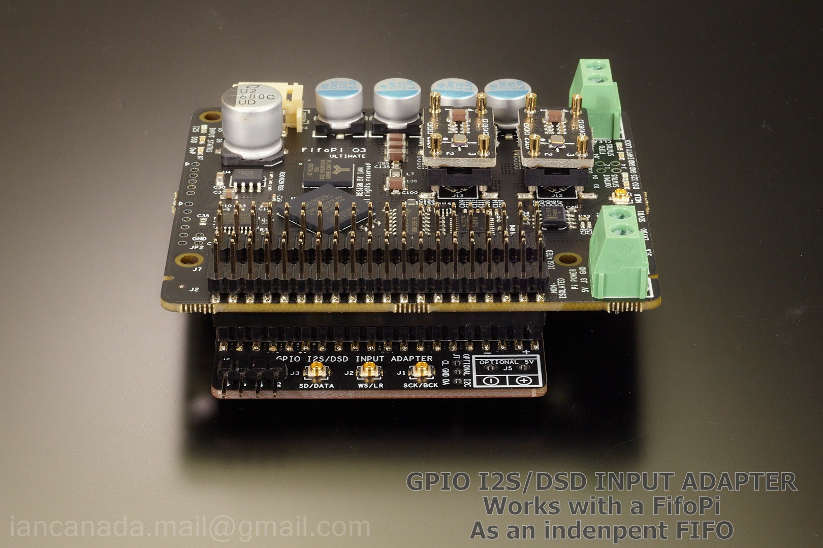

Hi everyone, what's the best/easiest way to connect the FifoPi Q7 with an I2S signal?
My need is to have a Bluetooth dac, so I will use a Bluetooth to I2S(perhaps slave) receiver, somehow connect it to FifoPiQ7 and so I can have clean output to the dac chip, all in one box.
Looking at the datasheet for FifoPiQ7 it accepts I2C but not I2S and I don't want to use a Pi at all. I've looked at the ReceiverPi Pro but there's no easy I2S input pins and I'm not 100% I can use it without an actual PI.
FifoPiQ7 takes external I2S. The best way is to use an input adapter to connect to an external I2S source.

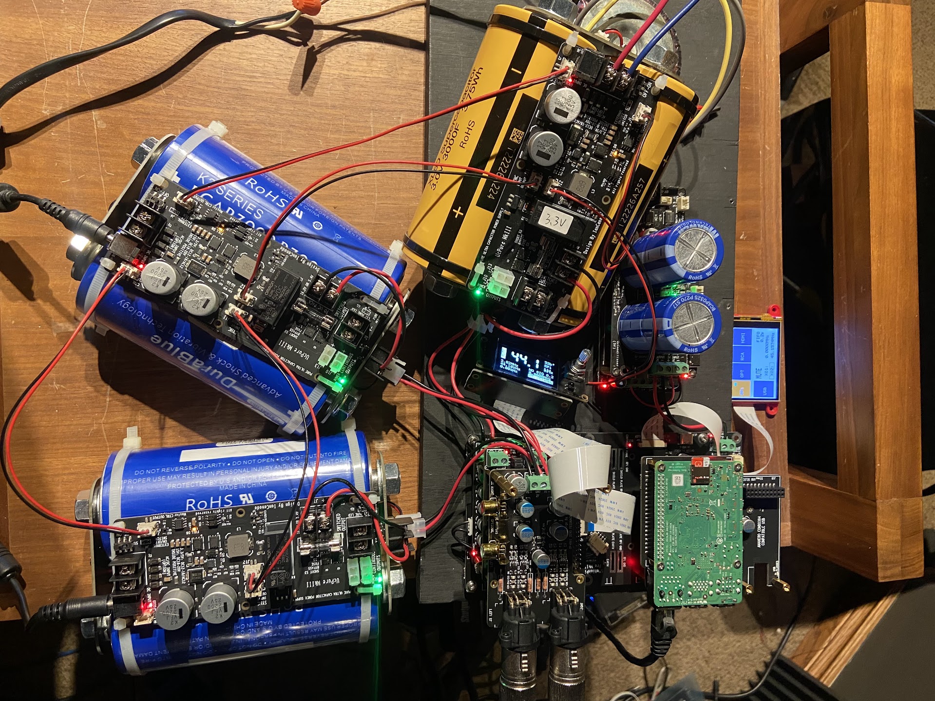

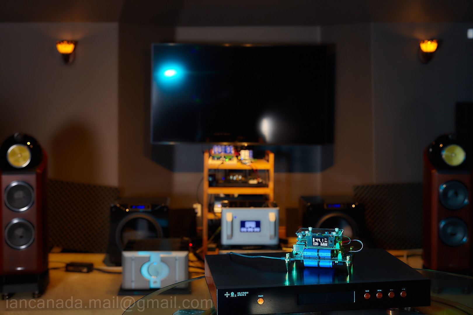

I have been testing this new ES9038Q2M Dual Mono MKII DAC for more than two weeks. I’m really happy with it.
I tried many configurations. They are all excellent. Based on my test, the best sound quality configuration is:
#4B ES9038Q2M Dual Mono MKII DAC DAC
#6B OPA861 I/V
#1D FifoPiQ7 with SC-Pure 45 and 49
#32B LinearPi Solo 5V with #25B UcConditioner 5V
#41C UcPureMkIII 3.3V for both Q7 and DAC (two UcPure3.3V could be even better)
#41C 2*UcPureMkIII 5V for I/V
#49B MonitorPiPro as controller
RaspberryPi 4
#35B StationPiPro (optional)
#19C ReceiverPiProII with controller (optional)
USB streamer (Amanero or compatible, optional)
The recommended MonitorPiPro or ESS controller configuration with SC-Pure 45/49:
  1. DPLL Bandwidth PCM:1
  2. DPLL Bandwidth DSD:1
  3. Other settings: default
Software driver configuration: Audiophonics ESS I-Sabre DAC
ES9038Q2M Dual Mono MKII DAC has more improvements over the previous version.
https://www.diyaudio.com/community/...fight-the-jitter.192465/page-475#post-7452106
But the SC-Pure clocks and UcPure MkIII power supplies (with 3000F UCs) also make big differences.
It could be the best sound quality Sigma-Delta DAC so far I have ever listened to. I even couldn’t decide which one I prefer when compared with my Spring3 (Drive be my external DDC with the same SC-Pure clock upgrade). They are both great. The Spring3 is one of the best R2R that I highly recommend. It sounds a little bit more dynamic. However, the ES9038Q2M DM MKII sounds more musical and delicate, especially for violin and vocal.
Please see the attached picture for the system under testing. I’ll order a case next to make it a well finished DAC.
ReceiverPiPro can receive i2S over hdmi port - that’s the i2S interface to it. See my DAC build

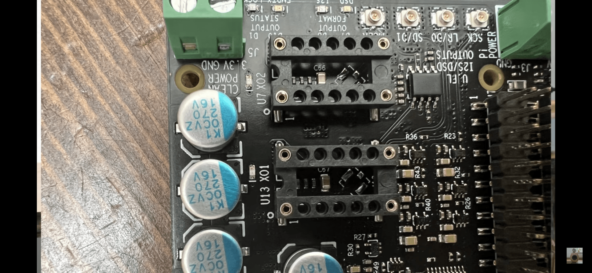

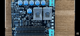

Did I dream about this or I have read posts about there is an order to roll the clocks on FifoPiQ7? I cannot find them.
The original ones looks the same. I want to roll with Sc-Pure (45+49). Should one has to be on top of the board? Please send pictures.
Thank you,
