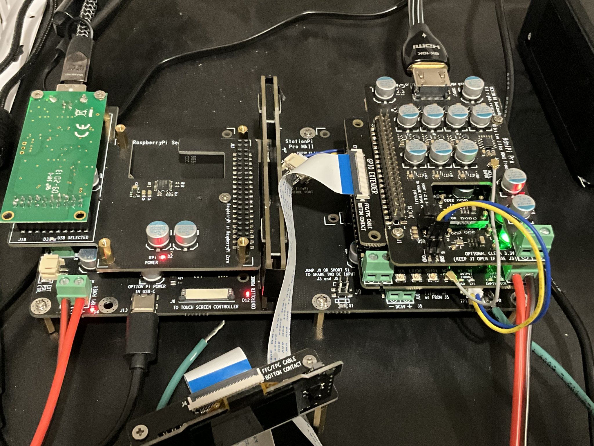

Hello everyone!
First sound test.
No sound and no display. 🙁
If I put the jumpers on J9 StationPiPro, I think I will get conflict with the clean 3.3v on FifoPiQ7. Will I?

Thank you Ian!
I have the monitor but still no sound. It displays NO SIG.
I’ll recheck my Roon config (Amanero board is active) and Holo May (ATE2 on i2s).
Any hints?
Yves
Any hints?

@Yveskoala
Please do it step by step and don't mix things up.
I suggest run the software with RPi only, only install MonotorPi to the RPi GPIO. Do not install anything else.
Make sure MonitorPi OLED shows correct music format when you play, then install them to the system.
My config has no RPI. It was optional. All I need is to reclock the music from USB to i2s.
How the signal is going from the Amanero board to FifoPiQ7?
Sorry for the typing mistake, it's StationPiPro J14.
Please download and read the manual and schematic:
https://github.com/iancanada/Docume.../StationPiPro/StationPiProUsersManualV1.1.pdf
