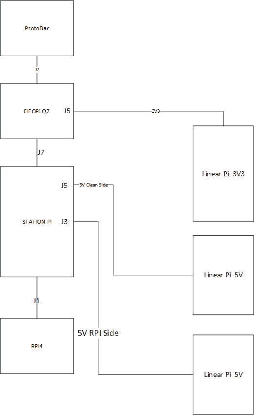

Hello, could someone please help me with this issue? I've assembled a ProtoDac kit following the instructions on Gabsters' channel, and I've also purchased a StationPi Pro and a FifoPiQ7. However, when I connected the ProtoDac to the FifoPiQ7 and the FifoPiQ7 to the StationPIPro, all the correct Q7 lights came on when I switched it on, but there was no sound. Upon further investigation, I noticed that pins 2 and 4 on J7 are showing 3.3V instead of the normal 5V.
I've attached a diagram for reference. When I connect the ProtoDac directly to the RPI, it works fine. But if I connect it directly to the StationPiPro without the Q7, it doesn't work. I understand that the ProtoDac needs 5V, but it seems like 5V is not being supplied. If I use the other GPO set on the Q7, I'm concerned I'll lose the benefits of the Q7. Any guidance on where I might be going wrong 🙁 Any help would be greatly appreciated. No real experience in doing this but its fun
