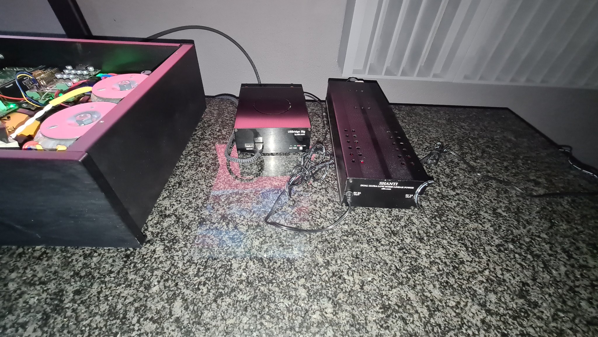

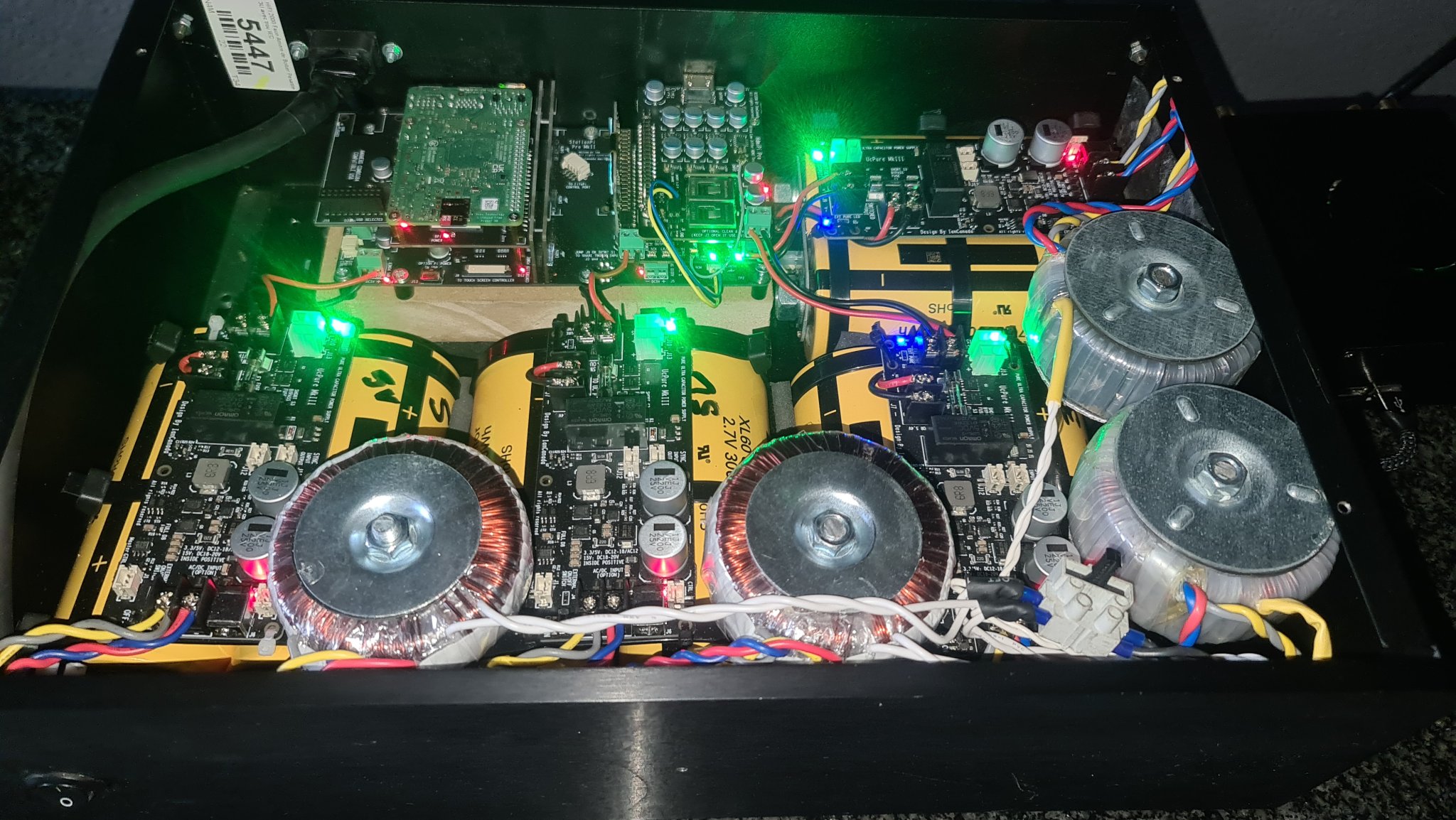

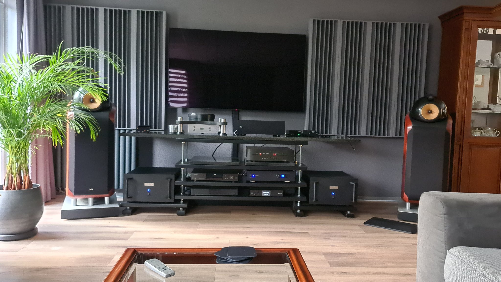

Today I compare 2 streamers.
1. Ian FifoPiQ7 with the SC-PURE clock's soldering on the board and the HDMIPI PRO i2s output.
2. Usbridge signature usb output with the Shanti power supply.
The DAC I use is the Denafrips Terminator Plus.
I also downloaded the TEST TONE from the Denafrips site to be sure the i2s settings are correct.
https://www.denafrips.com/config-i2s
Sorry to say but I hear no difference.
Regards
Rudy

@BMW850 tell us more about connections. What is source for the Ian stack? Ie files on Pi or volumio SharePlay?
What’s is source on usbridge?
How are they both connected to denafrips ? Ian via i2S hdmi out or hdmi pro out?
Usbridge connection to denafrips is I assume usb input.
I don’t know the usbridge.
I use the nuc8i7beh roon rock as the source, tidal and my own files storage on the nuc8i7beh.
Moodeaudio software on the raspberry pi 4.
Usbridge signature usb output to the dac.
FifoPiQ7 with the HdmiPiPro i2s output to the dac.

I love your listening room too. Looks fantastic!

It's surprising that you don't hear any difference at all. The 2 sources, the source power supply, the clock, the clock power supply are all different.
I'd even accept that the USB source sounds better, it's the lack of difference that surprises me.
Plus as I can see the whole audio chain is high-end level, so there should be no problem with resolution (my chain is much worse).

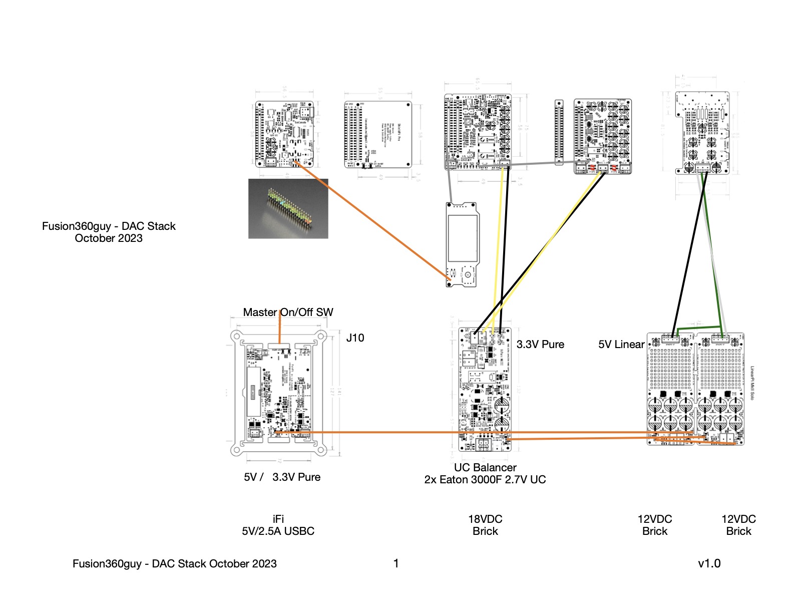

Hi all,
In full transparency and in order to maybe help others (but I doubt it you are all very smart), here is my current DAC stack config diagram on how everything is connected. I have to figure out how SYNC works. I still don't get it. I have blue lights all the time and during play, they sometimes go off for five minutes and come back on so everything is keeping charging to pure mode automatically without the SYNC cables in place.
According to Ian the ways to improve would be to replace the LinearPiDuo with 2 UCPures to power the OPA861. I don't see value in the toroids to power UCPure as the blue is almost always on...and this means the isolation mode is on 95% of time and my cheap power bricks aren't even connected.
Would rather invest more money next into a pre-amp as I go direct into power monitors and y'all say I'm missing something big 😎
Right now this combined with my streamer is heavenly Pure music better than I've every heard (which maybe aint saying much compared to y'all with Macintosh amps and such.....

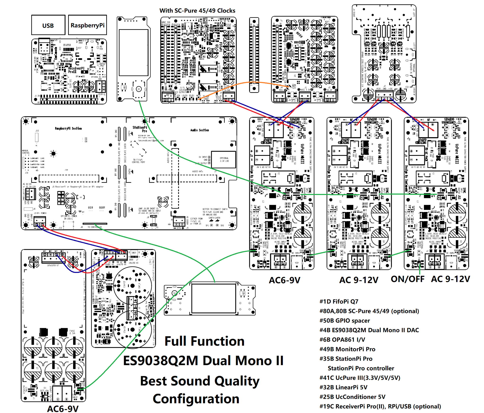

Hi all. I heard some news from Ian. He had provided me this diagram in the last little while and it was very useful to confirm my DAC build.
This is his recommendation to build the highest quality DAC right now at this time, and the power and connections to use.
There is also a blank template to draw your own connections in etc.
Enjoy.
