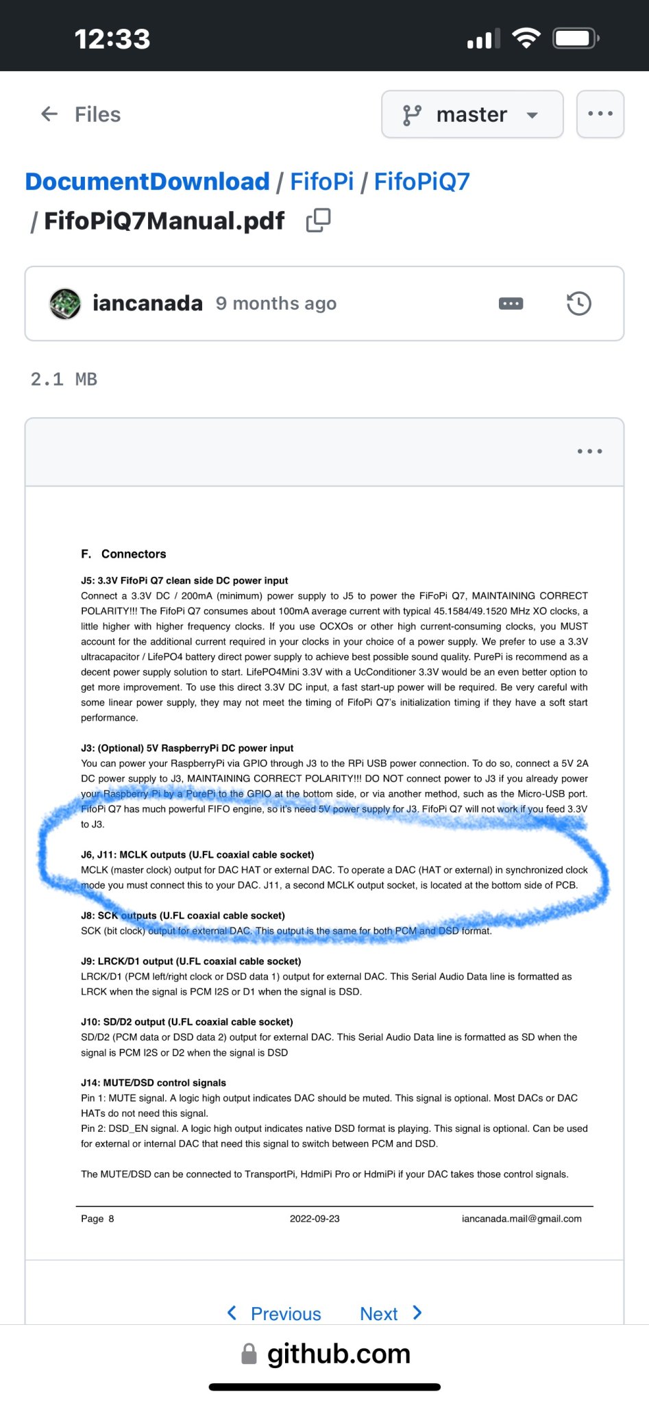

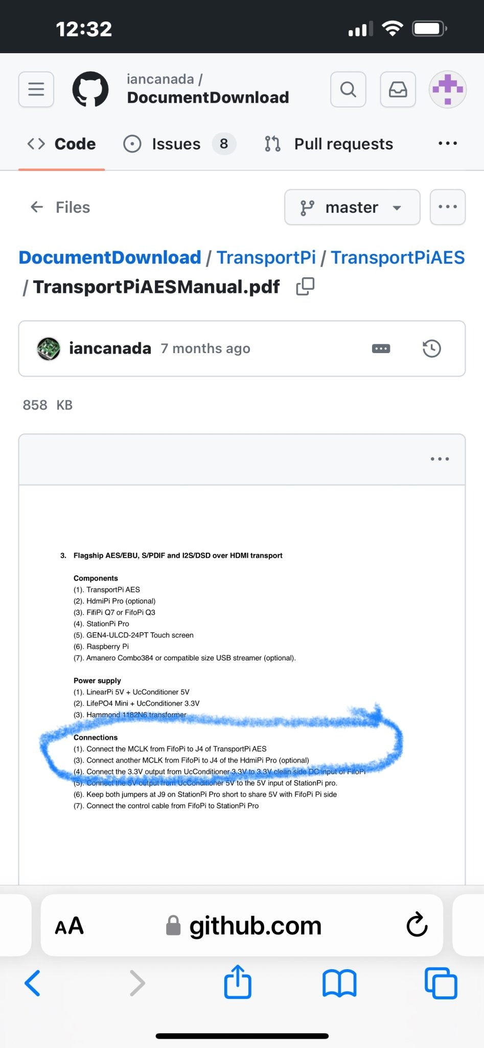

As far as I know you don’t need unless you want to not use i2S signals. Just MCK. I just updated prior post. DualmonoDACII also has 2 MCK positions for input.
I believe fifo you can feed two boards with MCK as you want to do. See example build page I screenshotted.
In you case do you need another MCK from fifo to DAC board? In addition to trasportpiAES? See two manual screenshots

- The MCLK clock cable from ES9038Q2M should go to FiFo Q7, but I use this connector already for my Transport PI AES :-(

You don't need SHIELDPI PRO II here, you do not need the ESS Controller Extension Kit but Ian's GPIO extension kit if you have MONITORPI PRO II, UCCONDITIONER MKII Ultra Capacitor Conditioner Board 5V and MAXWELL Supercapacitor 2.7V 325F and are not needed here because you have PUREPI II.
First assemble the STATIONPI PRO according to the instructions, look for How to share one 5V power supply with J3 and J5 in the manual on page 9 and do it according to the instructions.
RECEIVERPI PRO II goes directly Under the RPI, on the clean side go Q7, on Q7 go TRANSPORTPI AES Ultra, then DUAL MONO PLUS DAC ES9038Q2M HAT Raspberry Pi / I2S, then OPA861.
With PUREPI II 3.3V on FIFOPI and DAC, then PUREPI 5V on STATIONPI PRO II J5 or J3 but only on one, never on both.
"The MCLK clock cable from ES9038Q2M should go to FiFo Q7, but I use this connector already for my Transport PI AES" >> FIPOPI q7 has two master connectors, one is above, the other is below on the other side of fifopi and you can also use it for DAC and for Transportpi.
You still lack +/-5V for OPA861, there you should have taken 2x LinearPI + 2x 5V UCCONDITIONER and 4 Maxwell capacitors, I would also add one 3.3V UCCONDITIONER + 2 Maxwells for DAC and FIFOPI Q7 3.3V

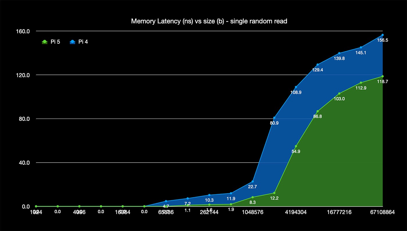

2024 would of been miserable without my RPi 5s. I wouldn't know what to do.
What I love is the improved Memory Latency:
I run everything in RAM. My whole OS loads in RAM, so you can pull out the USB stick after loading and it still runs normally. All my well-mastered tracks run exclusively in RAM, so this improved latency is definately something I look forward as I'm all about low latency at the UcPure level, kernel level, output level and I guess now RAM level. I have zero leaks in my chain for an Authentic to the Master Source Tapes experience. With the added CPU PWR and lower Memory Latency, it's just going to make that experience that much better. My head is spinning now knowing how easily I could of missed grabbing an RPi 5. It would of taken an RPi 6 in 2027 to recover.
My physical media will always be more valuable to me than the hardware. But the hardware is at the forefront of technology so all good.
Too many have holes in their chains or flaws to incorporate a RPi 5 so they are best to stick with RPi 3 or RPi Zero. Their gear is pretty, but not robust or CPU PWR enough. It's all about being off Mains. It's 2023, who is still on Mains? That's Mickey Mouse. No wonder they have to stay on RPi 3.
