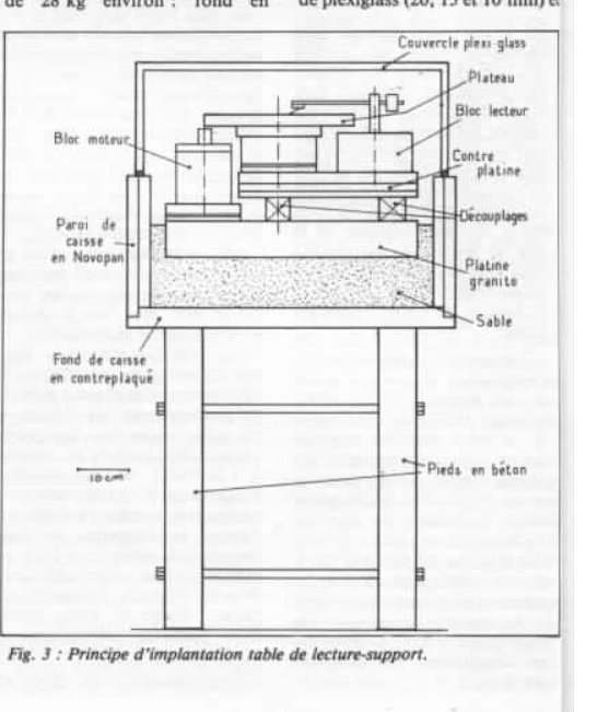

If i did read correctly the weight is when used with 4 dampers. I think i did so then probably you will need to use the A1 or A2 type depending on what is in your stack.. If the bottom board is the UCPI you will need to increase the diameter of the mounting hole but the outer dimensions of the grommet are exceeding the mounting area. The Theta A or B will fit better but they are more expensive but hobby cost money. If you spend loads on the clocks might as well try to makle them work the best they can.
The insulator will connect the board to another item. You can experiment with that item too. The French L''Audiophile magazine published a wooden '' container '' on concrete paws in 1981. In the container there was a kind of marble element buried in 35 kilogrammes of sand that was used as a base for a turntable. No need to copy but sand is cheap. In the USA probably easy to find lead shot.
Maybe you will need to do some experiments to find out where you need to go and how things can be further improved.

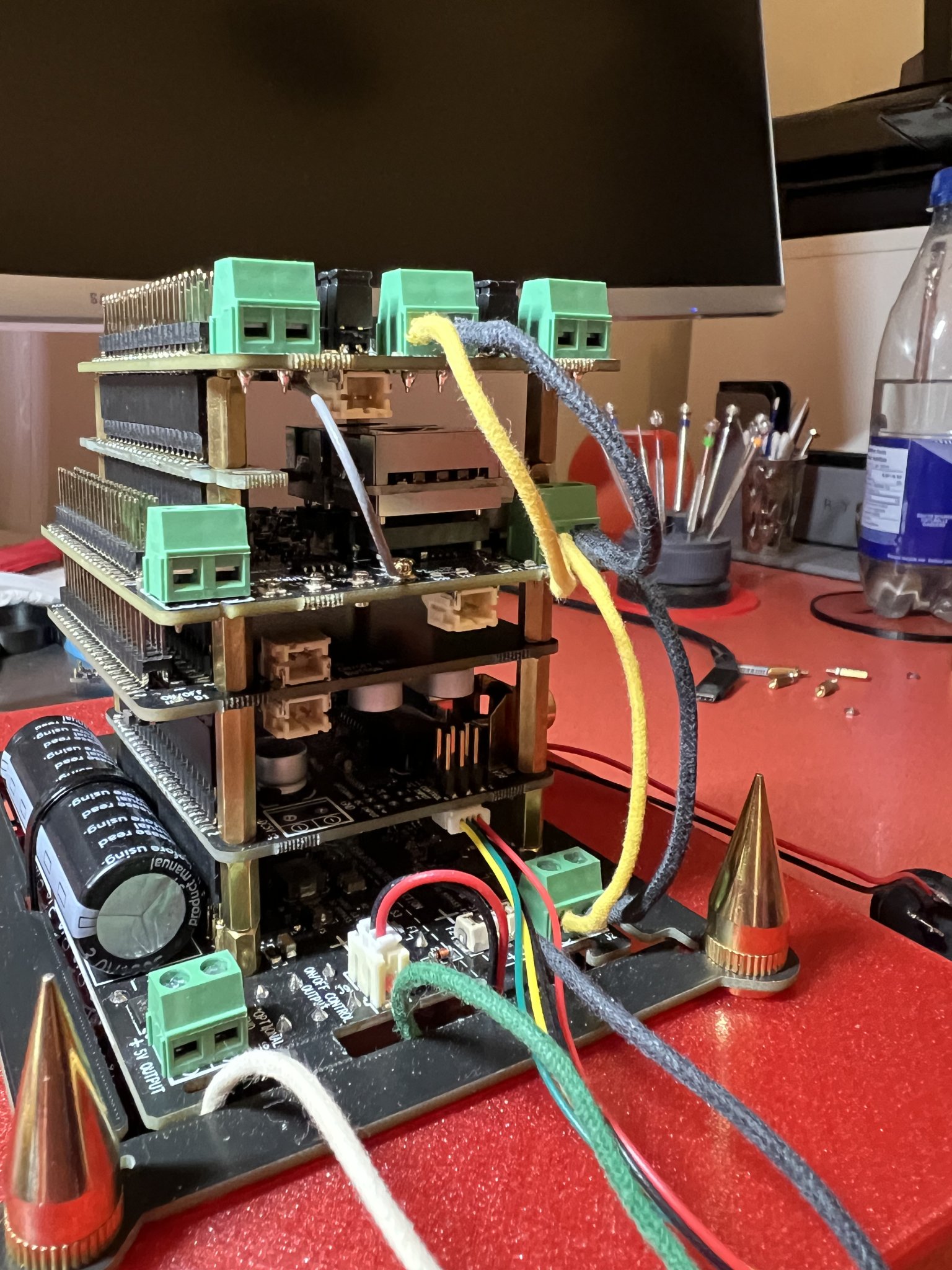

Would the UC-PureIII and the ultracapacitors fit within a 2U (80 mm) height enclosure?
Hello ,
Unless you can use some kind of nylon nuts i would not take the risk. If you have just a very tiny clearance you will need to mount things with decent brackets and no tie raps or similar stuff.
Most enclosures are not that sturdy and with little clearance it is not that difficult to create a short circuit.
Maybe you can make a bigger hole where the nuts could touch the enclosure and then cover that hole with a little piece of metal mounted at 10? millimeter distance by using stand offs. I used this technique several times.
greetings, eduard

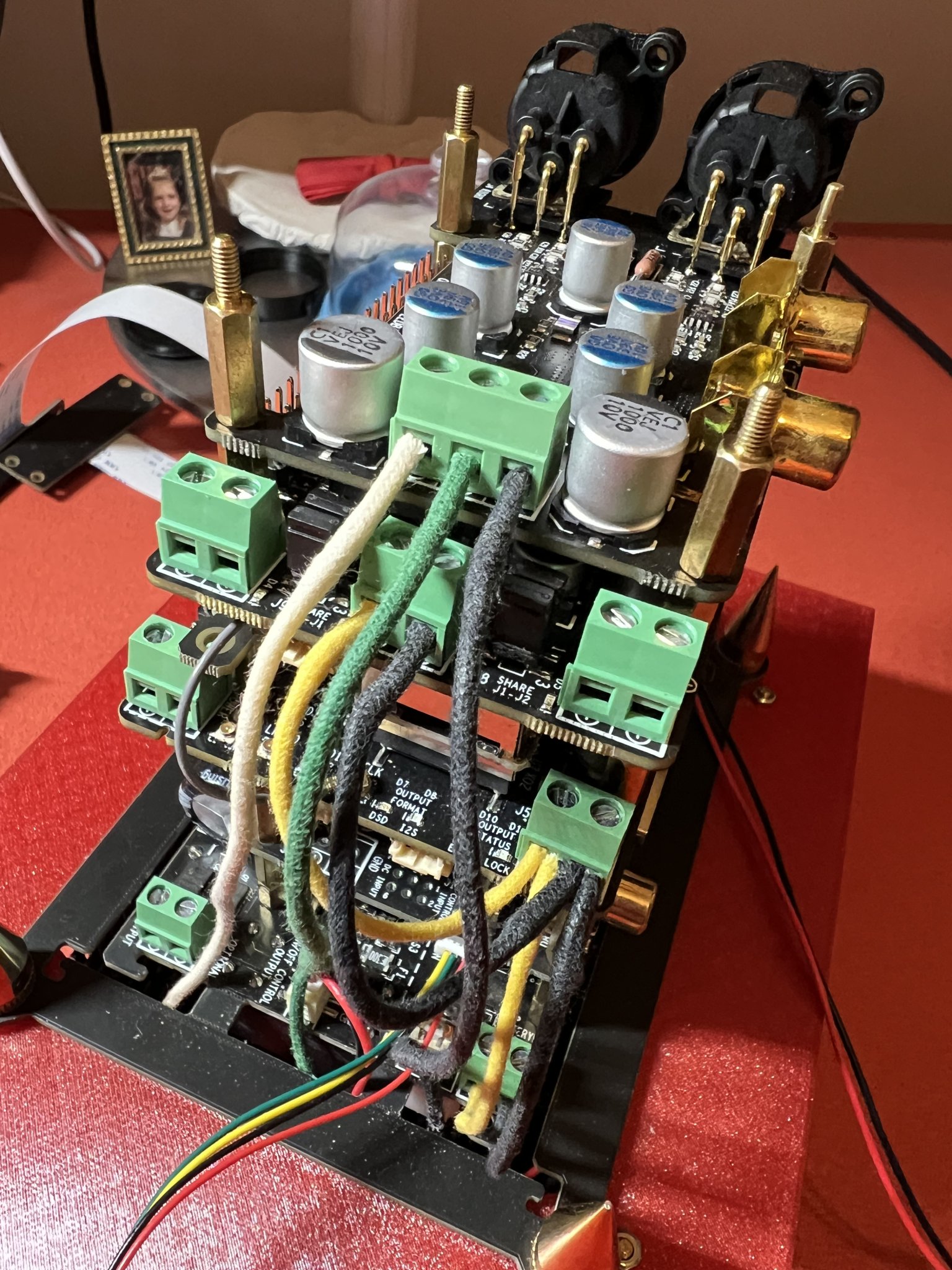

Hello,
These caps need burn in to especially if you just will be using a low current. Maybe get a big power resistor and let them do a good exercise.
I support the idea of having the minimal number of interruptions from the cap board to the Q7. NOT sure if you will hear the difference between a ten and a twenty inch cable so i will try to make it 3 inches and just solder at Q7 and probably the same on the other board. I wouldn't worry about the cable gauge. Twist the two cables or not? If it just 3 inches i would not bother.
Many things to try and share.
Greetings,Eduard
Reactions: fusion360guy

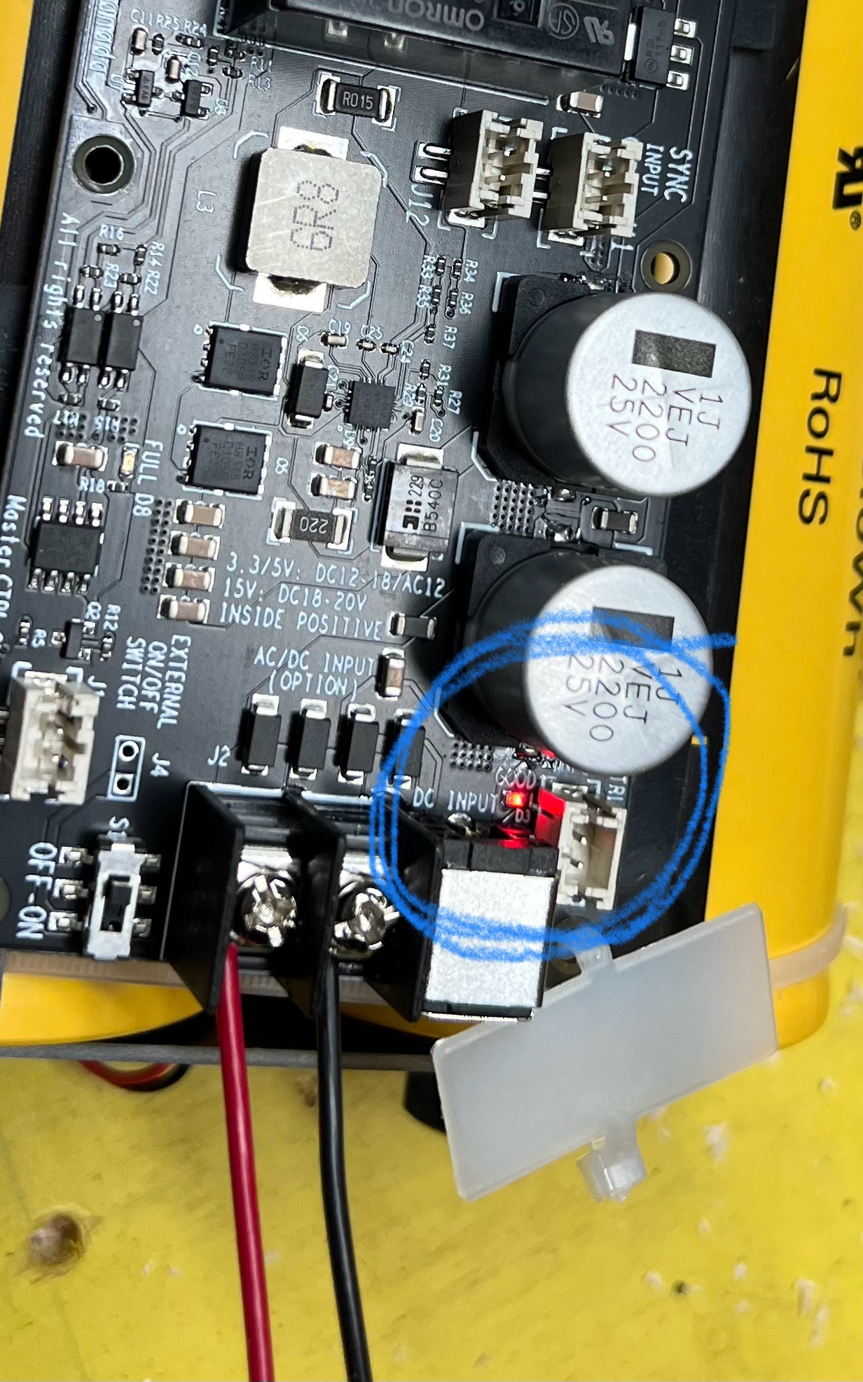

I’m going to hook up to a power brick which is running at about 17v and see if it starts charging. Do I have to de charge it before I hook an actual load up?
D3 lit and nothing blew up and then I unplugged power brick.

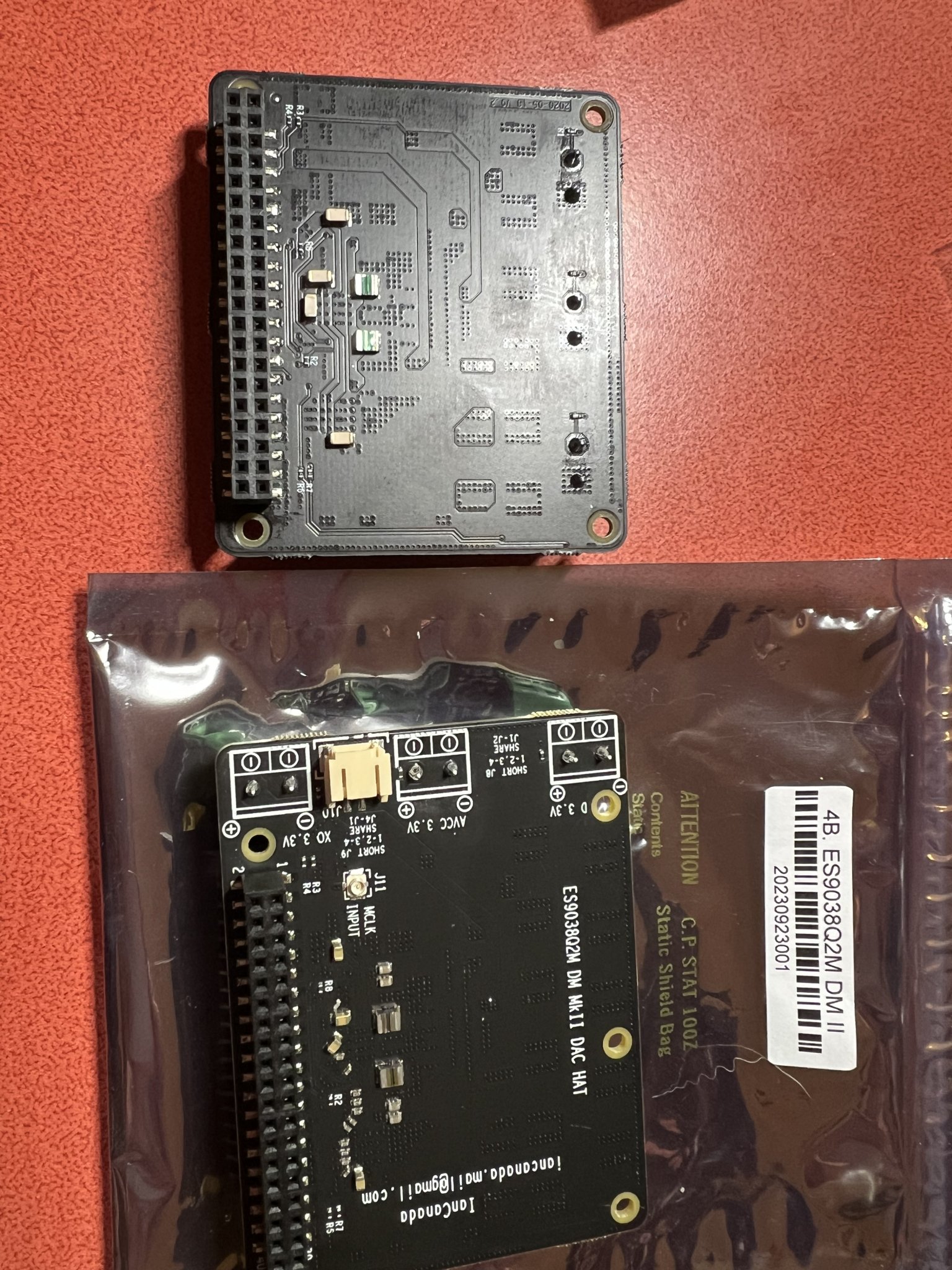

New ES903Q2M Dual Mono MkII board comparison…..
  • more noise reduction
  • better placement of 3.3v power blocks and optional jumpers to feed left and right from the center block or have 3 separate power input without jumpers
  • MCLK inputs on top AND bottom
  • enhanced functionality with MonitorPiPro (I don’t know what that is yet stay tuned)
  • OPA861 fits better on top. I think the PIN blocks are slightly higher.
I have to remember to reset my DAC settings via MonitorPiPro as they are probably factory again.
Good job @iancanada

Hello,
All the info is in the manual. Same like the ucpi it will take some time to charge the caps. During charging there is a selector switched to off position when charging is finished it will be indicated with ucpi . I think ucpure it will be the same.
Instead of connecting the circuit that takes minimal load you could connect a big resistor so it will have shorter periods free from ac because they are drained rather quickly.
Even if they dont have memory they could become "" better "
Good luck, Eduard
Good job @iancanada

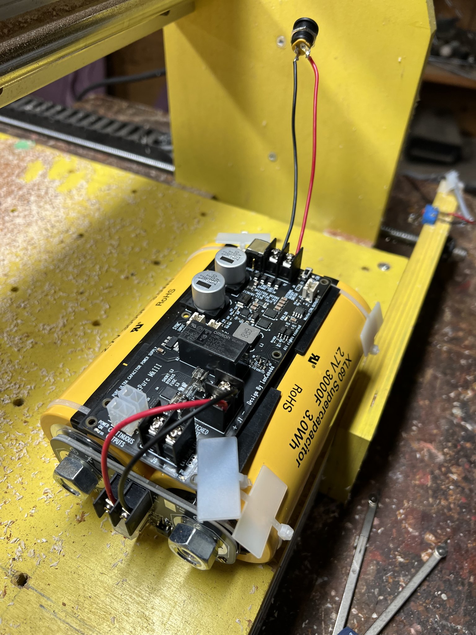

She works. The DAC setting must be stored in MonitorPiPro NVM. It kept what I had even on the new DAC board. Of course everything still sounds stellar.
Tomorrow I’ll try and hook up the UCPureIII pack I built. I’m hesitant to do it until I build some kind of case for the UC pack. There too many big metal bolts sticking out to accidentally get shorted out by some household mishaps or something dumb.
