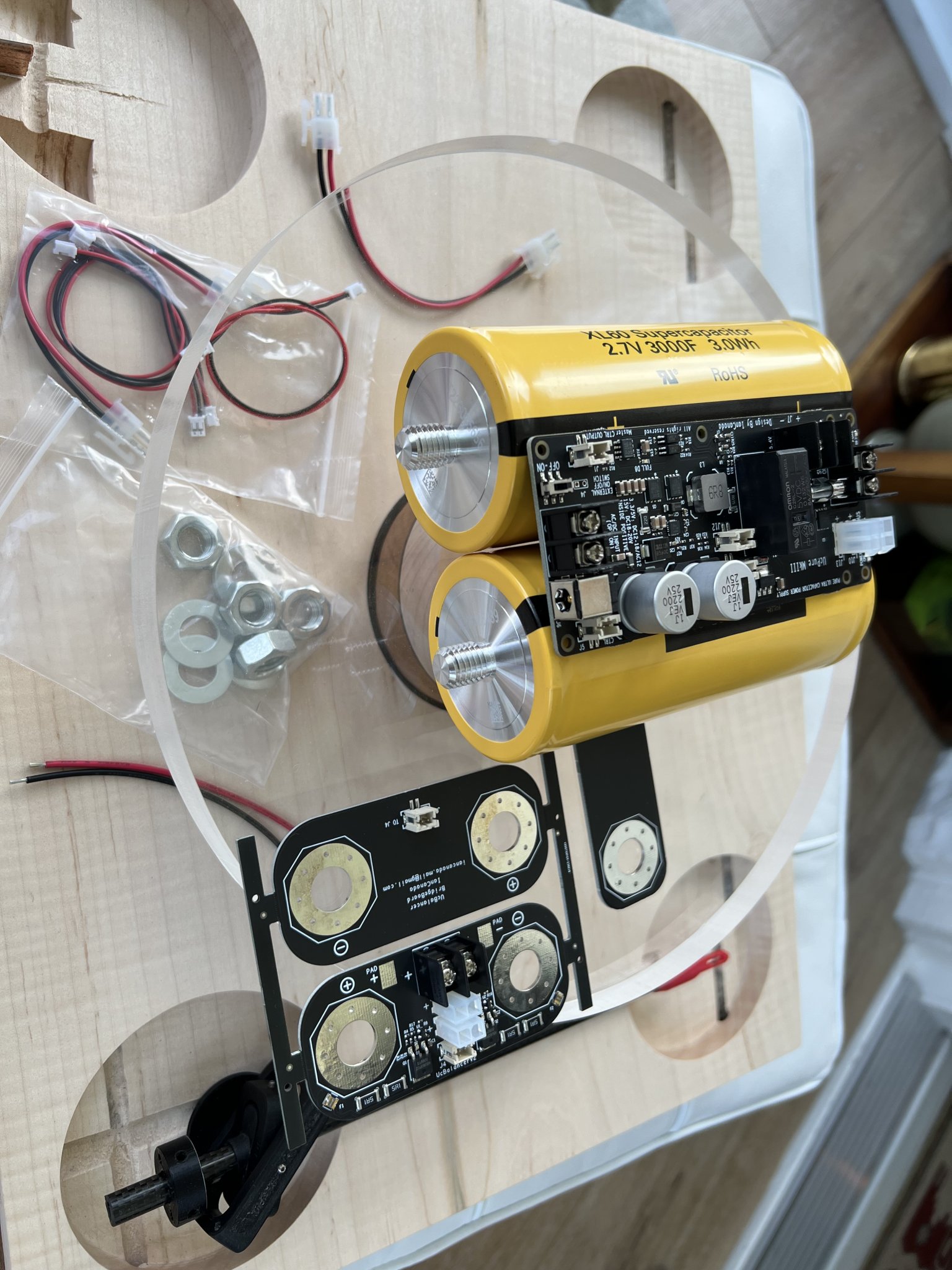

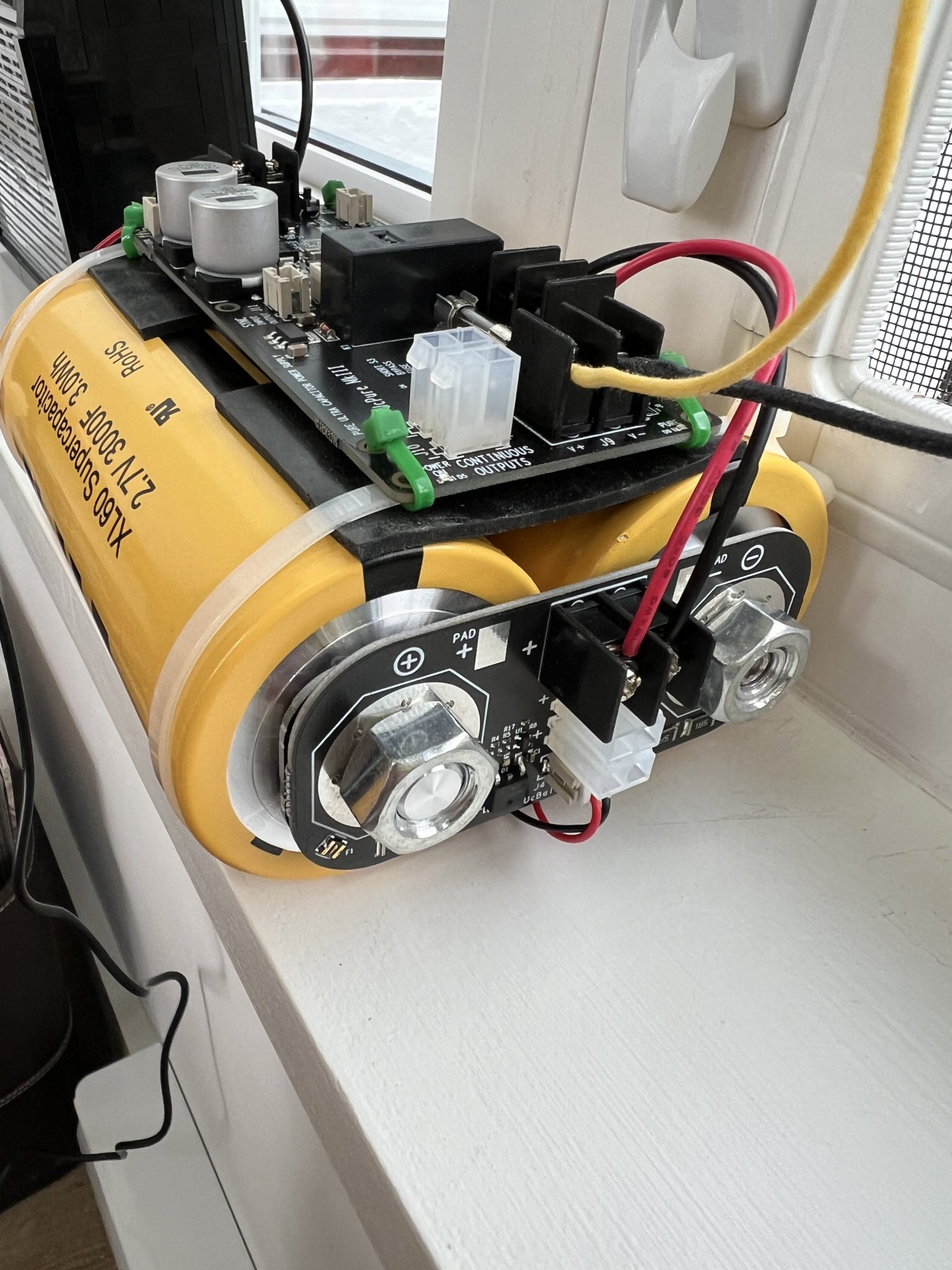

I have an issue. There’s only small voltage across the yellow supercaps. So it’s not charging. And when ON but no pure light in it’s not passing any voltage. Let me know if anyone has suggestions.Manual says “about 1 hour” so I’m just wondering if something is wrong. It’s been 3.5 hours now

Hello,I have an issue. There’s only small voltage across the yellow supercaps. So it’s not charging. And when ON but no pure light in it’s not passing any voltage. Let me know if anyone has suggestions.
Better switch it of!
Check polarity of the wiring. I think manual says something about length of the charging cables.
Caps are not from Ebay or Amazon?

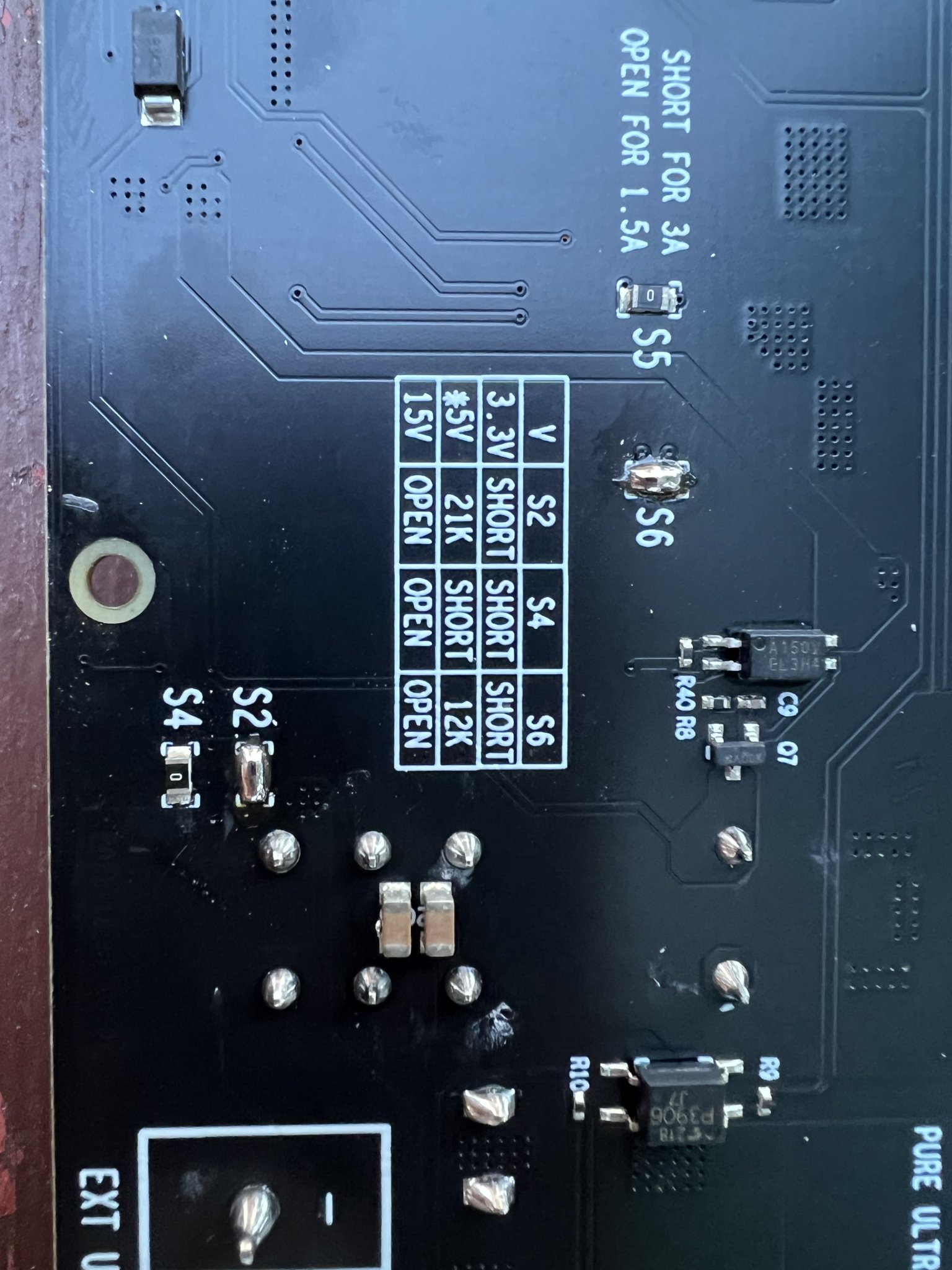

By default it will be charging with 3A but maybe your 3,5 A cant do that. You can easily change the setting to 1,5 A.
You could check the current running with a multimeter.
Greetings, eduard
Thanks eduard. Polarity is good. Length is less than six inches from charger to terminals. UC are from mouser.

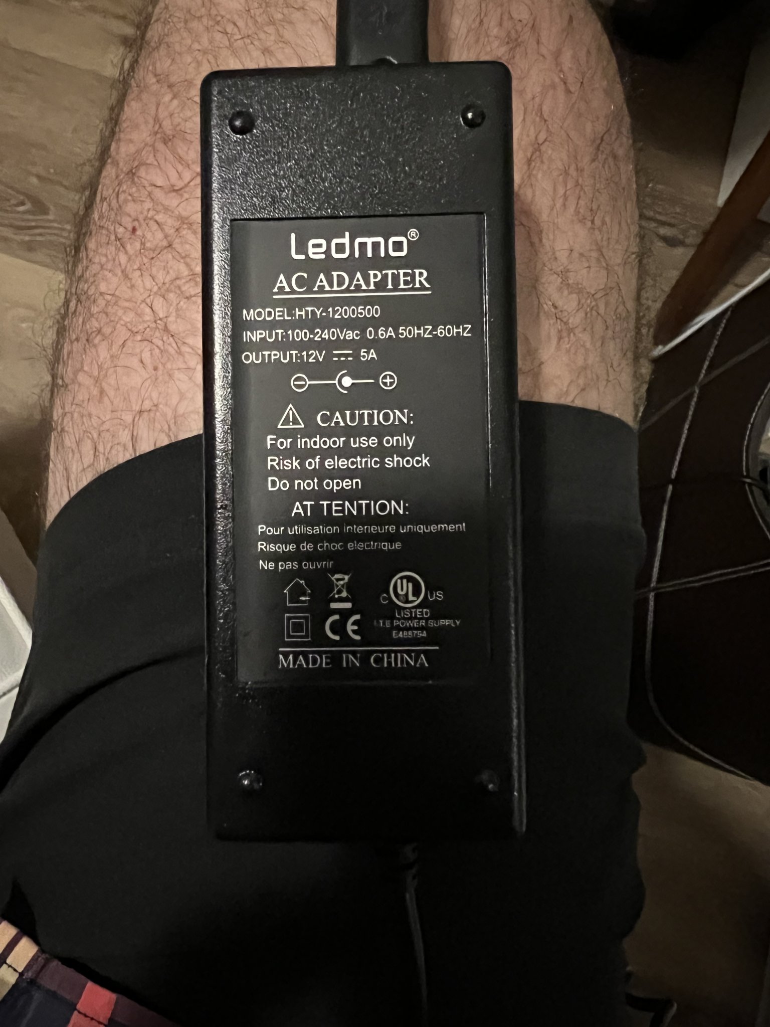

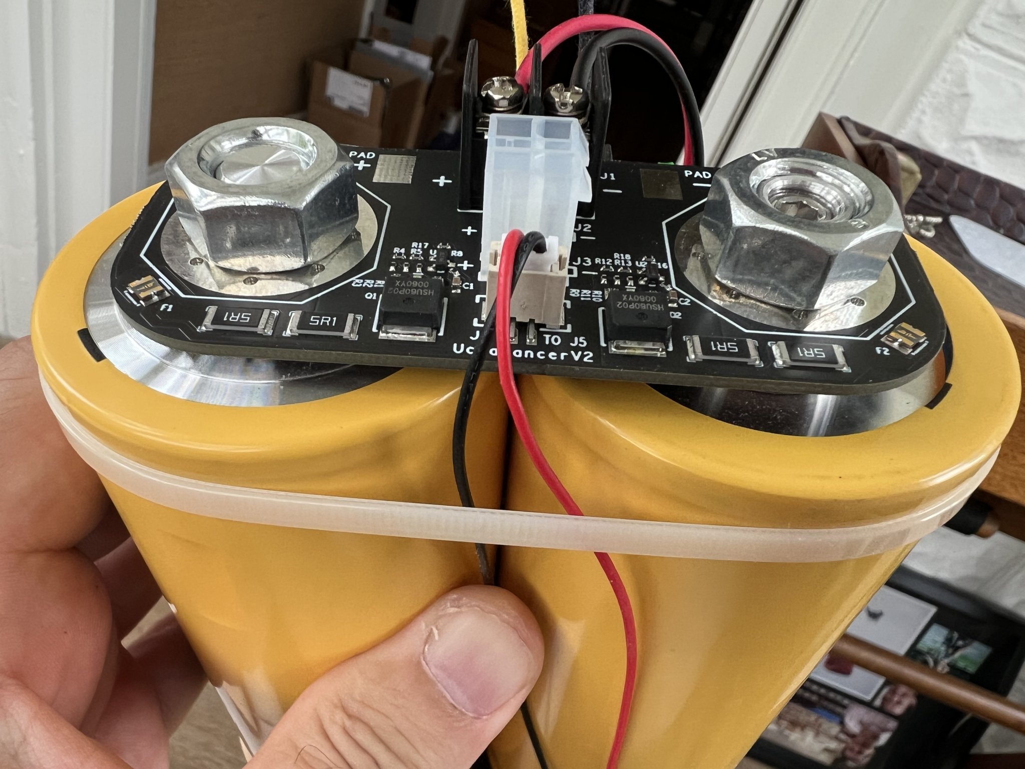

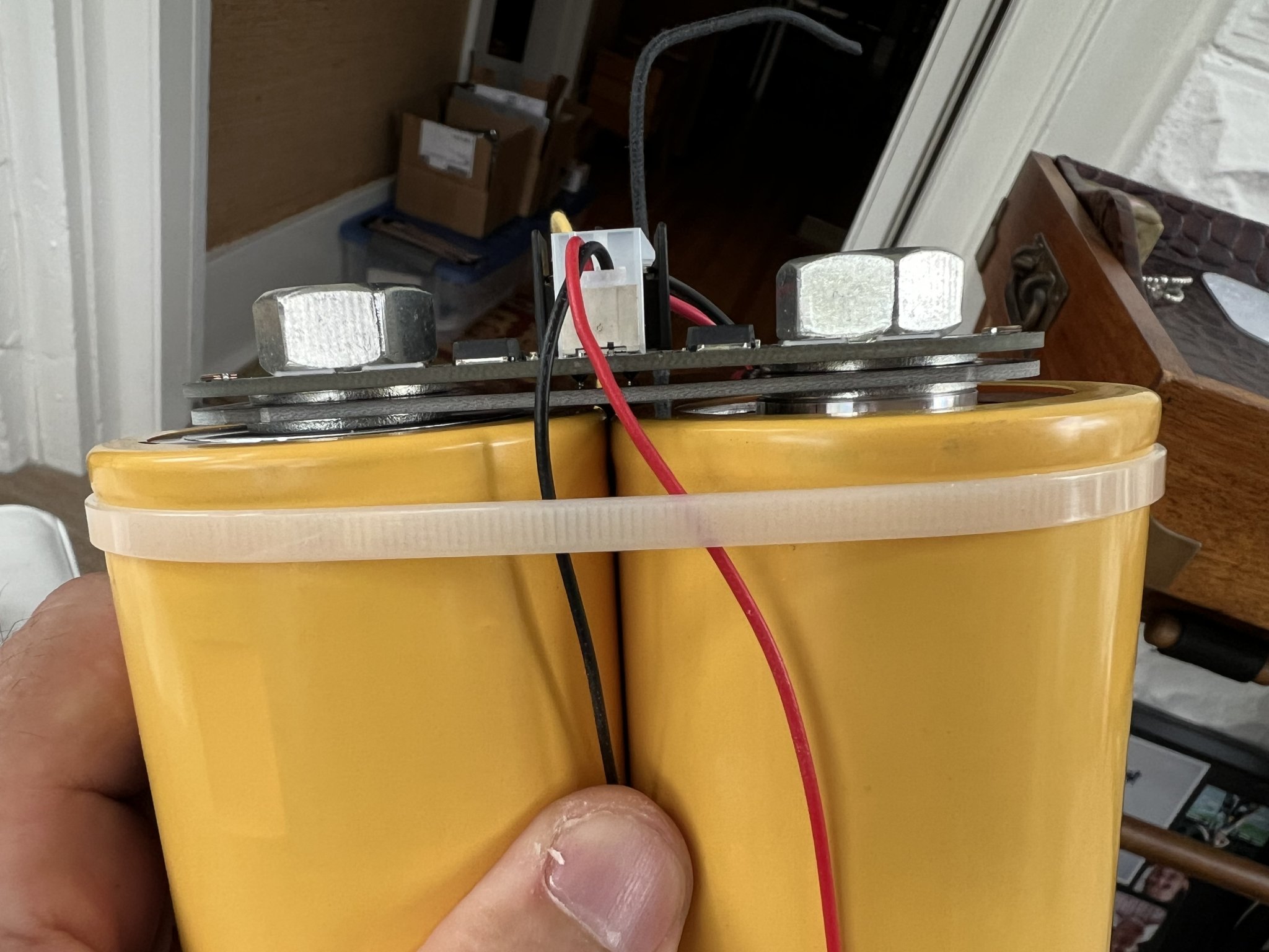

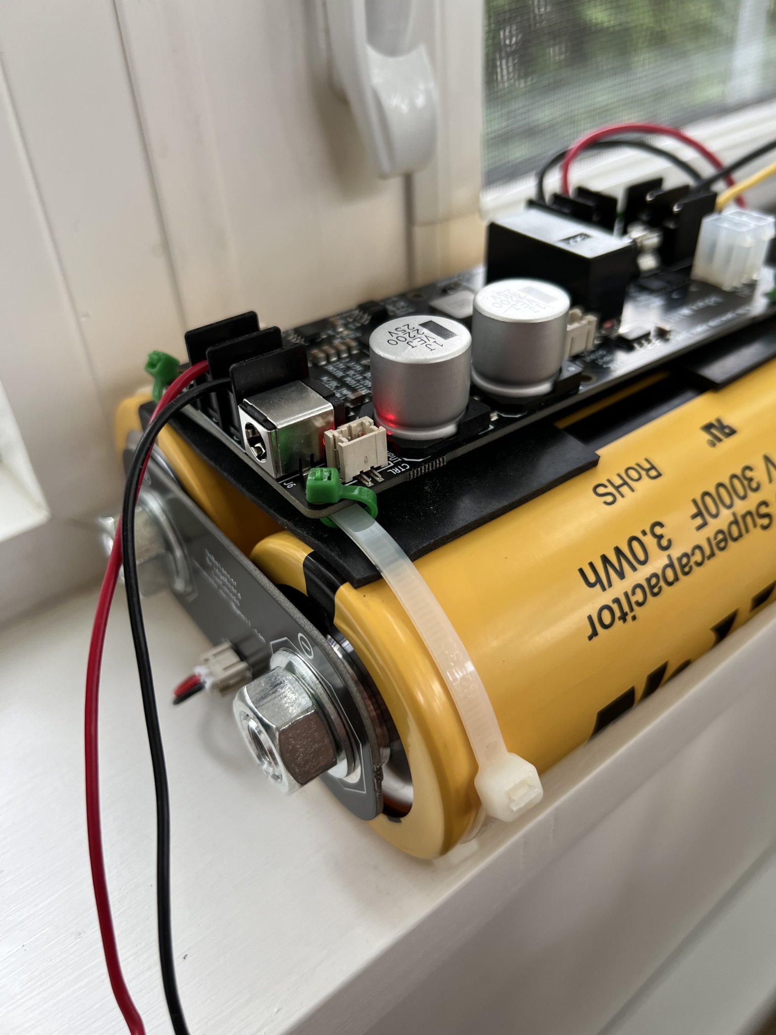

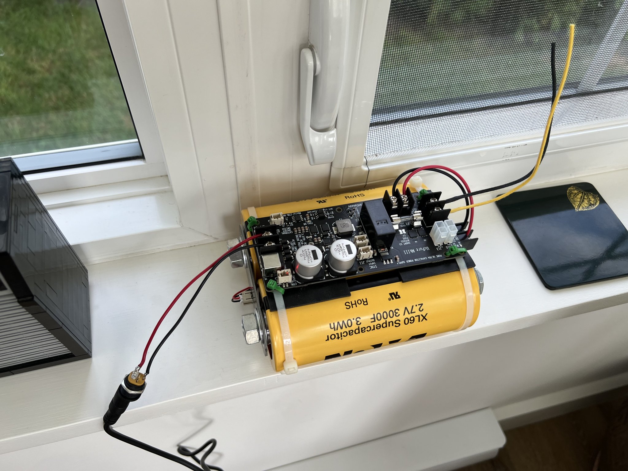

I get no voltage at J7 going to UC pack. So it’s not charging for some reason. Bad board or user error. I’ve read everything six times to Sunday. I have an extra part that isn’t in manual of UC balancer that looks like a spacer to get main board higher up. See pic with edge on view and last parts layout picture. Other than that it looks exactly like the pictures. I’ve check the glass fuse with an ohmeter and there is continuity. Manual says for 3.3v output which I need for fifopiq7 clean side I can use a 9-20dcv laptop ps. Which is what I have. As far as I can tell I’ve followed everything exactly as per manual to get 3.3v output. Issue is board is not supplying charge to caps. Re brick it is 12vdc 5A. Picture added.
OK. It turns out I am dumb. Everything is ok. It just could take hours to charge up these big yellow scuba tanks!
I will leave it overnight. Note you only get voltage at J7 if you unplug the pack (to check proper voltage for charging).
"When connecting the UC package with switch at the off position, J7 will drop to 0V and will take hours to build up to 3.4V. D8 will keep off until then."
@fusion360guy lets us know the status so we can help. When you are charging the 2 silver capacitors will get warm FYI and if you feel you can please measure the DC voltage across one of those while charging and state the voltage
Well spotted! There should be only 1 board at each end of the caps @fusion360guy
Need to remove the bridge board 100%
Ok. I figured it was to get the main board higher as I had ‘legs’ on bottom side of the board touching the cans. So I put it in there thinking it was to raise things up.Well spotted! There should be only 1 board at each end of the caps @fusion360guy
Is it safe to remove and rebuild now without the ‘3rd board’
