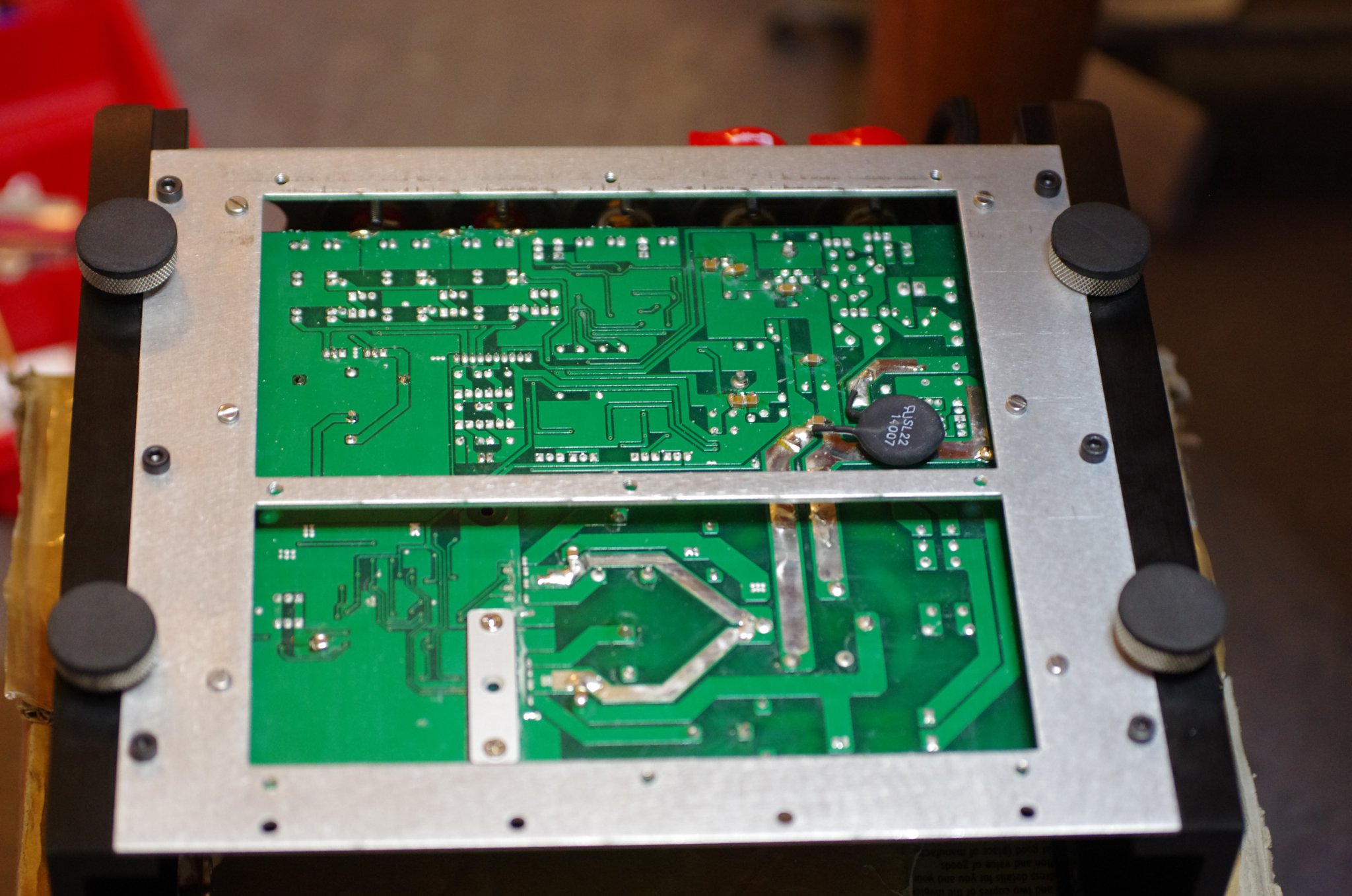

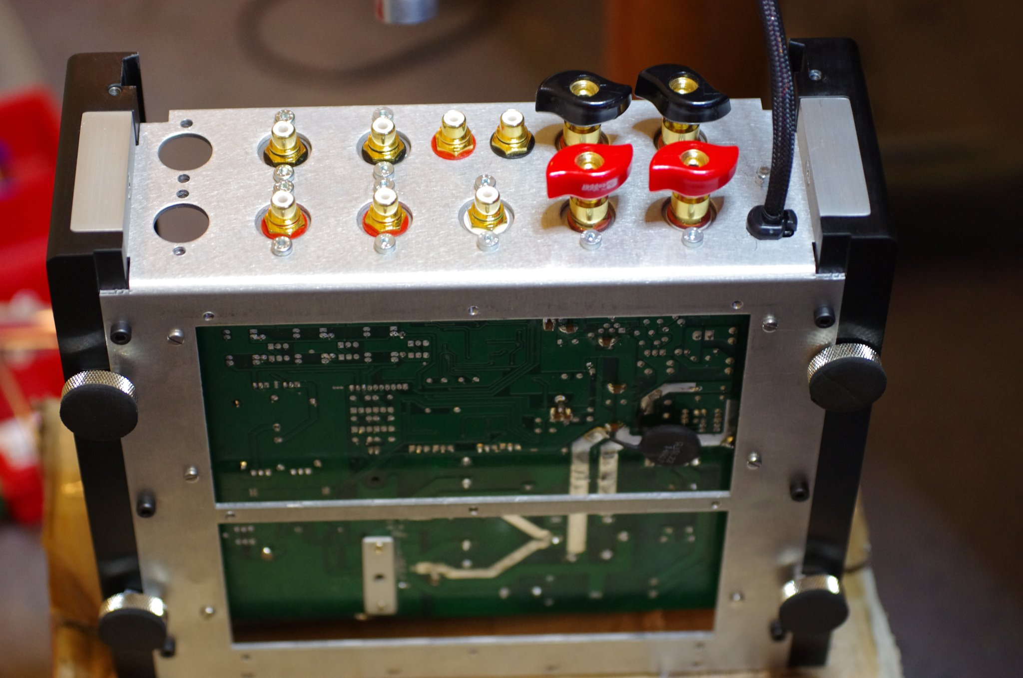

P.s A few days ago i mentioned a trick i used in the past to increase internal height of a chassis. I made a new chassis for my Virtue Sensation that i use in my cinema setup. The circuitboard is mounted onto the aluminium bottomplate but i have access to all soldering joints because i can remove the cover that closes the two big rectangular holes. If you mount that cover at 15 mm distance by means of metal stand offs you can create extra height. Usually you will have 15 mm free space under your chassis if the feet you are using are let us say 20 mm height. This way you can create some extra airflow if you like. Same trick can be done at the top plate.

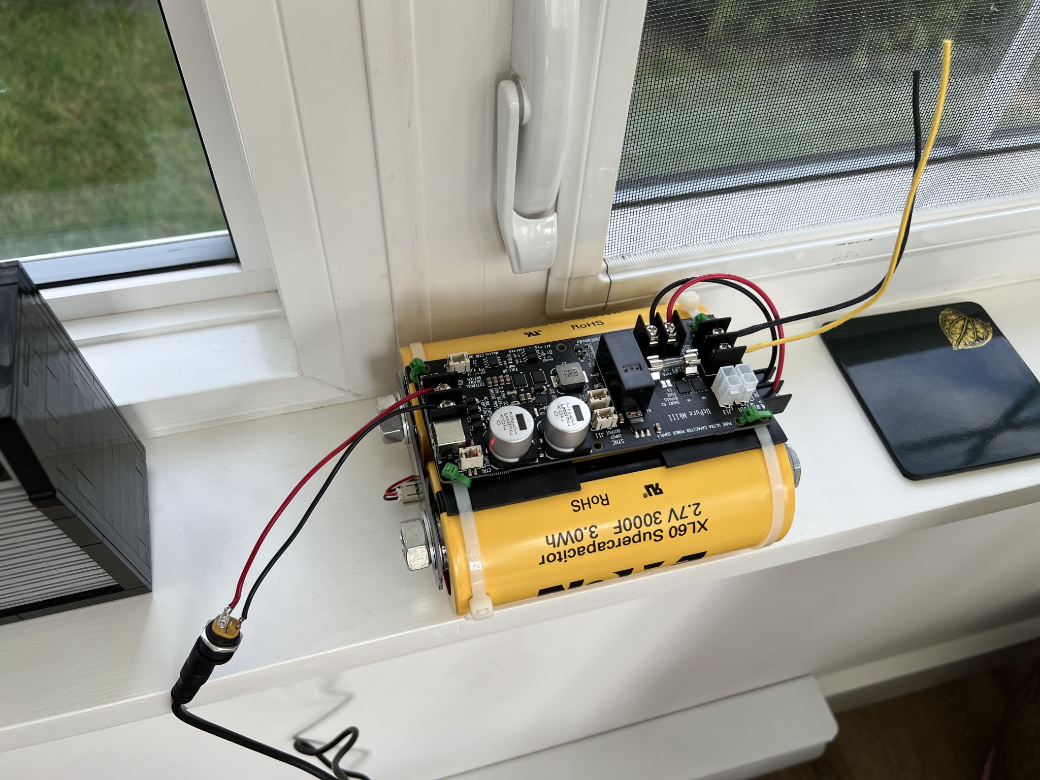

I finally got up nerve to charge my UC pack.
In the manual it says current can be 1000A.
Is that a typo. The fifoPi clean 3.3v can’t possibly draw that much current. Does the UCPureIII board control the current from the UCaps ?
I wouldn’t want to bring one of these through Pearson security gates 🤪
It’s been charging for 2 hours. D8 hasn’t come in yet.
The switch is in the off position…
