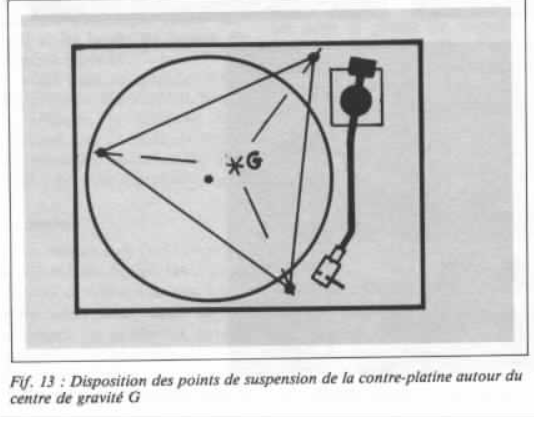

I think because most stacks present here are interconnected by GPIO and stand off i guess the most effective way to create a peaceful surrounding for it will be mounting the lowest board with Taica '' grommets '' with the right weight rating. As you can see in the document the load should be equally spread across the 4 or 3 Taica elements. Maybe you need to add a little extra weight in some area to create an equilibrium.
A bit like Verdier described when using 3 feet positioned around the centre of gravity for his turntable.
You could decide to include the Eatons into the package to be mounted in isolation.
We will have to some test if you want to find the optimum solution.
Greetings, eduard

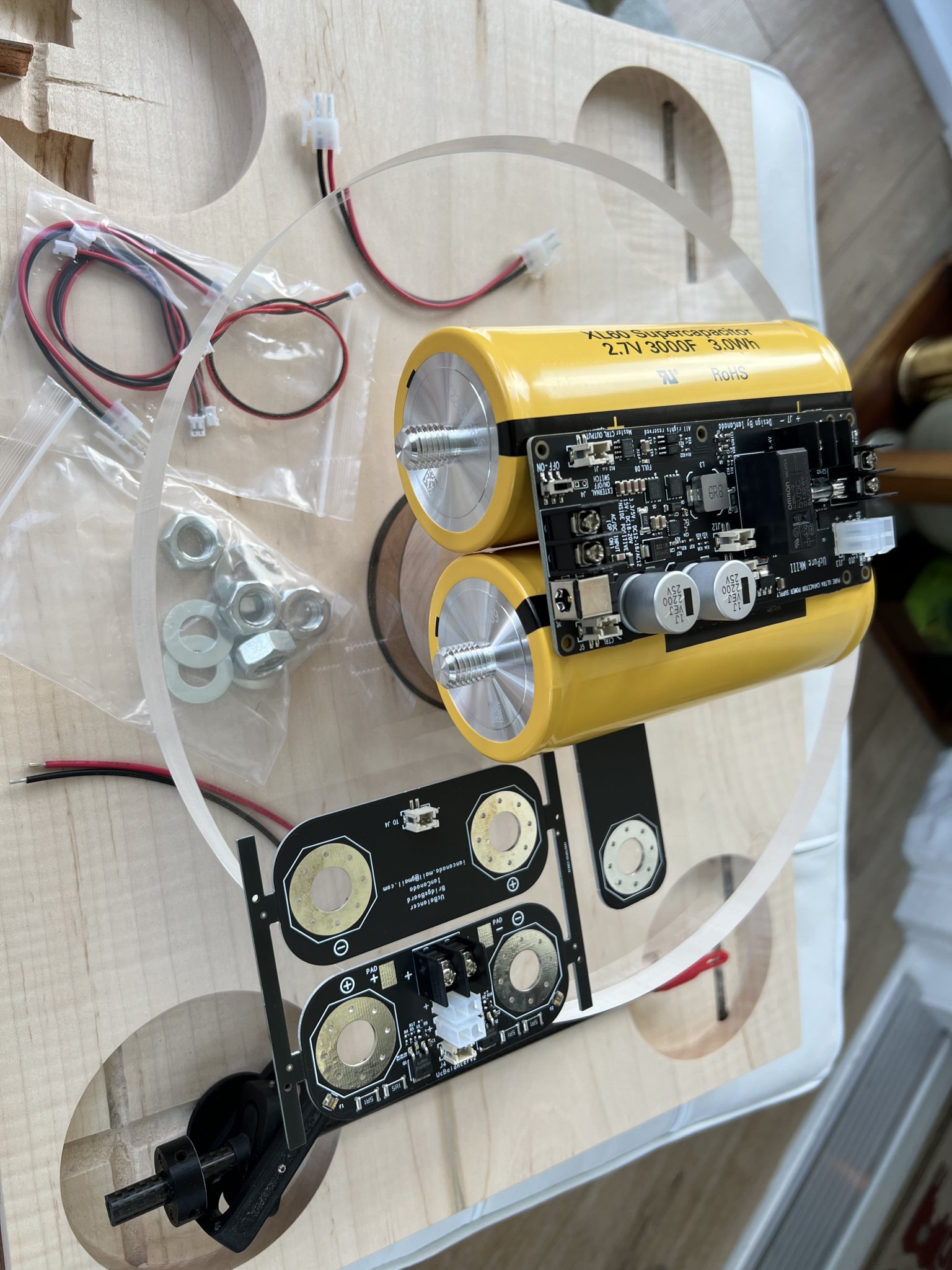

Ok. This just arrived. I must be graduating to purist. 👨🏫The yellow tanks are bigger than my whole DAC stack 😂😂😂 in pictures they look tiny. Now I know why gabsters case was so big 😎 I better read the manual on this.
How do I discharge them if I need to so I don’t blow anything up! ? In Bell Canada we used to use lightbulbs to discharge central office caps before changing large fuses so they wouldn’t blow.

OK. I found this in the UCBalancer manual. It also says on the EATON google results that "Supercapacitors are transported fully discharged. "Ok. This just arrived. I must be graduating to purist. 👨🏫The yellow tanks are bigger than my whole DAC stack 😂😂😂 in pictures they look tiny. Now I know why gabsters case was so big 😎 I better read the manual on this.
underneath you see my in progress turntable project! Which will eventually plug into this DAC (I know - not a purist move).

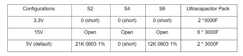

Question: is there a safe easy way to change UCPureIII voltage from default of 5v to 3.3v? I think I got the wrong version.
I see the designation on back to short 3 terminal where there are surface mount resistors but there are not shorting straps on either side of board.
When I read the voltages with voltmeter they more closely correspond to 5V.

The answer is to short the resistor DIY style with solder although the manual calls them jumpers. So to me it was confusing. Once you do this it’s probably not easy to go back to another config.Question: is there a safe easy way to change UCPureIII voltage from default of 5v to 3.3v? I think I got the wrong version.
Correct, replace the smd resistor with a jumper, after that it’s not easy going back to 5v. Tiny stuff.

Anyone happen to have a photo. I have heard to use jumpers and I have heard ‘solder balls’. I guess just short the resistor by joining the two ends?Correct, replace the smd resistor with a jumper, after that it’s not easy going back to 5v. Tiny stuff.
You just short the pads with solder - the gap is small so very easy to do.....
.....of course if you want 3.3v you remove the resistors and short the pads with solder
