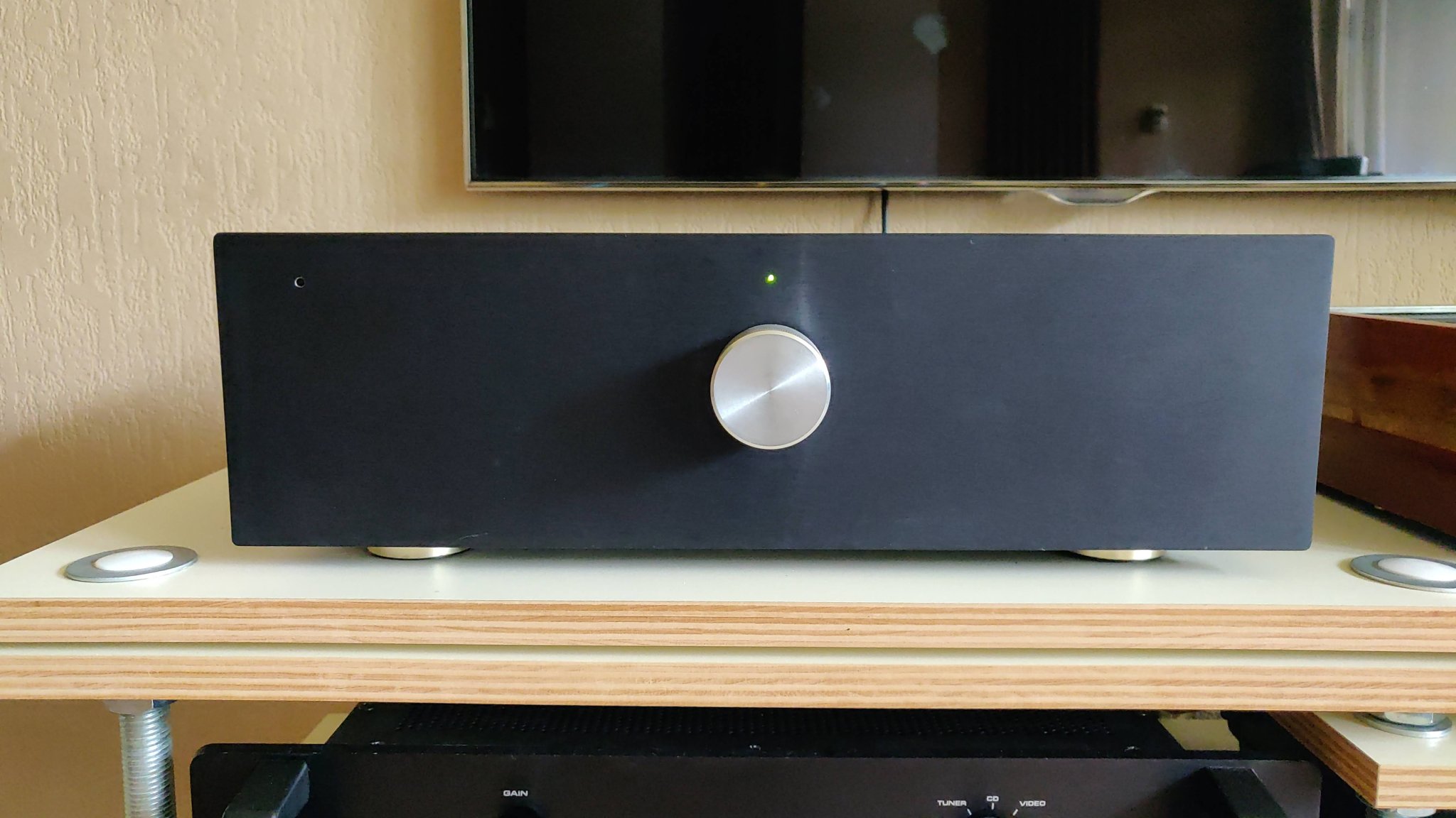

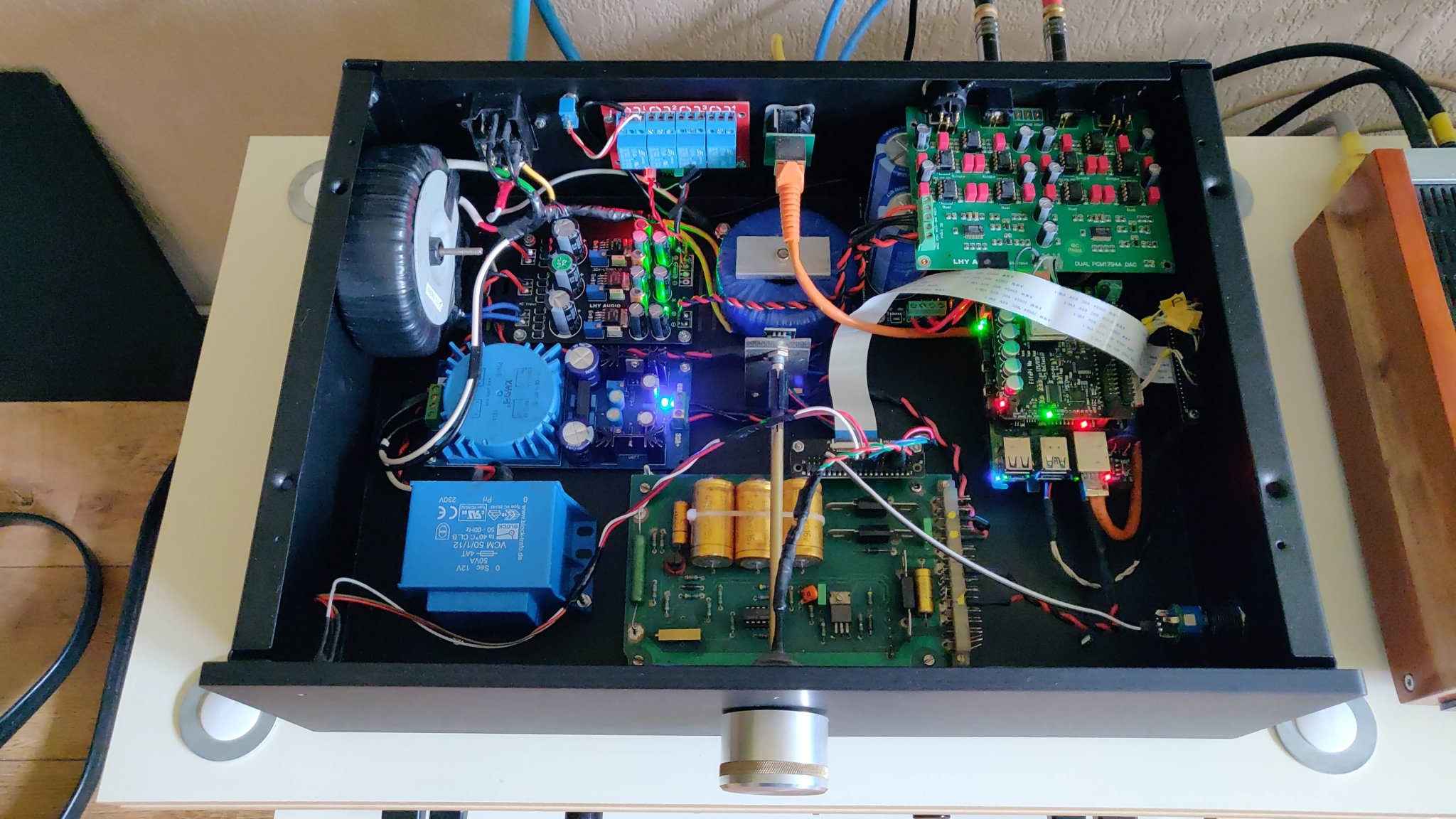

and finished.
used electronics:
ian canada FifiPiMa 1.5 reclocker (ACCUSILICON 45 mhz and 49 mhz) isolator ii, UcConditioner ultra capacitor 3.3 v, PUREPI Ultracapacitor / Batteries Dual Power Supply Module for Raspberry Pi 5V / 3.3V, Ian Canada GPIO extension kit for Raspberry Pi .
dac: Balanced DAC Board 2x PCM1794A I2S 24bit 192kHz.
further infrared, a rotary encoder, safe power off button raspberry pi.
maybe in the future get a UcConditioner ultra capacitor 5 v.

In my D11 Dac build at 6:05 I posted a schematic of the power supply that uses 3 large transformers and I used a simple snubber circuit with one resistor and one capacitor to keep the big relay safe from inrush current . The video also shows the entire build with triggers in and, timers and on off circuitActually even I am learning. I hope some more knowledgeable person can shed some light to it. @Gabster 2000 maybe you did something for the toroidal inrush current?
It is a complete elaborate power supply for 5 Ucpure and 1 linear pi
Hope that helps you @NeoTheOne and others

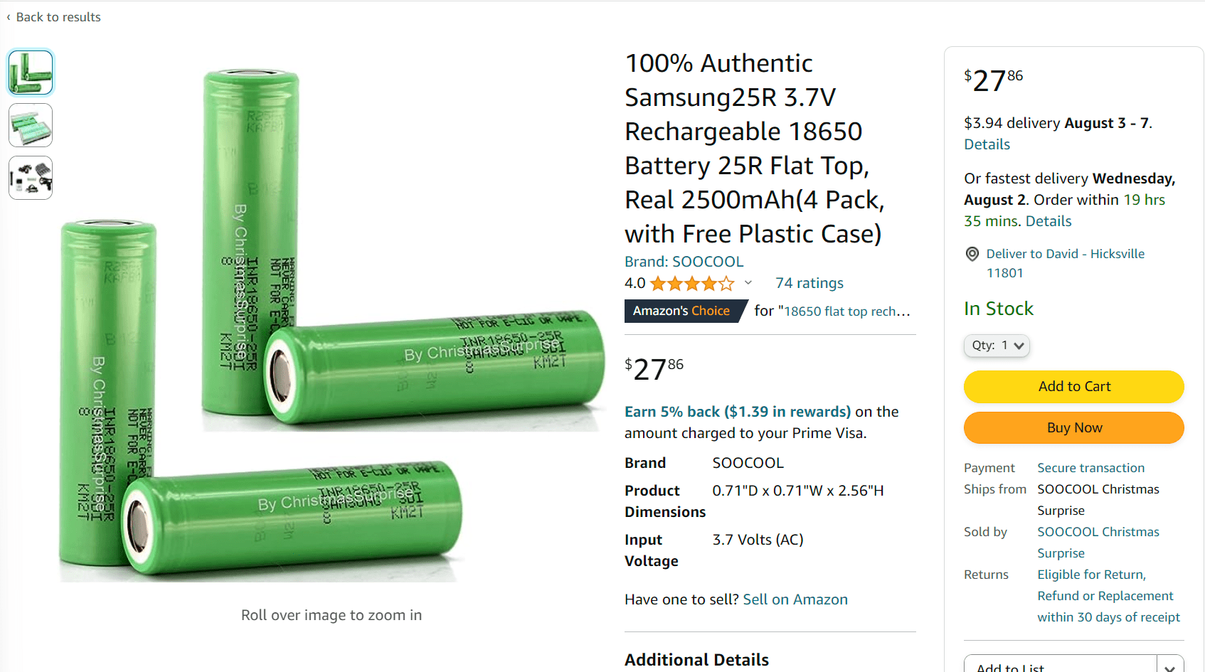

There is no 3.7v LiFePO4 batteries... so nobody uses 3.7v batteries in Ian's battery power supplies... Only LiFepo4....
So these are 3.2v even though it's labeled as 3.7v? This is just one example. if I search 3.2 LiFePO4, not many options available at all. Maybe a supply problem or other issues we don't know about.
I bought my batteries at
https://www.audiophonics.fr/en/batt...lifepo4-32v-1500mah-rechargeable-p-16678.html
I don't recommend anything from Amazon since it's compromised, especially batteries. I exclusively use 26650, but did some small 18650 projects in the past.

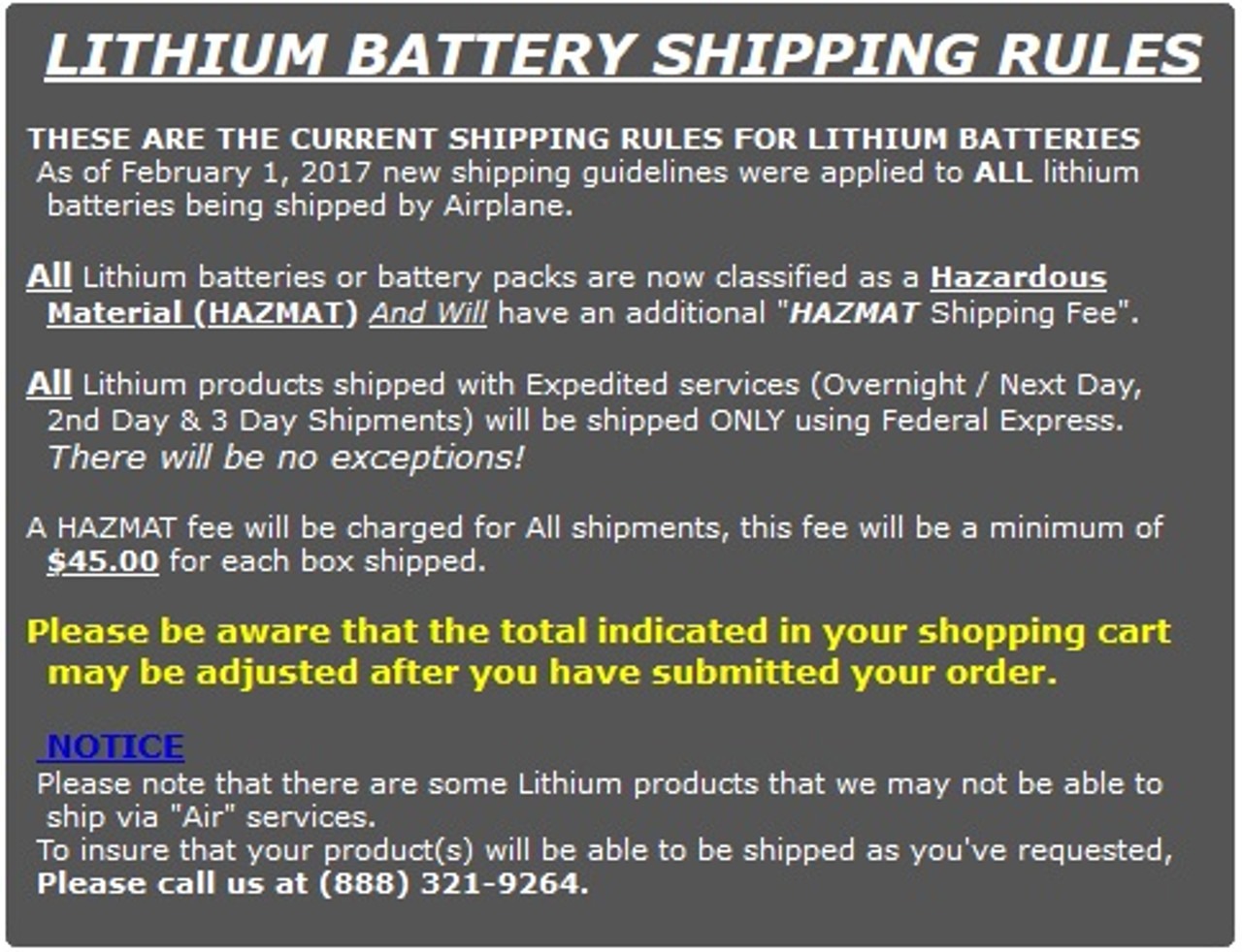

For QTY < 10, they wrap each individual LiFePO4 in their own sealed plastic. This is handy for International flights. I don't think I can travel with Ultra Capacitors.
But I don't know if their shipping policy has changed. They usually handle orders in the thousands, so I don't know if this applies to small orders:
