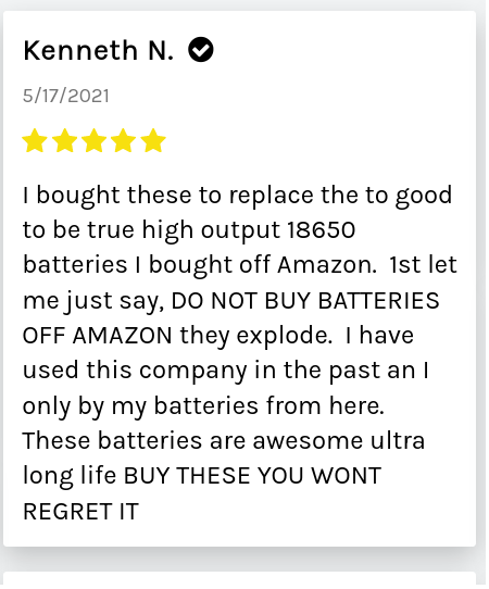

I noticed this review on the second link of my previous post:

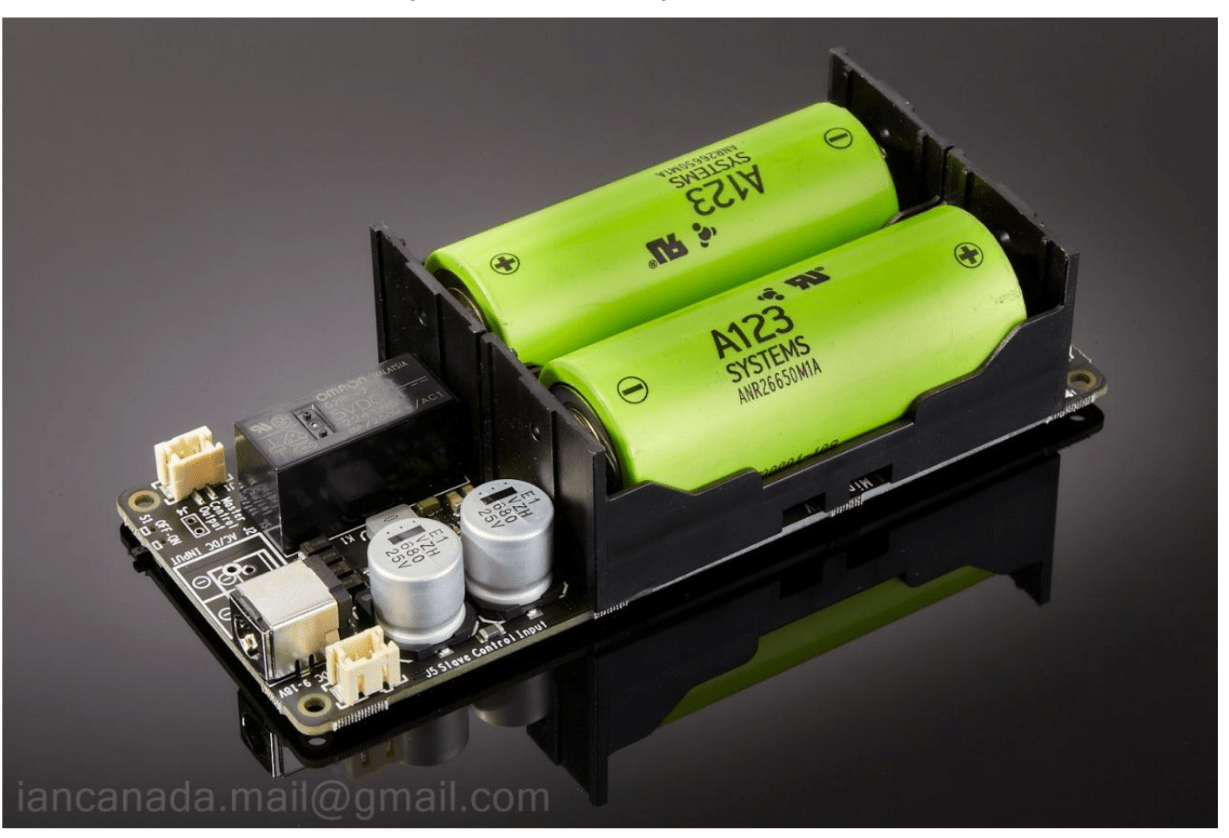

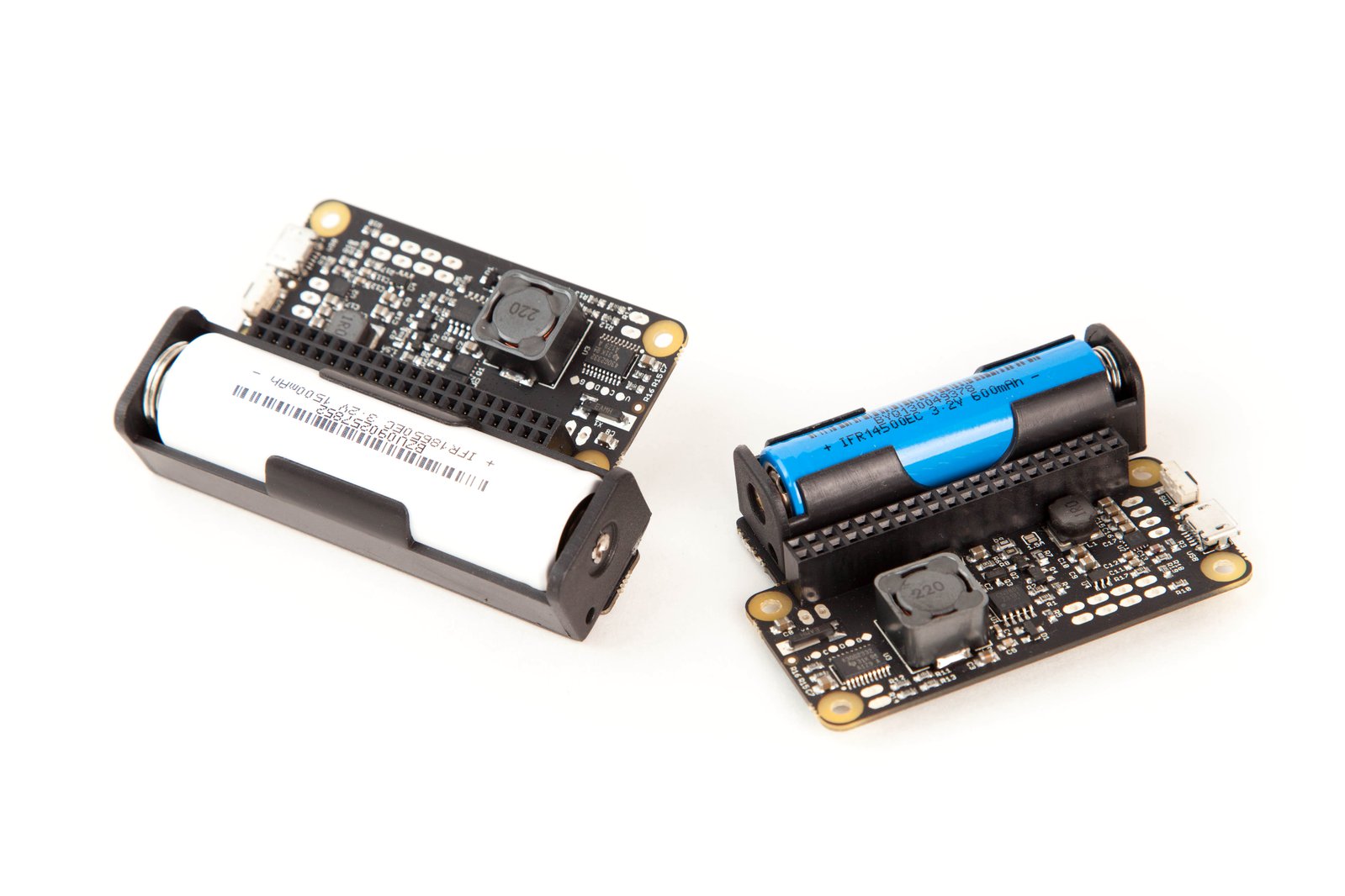

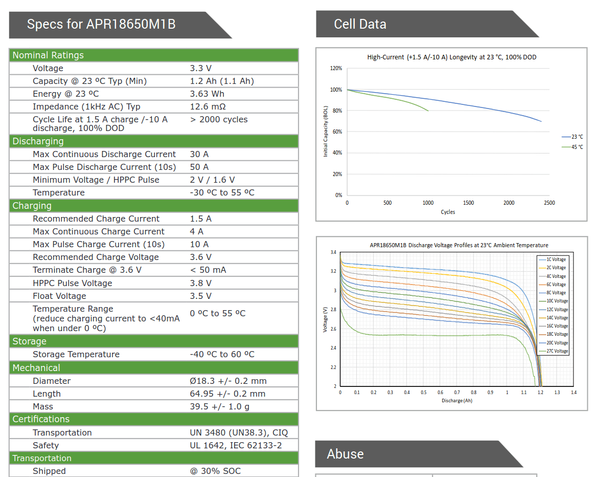

After looking at the PurePi manual, I do wish Ian set a reference standard on the 18650. 26650 reference standard is pretty much A123/Lithiumwerks brand. For those whom don't know, Lithiumwerks was re-branded as they were formally known as A123.
So I was surprised not to see Lithiumwerks/A123 18650, just a generic 3.2V LiFePO4 18650, in the PurePi Manual.
The Lithiumwerks 18650 should work the same. There's 3.3V all throughout the PurePi Manual, so I'm not sure if the Lithiumwerks 18650 was used in the original prototype. Only mentions of 3.2V are directly concerning the battery.
3.3V isolated pure LifePO4 battery power supply with battery holders pre-installed for two 18650 battery
cells. ESR less than 6 mOhm. The ultra low output noise would be only decided by the battery cells.
I believe the Lithiumwerks is 12 mOhm, but I don't think that's a big deal or dealbreaker. There may even be a math formula that needs to be applied like divide by 2 batteries when 18650 used in a Series. So 12 mOhm / 2 = 6 mOhm? Again, I think it's completely irrelevant and I wouldn't trust generic 18650 impedance specs / data as an alternative option.
For example, I used this LiFePO4 BMS with my Ian Stack:
The BMS included generic 3.2V 18650 and I immediately replaced with Lithiumwerks 18650 3.3V for quality purposes. Never had a issue. Seamless.
So with the state of generic low quality 18650 options and past seamless synergy of Ian's power supplies with the Lithiumwerks / A123 brand, I don't think you will have any issues with the Lithiumwerks 18650.

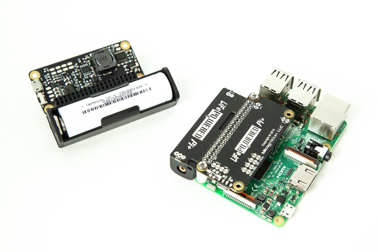

I recommend looking at the Github code for my LiFePO4 BMS, the software works pretty well. I have not have time with your new power supplies yet, so I don't know how well they shutdown via Software, etc. It works on Archlinux realtime low latency kernels too with the right libraries so compat with various Linux variants.
https://github.com/xorbit/LiFePO4wered-Pi

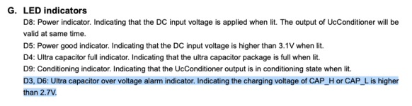

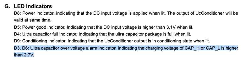

i wonder why this is.
as soon as I switch on the streamer (after half an hour of no voltage) the overvoltage led on D6 of cap L of the UcConditioner MkII 3.3V lights up.
this is no more than a quarter of an hour, then it slowly goes out.
should I be concerned? because this doesn't seem quite right.

Overvoltage is overvoltage AND if i am correct ucconditioner and purepi both will have identical voltages because they just " copy " the voltage offered at their input.
But one feature of ucconditioner is balancing the caps so if voltage is to high it should be to high at both caps because both caps should have identical voltages.

I think your charging voltage is to low.
I had the same for my 5 volt ucpure MkIII.
I charged with 6 volt and only 1 eaton supercapacitor measure 3 volt.
Later I use the 12 volt toroid and this works before I make the supercapacitor empty.
Now I use the 6 volt toroid for the 3.2 volt and this works because they are spare parts lying around.

Measured this morning at startup. input PurePi 5.07 volts, input UC 3.27, output UC 3.27. in that respect everything is okay. I will see for a while whether that capacitor in question stops or cheerfully continues.
Hello,
Each cap has its own overvoltage indicator. If the balancing circuit would function properly both caps should have an identical voltage
If i remember correctly it is written in the manual best to start with both caps fully drained before starting the first charging process
Of course if your caps are Chinese knock offs it could be a reason for things not working properly.
I remember at work once in a month we had to use a special charging procedure for our BIG batteries mounted in series to give each one an equal charge/ voltage.
I would not switch it on until you found the culprit.
Greetings Eduard

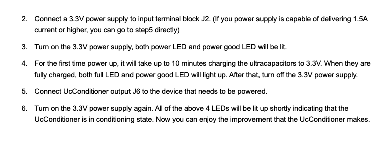

there is nothing else in the manual about both caps fully drained before starting the first charging process.
i just did this one (screenshot)
how can i best get the caps fully drained, then i do the process again.
by the way the UC does go into conditioning state and all leds for that are on.
I have these caps by the way.
