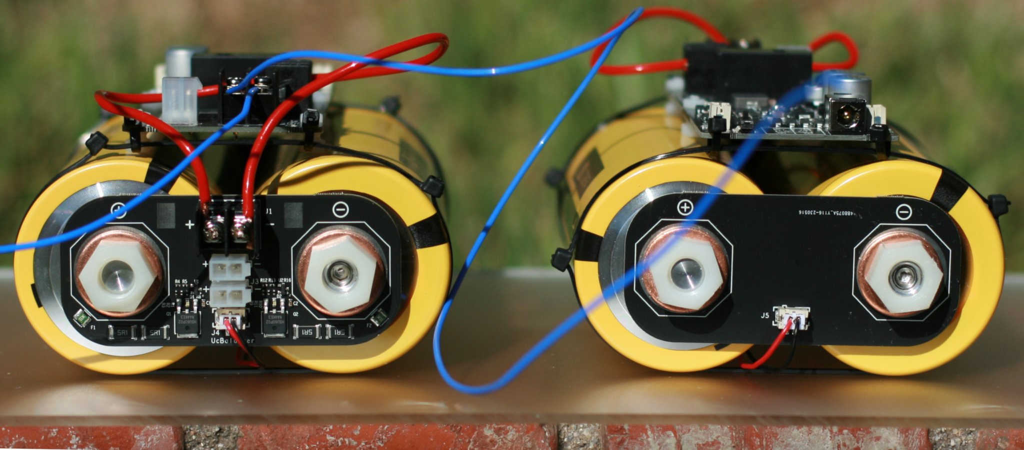

tried a different power supply, same problem, caps are drained.Before you start the caps fully drained, measure the caps first.
Otherwise you (can) make the same fault with the low voltage.
First make sure what is the problem what you have now.
Rudy
What I also don't understand is that the overvoltage LED just stays on for another 10 minutes if there is no voltage on the input.
will measure the voltage separately from the caps on saturday.
i did a quick measurement, cap H is 0.524 volts cap L is 2.669 volts.
so cap H is not charged and cap L (over voltage) is normal.
so there is an imbalance.
I will unload them both and then do the first start procedure again.

Something is very wrong there. Please share pictures showing all your wiring and PSU/Transformer user for charging. I have a few UcPures here with no issues so will try to help you. To fully discharge the caps I use an 8ohm 100 watt resistor connected to the always on UcPure output J10i did a quick measurement, cap H is 0.524 volts cap L is 2.669 volts.

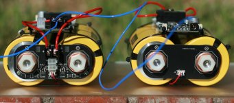

Hello,,
The problem is happening with an ucconditioner.
But just like an ucpure there are two caps iin series and both boards contain some circuitry to keep the caps at equal voltage and to keep things working safely.
Today i showed the datasheet of the 3000F . He told me to wear safety glasses and no jewelry during handling. These old mechanics/electricians always have impressive stories about batterie accidents..
These 3000F caps are not like a popping to low grade cap on a pc motherboard
So better wait untill the problem is fully investigated
Greetings Eduard

I have flashbacks of Ian mentioning decent powered soldering iron and double-cooper anytime UcConditioner is mentioned.
Could be Mr. Obvious here, but that's how far I would backtrack. I believe I upgraded the soldering iron for UC boards back in the day due to double-thick cooper boards. So I would double-check the soldering on the UC that's not filling up.
I think draining only applies to UcPure, not UcConditioner, but I never had to troubleshoot the UcConditioner. I believe Ian recently mentioned draining shortly before UcBalancer was available when unbalanced Ultra Caps was a thing.
Double thickness 2oz PCB copper layers especially designed for high current and ultra-low ESR
applications.
Please make sure using solder iron with 80W or higher power for durable connections of this high current
conditioner board.

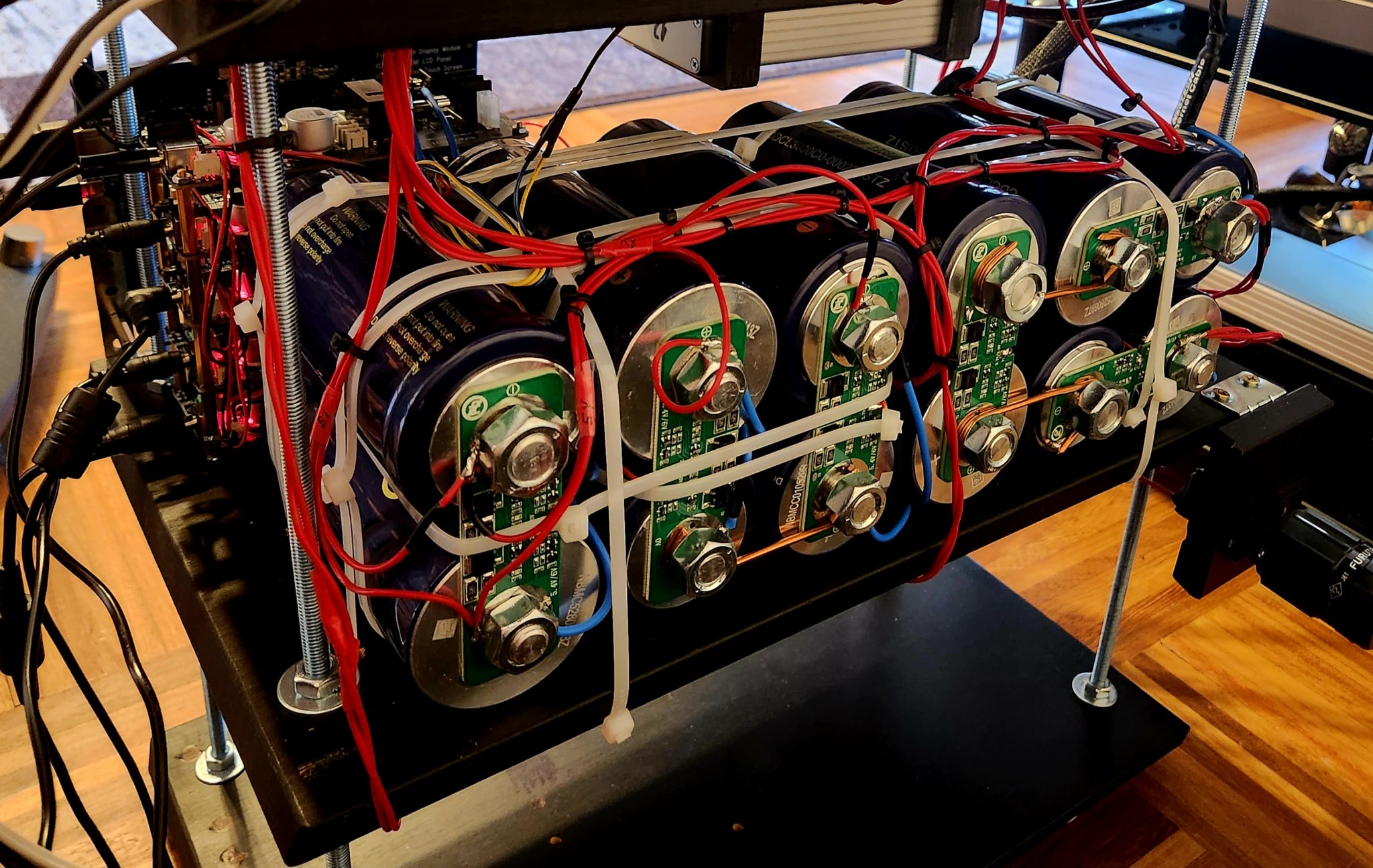

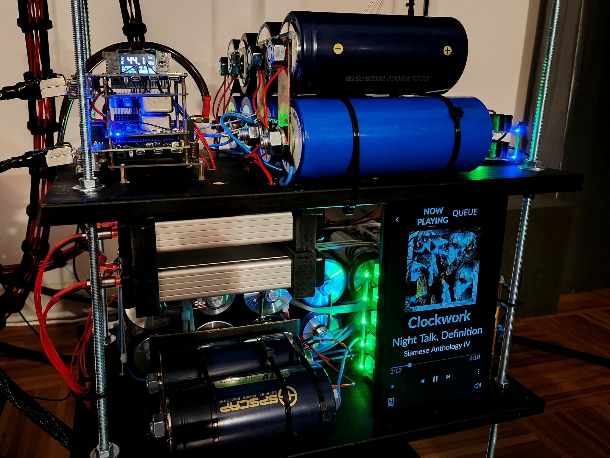

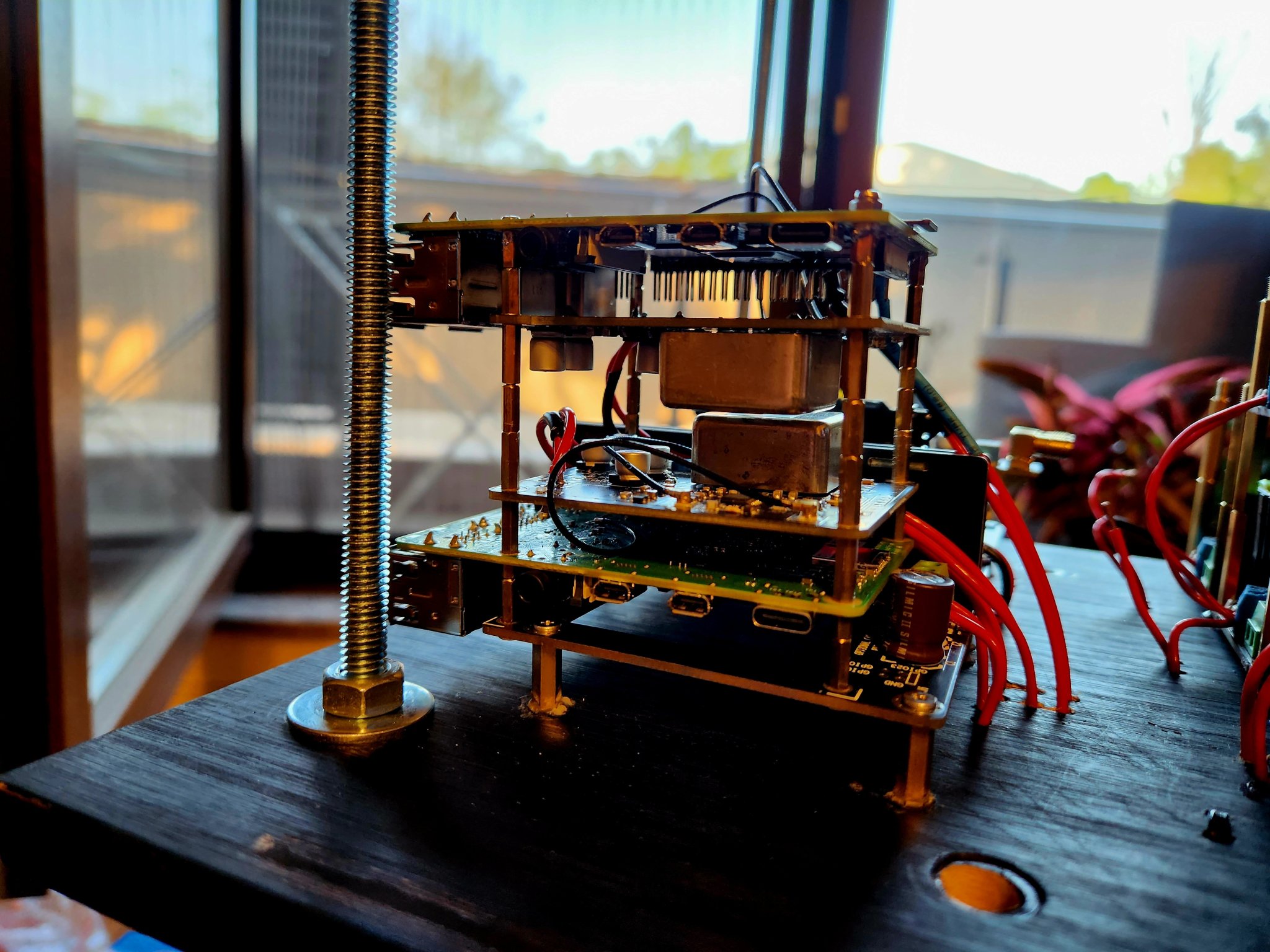

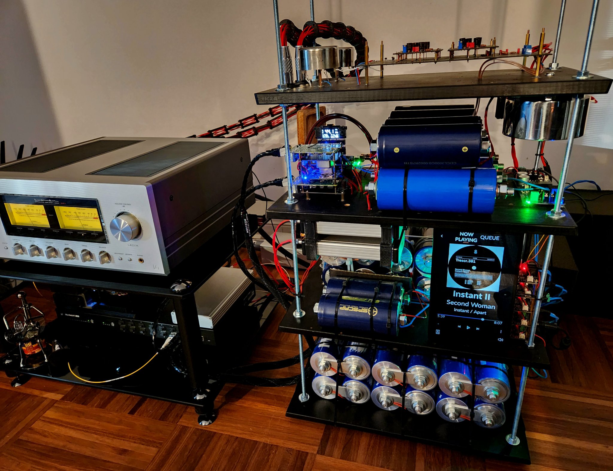

Hello guys!
Just wanted to share my build using Ian's toys, but not only. Started doing it almost two years ago..
On a StationPi I have put 2 x RPIs, FifoPI Q7, SinePi. Plus a custom PCM1794A DAC.
Now let's break it down😀:
RPI:
I'm using 2 x RPI 4 running symphonic-mpd software in AoE config. Both RPIs have upgraded clocks on them. Power for RPIs is supplied by AMB Sigma 11 5v + 2 x 2.7v ultracaps for filtering. Power for RPI clocks is supplied by 4 x LTO 2.8v batteries in 2S-2P config + 2 x 2.7v ultracaps for filtering.
FifoPI Q7:
3.3v/5v is supplied by UcPures 3.3v/5v
SinePi:
clocks are Andrea Mori's TWTMC-DRIXO 11/12mhz. Power for clocks is supplied by UcPure 15v.
custom DAC:
PCM1794A based DAC running in NOS mode with passive I/V stage using Ivan Byiak's D60 transformers and balanced output. Currently using 2 chips per channel. DAC requires 3 different voltage rails, 3.3v/5v/8v. All of them are supplied by UcPures.
Everything is put together on Ikea bamboo chopping boards. Neotech UP-OCC wire used all around. Samsung tablet as screen. Sounds wonderful since a while back.👍
Next steps would be to finish DAC part as it's in testing phase at the moment, final version should have 10 dac chips per channel. And maybe try an active I/V stage. What about a case for the whole thing?🤔
Technical advices from my friend Toby, Ivan Biyak, IanCanada and Doede helped a lot! Similarities were obvious, DAC part is inpired by the DDDAC.🤓
Designing pcbs for DAC would not have been possible without my buddy, Vlad.☕

thanks for the tip.I have flashbacks of Ian mentioning decent powered soldering iron and double-cooper anytime UcConditioner is mentioned.
I immediately inspected the soldering points off the caps and as it turned out, one of them was not properly soldered despite the fact that it seemed that it was firmly attached.
I also bought an extra 80 watt soldering iron for this.
all soldering points went through again and hoppa it works well again.
thanks again🙂👍

it's not that I didn't have the right soldering iron, but a soldering tip didn't flow properly ...... was my own fault. but it works again.Hello,
