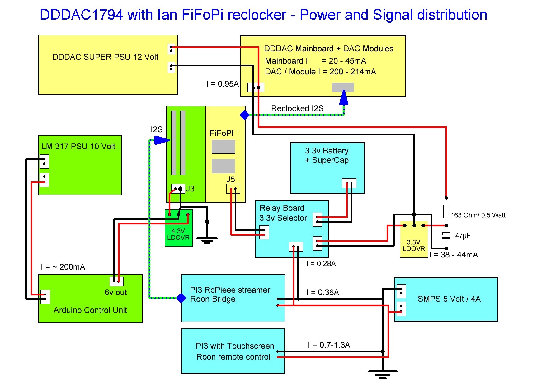

.....not sure why the 5v/3.3v is so in question guys. Everything (at least to me) is clear in the manuals Ian provides. I highly recommend all manuals are read in detail a few times before you even start your build, all manuals are online in 1 simple place too 🙂
https://github.com/iancanada/DocumentDownload
So, still something like a list containing the following information would be nice:
In post #9,031SimonJ shows a piece of the documentation on which possibilities exists for feeding 5V with a StationPi board. Additionally if we are lucky we stumble across the following in the FifoPiQ7 manual on page 8, chapter "F", J3: "(Optional) 5V RaspberryPi DC power input". This indicates for me input power related to the RPI, but it states in the end:
"FifoPi Q7 has much powerful FIFO engine, so it’s need 5V power supply for J3. FifoPi Q7 will not work if you feed 3.3V to J3."
So, FifoPiQ7 seems to require also 5V.
Drive Shaft posted this in post #9,037. Thank you!
- Module name with its average power consumption (to decide if we want to power it off supercaps or shunt regs)
- Module name and if it needs 3,3V and/or 5V
"FifoPi Q7 has much powerful FIFO engine, so it’s need 5V power supply for J3. FifoPi Q7 will not work if you feed 3.3V to J3." So, FifoPiQ7 seems to require also 5V."
......FIFOPI Q7 needs both 5v and 3.3v to operate - 5v to J3 & 3.3v to J5. Now what might be confusing people is when they are using a StationPi the 5v needed to power the FIFOPI comes from the StationPi 5v connector.....just my thoughts. At the end of the day FIFOPI Q7 needs both 5v and 3.3v to operate and the 5v can come from different places.
Hope that helps....

What really would help is a spreadsheet /list with each module, its needed voltage and average current consumption. If a module can get the input from another one, or if it can deliver it to another, and if it needs a separate power supply, should be listed, too.
As there are so many possibilities (most of them very clear and logic), having all the documentation at once laying on the table is a bit of lucky guesswork.
A document has the use to describe each function detailed, but the interaction of different modules needs to have a different document.
For starters a overview document naming each module, the pros and cons of each module and a ranking in its group (e.g. reclocker), and examples of streamers and DACs (cheap/ price+performance/ high end) like we can find in different places would be very helpful.
I can remember very well being overwhelmed of the enormous sum of modules and their for me confusing names...

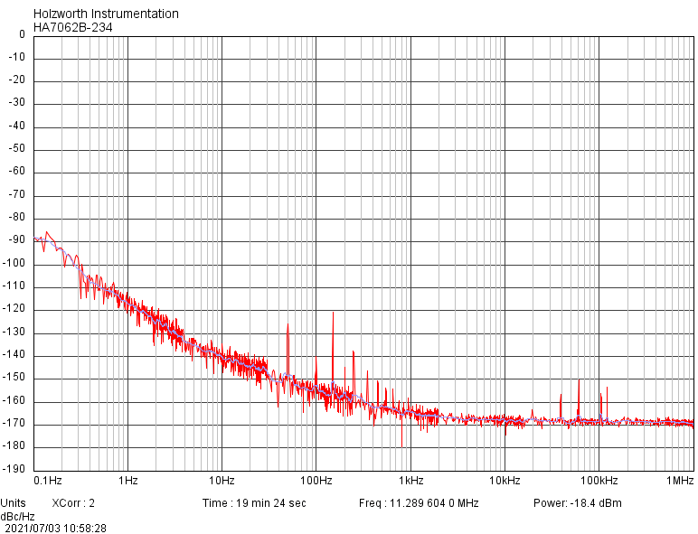

Hey Mark,Have a phase noise plot for an Acko Labs clock at the same frequency, if that helps:
They are physically not very big:
Magic Xtal from Russia 🙂 🙁
https://magicxtal.com/products/?S=20&C=36&I=570
They used to be relatively inexpensive at qtys >=10. SC-cut, same as Pulsar.
PS - You can add your own fancy ULN power supply but if you split the can open there will usually be revealed an internal PS that's maybe not quite 'DIYA qualified' ULN.
