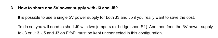

On the fifopi q7 board there is the 5volt connection is this also a clean power connection for the fifopi q7 ?? (if the answer is yes then read further)
Now I don't use this j3 connection on the fifopi q7 because I use the 2 jumpers on j9 stationPi pro mk2.
Is it possible to connect a clean 5volt power supply to j3 on fifopi q7 and REMOVE the 2 jumpers from the Stationpi Pro mk2?
After that, connect also a separate 5volt power supply to the raspberry.
Then there are 3 possibilities 2 connections on the StationPI Pro mk2 j3 and j13 (usb-c) or the raspberry also usb-c.
Please let me know if this is possible and more important is, is this useful to do to make beter sound.

Please read the manual - https://github.com/iancanada/Docume.../StationPiPro/StationPiProUsersManualV1.1.pdf
You can connect separate 5v PSUs as you will see in the manual

So what I do is power the Pi with its own 5v PSU, I power the Ian stack of PCBs with another dedicated PSU so they are isolated. I did this as I had the 2 x PSUs so why not to isolate them like this.
I made sure I use the best PSUs I could as well.
Hope that helps
Hope that helps

Hey @Murdoc I use the StaionPi SMT but the PSU concept is the same. In the manual it states.....
..... so the opposite of this is to remove the J9 jumpers and then connect 1 x 5v to J3 which powers the Pi and another 5v PSU to J5 which powers the Ian stack. This delivers all the 5v power to all the right boards. I then apply the 3.3v PSU directly where needed to Ians PCBs.
Does this make sense?
This doesn't matter witch connection I use they all isolated from the fifopi q7 board if we remove the 2 j9 jumpers.
I ask this because I will use the usb-c cable from my allo shanti power supply to the raspberry.

...again this is in the manual, are you reading is carefully? 😉 So you can connect to either the J3 or the J13 and with the J9 jumpers removed all is isolated and good.
