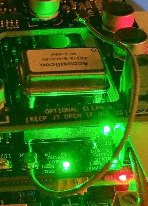

Hello,
I removed the 2 clocks from a Fifopi Q7 and put an Accusilicon AS318-B-903168 clock instead (without the OE pin).
When I try to play a 44.1 kHz PCM file, there is no sound.
I am attaching a photo of the leds.
Any idea ?
