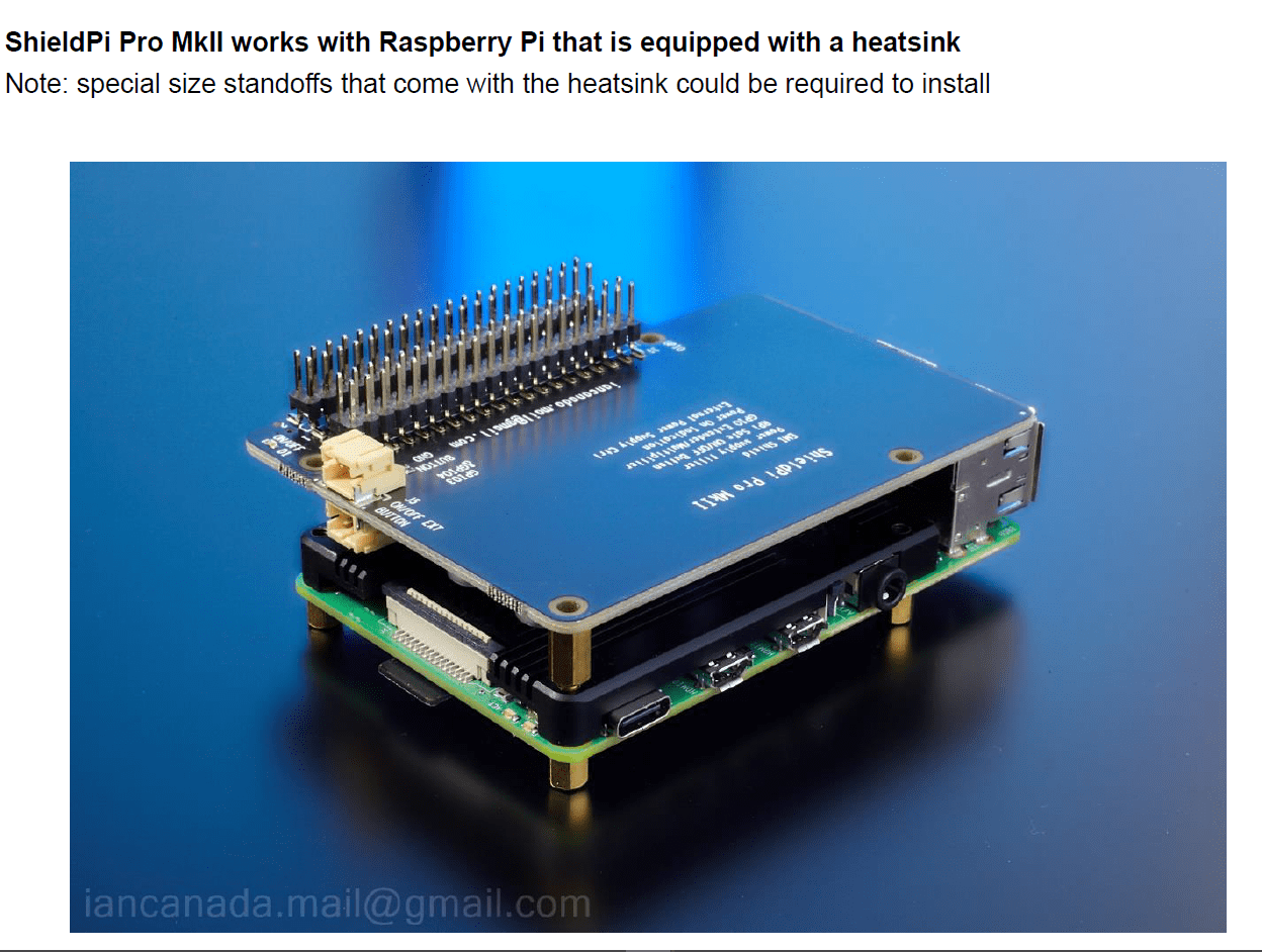

I don’t seem to find a RPI heatsink that works with ShieldPI Pro, there is not enough room in between, can you help with a link to a heatsink?What if you use the Isolator II from Ian Canada? It galvanically separates the GPIO of the RPI 4 from the rest of the stack. And separate power supplies of course.

@Lso
I mean #23C ShieldPi Pro MkII, sorry for the confusing.
https://github.com/iancanada/DocumentDownload/blob/master/Adapters/ShieldPiPro/ShieldPiProManual.pdf
ShieldPi Pro MkII has a high profile GPIO design, that makes it working with heatsink.
You can use RPi4 heatsink like this
https://www.amazon.ca/Geekworm-Raspberry-Compatible-Expansion-Extension/dp/B08N5VZN8R/ref=sr_1_2?crid=3519W4DW29G2Q&keywords=geekworm+heatsink&qid=1683635770&sprefix=geekworm+heatsink,aps,83&sr=8-2
