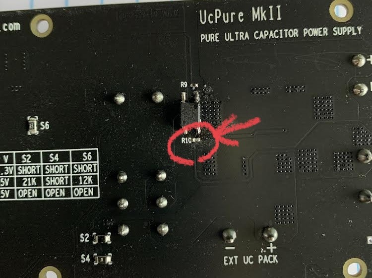

Not sure if this is best place to post this, my apologies if this is needs to be posted elsewhere. Got myself a 5v UCPure mk2 from IanCanada but found the R10 resistor missing, likely my moving boards around too often while trying different configuration on the box. does anyone knows what is the resistor value this R10 should be? It doesn’t seems to affect anything but just in case if it blows up the capacitor 😳.

Please no worries. It's a 1M ohms chip resistor in 0402 package. With it, the turn off time will be faster. However, you can leave it un-assembled if the turn-off time is not a problem for you.

Thanks Ian, much appreciated for your prompt response 😁👍@TigerMax
