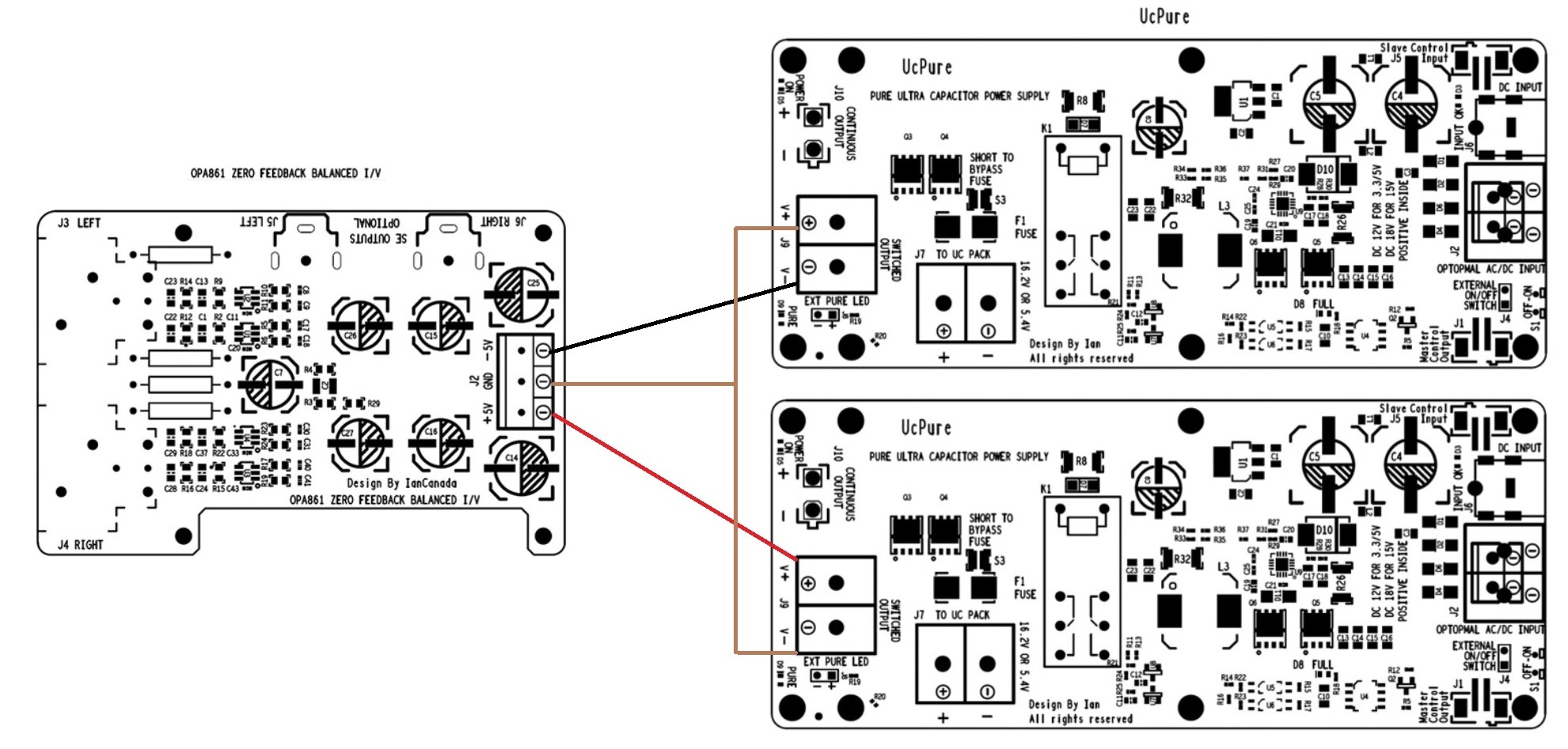

The OPA861 needs +5 v and - 5 V. Can I connect the 0 V from one UCPURE to the +5 V of another UCPURE to create a + and - 5 V?

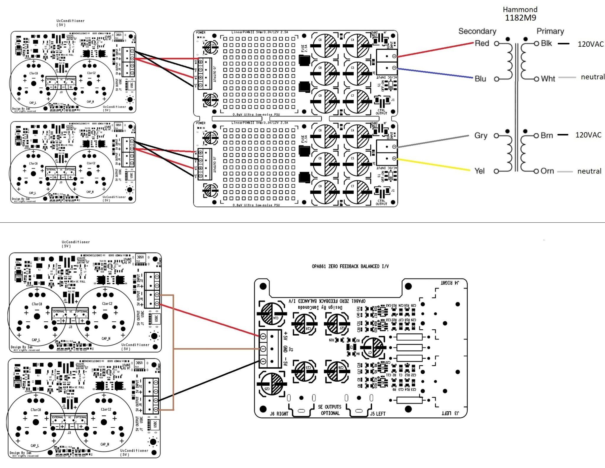

@Panamarenko The way I powered my setup. I also installed 3.15A time delay fuses in the LinearPiMkII's because the stock fuses blew.
So your setup should similar

@Panamarenko I created the drawings referencing Gabster's video and adapted them to my setup and cleared it with Ian. I'm interested in the UcPure + Ultra Capacitor PS performance but I've heard a similar capacitor explode (Not sure what caused this) before and don't want that in my living room. Maybe if I installed caps in the garage and ran a two-foot cable trough the wall into my living room. I not completely sold yet. PM me if you or anyone else has a cap go off(explosion), I'd like to know. I'd probably calculate caps end of life and replace it way before then, that and keep my whole house surge suppressor up to date.
