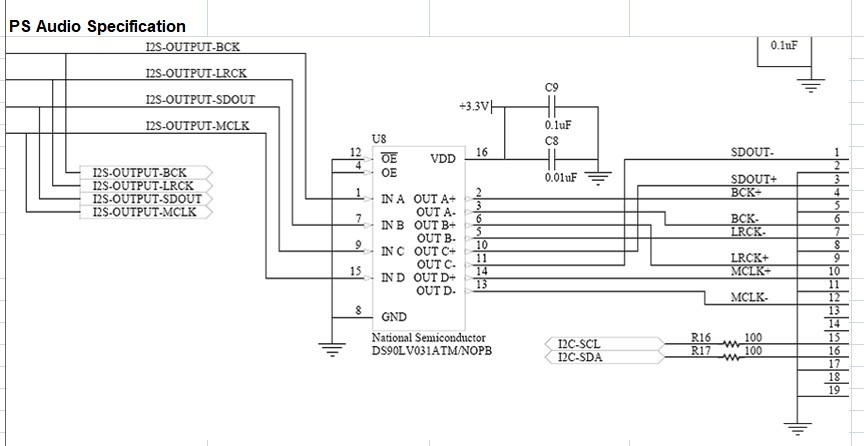

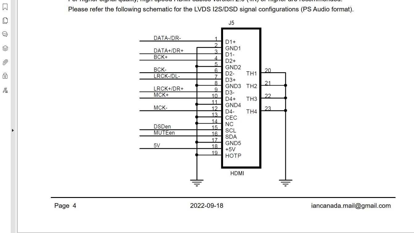

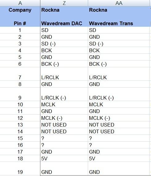

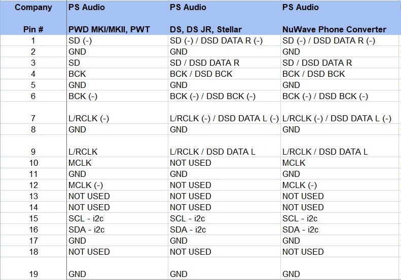

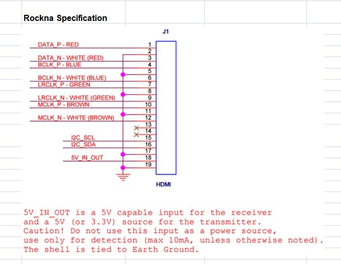

I have some questions about i2s format across the different versions of the HDMI Transmitter.
I started with HDMI Transmitter MK1 and I was using PS Audio format on my DAC (a Rockna Wavedream supporting 2 formats: PS Audio and Rockna which can be changed in the software menu - I also use a Viablue HDMI cable which I do not think reverses any pin).
I moved to HDMI Transmitter MK2 and I noticed I have the L/R reversed so I have changed to Rockna format and did not give it much thought.
Now my las move was upgrading to HDMI PRO on which also Rockna format works with correct L/R. Noticed that another user on this forum made detailed tests and found out that also phase issues may occur using the wrong format. So I have checked the user manual for HDMI PRO where the PS Audio is specified as the format used.
So I am a bit confused. Which format is actually used with HDMI PRO? Was the format changed across models (it surely looks like as no software update was performed on the Rockna in the mean time)?
Source of the info is a document found online and done by Sonore:

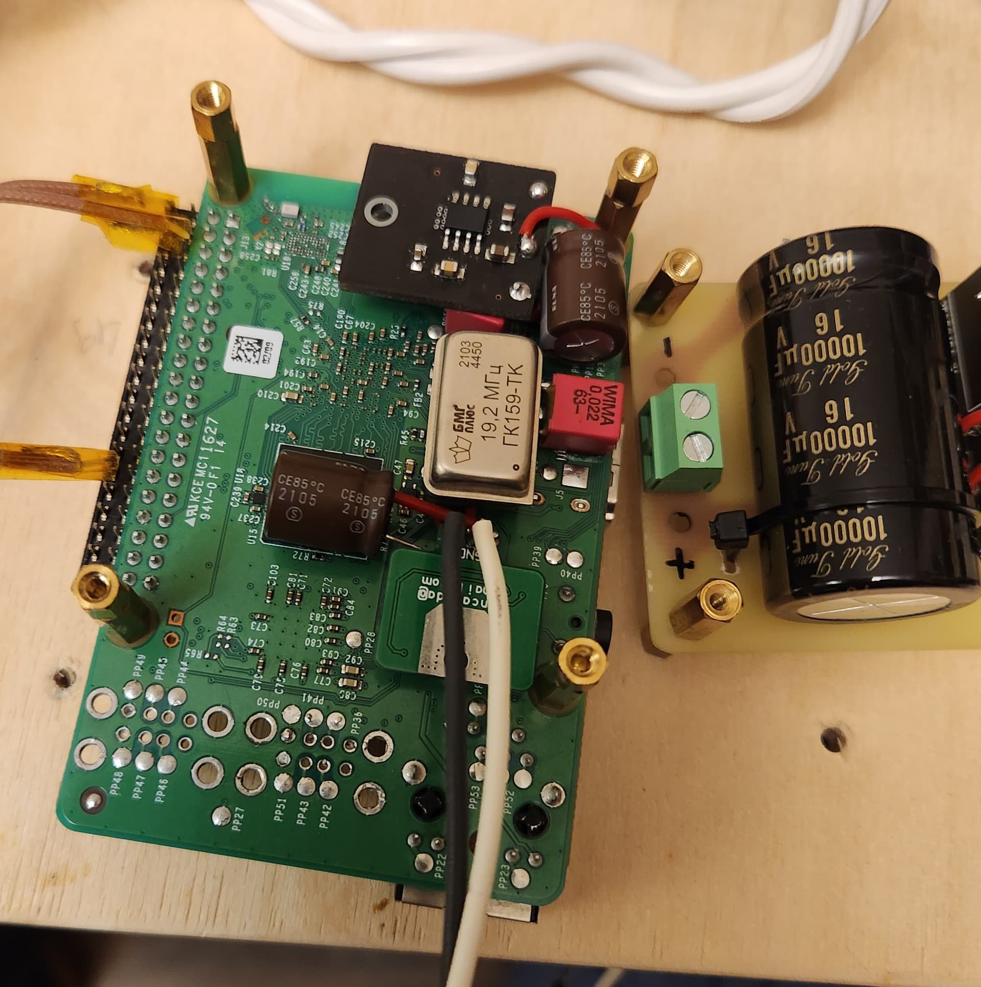

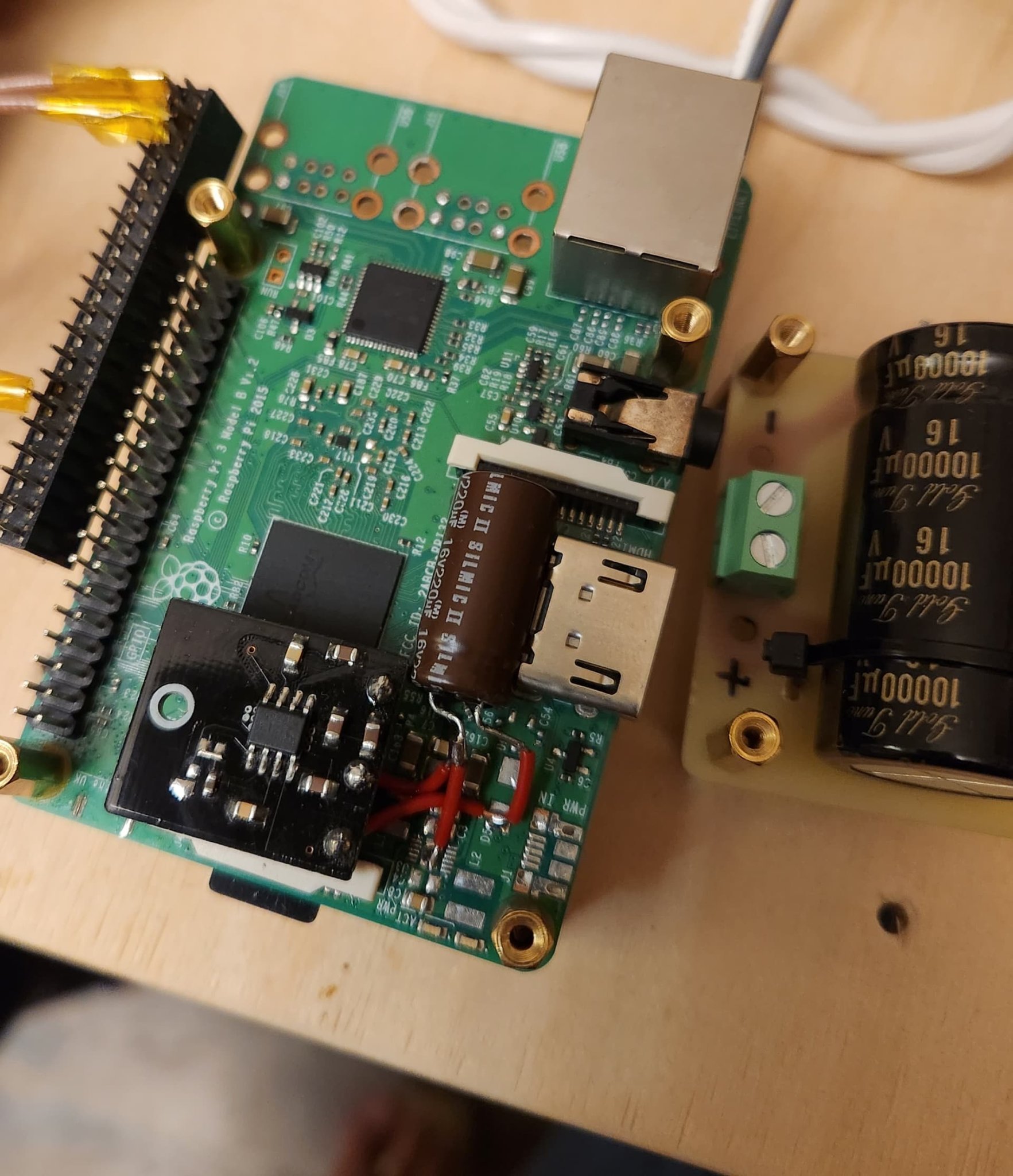

Your new Q7 is a great product, a worthy result of 10 years of work. I made a comparison by connecting to it stok RaspberryPi 3b and RaspberryPi 3b (Where I not only removed the pmic by making 1.8v 3.3v through separate linear regulator , but also removed the antenna, Wifi, Bluetooth with their clock and replaced the clock with 19.2 MHz from a separate PSU and achieved stable launch). I will attach a photo of my raspberry.

AIRAIR, I have made same as you removed that switched chip and make separate 3,3v and 1,8. Going also to replace clock 19,2mhz with Oxco.Have one question,where can you find clock bluetooth and antenna wifi. I only now about common clock for ethernet and usb on 3B.
In this case, you have a different model, I have 3b. It is the most suitable, the first in the line for 64bit, i.e. any software with good sound is supported and has only 1 quartz at 19.2I only now about common clock for ethernet and usb on 3B.
Quartz at 25 MHz is changed to XO and switches before raspberries, it makes no sense to add one more.
In 3b chip for wifi and bluetooh marking U19 and near his quartz Х2. Antenna on on the other side with the edge between the gpio and lcd socket.
Just for clarification, I have Raspberry 3B Version 1.2 and I agree most suitable.Run it with Volumio 3...... and plugin music shield,put the tasks for music on dedicated cores.You can see my buildt on post 8325,put in some pictures and information.Maby some misspelling my english or yours,25mhz shared ethernet and usb,19,2mhz for music. Clock for bluetooth?

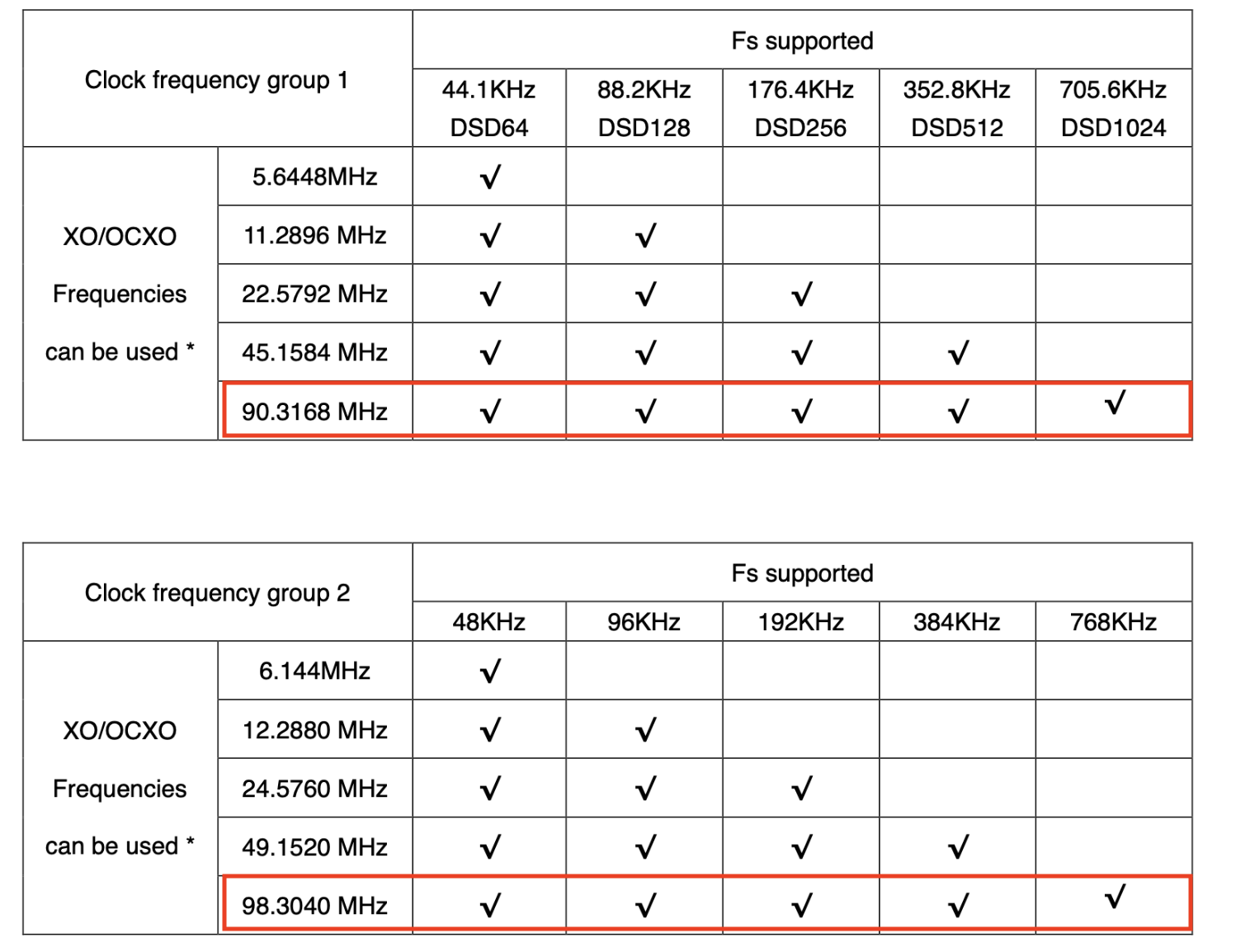

Q7 accepts 90/98Mhz clocks or just 45/49Mhz? According to doc it's a NO, max 89Mhz but I'm somewhat confused, I'm hoping there's someone with actual experience.
Thx.
