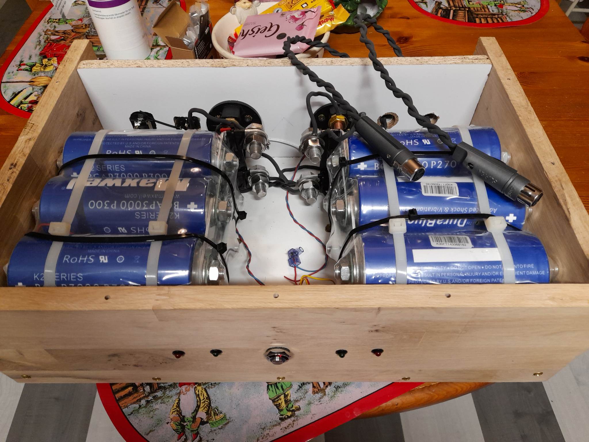

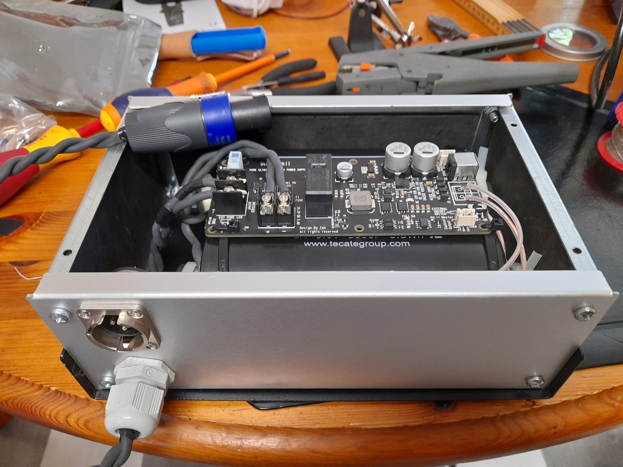

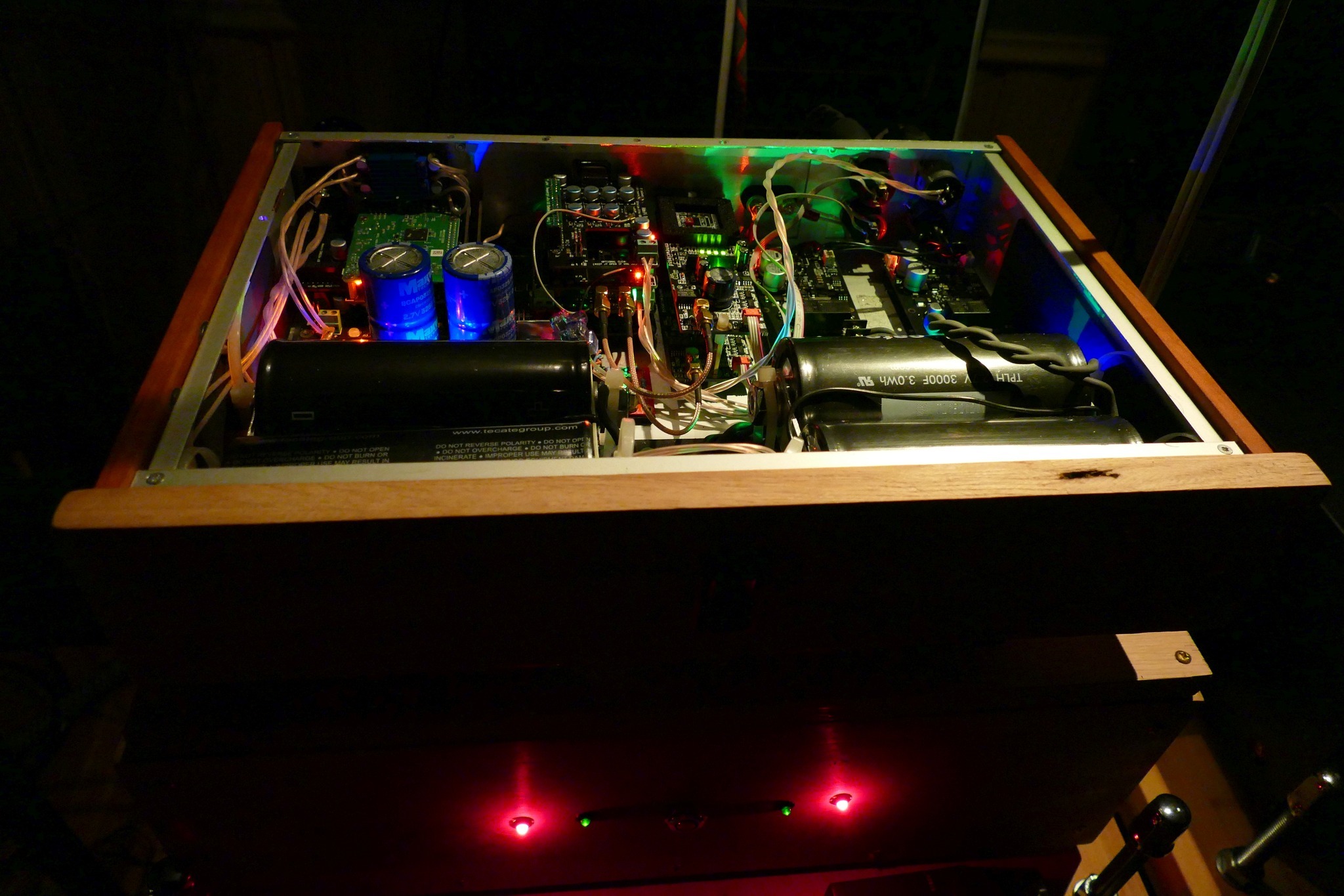

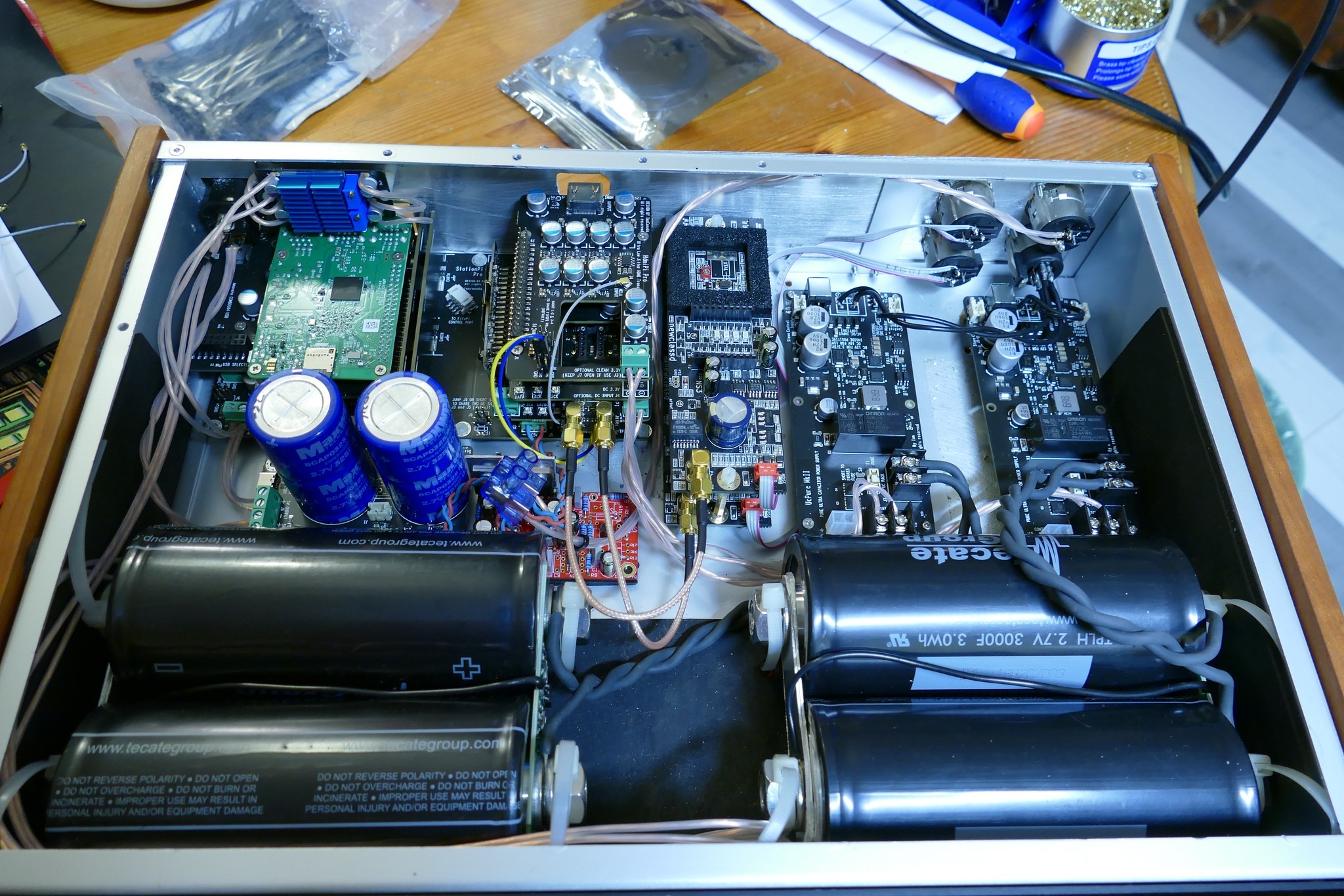

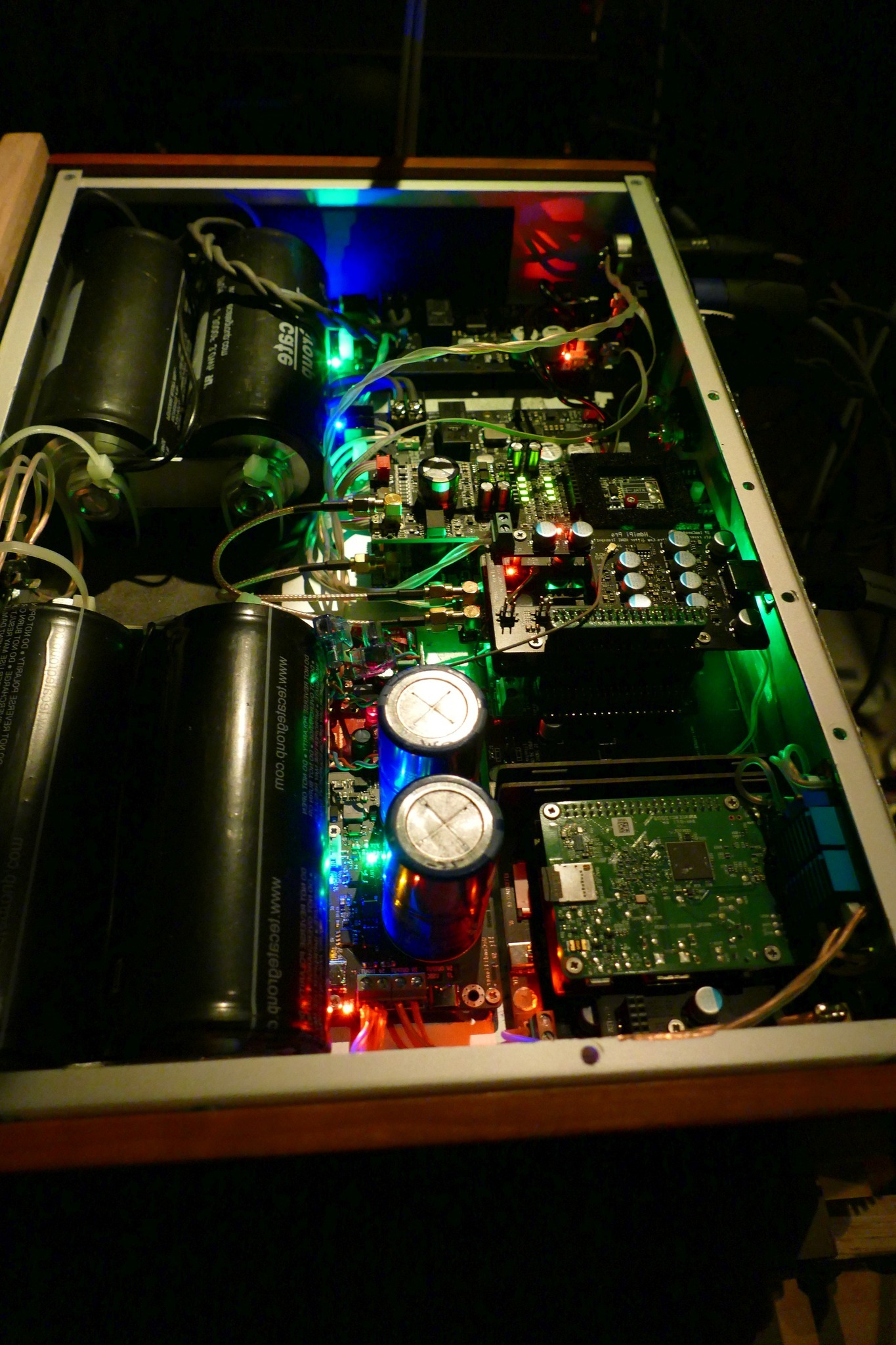

Hello,everybody have been a follower this forum long time but never posted.This is my fourth time built based on Ian Canada and Raspberry Pi.
Now i decided to go with the top of the line products.4 box solution with ultracapasitors feeding as power supplys,only raspberry pi have very high quality class A power supply,but to suppport have 2x325F ucconditioner board and seperate lt3045 for 1,8v and 3,3v.Go for Raspberry 3b for best sound.Use pi as a headless player streamin Tidal,Quboz and local server Synologie up to 192Khz 24bit,so go a sollution with low noise from cpu pi.Use Volumio with program music shield possible to separate task from music to dedicated cores.Have monitorpi but only for setup Q7,can hear it`s slightly degrades the sound so than settings stored in flashmemory take it away.So my system the latest boards from Ian,I must say have never had better sound enjoying very much

Now we really have everything to build a professional digit streamer even in a simple setup with two cards on an RPI.
All I wish for now is a professional DAC with a non-ESS chip (preferably new generation AKM) in dual mono setup including the XLR connectors on a single card. I don't even mind if it's a larger card. Plus a real nice feature would be to have an "internal" signal output on the card which can be connected inside intergrated amplifiers having a DAC card option.
Keeping fingers crossed.
