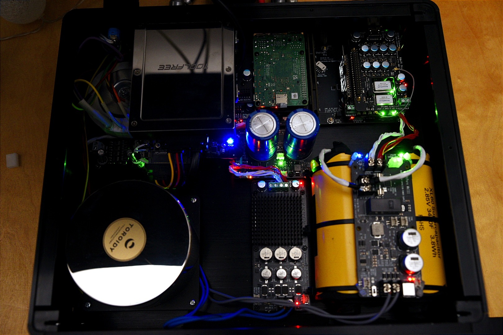

just finished this mini project! Sounds awesome still only one day of playing and sound is not yet stable, changing.
Thanks @iancanada for this opportunity!
It already sounds better than holo red.
It's plain aluminium box audio-gd style without any monitor.
Details:
Stationpi pro
Pi4 8gb
Fifopi q7
Accusilicon as318 clocks 90,98mhz
Hdmipi pro
Ucpure mkiii 3.3v
Linearpi 5v
Ucconditioner 5v
Eaton ultracaps
Toroidy.pl- supreme audio transformer
For hard drive:
Triad medical grade transformer
Ac-dc linear psu in lm317
Dc-dc linear on lt3045
Elfidelity sata power filter
Sata to usb driver with separate 12v power input
Samsung 870evo 2tb.
Viborg iec
Aucharm red fuse
Pure silver wires and silver plated mil spec wires

@bludlivijkot
Thanks for the sharing. You streamer looks very nice. Congratulations! I'll re-twitter it.
Is the any possible to add a USB DVD ROM to make it having a CD player function?
BTW, just in case you want, by using a #50A universal GPIO extension KIT, you can move the MonitorPi to the front panel.
https://github.com/iancanada/DocumentDownload
Ian
Regards,Ian
Hi @iancanada , haven't thought about cd player don't have any cd's, but i believe it could work, connecting dvd rom via usb, moode theoretically should find it as usb stick. Regarding monitor pi, i've connected it only for troubleshooting purposes. As everything works as expected, i've removed it already
