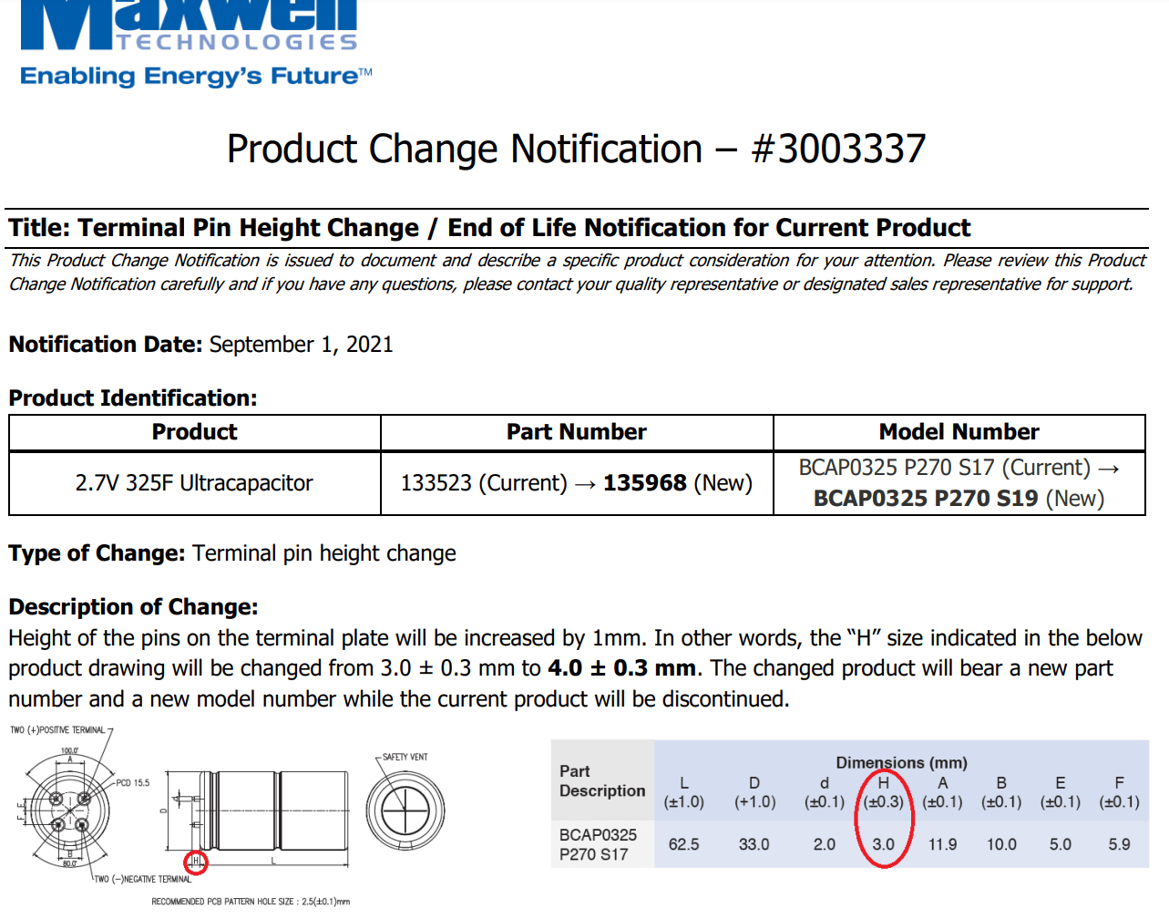

Thanks, "Notification date: Sep 2021" Typo? Yet the S19 still isn't available, that I can see.

Very interesting change. I’ve struggled with soldering all 10 caps, maybe longer pins will help? Does anyone have any tips on soldering the Maxwell caps to Ian’s board? I always have to revisit the soldering as it’s not making contact to the board properly.Seems like the new version is BCAP0325 P270 S19:
Side note: I didn’t receive that notification but was lucky enough not to install them and obtain a refund from Mouser. And them got the caps from Audiophonics a bit more expensive.
