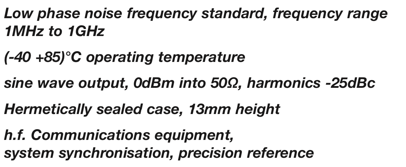

Hi Ian,
I noticed LapTech has an OCXO section. Because I moved on from MagicXtal, looking for alternatives for future use.
The OXO214 - 1000 may have worked out, but unfortunately they only have one freq and is 12V. They have under-performing 3.3V or 5V DIL, so will have to pass until they release an "optimised" version.
https://www.laptech.com/pdfs/OXO214_1000_007.pdf

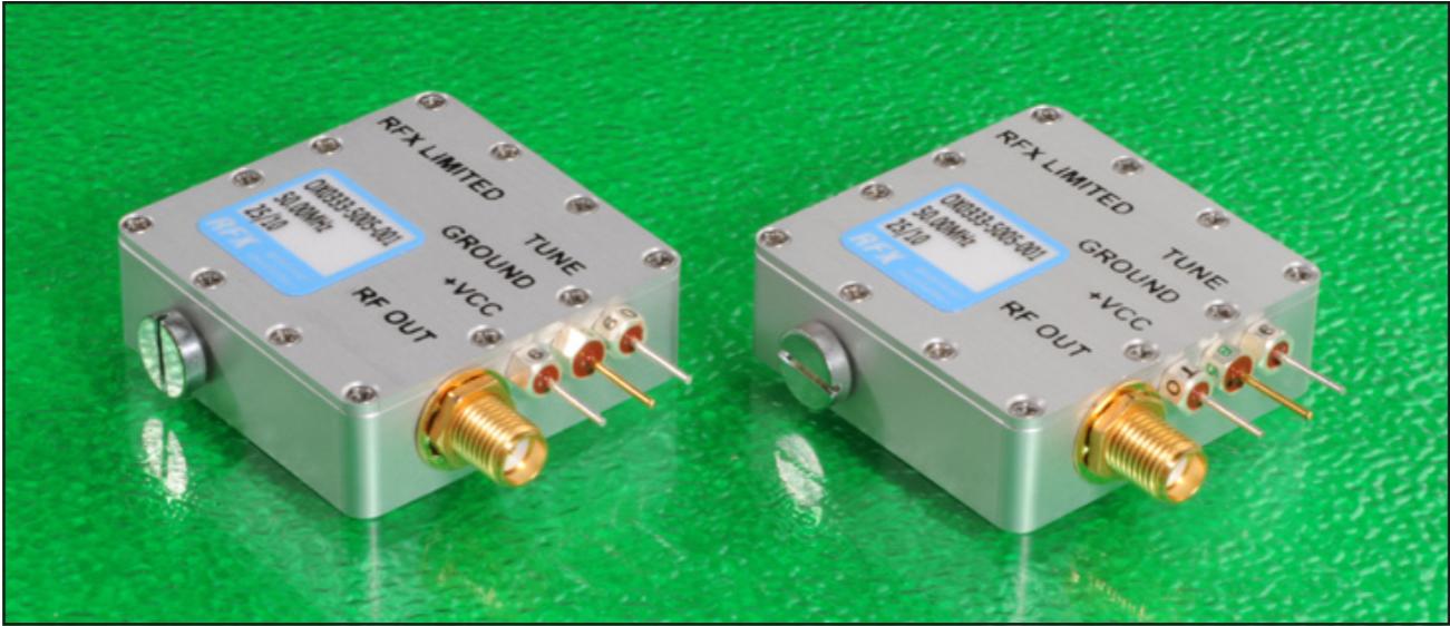

Anyways, I stumbled upon another product that may look interesting for SinePi pairing:
https://www.laptech.com/pdfs/OCXO_series_OS364-13_generic_data_sheet.pdf

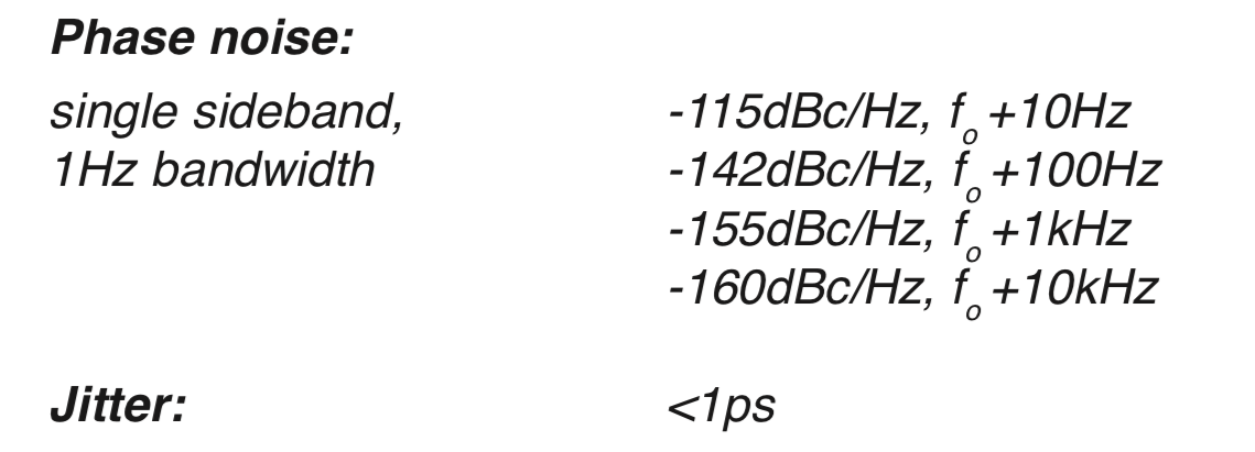

Hi A123, I looked at this as well. Point is that the phasenoise round 10Hz is significantly worse than the Andrea clocks. 115 vs 150.
Ouch. Okay I'll keep that in mind when checking the clock specs. I was just focused on the SMA connection now that the SinePi is soon to be released, but for that the Neutron Star or Andrea's is clearly the better way to go.
I'll stop getting sidetracked with clocks and just be happy with Andrea's clock.
