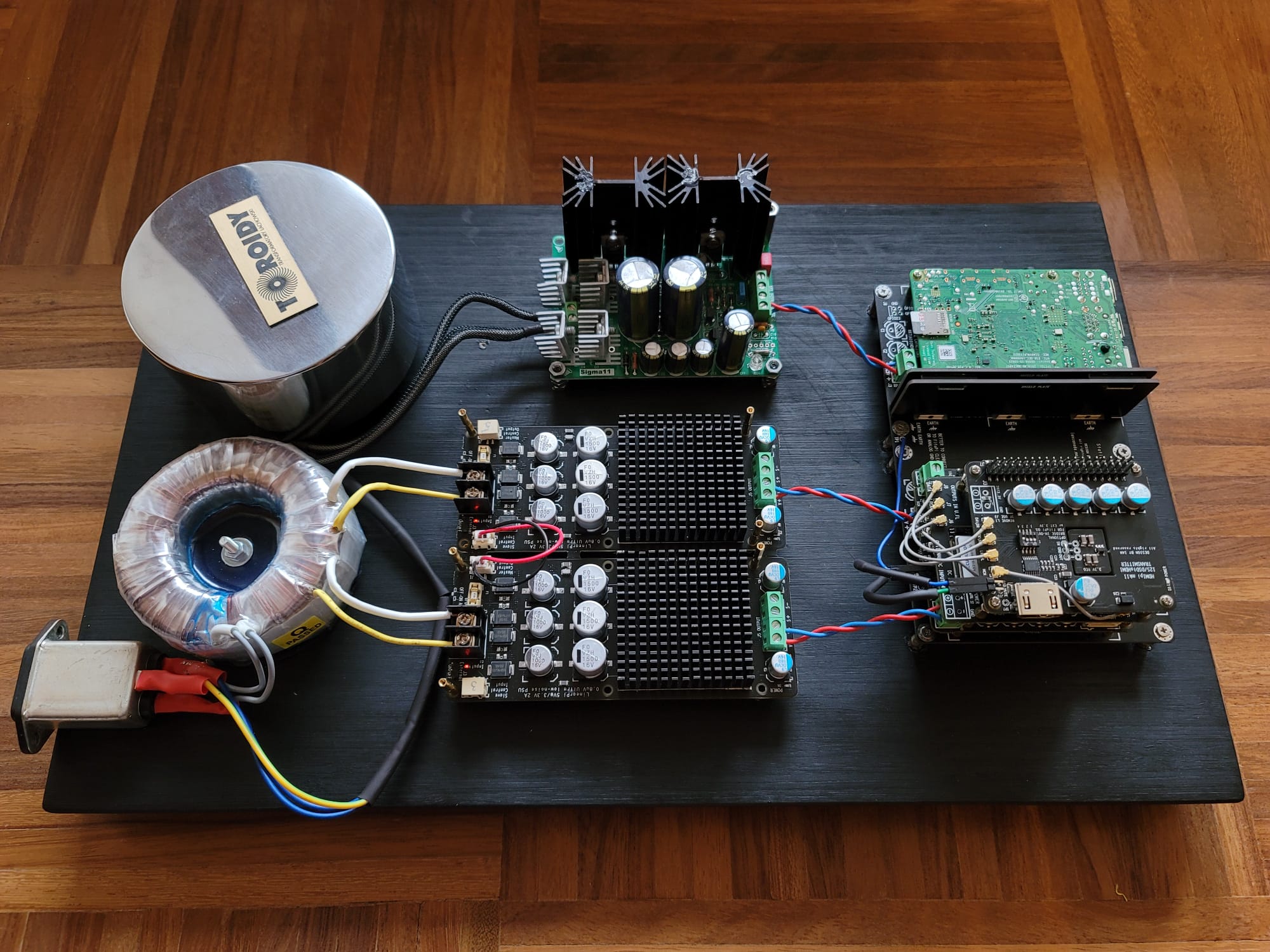

I'm a newbie too, but got my feet wet with some of Ian's products.
I am running the most minimalist Ian setup possible as I need both portable and desktop solutions.
As shown in the photo, I'm just running a battery direct to GPIO on a RPi 8GB with Ian's:
  1. FiFoPi Q3
  2. GPIO Terminator
  3. ShieldPi
I then stream the clocked realtime low latency source to a audibly transparent iPhone dongle via the iPhone. The iPhone dongle is highly praised on the ASR forums. This minimalist build (basically just a Q3) is all I need for a quality portable solution post-COVID.
So what you listed should be more than enough to get things rolling. But a reminder I believe you need to power the clock side with 3.3V on the Q3, so you may need to plan a power solution.
It's been a while since I thought about the architecture, so I cannot confirm on the power requirements.
What I do is I use the non-isolated GPIO pins for the non-audio related stuff like IR remote and OLED. I don't touch the isolated GPIO pins as shown in the photo as it is GPIO terminated with a ShieldPi on top.
I have no need for GPIO power 3 or Volumio so no clue how those play out. The StationPi I have not touched, but plan to work on that in October.

Update regarding my Ian Canada stack, Sigma 11 PSU for RPI:

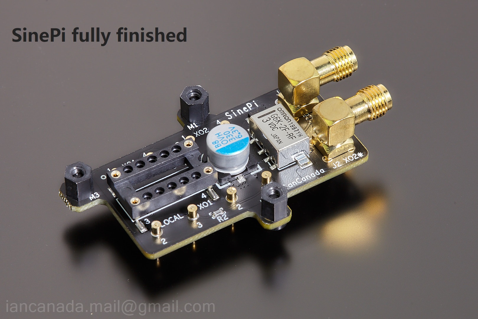

Trying to get the most out of TWTMC clocks for FifoPi (12)
Conclusions

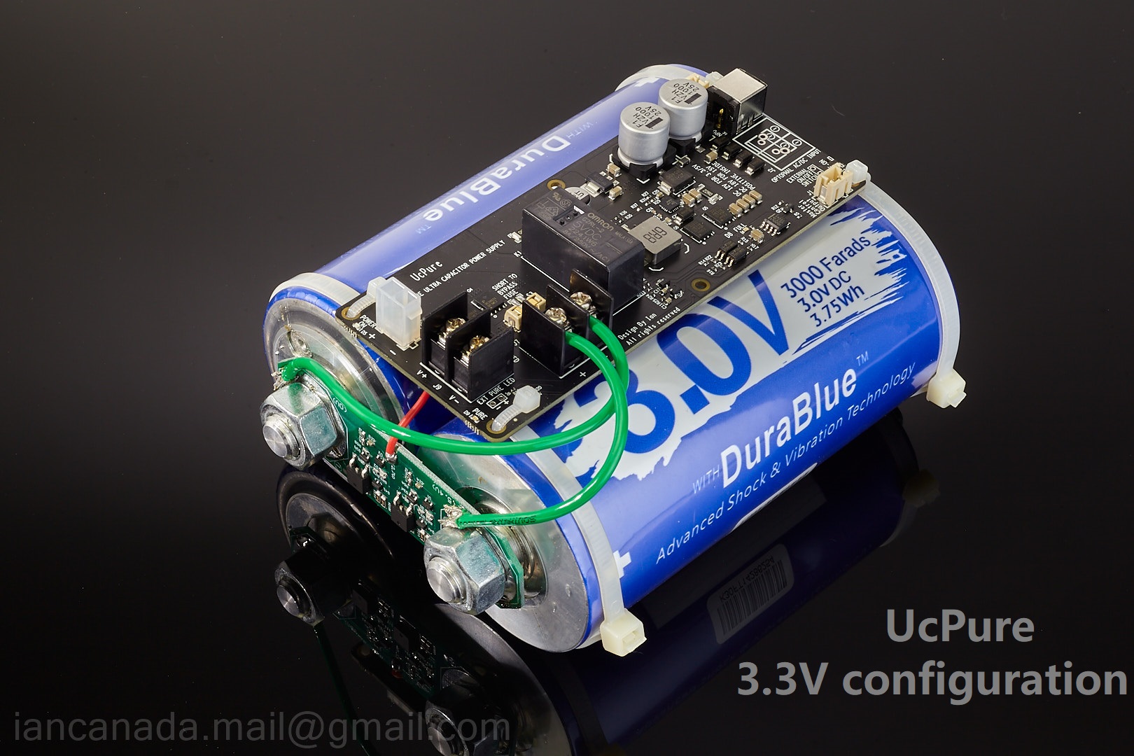

1. Many low phase noise crystal oscillators work in sine wave output mode. However, digital audio systems don’t take sine clocks directly. In this case, a good sine to square wave converter will become very significant to carry over the low phase noise performance from the phase domain into low jitter performance in the time domain. The SinePi was designed exactly for this purpose.
2. AM noise can be easily modulated into jitter while converting the sine clock to square clock. So, the power supplies for the sine to square converters would also be very important. It was confirmed that the power supplies at different quality levels can result in audible sound quality differences.

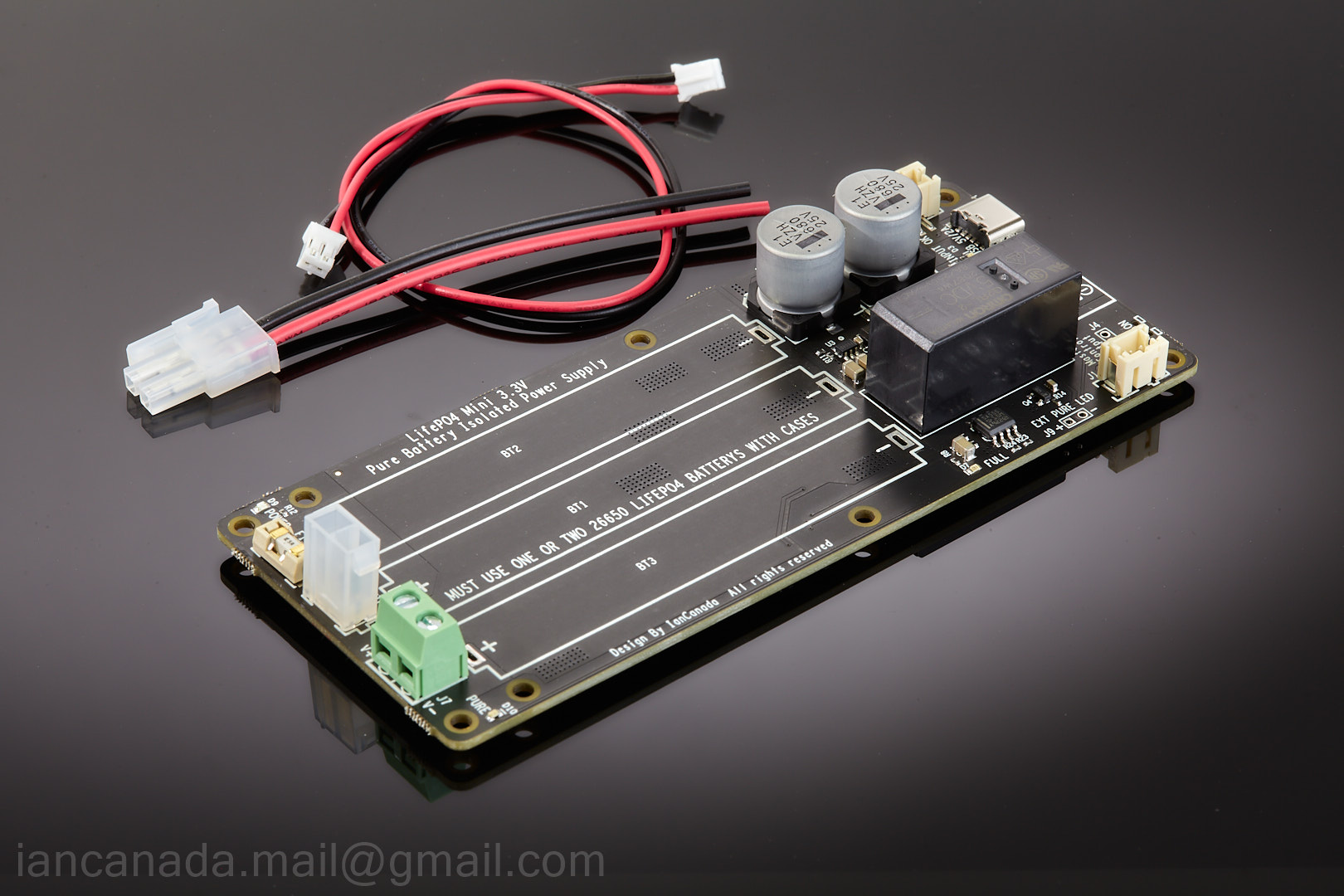

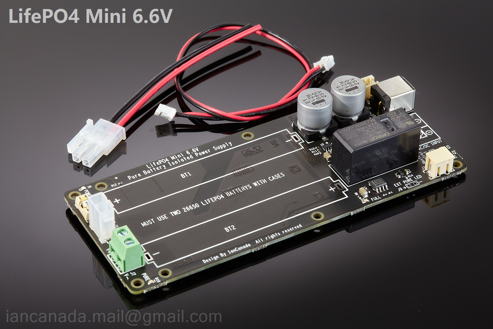

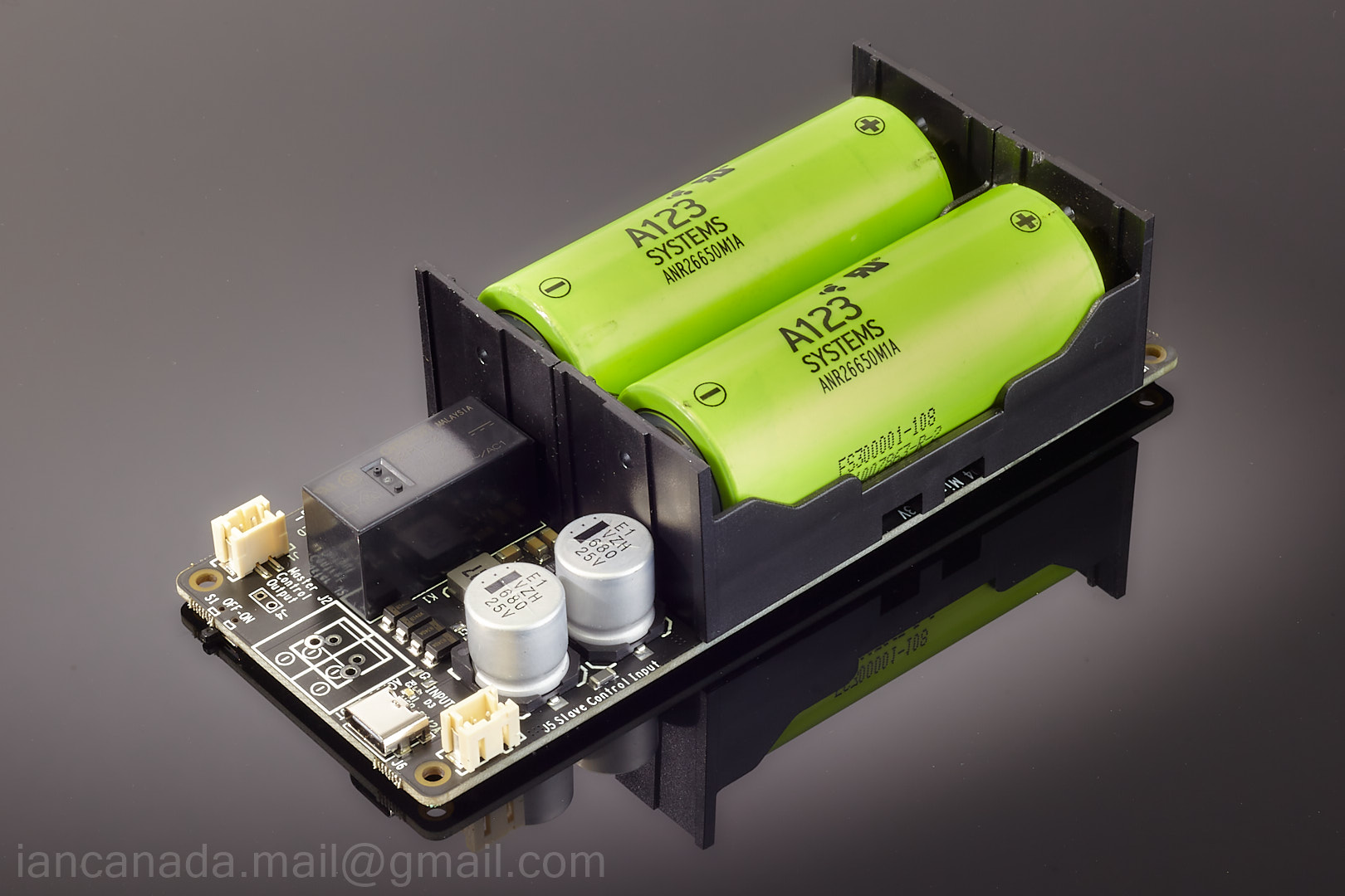

UcPure 3.3V configuration with 3000F (or higher) ultracapacitors could be the best solution for SinePi so far. LifePO4 Mini 3.3V with UcConditioner 3.3V is also very good, as well as the LifePO4 Mini 3.3V only. Active regulators or LDOs are not as good as pure passive power supplies in this application.
FifoPi clean side and the SinePi will share the same 3.3V power supply by default.
3. Of course, to get the most out of TWTMC sine clock oscillators, the best possible ultra low noise power supplies are also necessary. UcPure 15V with 3000F (or higher) ultracapacitors are so far the best solution. But those ultracapacitors could be very expensive and difficult to source. Alternatively, LifePO4 battery power supply is also a good choice.
4. Oven at desired temperature can improve long term frequency stability of an OCXO for sure. However, the real listening test also showed that an OCXO with an oven is also positive to the sound quality. To avoid introducing additional EMI noise into clock oscillators, care must be taken to ground the oven properly, as well as choosing a low EMI power supply for the oven. Isolated power supply would be preferred to eliminate common mode EMI noise.
5. I could be wrong, but my own experiences have shown that the sound quality of a OCXO with a multiplier is not as good as OCXO at the same finial frequency without a multiplier. I would suggest using the OCXO without multipliers as possible.
Ian
