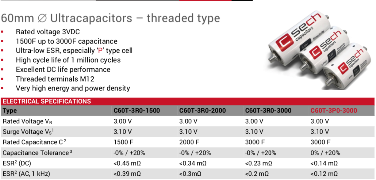

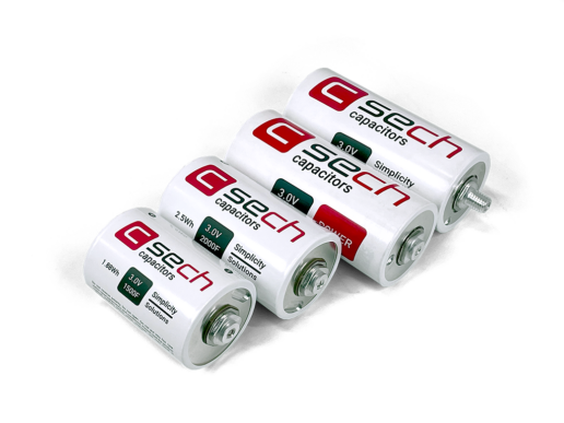

How do ya' like dem apples? In this case, mind-blowing low ESR.
Unfortunately, it's manufactured outside Europe and difficult to purchase for most.
Capacitor Cells – SECH SA
Hello,
Just a QUICK search:
C60T-3R0-3000 SECH SA | Rutronik24 Distributor
It is true you need a proper connection to maintain the state of the art specs. With M12 you can apply lots of force on the circuit board. Possible it will crack if you dont use a special washer and/or a special tool that will allow you to reduce the torque applied.
If the M12 thread is long enough maybe you can create a '' sturdy '' connection between the output wire and the part of the M12 thread closest to the cap and then use another nut to attach the circuit.
The French wrote some articles in the eighties about keeping the specs of expensive caps and batteries as good as possible by using special '' technique '' and Electrolube. Back then those specs were not as spectaculair as nowadays products.
One more reason i will decide to keep connections between supplies and circuits short but above all with a limited number of '' elements ''.
My idea is that using a cable with 100% more diameter wont always be better. If you use a cable that will just fit into the kind of terminal you will usually see on circuit boards OR you will just solder a thinner cable and skip terminals on both sides which one will give the best results?
Again my idea is that you wont need the enormous current '' capability '' of these monstercaps. So i would focus on a good connection that will remain good for a long time.

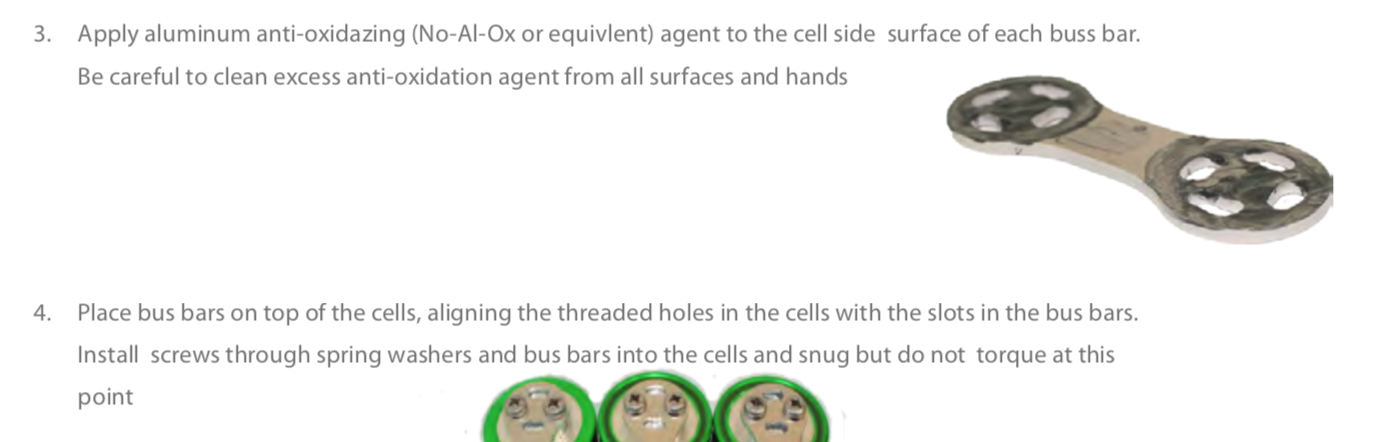

I'll avoid modding the protection board to use M12 and stick with the Philip screws for a more solid connection. Too much risk of human error on my side.
It was also recommended to use anti-oxidant or Loctite for a even more solid connection since the base is flat, more metal connection than an M12. The washers should help too.
So I will go the car audio Ultra Cap route pending successful purchase of the kit.
Here's a video of putting together the car audio Ultra Caps. I have a torque Philips, but not a torque wrench so it all seems to be working out.
How to Make your Own Supercapacitor @any Voltage!! - YouTube
That's why I was willing to spend a little more for the kit. It's pretty dummy proof and I get brand name protection boards. It's also been tested in the car audio world, so if their were any red flags it would of been posted by now.

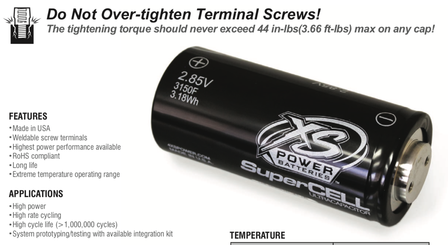

For the car audio Ultra Caps, it has good specs for a mature product:
Capacitance (F) 3150
ESR, DC ≤(mΩ) 0.26
ESR, AC 1kHz ≤(mΩ) 0.22
http://www.4xspower.com/2.85V-SuperCell-Instructions.pdf
At least the car audio Ultra Caps connection respects torque for a more solid connection. I'll eventually change to some Keystone M6 hex screws since the Philip screws in the kit seem flimsy.
