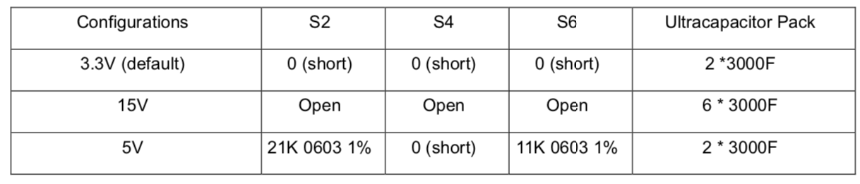

Oh, that reminds me. Ian, when you have time after the Group Buy can you point out how to short the 5V? You have to purchase a resistor and then solder on to short versus no resistor to short the 3.3V?

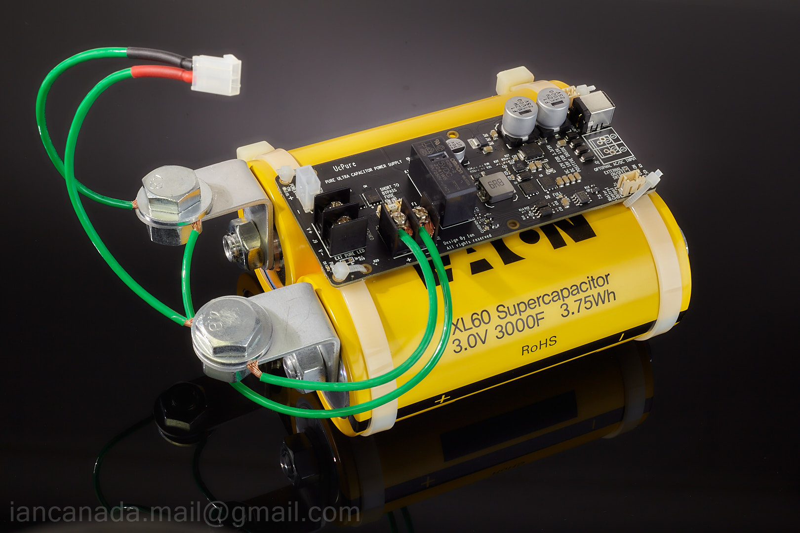

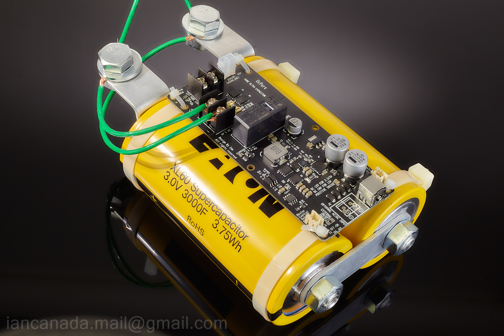

Pair of Eaton XL60-3R0308T-R 3000F/3V ultracapacitors have installed to a UcPure 3.3V power supply.
I'll use it in continuous output configuration to power a SinePi and FifoPi clean side.
They look nice and work great without any problem. I need a couple of days of break in before I get them compared with my Maxwell 3000F/2.7V caps.

yes!! now thats a more suitable ring/screw terminal connector. well done. I might have to grab a couple of these to try out.
Amazing implement Ian. I'll check out M12 supplies on Mouser or Machine Shops.

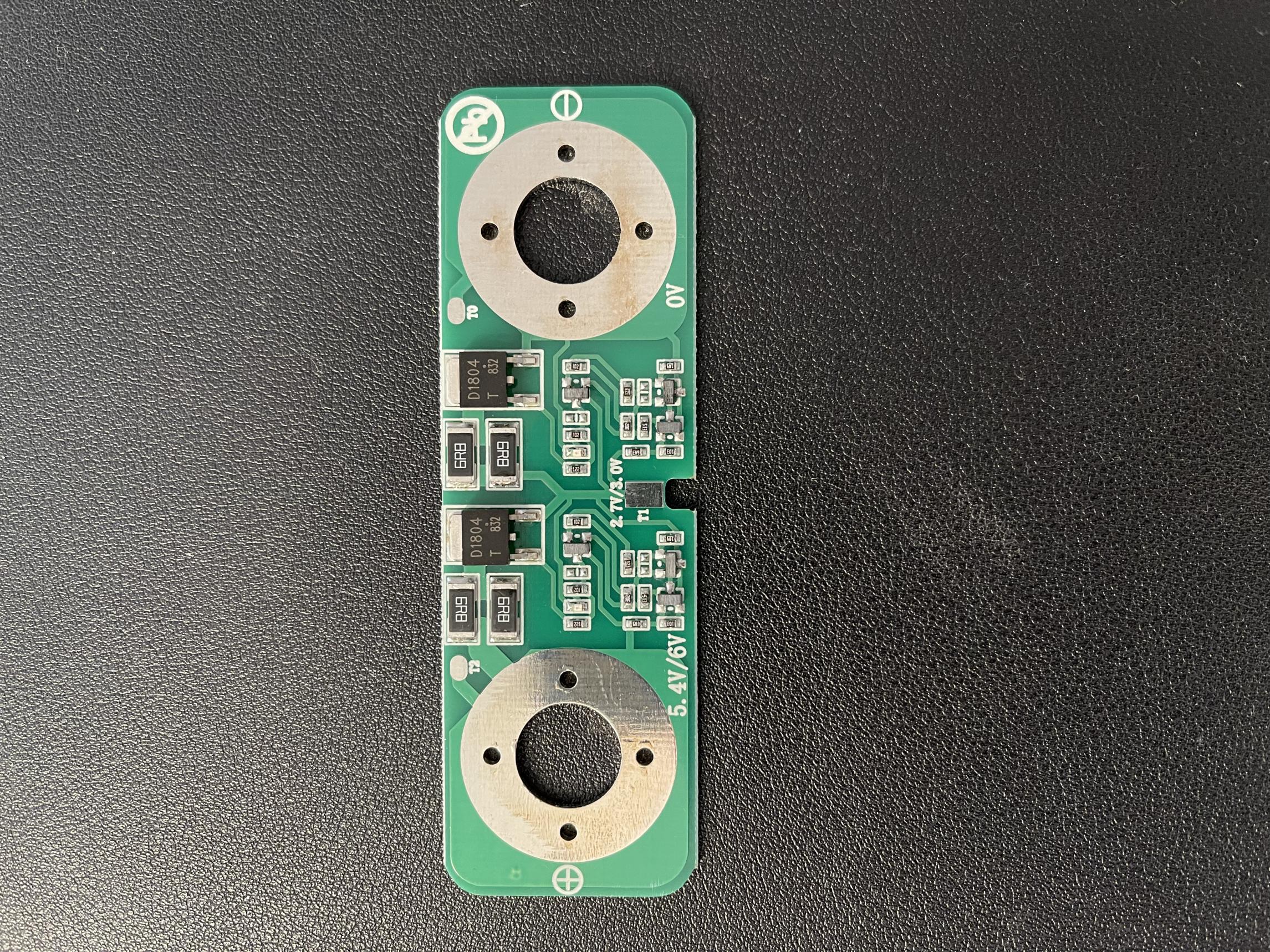

I don't see a balancing board. A balancing / protection board is not needed for 3.3V or 5V?
If a balancing board is not needed, it will change my arc as I don't need 15V for quite a while...
I'll be happy with something exactly like your photo with the Eatons 3V.

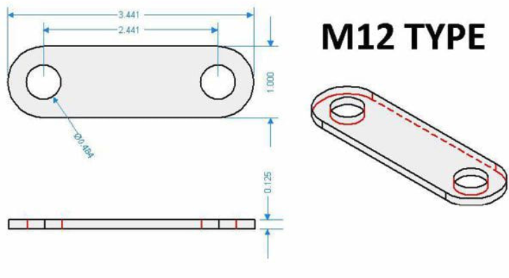

If I cancel my kit, I might try these cooper bars. No right-angle though, so will just run straight vertical on one end for positive and negative terminals. But the kit is a good buy as it may become OBSOLETE status soon. Decisions, decisions. Dependent on whether a protection board is optional with 3V.
I agree those new pictures have confused the need for balance boards. No way can I see why not needed for those capacitors too.
I am sure Ian will clear this up fir us

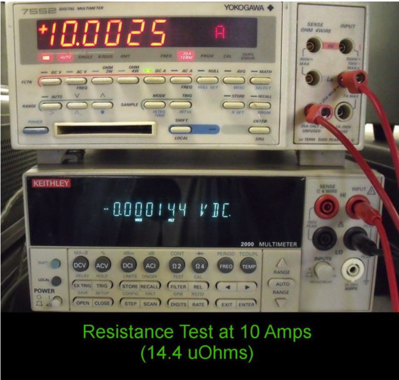

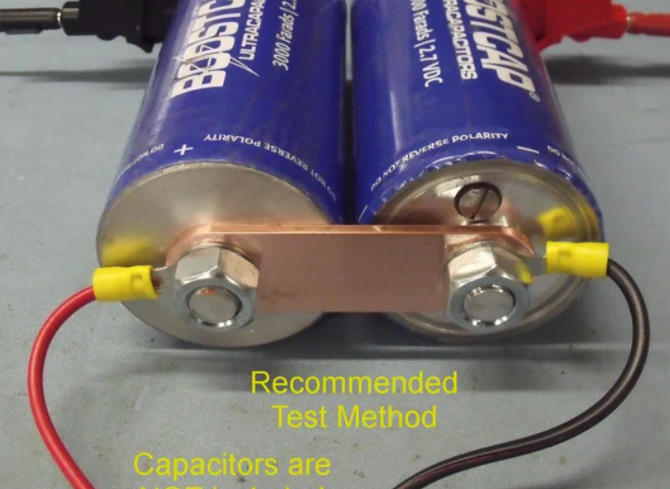

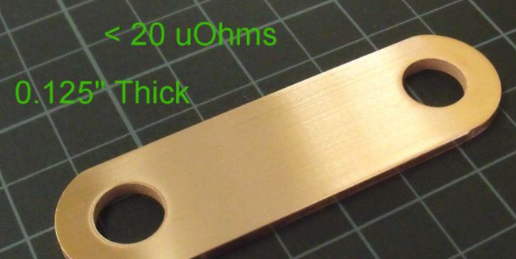

I haven't confirmed they are still in business since their website is not updated @ 2015. But I have seen their products on Amazon third-party and eBay.
SUPER CAP STRAPS
I'm pretty sure this is their eBay account:
Low-Z Copper Strap,12 pack,Maxwell Ultra Capacitor Farad BCAP P270 K04,< 20uOhm 680474114412 | eBay
I get free shipping domestically if I order direct, so may pursue that route.

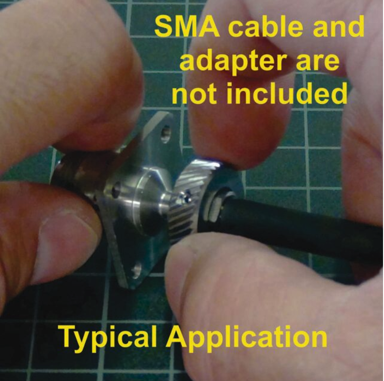

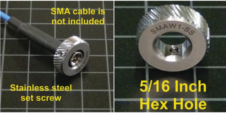

I'm also considering ordering the SMA connector finger thumb wrench for the SMA cabling.
Note: I haven't gone through the Eaton / Tecate spec dimensions yet to compare size with Maxwells. I wouldn't mind the Aluminum (Repeating in both US and UK pronunciation) either. It doesn't have to be Cooper.
Be careful too if you order on eBay to order the M12 not the M8. It can easily be overlooked since the packaging is exactly the same.
