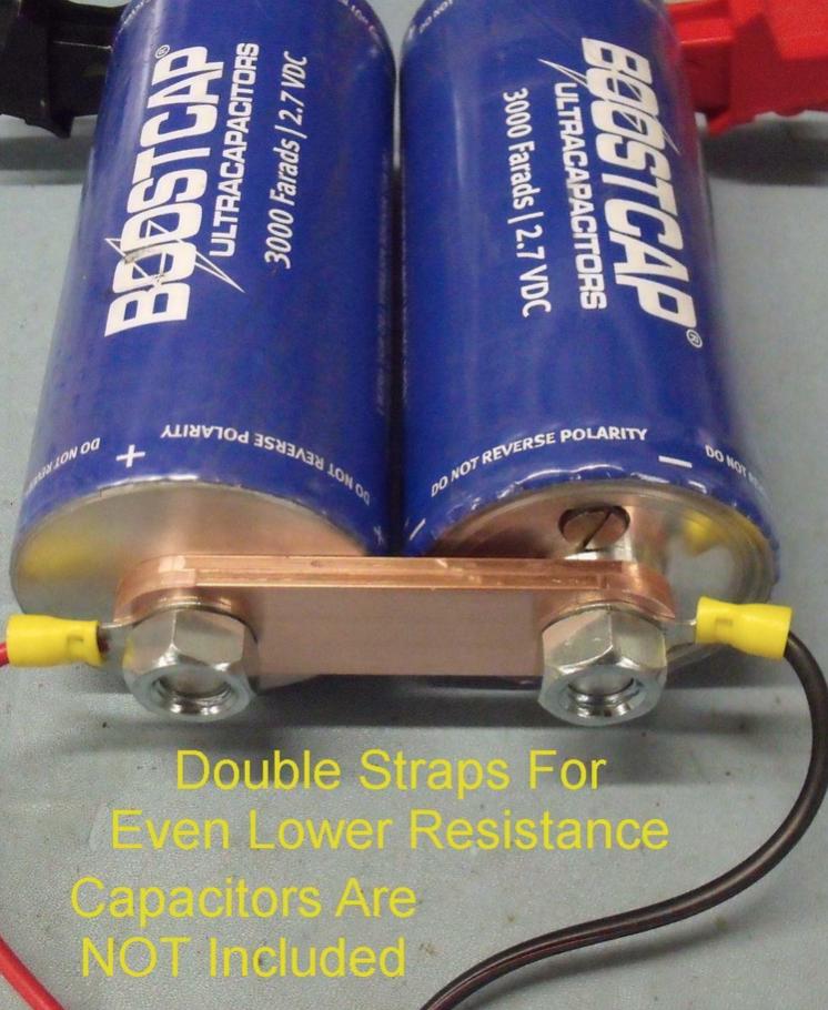

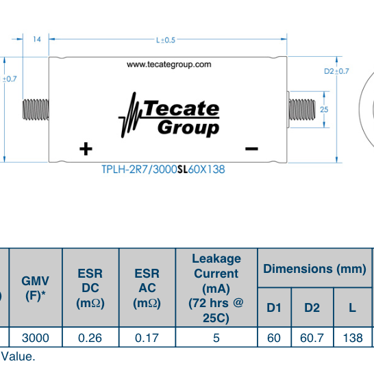

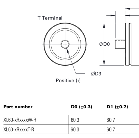

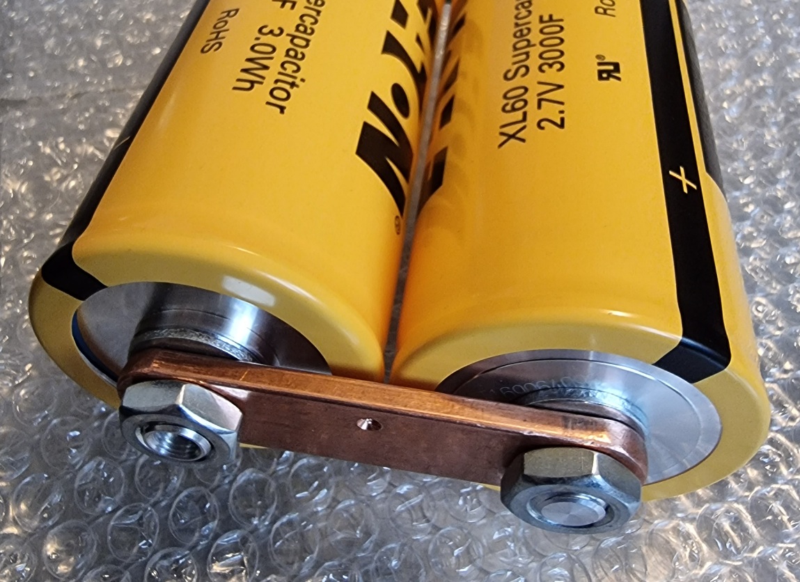

Body diameter of Eaton and Tecate is between 60mm and < 61mm so the bars should be okay to order.

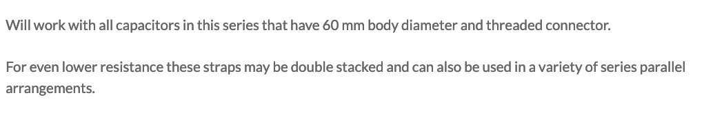

Also, if you have extra bars, you can double stack for lower resistance.
Hello,
These bars are very easy to diy if you cant find them.
I dont think thickness is that important usually the resistance is created in the area where the bar, bolt and terminal meet.
Especially these big M12 are hard to crimp. Better go to a shop/company where they crimp them on a daily basis. You can even ask them to make a replacement for the bar using a thick cable and two crimped M12. If the M12 connector is rather thin the contact area between connector and the cap will be bigger because the nut will '' flatten '' the connector. Of course using a dented washer and a kind of electrolube will improve things a little more.
It could be possible to crimp the cable going to the ucpure board and the cable going to the Fifopi board in one M12 connector. If not use two separate M12 connectors and bolt them with one nut to the cap terminal.
In the past i worked in a company where they used a lot of very high current welding machines when things went wrong because of things getting hot most of the time it was BAD connections. Usually they used infra red thermometer to locate the bad '' joint '' in the '' distribution board '' . Once there is more heat than allowed resistance can go up because contacts get contaminated and things will get worse.
OF course for Fifopi board there are no huge currents but it will be good to try to maintain the specs of the caps all the way up to the circuit where it will meet the tiny track so to say.

HI if M12 is a problem you can retap with smaller ones...Body diameter of Eaton and Tecate is between 60mm and < 61mm so the bars should be okay to order.
yeah, I was just about to say, why buy something like that? some copper plate/bar stock and a drill press is all you need.
I've also used goertz copper 'foil' flat speaker cable and drilled. they are 12AWG equivalent iirc.

Using something to is more like a foil than a bar wont leave any space for a kind of voids because the foil will be pressed all over the surface when used with a proper seized washer and nut.
In the perfect situation the foil will complete cover the terminal surface given by the cap.
If i would use thick bars i would make M12 threaded holes in them! This will add more " contact area " and it be kind a airtight. Of course still can add a nut and washer!
With threaded holes there could arise the problem that when " mounting" two different metals this way you want be able to take them apart again because they will kind of interact chemically. Stainless steel is notorious for this.
BUT these caps are made to last so probably no issue.

Hello,
I'm just weighing my options right now as I can still cancel my kit. If I keep the kit, I may not have a need for these because they will not be M12. It was mainly for @SimonJ, but I believe he mentioned he is building his own. In my case, you need to pick your spots and sometimes it's not justifiable to build your own and the better option is to buy from a place that specializes in these niche products. For Aluminum, it's not a bad deal since there is free shipping. So $30 for the product - $10 shipping = about $20 for a dozen. Not bad. The cooper may be borderline between buying and building your own.
Yes, that's a good idea. If you really need a tight fit and for pure optimization, buying the M8 and drilling a larger hole to fit M12 can be a better route for some.
I am now waiting for the circuit board from Ian. 😀
The copper rail is homemade from a rail that is used in control cabinet construction.
That's really optimal. Something I would be happy with as it's thick and cooper. When you notice the M12 nuts do not fully screw in to the capacitor's M12 thread, you know you have a solid bar. It makes me want to buy the cooper and double stack. The time it takes to find cooper raw material and make your own doesn't work for me versus just buying pre-made straight out.

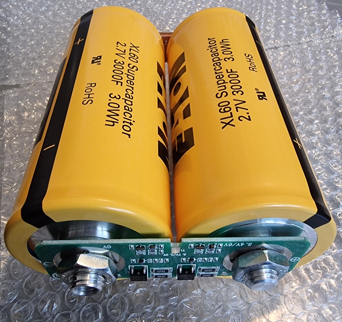

I'm leaning towards just staying the course with the kit. My current plan is:
- Drill a larger hole in the protection board to fit M12.
- Pursue the Eaton 3V.
- If it works, then pursue cooper bars.

Hello,
Using this kind of thickness you must be absolutely sure that the surface is 100% flat and it wouldnt be bad to polish it because wherever there are ''scratches'' the contact area is reduced.
Unless you use a very thin material most of the added '' resistance '' will be in the connection itself not in the material.
Of course the cable going to the Fifopi should depart from the '' spot '' closest to the terminal area of the cap itself.
You want the upper part of the bolt to have the biggest diameter possible! A so called button head screw with flange is what it is called i think. I remember buying big caps being delivered with this kind in the past. It will assure you the maximum pressure being executed by the bolt/screw over the largest area possible.
Greetings, eduard

I'll be sure it's flat and polished. The machine shop should be able to handle the finishing touches.
Because of the cooper bars, I wanted to go back to threaded. But then I eventually run back into the problem of protection boards.

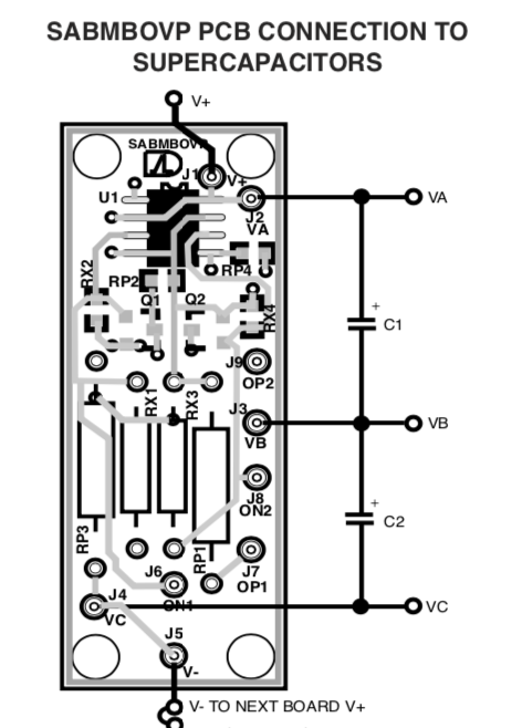

After the cancellation, I noticed Advanced Linear Devices offers a HQ 3V balance board. That got me to wondering if Ian did not include a balance board in his latest photo because the knockoff did not support 3V? Even if it did, it would not take full advantage of 3V because it's capped @ 2.7V? I don't trust knockoffs anyways because they are so hit or miss. I can't afford a miss for risk purposes, so I want something brand name of high quality. I will be running the UcPure 24/7 in continuous mode so I can't babysit this solution. The kit would solve this problem (2.7V max?).
I want to explore the ALD 3V option a little bit before playing if safe and re-ordering the kit. The examples to me look like Alien Code, but I'm guessing if the V+V- on the ends of the ALD PCB go to UcPure? Then the +- on CAP1 (Eaton 3V1) and CAP2 (Eaton3V2) connects to the ALD PCB? CAP1+ goes to VA. CAP1- goes to VB. CAP2+ goes to VB? CAP2- goes to VC. Again, no clue, it's Alien Code. But these boards do not cost much more than a knockoff, so risk is low to experiment.
Looks straightforward, but I'm trying to get a real-life example direct from ALD. Even if I experiment with an ALD board, I don't know how to debug if all is working even if wired correctly.

The boards I bought which look the same as what Ian used work at 3v as well
Nothing wrong with a knock off in this case I feel as hardly any components and simple circuit with not much to go wrong I feel.
