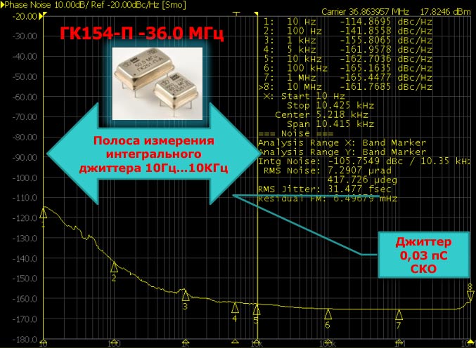

I myself live in Russia. I called the Mxtall plant. But I chose others, ГК154 manufacturer in Moscow. Кварцевые генераторы :: Производство и Поставки :: ООО НПФ БМГ ПЛЮС In terms of characteristics, they are not inferior to MXO37 / 14 and sound great! But they cost around $ 50
I use it on 22 and 24 with fifopi. I only have a table of 36 for comparison. Now I want to buy myself another 5.6 and 6.1, but the minimum batch is 3 pieces of each frequency. I also think about group purchases.
But for maximum performance they need 5v. (3.3v support too).
