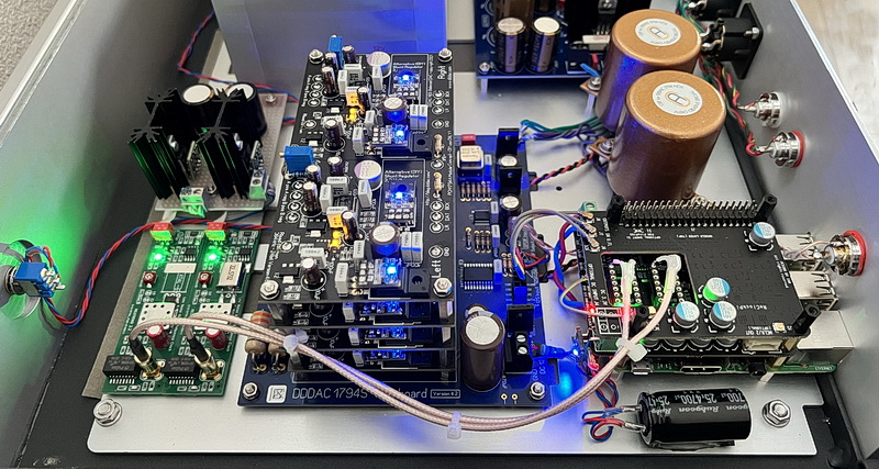

A great story from Audio Creative on a highly pimped DDDAC where the FiFoPi and Ian ReclockPI are featured as well…
berrystreamer-xl-ultimo/
@dddac
That's really nice 🙂
Thank you for sharing the link
